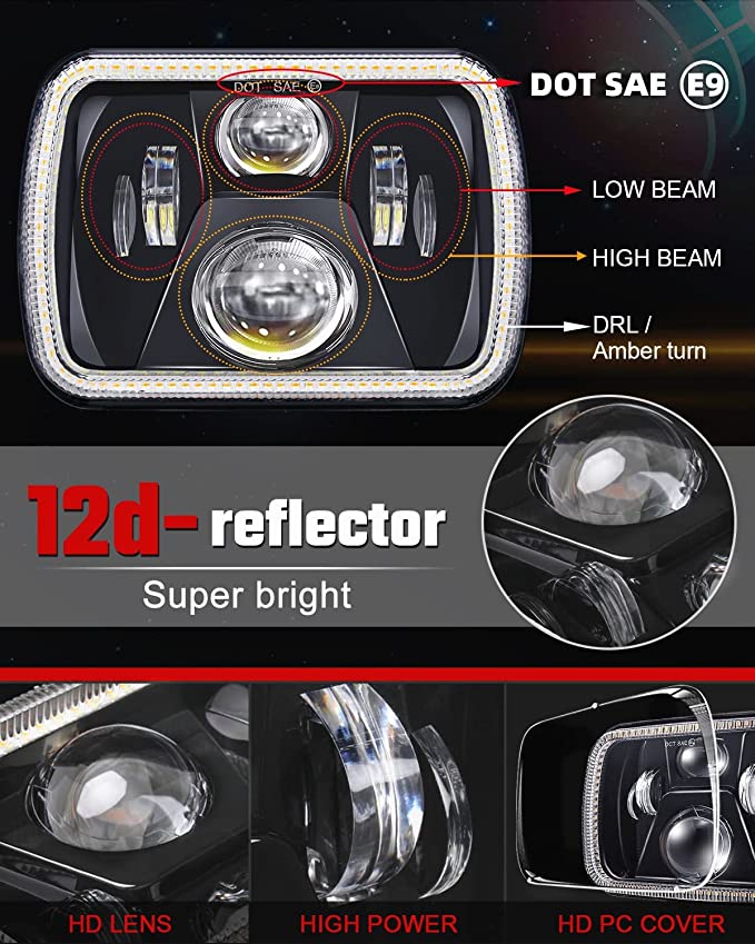

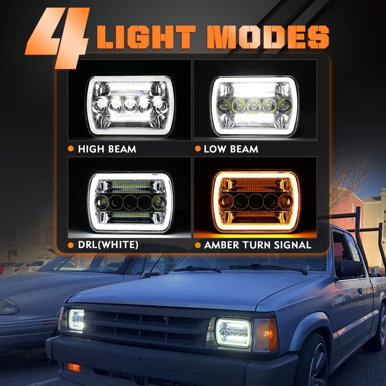

These another option that had yet to be mentioned. IF you are at all interested in aftermarket LED headlights, many have the white/orange halo which, if wired, acts like a modern car with the white halo turning off and the amber halo flashing for a turn signal.
- photos or they don't exist ...
- live TECH video of them in action on a 95 - older Minitruck / 4runner and they do exist .......

I run a set similar to this. For the price, it beats the hell out of any sealed beam, even the silverest-super-ultra-white ones, I have spent too much on. Downside is dealing with converting to switched positive wiring and running a hot to the bright indicator on the cluster.
It should be possible to use the factory dash wiring… I have an aftermarket relay harness for my FJ62, 5 relays iirc for 4 lamps.
I made my own conversation harness and just ran the heat back from the high beams to my indicator. There's certainly a very way.
