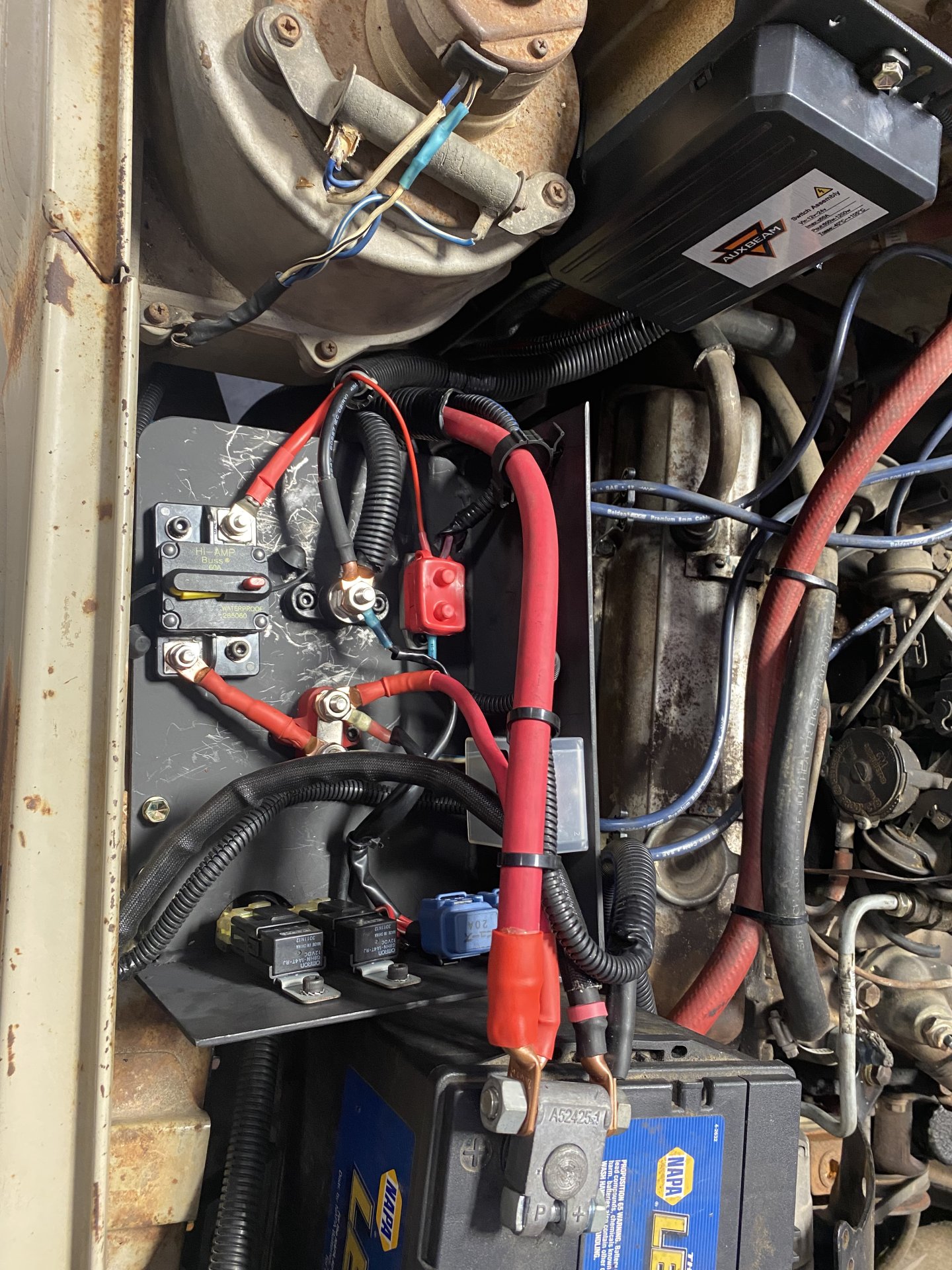

That blue crimp 'ring' connector looks like you struggled. For that wire, it would have been easier if it was a 16 to 18g (red).

What all should be flashing with the hazards on? Currently, nothing is. Only the tail lights flash when the turn signal switch is on right turn. I definitely suck at the electrical stuff so struggle is a good word to describe my work haha
