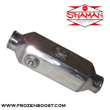

I've got a water-to-air intercooler that would just about perfectly replace that straight piece of tubing. I started with this core and built it up myself. No pics of my completed setup handy on this computer. It's very noticeable on my 6.5 Chevy, though I think I need more water volume for towing. It's a work in progress.
Barrel Style Water to Air Intercooler
