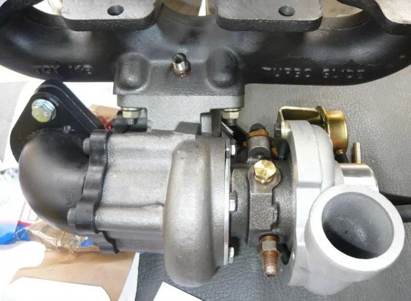

OK, so with that as the back drop - here is the kit: as you can see, it has the fittings that swap right into the oil lines at the filter - very simple design. The only aspect that I don't like is that on 1982 and older models, you have to cut down the length of the "arm" on the air cleaner lid and weld on their 90degree arm to make the tight turn to the turbo intake. So, I'm looking for a post-82 lid (they have a shorter arm): https://forum.ih8mud.com/diesel-jdm-parts/372835-post-82-3b-air-cleaner-top-lid.html
Other than that, the kit is nice. FYI the cost out the door with shipping was $2730AUD as of February 2010 (roughly $2500USD). I know I could have saved some money by gathering my own DIY kit, but I don't have the time or patience for that. As they say: you can have it cheap, fast or good - pick two and it won't be the other.

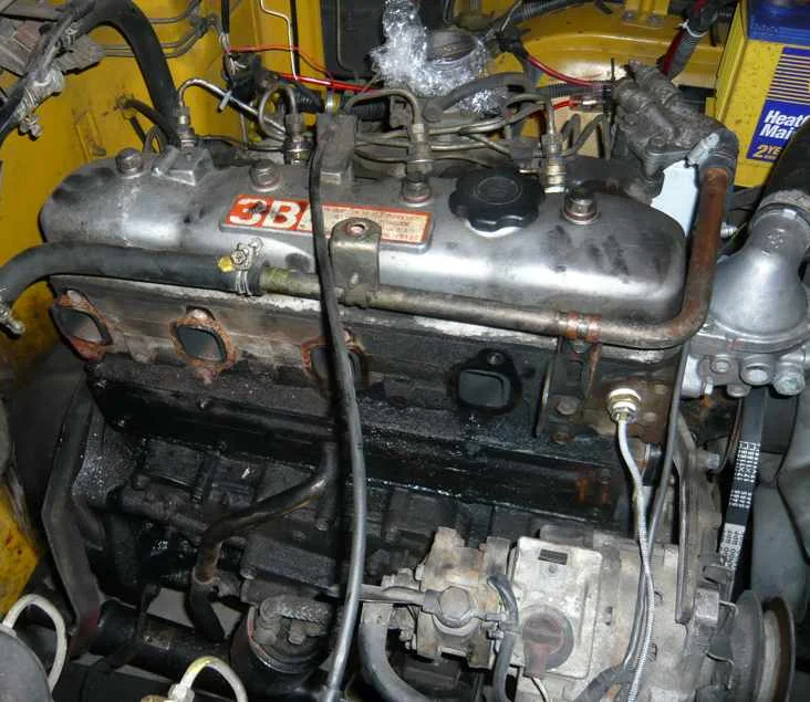

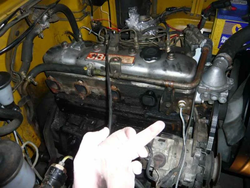

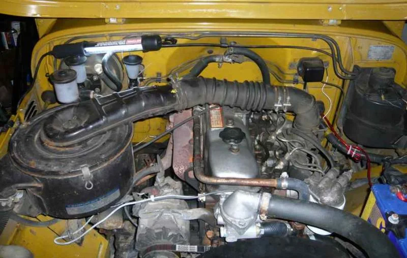

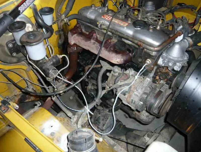

Removed the air cleaner for better access to the exhaust manifold. Wiper fluid reservoir removed on a different project. Exhaust manifold wasn't bad BUT FOR the lower left bolt - that thing was a beast to get out. I soaked everything in liquid wrench.
Since part of the problem was access and the ability to get any leverage on the bolt, I also removed the exhaust pipe @ the manifold... and since one nut (back one, without much room to get a wrench/socket) was stubborn, I sawzall-ed the pipe so I could get clear access underneath it. I'm getting all new exhaust, so easier to cut it out than work around it.
Since my side cover looks like it leaks and I happened to have a new cork gasket, I removed the old gasket with a razor (had baked onto the engine and cover) and slapped some high-temp RTV on there with the gasket and cleaned up the oil a bit. I don't know if the oil-spewing 3B will now keep the side of the engine clean (doubt it), but I'll give it a try.
Then I installed the TG-supplied oil/return line fittings - very easy job. :banana:
Attached the lines to said fittings and began putting in the studs to which the turbo/manifold bolts.

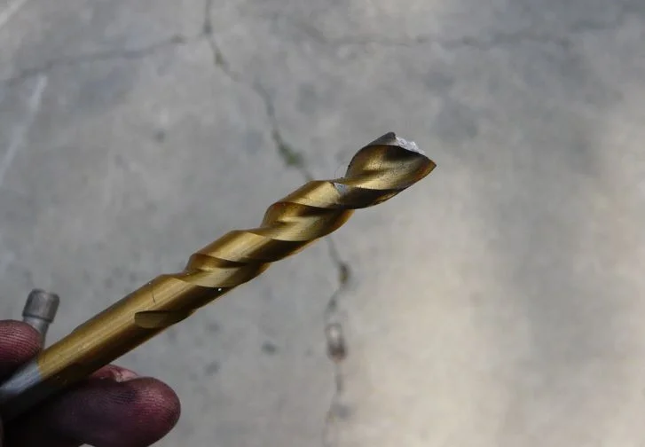

OK, so the beat goes on. Here is the boost and pyro fittings all snugged into place. I tapped the crossover tube for boost and pre turbo for pyro. Drilled both with an 11/32 bit (after breaking one on the TG manifold - thing is a tank, see below...grrrrr) and threading with a 1/8 NPT tap.

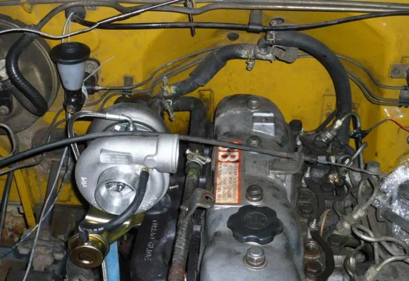

So, this is where I'm at. Manifold is on. I'll post up more as I go. Hopefully, these pics are useful to somebody jumping into this.
I see one problem: anybody have an idea as to how I can not fry my throttle cable? The way it fits, it touches the turbo unit - not good, that thing is gonna get toasty under load.
TG's pics seem to show a tin-foil-wrapped contraption (not kidding) on the part that passes over turbo. I've gotta figure something out.

Final piece of the puzzle is finding a 83 or later air cleaner top or finding a suitable aftermarket alternative. From most of the posts I've read, the K&N style "cone" gets no love. I'd really prefer not to hack up and weld my 82 unit - really want to find a short-arm version... the search continues.

Cheap drill bits suck, ti coated equals chinese crap bits...:popcorn:
~Rob
It was a DeWalt bit... I thought it would be of decent quality. On the bright side of things, this project gave me an excuse to buy a really nice drill - my 18v cordless wasn't doing the job.
The bit went into the metal pretty well, but then at the end, it literally "snapped" off. I had to work it back out with a pair of pliers. I think I'll take it back to OSH and ask for my $8 back...what BS.
Yep, Dewalt means nothing, they are chinese also.
High end bits are well worth the money, I purchased a set four years ago, never broke one yet...:beer:
