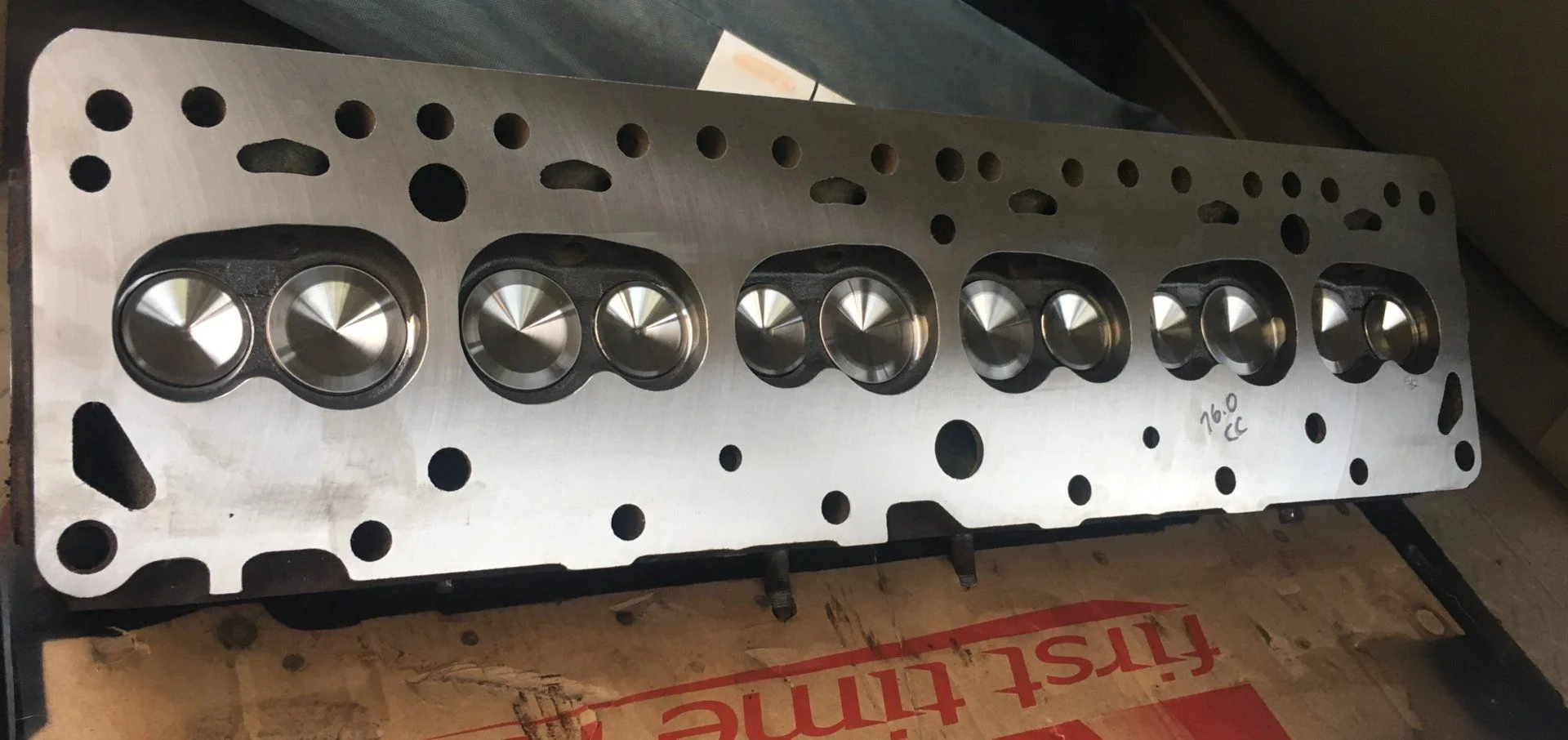

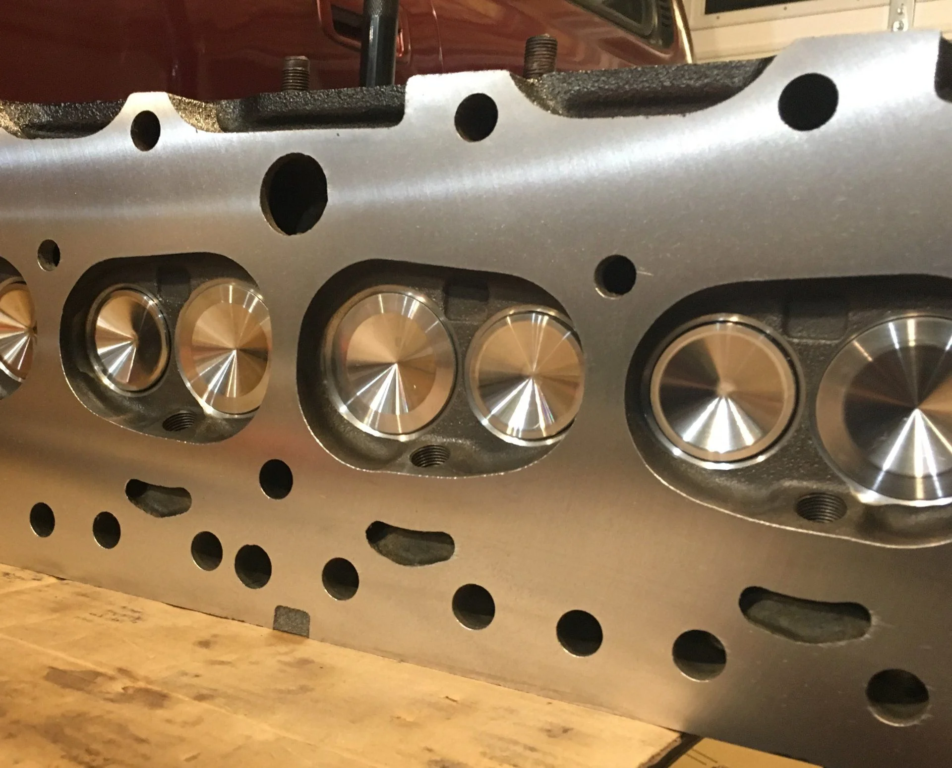

Another thought... In pursuing better breathing of the 2F I milled down some FJ62 manifolds. They have worked great with the sniper and I like them a lot but the stock 60 exhaust manifold has better placement for a turbo . I wonder if the improved flow of the 62 manifold would justify the more space consuming and difficult turbo manifold/adapter/J-pipe or if direct mount on the more restrictive 60 manifold would suffice?... Eventually just making my own turbo manifold may just be the way to go...

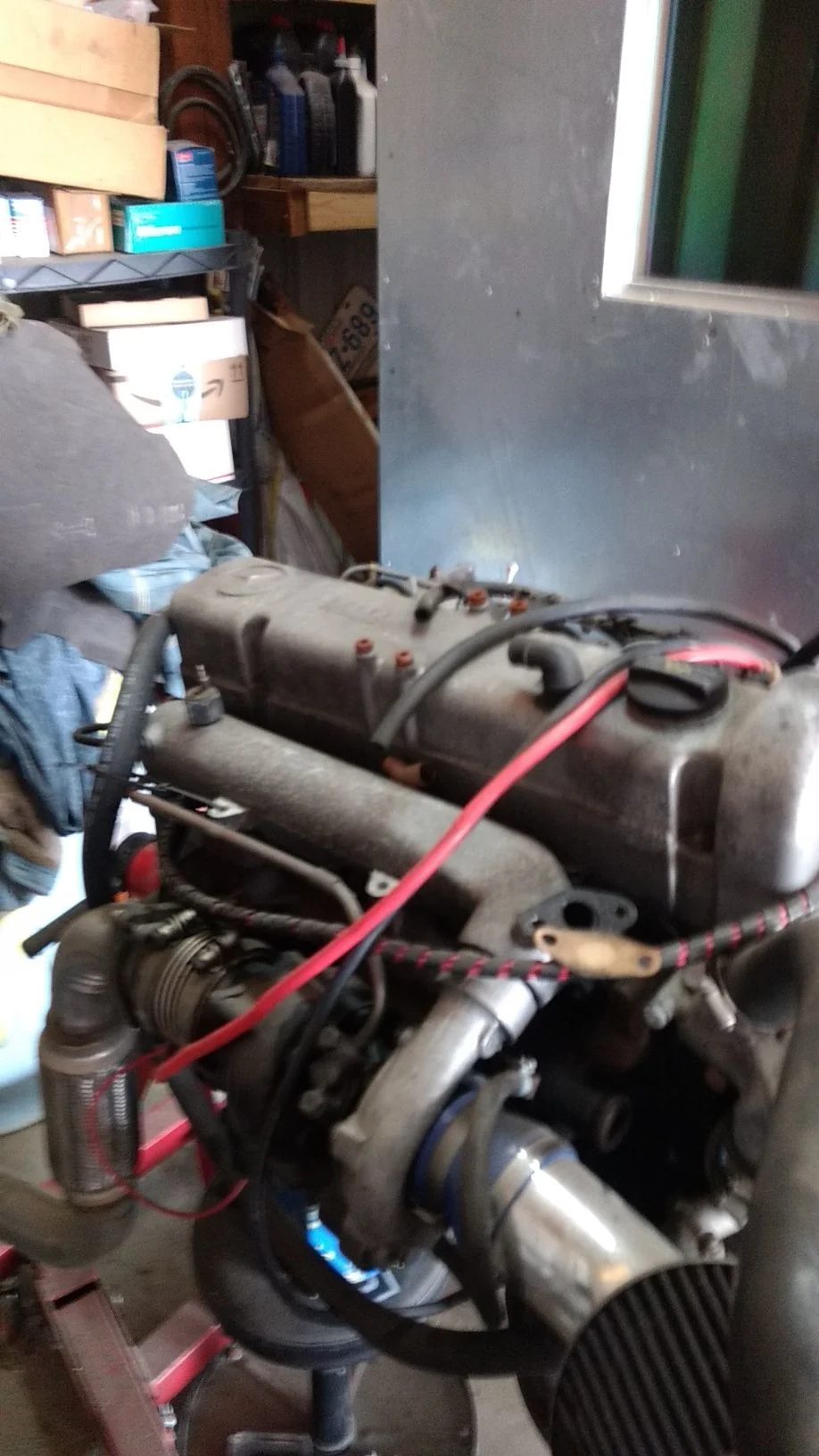

Something low boost and easy, like this. ;)
FINALLY! SOMEONE THAT SEES MY VISION!
I'm putting together a turbo 1f-z for my 80 (see you this week @FJ60Cam !) and I watch this video regularly for motivation!
Now you're on the right track
