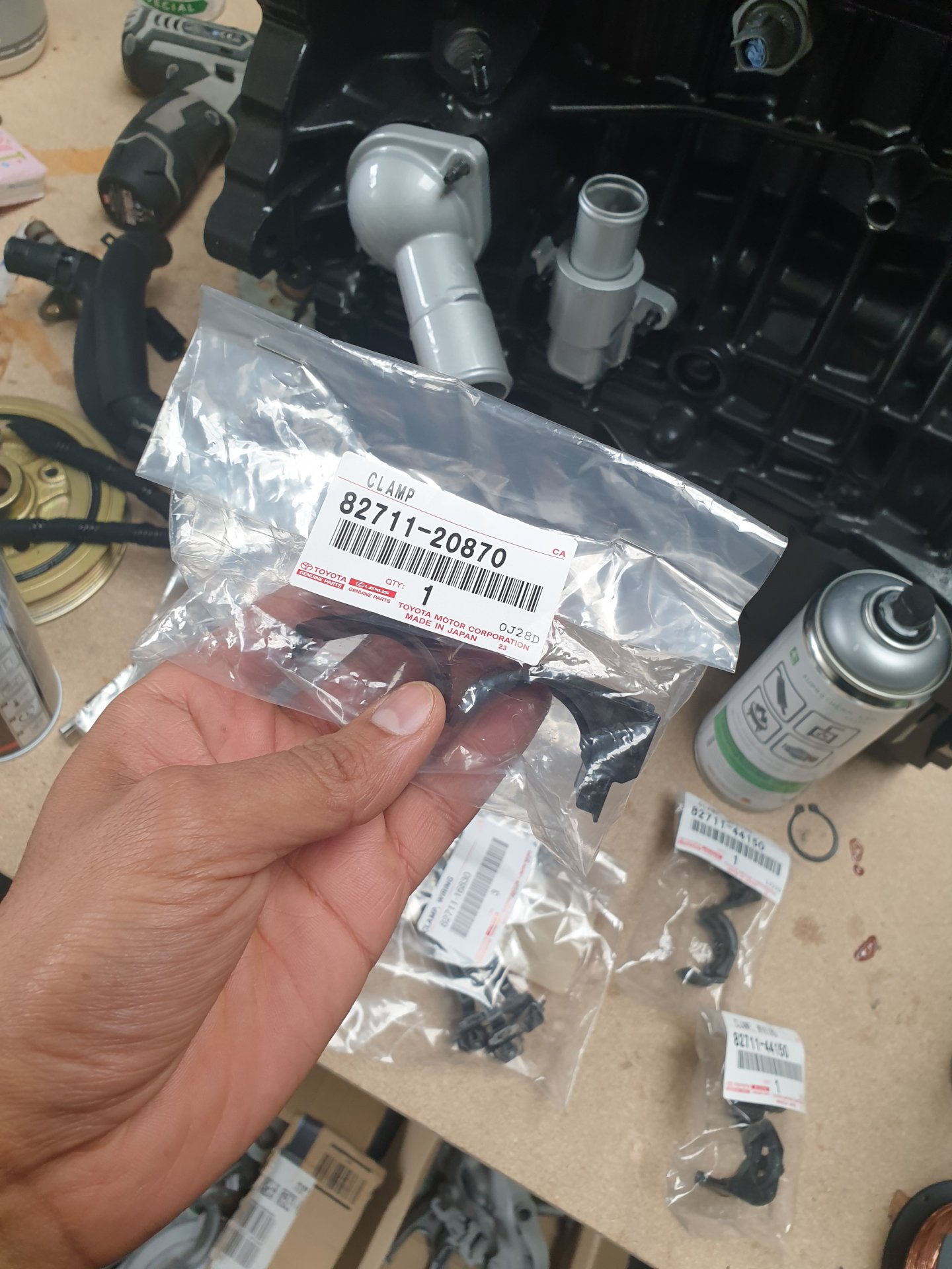

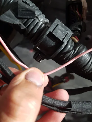

Trying to find the part number for this engine harness clamp

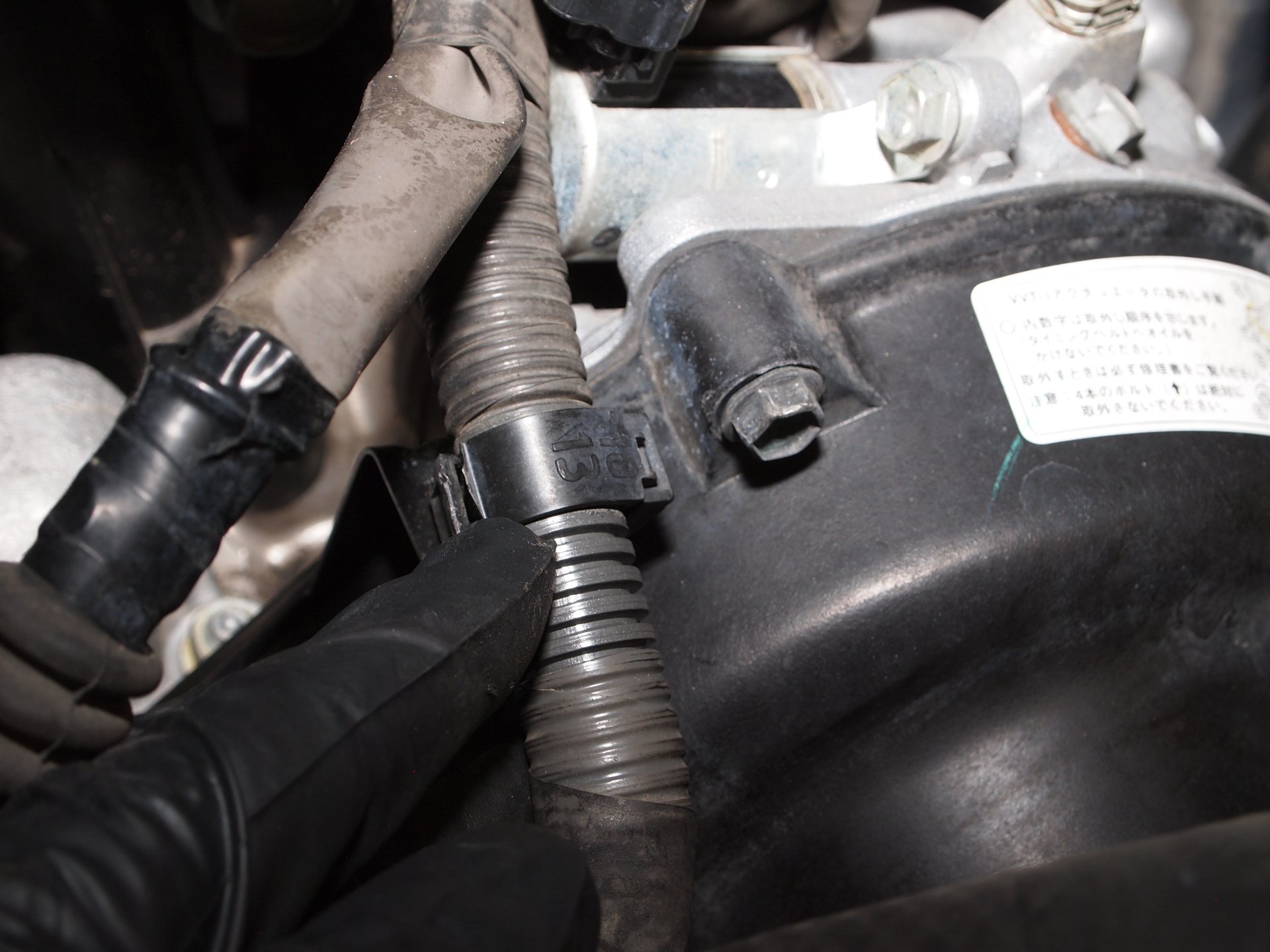

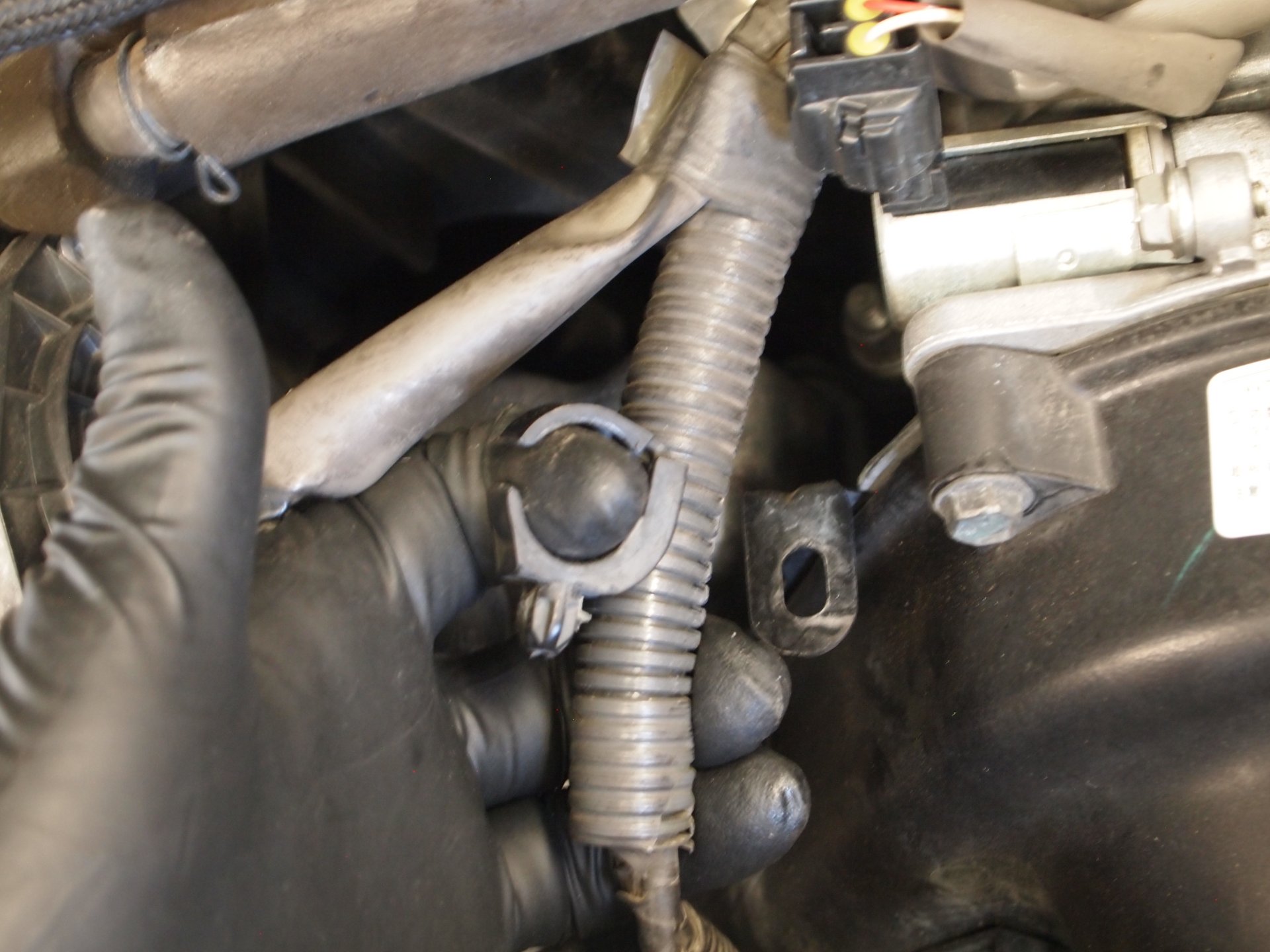

It is a tight fit, but seems to fit well. This is on a '99. I don't have the front of the original clamp. Does your clamp also have a number stamped on the rear?
Does the 03+ have additional wires in the harness? Perhaps they had to use a larger clamp because of it?
I went back and recheck fitment, remove old first from 07. It does fit all years. Nice find.

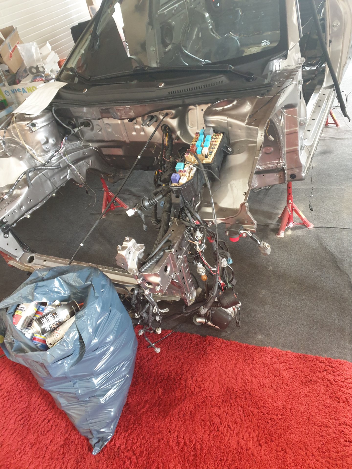

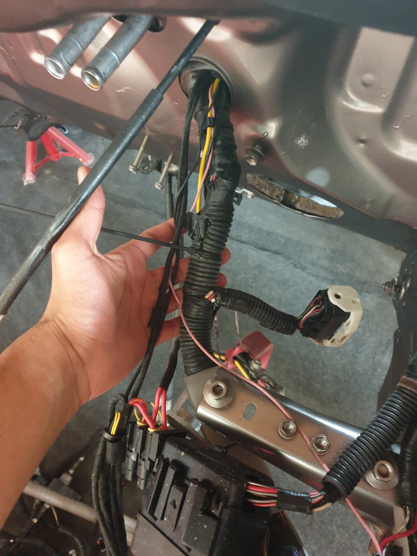

your forum definitely helped me. I received all the clips for my Toyota wiring harness that are officially not available for purchase separately for my model. the car is not a Land Cruiser. I hope you are not mad at me. Greetings from Germany and many thanks. All the best!

That clamp is for a 91-95 MR2
unfortunately you can't see it like that. the clip is for many cars only for the Toyota MR2 you could buy them individually. in my Toyota Celica T23 this clip is also available. only via my car there is no option to buy them individually. If you want to have all the clips for your wiring harness, you can only search using the dimensions of the clips. and then search for which car Toyota offered these dimensions individually. for my car I had to search almost 60 diagrams of other vehicles. I haven't found any other way yet. well what the heck. anyway it worked now. All the best

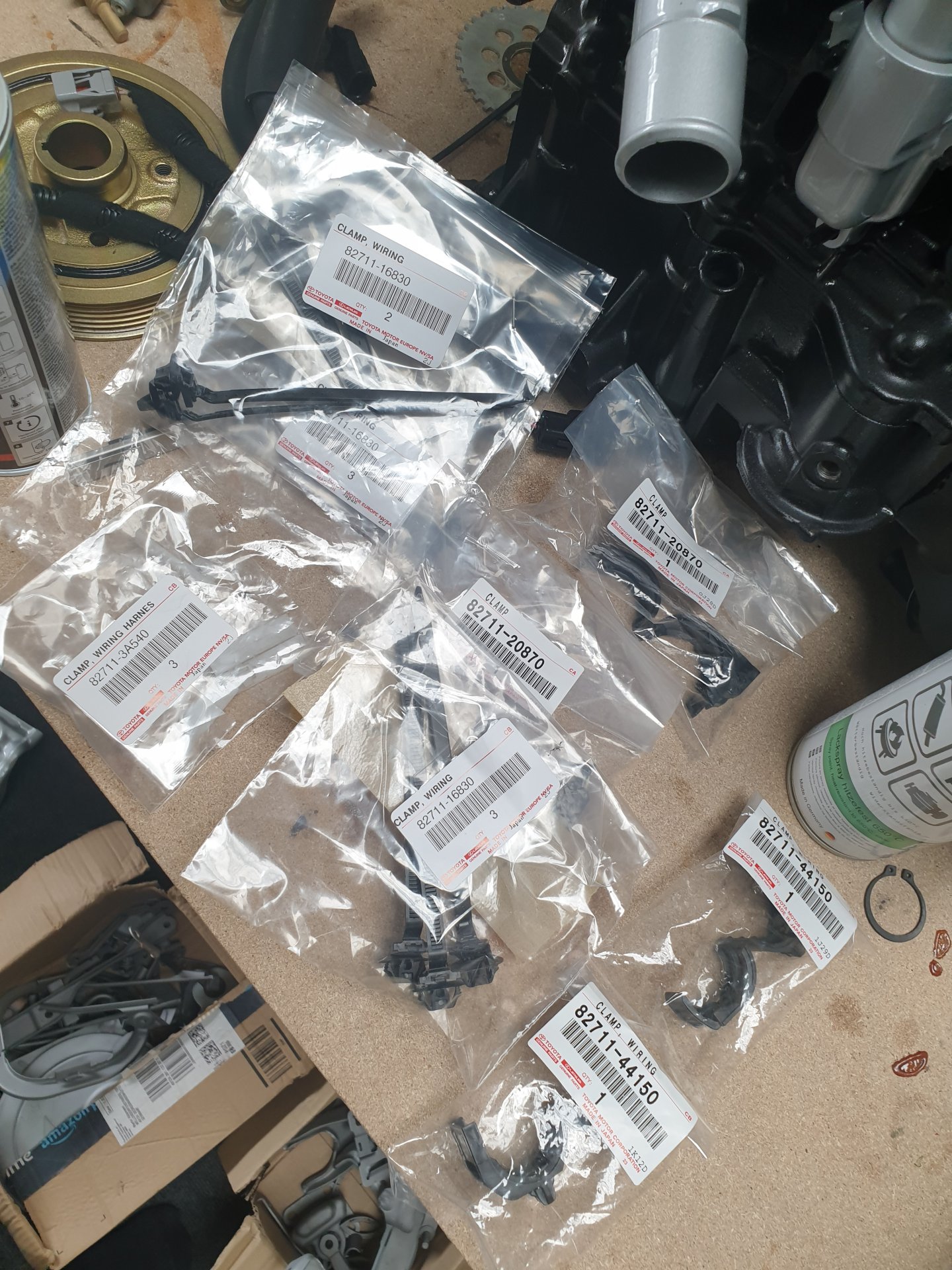

Toyota parts got for me, using number you found. Great to finally have some on the shelve. Thank you for taking the time. I've others I'd like to get my hands on. If you can to find time(PLEASE!), say so. I'll post them up?

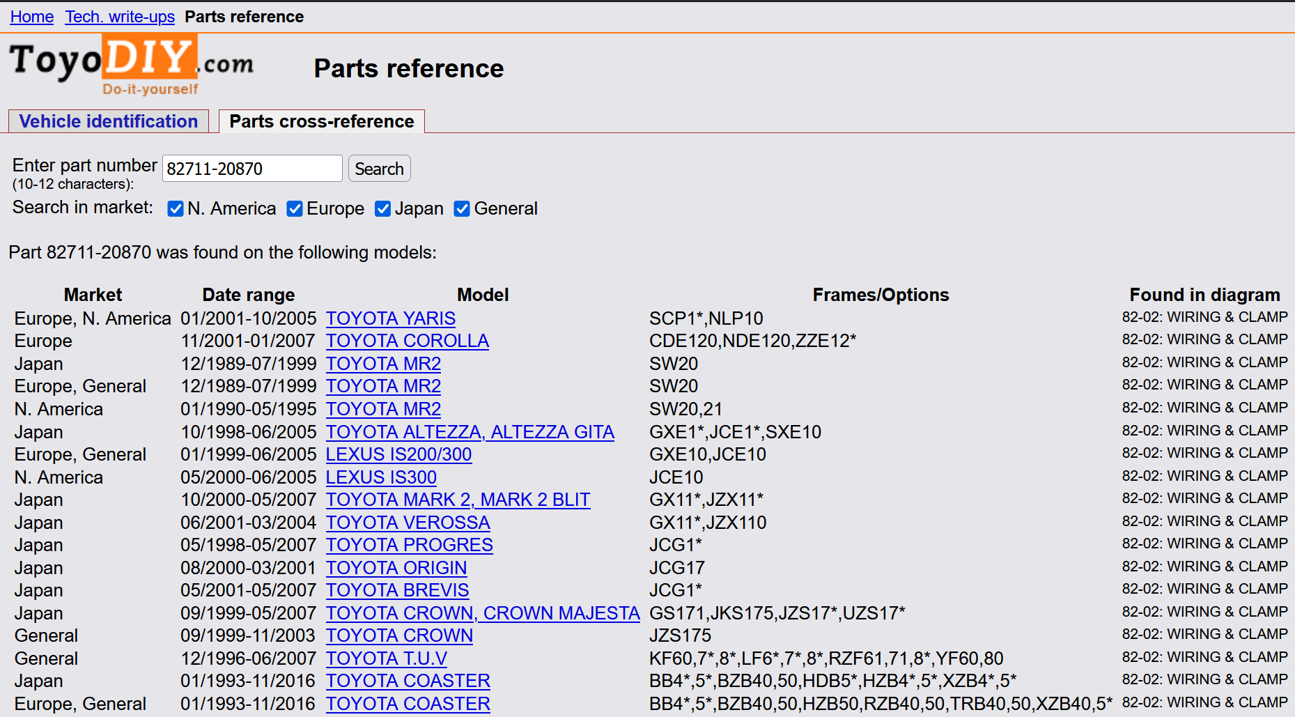

@Andrewzlc100 Part Numbers for Toyota or I am sure other OEM's are shared across models. for example this part number runs for a lot of toyota models. Most likely its not a unique one. here's the link.. and a reference of which Toyota's a part number would work across.. Toyodiy.com is your friend.
Yes, the shops also offer a similar search if you enter the part number so that all vehicles are listed. but only the vehicles where Toyota wanted you to be able to buy it from them. there are not all vehicles where it was installed that would be even more.
Absolutely these part # numbers are used across other OEMs. I use SnaponEPC, which I use for my job at my local toyota dealership. So i'm sure my catalog just searches domestic models. Thats just what filtered out in my catalog using that part #
https://partsouq.com/ is spot on with parts searches similiar my catalog. They even use the same exact diagrams as SnaponEPC
but I will say that is a awesome recommendation to see the part # that cross-reference with international models

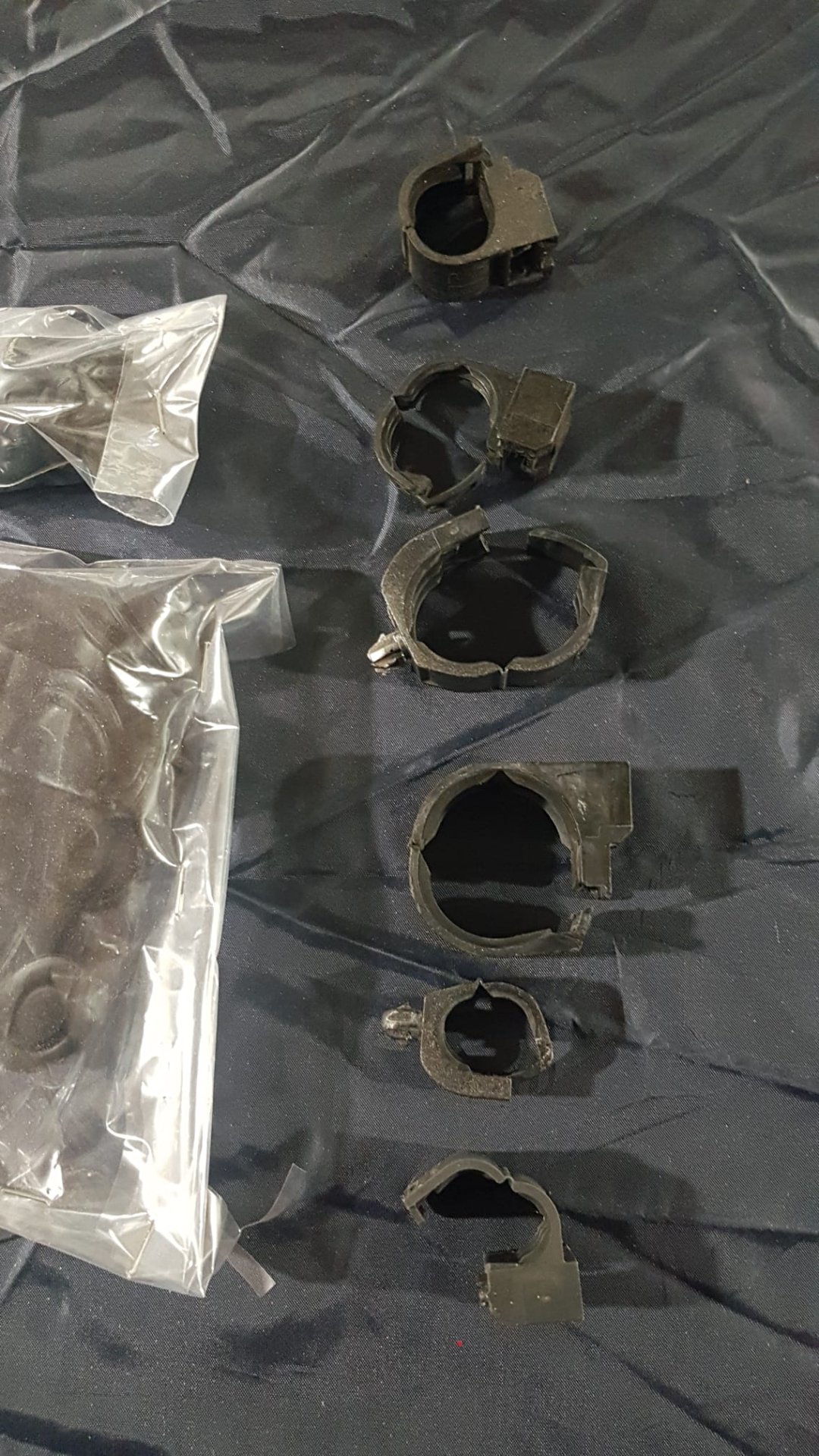

Okay, here are just some I'd love to get PN #'s for?
This is just above BK1 (LH) timing belt cover. 10 over 13 is embossed on it.

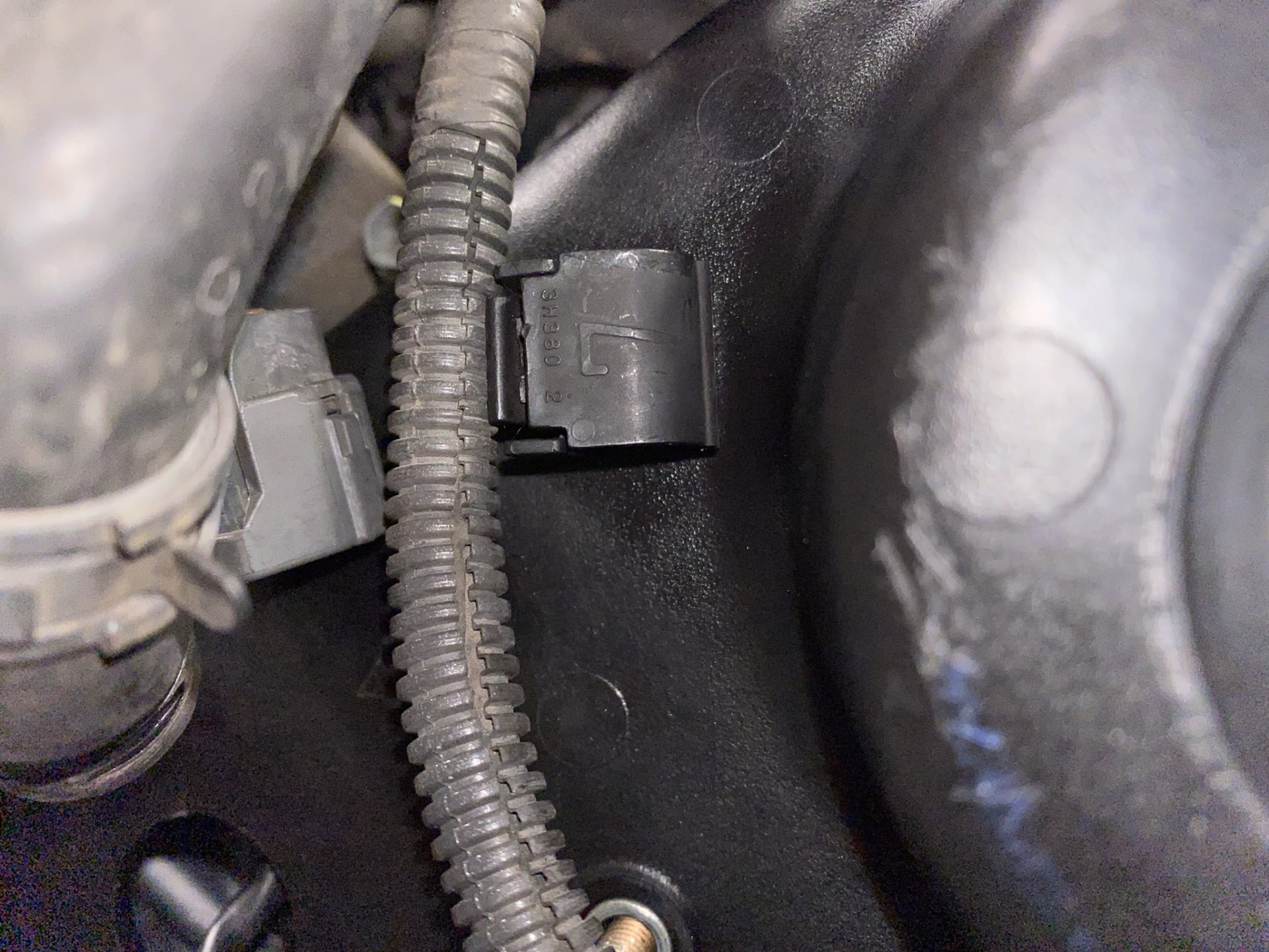

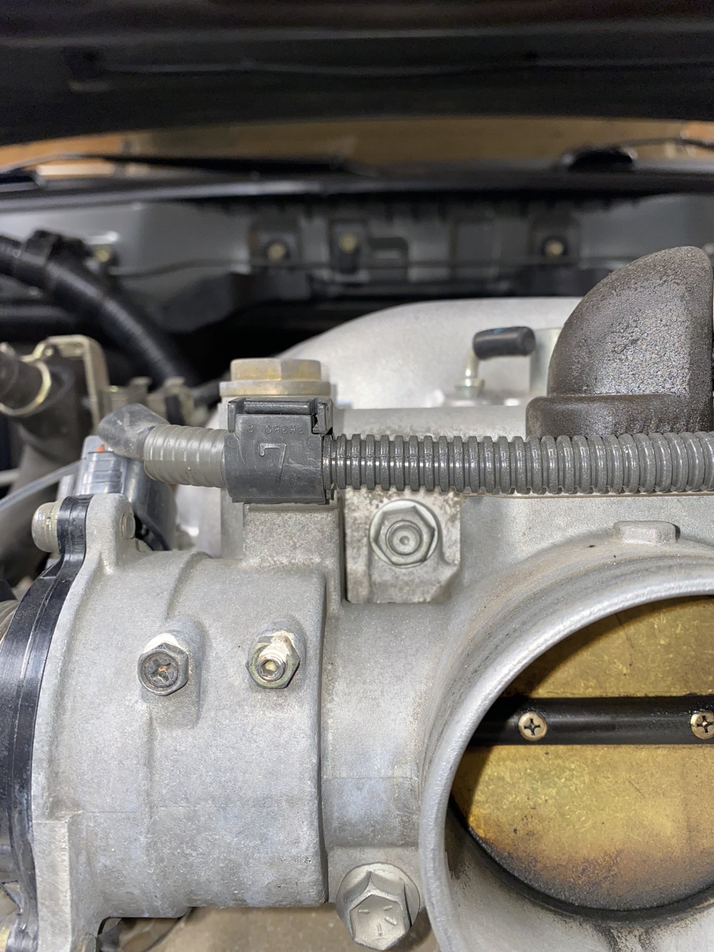

Then, as we work are way down the BK 1 cover, we've 2 smaller ones. Which appears to be same used on 98-02 top of throttle body RH side:
3H380 2 with large 7 embossed om them
So you've purchased and verified 82711-2D350, is the replacement for the 10 over 13 one in your picture (hand)?

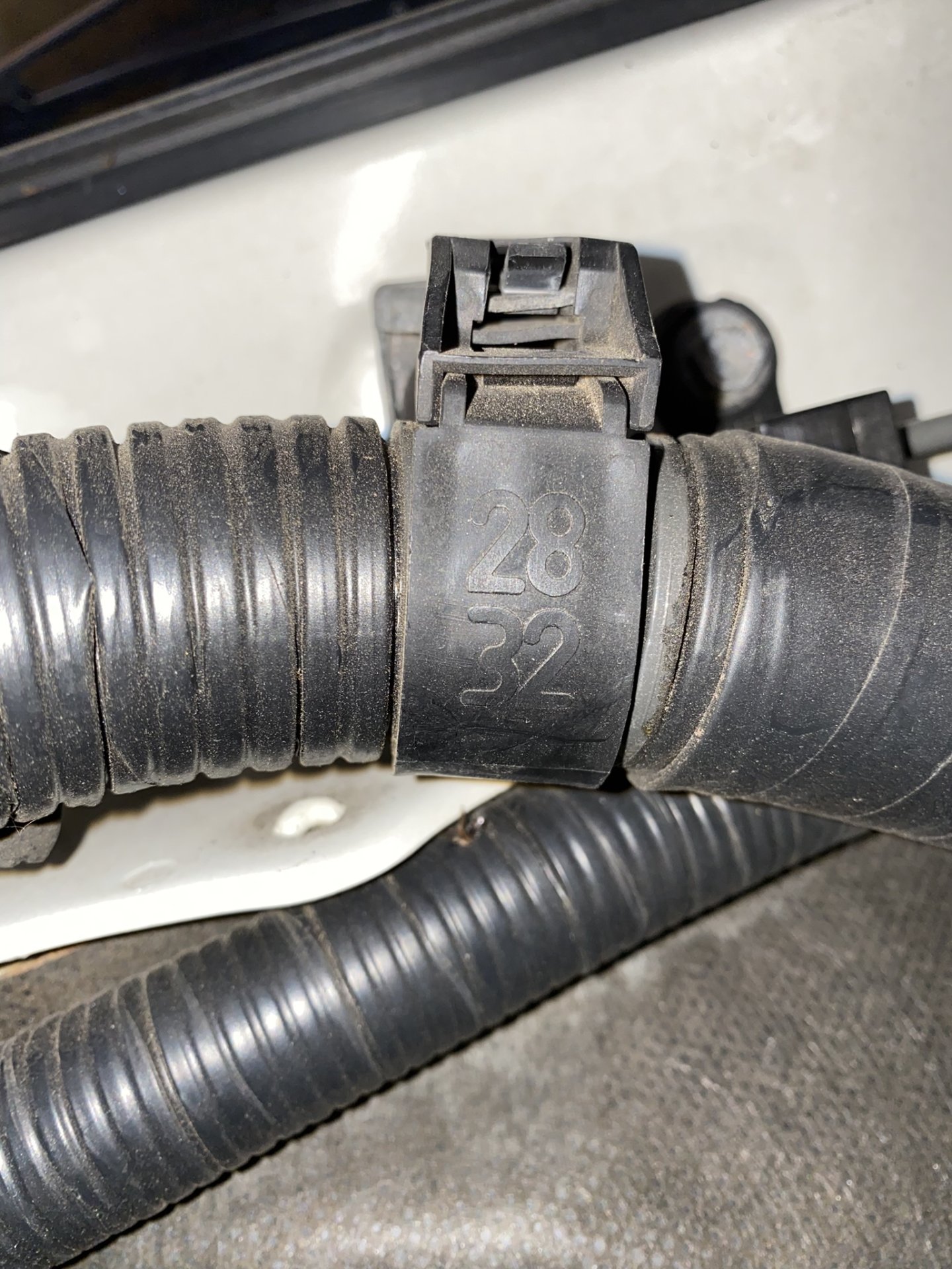

If you look really close the originals have part number stamped on them. So if anyone is still hunting down some clamps we should be able to check and find out .
For example the one on the main harness I am working on is stamped 19 but in tiny letter it shows 2a620.
Sorry if this has already been mentioned just figured I would throw that out there .
Do you recall if any of your clamps have 15 19 stamped on? I can't find a replacement. It's one of the circular ones posted in your pic that is used on the backside of the motor to hold large wire loom in place

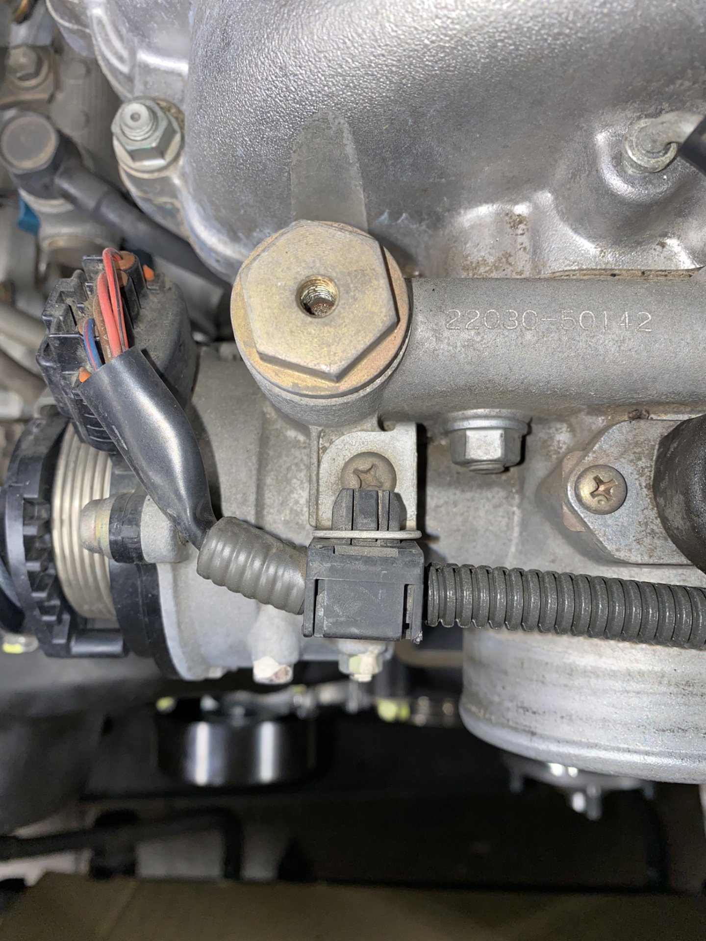

View attachment 3152212View attachment 3152209
Your number 7 seems to have this number stamped 3h380
Toyota 82711-3H380
Toyota 82711-3H380
Thanks.
I'd lost track of this thread. Or I'd reported back found all I've been looking for with the prefix 82711-
