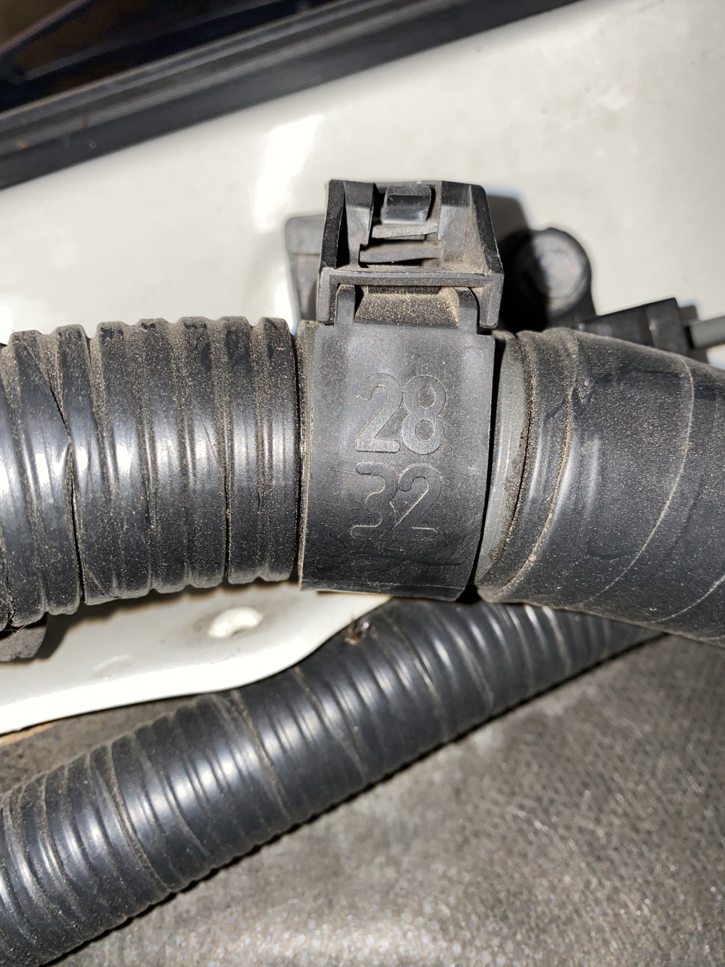

my plastic holder / clamp for the main engine wiring harness has broken - does anyone know the part number for this piece? thank you.

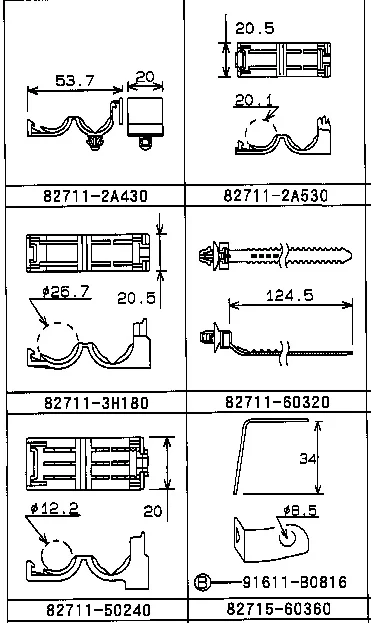

i did not order it , as I do not think it will work . in the diagrams, i think the 26.7 on the part # 82711-3h180 is the diameter. my broken one has a "28" on it, and by my measurements my broken one is 34mm in diameter. I don't think it is available for purchase from Toyota

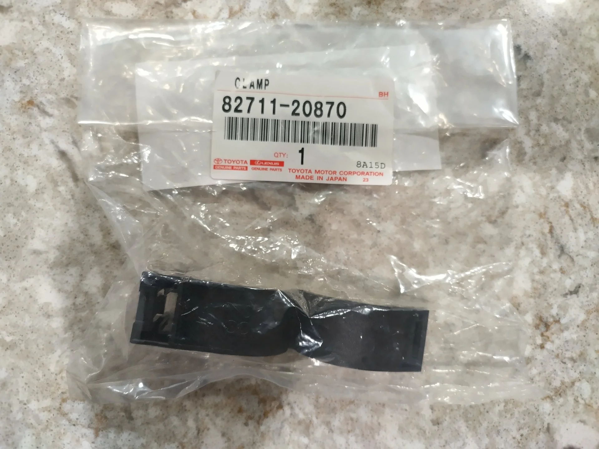

Thoughts on 82711-20870 as a match? Drawings have it at 30mm diameter

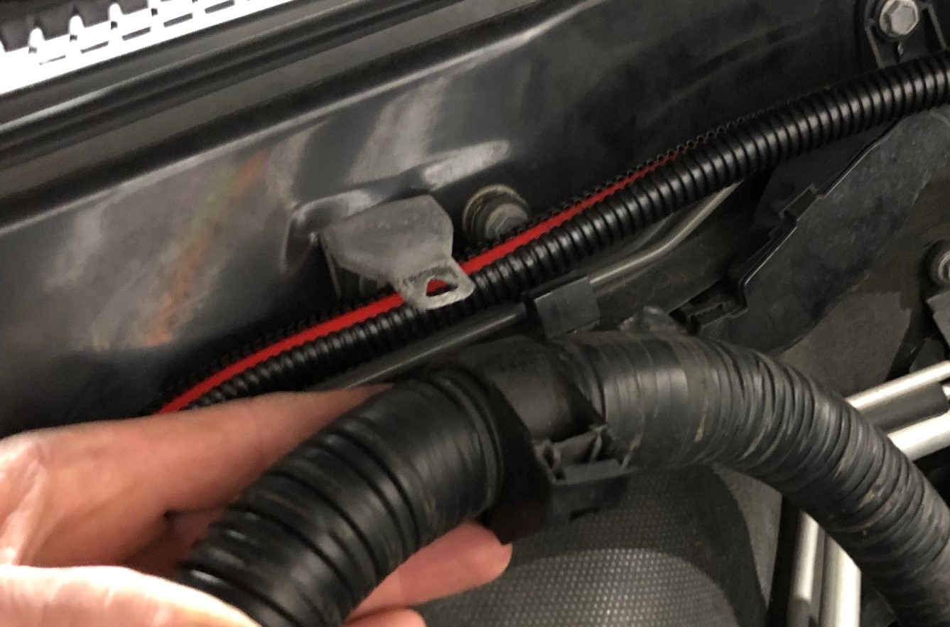

Curious if this would fit? I need to open hood and look closer but just throwing it out there.

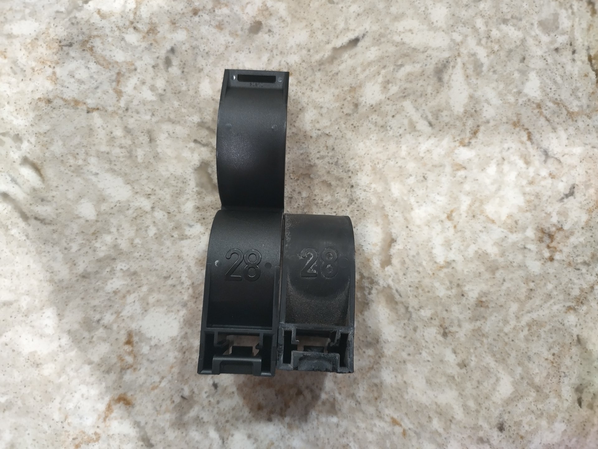

I found that the clamp from a 3rd generation 4runner engine harness works. that is what i used on my LX470
You can't buy it from Toyota (the clamp is only sold w/ the wire harness) , bu 3rd gens are pretty plentiful in junkyards.
I can't find an actual image of it, just the drawing from the parts catalog. I am ordering one up and will reply back here.
I've Ordered one locally, will see!
It is a tight fit, but seems to fit well. This is on a '99. I don't have the front of the original clamp. Does your clamp also have a number stamped on the rear?
Does the 03+ have additional wires in the harness? Perhaps they had to use a larger clamp because of it?
