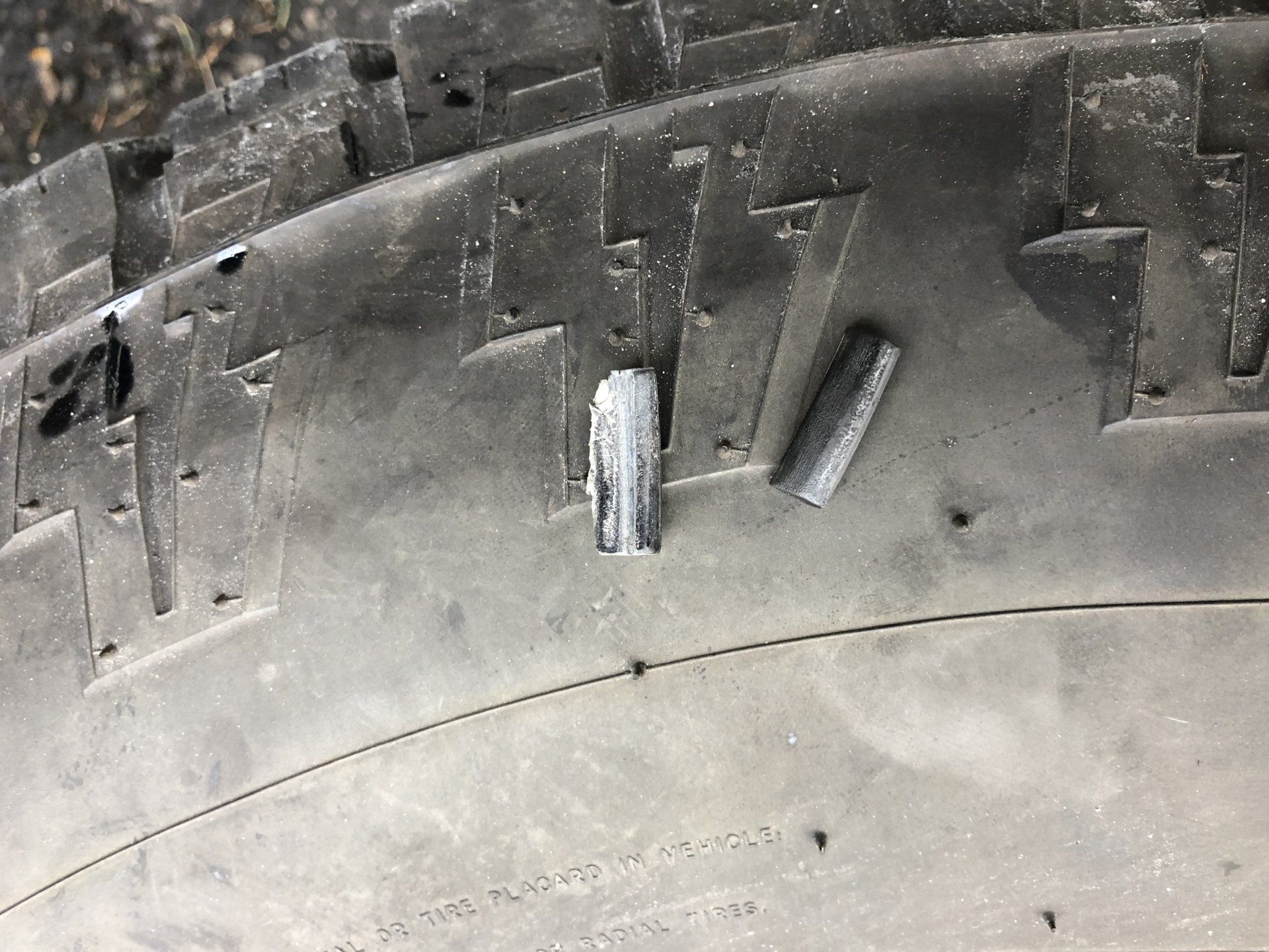

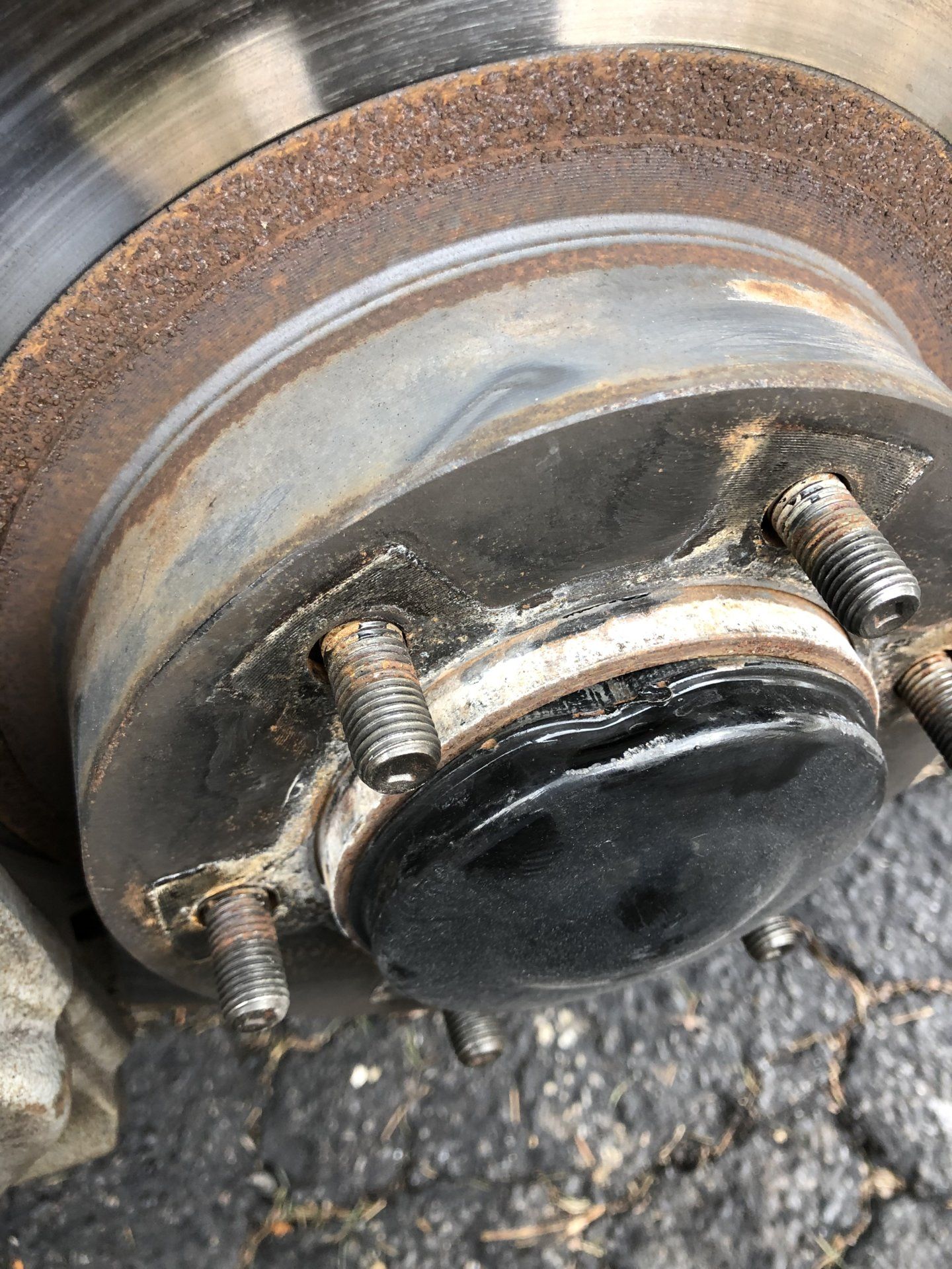

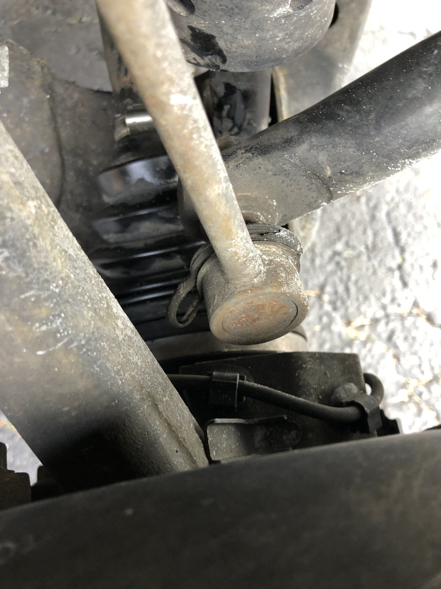

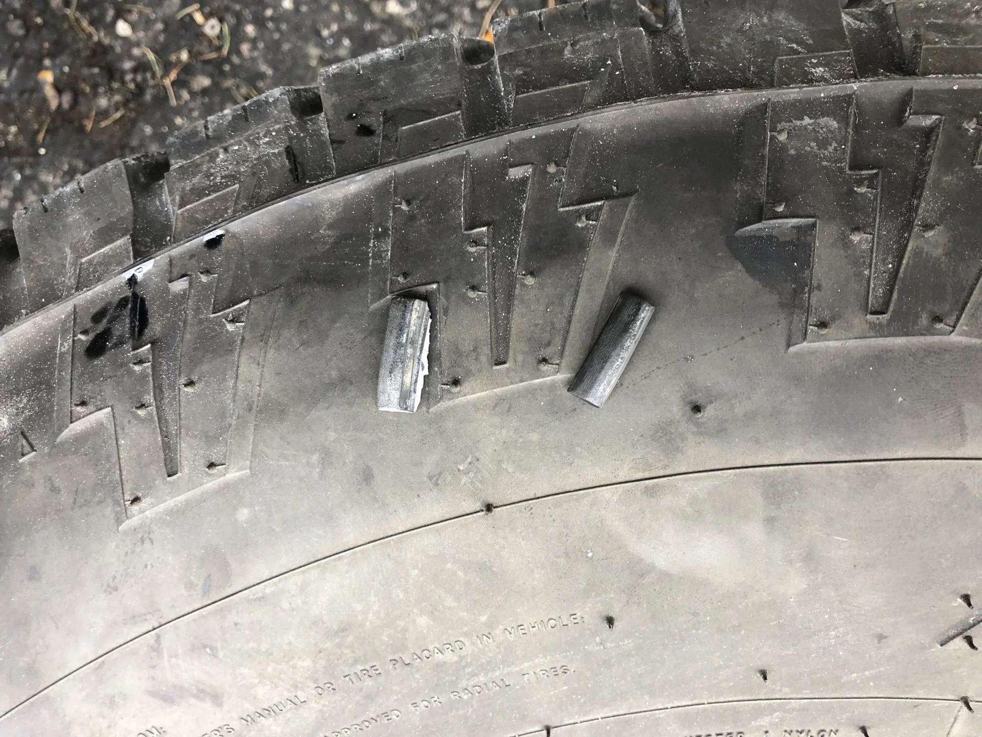

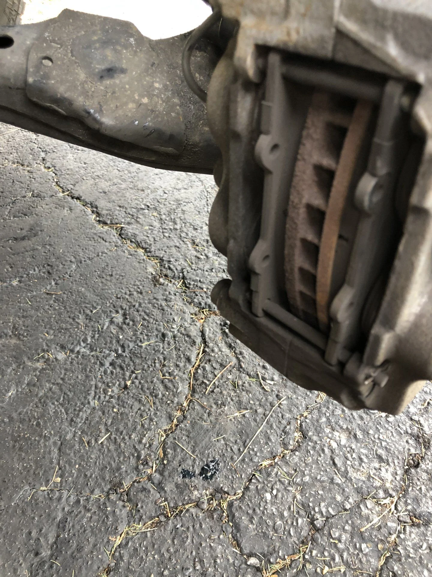

What I did find. Passenger cv had a zip tie around the outerboot on the shaft side. Pumped some grease in there and put a pfran clamp on I had. Found a couple of little plastic? pieces that fell onto the wheel as I pull it off. Not exactly sure what they were. Don’t the brake calipers usually has a spring on the outside? Or am I just thinking about my FJ40 brakes? Dust caps are both very dented from being removed previously, guess I should order new ones. I also think I need extended spline lugs with the 6 shooter wheels that were on it when I bought it.
I have put about 100 miles since I shot some grease and reclamped the outer cv boot. No vibrations or noises. It appears to be the culprit, so I will order some cvjs soon to replace. I never did see any grease shooting anywhere underneath but who knows how long the boot was zip tied.
