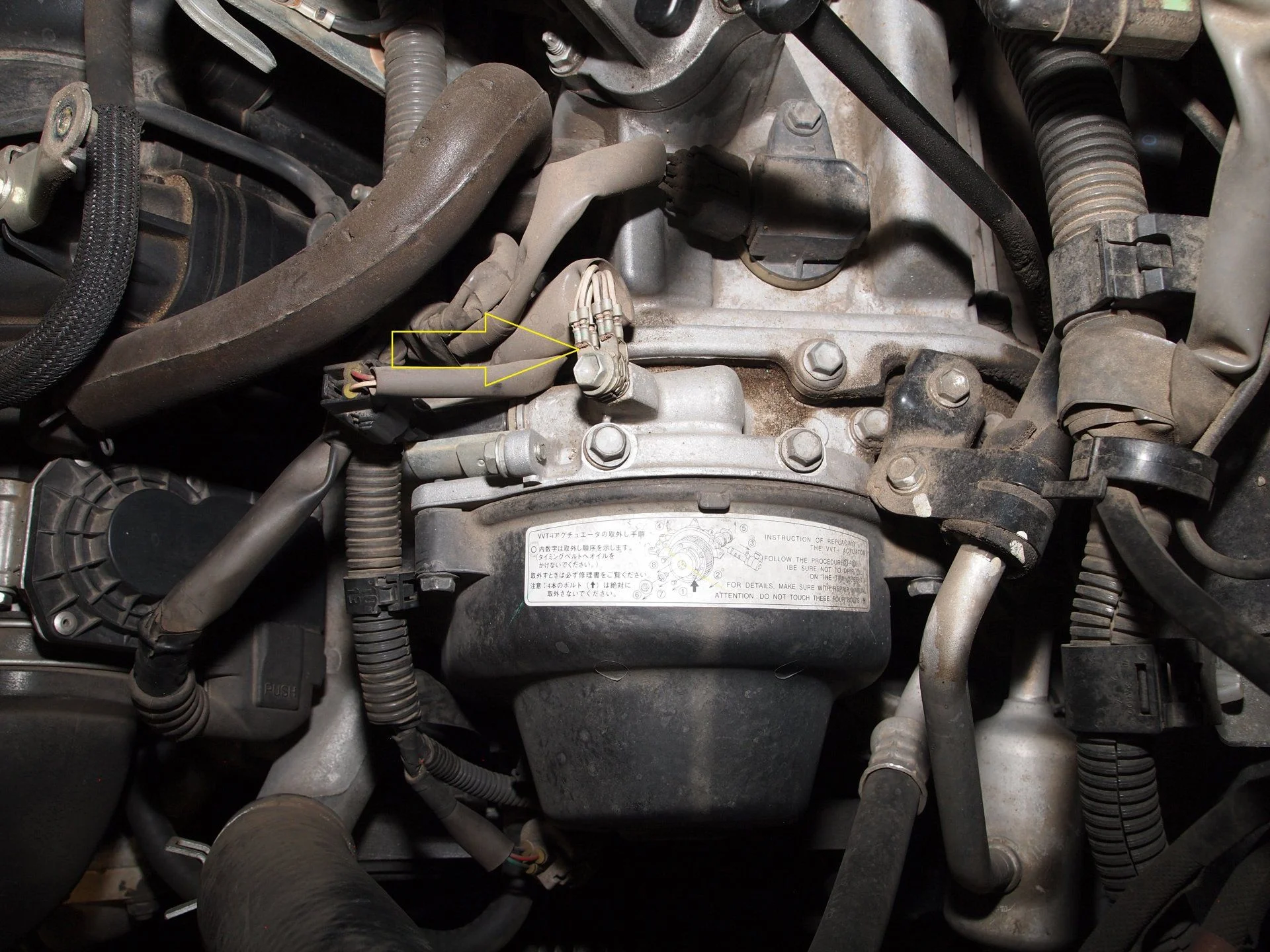

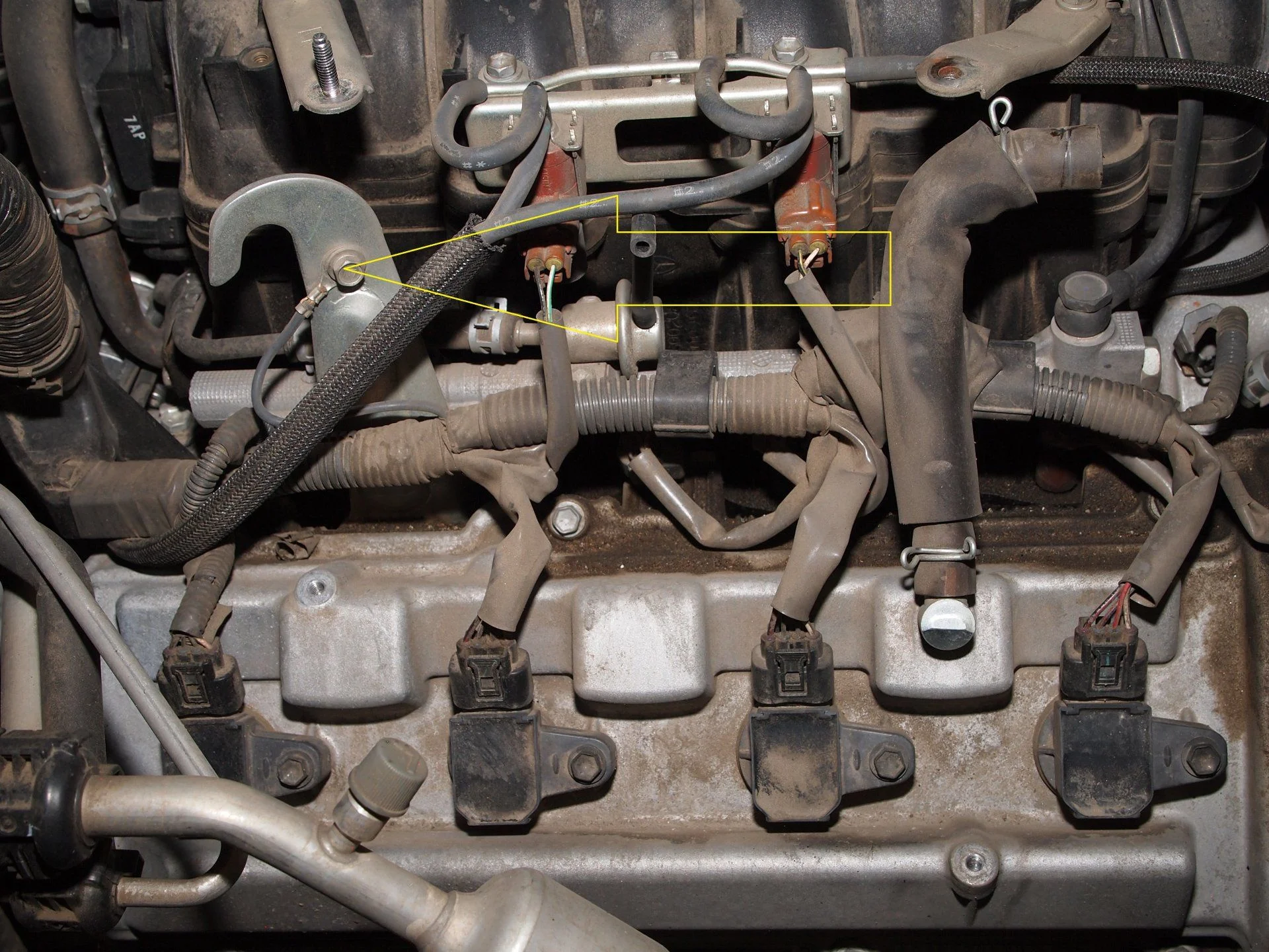

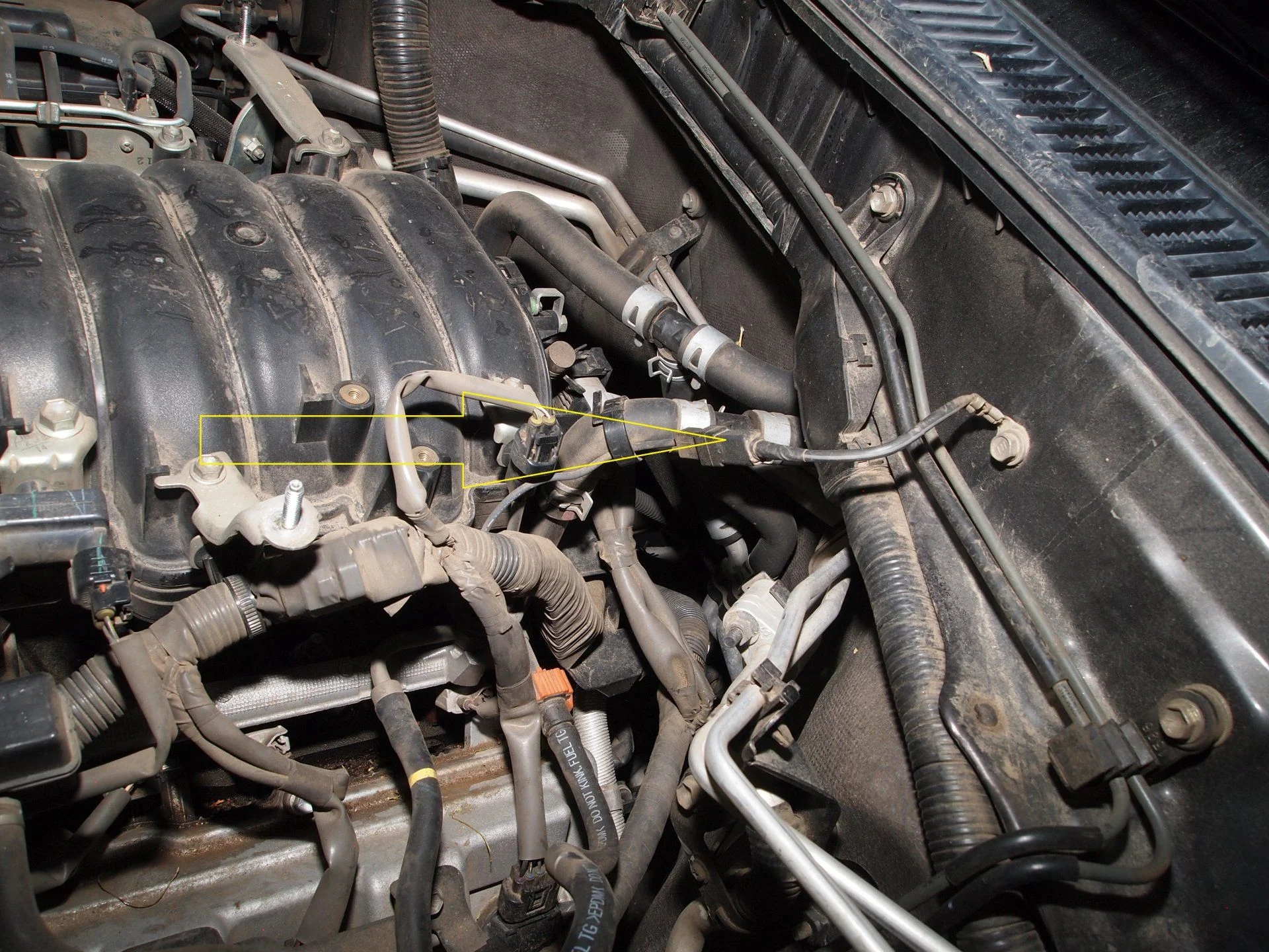

Not sure how many grounds but here's some on the 07:
This one is on both side IIRC
