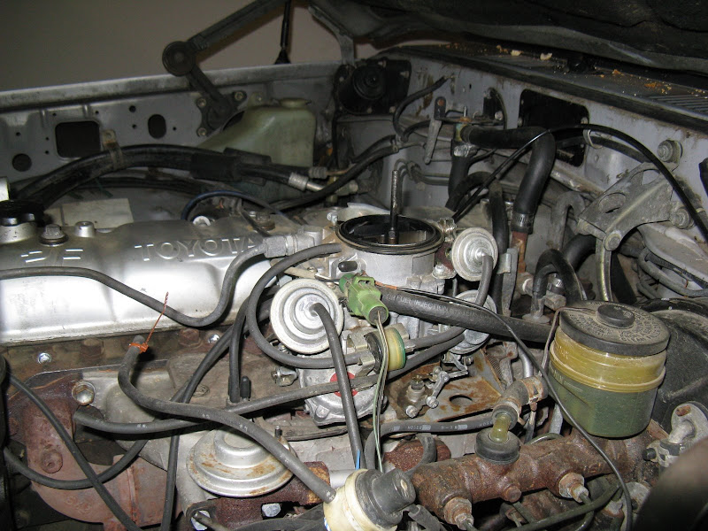

Below is the engine with the stock carb and my hack desmog.

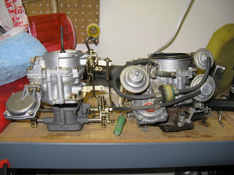

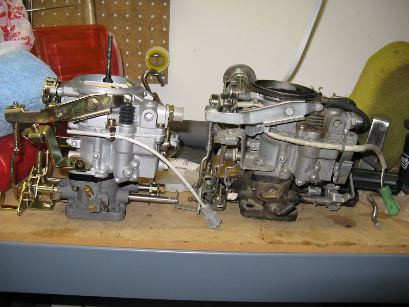

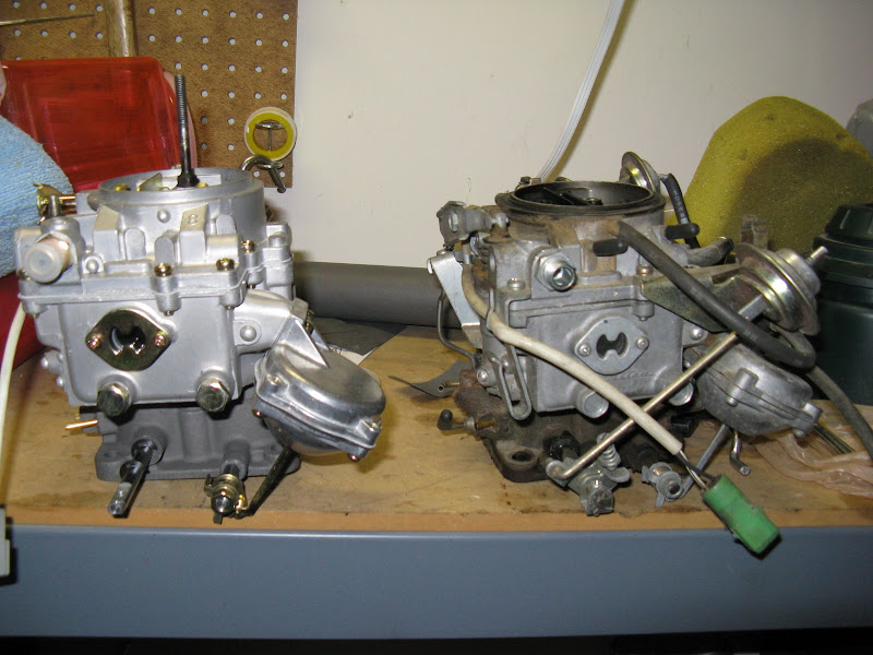

Took the old carb off and set it beside the new one to see the differences (the new one is on the left and shiny :hillbilly: )
Notice the identical linkages but no vacuum pots.
Driver's side view, no choke breaker, no A/C idle up (it is easily transferred to the new carb), and much simpler.
Front of engine view - same viewing window, shaft for A/C idle up, and one fuel line in.
Passenger side of engine view - only 1 vacuum connection, advance for the distributor.

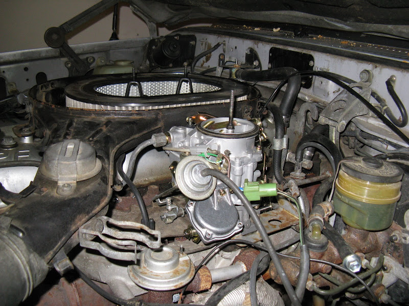

Oh yeah, here's the finished product, sans breather top.
One thing I forgot to mention, is that the fuel decel cutoff switch (the only electronic wires on either carb) don't have identical plugs. The new carb is a 1 wire system, while the 60 is a 2 wire plug. Not a problem. You can either do as I did and make a jumper to run from the 1 wire to the constant 12V side of the 60 plug, or you could switch plugs and make the wire go to the constant 12V. Another option, for those who want to try, might be to swap the sensors. I'm not certain it would work correctly, but might be worth a look.

It appears that, like mine, prior to install you had BVSV1 (top one) hooked to carb and driverside VCV and that you had fuel cutoff solenoid attached to carb vacuum. Can you explain how you deleted these? Does anyone know if you can keep fuel cutoff solenoid by attaching to "gas"filter manifold vacuum? Some specificity would be appreciated.
