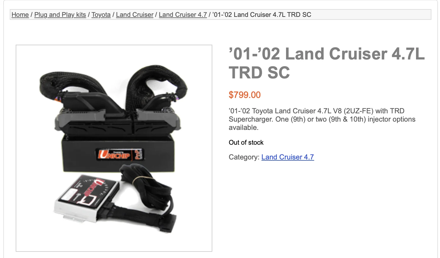

The 10 injector ('03-'04 version) kit will work fine on a 98-02. You just need a different ECU than what is provided by TRD. It has to be set-up for the 10th injector. Try calling Unichip, URDUSA or ???.
'01-'02 Land Cruiser 4.7L TRD SC - Unichip Wholesale - https://www.unichipwholesale.com/product/01-02-land-cruiser-4-7l-trd-sc
