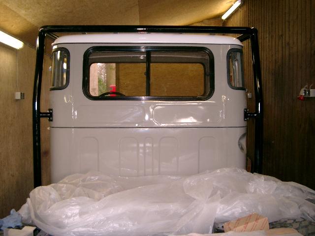

without the cabin
The window is bigger then stock, a Reimo window to slide open. In the cabins front wall is a matching window, allowing emegerncy exit to the cab..

without the cabin
thanks again. i would appreciate a picture of how the cabin is joint together with the cab. i will be doing similar on my build but was considering not putting a window, just open access between cabin and the cab. however i am concern about cabin noise and insulation (there is about 2 inches space between the cabin and the cab). i would prefer and open access, but if i am not able to resolve this issue i will put a window in the rear cab and front cabin.

Hey,
the cab and cabin don´t join, due to the construction of the hardwalled top
accsess from cabin to cab through two matching sliding windows when the top is in upper position
if the cabin has only one single wall the accsess can be left open and sealed by using a rubber profile or rubber tube like a frame around the opening in the cabs back wall and the cabins front. Stil I would use a small door too. So you can lock the accsess to the cabin while parking or when the car is transported on a ferry etc...

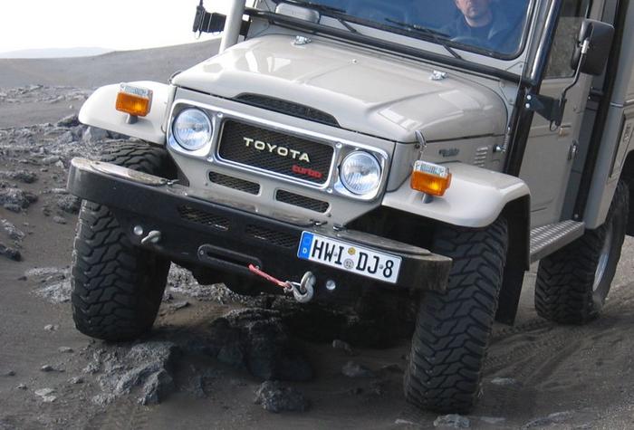

the bumper; covering the body lift, winchmount and storageroom...

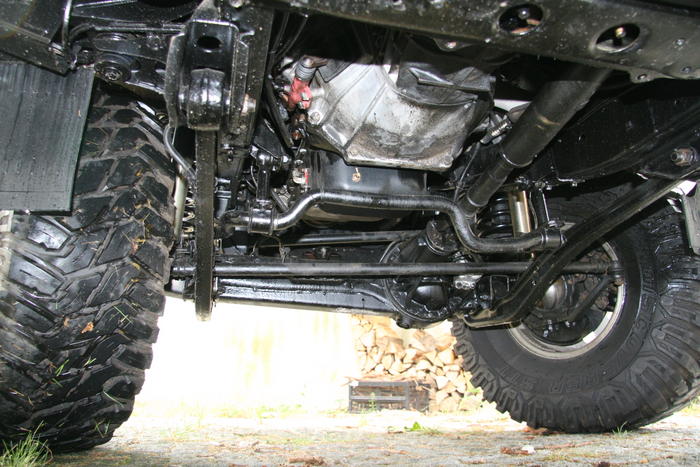

underground:
frontaxel tube is reinforced but still high pinion diff

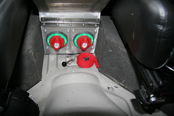

battery and tank switches (box still needs to be painted and the watertanks underneath the seats covered...)
