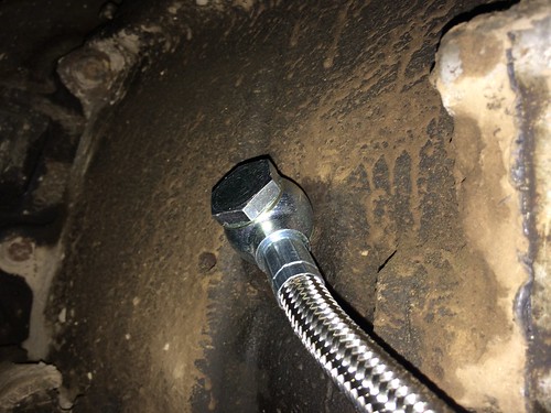

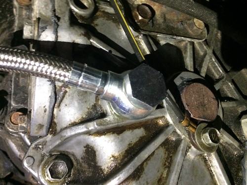

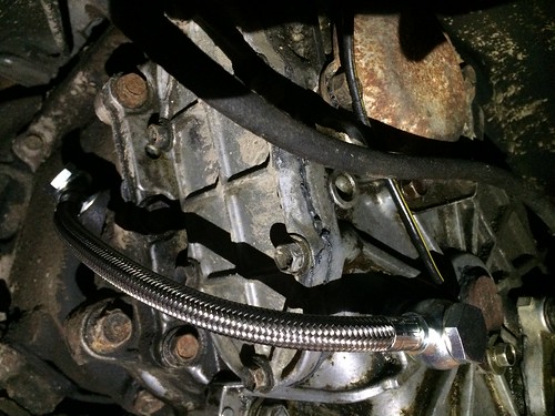

I got the 12.75" for my 1983 FJ60, and it was a perfect fit. Took a few seconds extra to thread in the transfer case end because it had **just** enough length. Lou was super quick and the transaction was perfect. Awesome product. Looking forward to keeping fluid in my transfer case till I can afford a rebuild. Thanks Lou!
