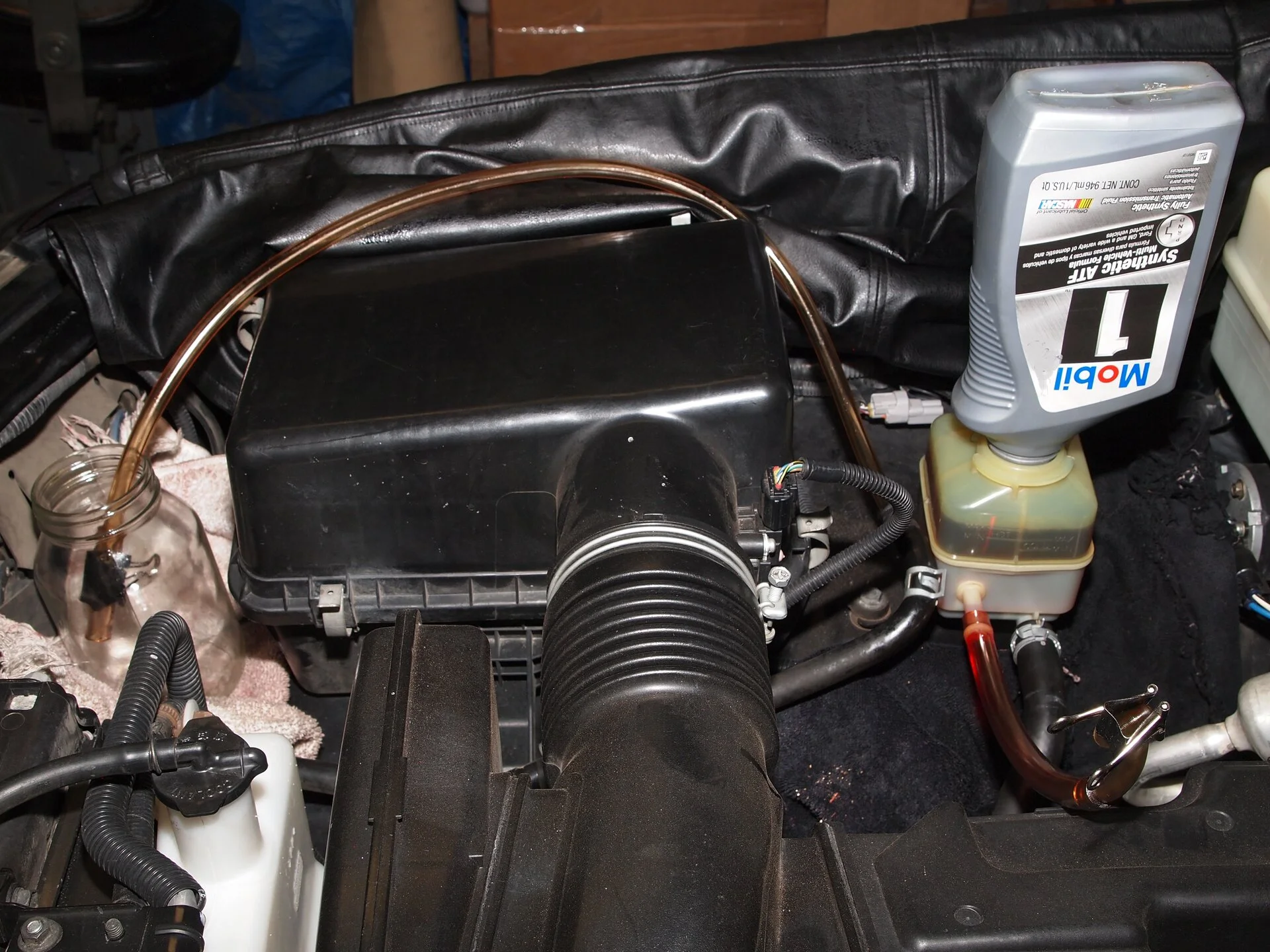

My absolute favorite is: Mobil 1 Muilt Vehicle ATF full synthetic. Use it in all 98-02 100 series. Doing 12 qt flushes. They love it! Also all power steering reservoir.

My absolute favorite is: Mobil 1 Muilt Vehicle ATF full synthetic. Use it in all 98-02 100 series. Also all power steering reservoir.
All 100 & 200 series power steering reservoirs I work on, are that clean ;).
I start by removing & cleaning the reservoir in a sonic-cleaner w/de-greaser. Removing old gunk settlement in bottom and cleans the internal screen.
