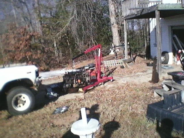

Ok so the wheels are slowly starting to turn on this again. Dohcdelsol and i are going to pull the motor out of the dent in the morning hopefully. I have around 2500-3k budget wise and hope to have enough $ left for a lift and new tires.
1. Should i just bite the bullet and get a kit instead of piecing it together? I have some leaf springs that look to be in great shape
2. What tire would you look at going with? Probably no bigger than a 33" tire. Going to hopefully do a 2" body lift to help with fit!
Now if we run into problems with the rewiring which i am sure i will one of the two may get the axe just depends on finances!

Drive train is out of the dent. Going to pull other Wednesday hopefully!
going to finish it wednesday if it is not raining.
heard it is gonna rain wednesday:bang:
Went well today! Got the drive train swapped out and running. Electrical is next! Then as long as brakes are good front axle rebuild then lift and tires!
