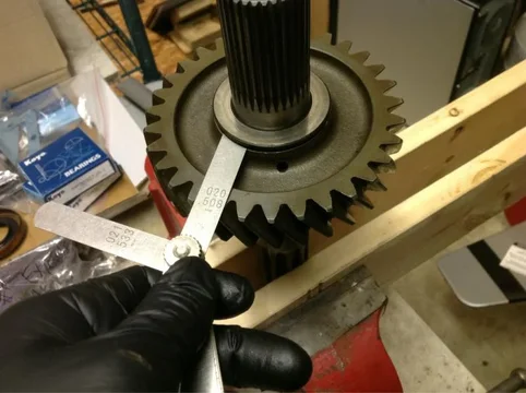

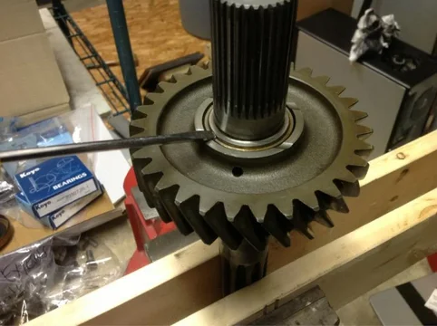

Putting the spacer(s) on the shaft with the gear installed, without the bearing. The spacer bottoms out on the lip of the shaft. The gap isn't going smaller than 0.019/0.020.
Lip
Gap
So I do need those spacers Georg. Question is one or both?
When I check the clearance on the thrust washers to the gears ....... Here's how I do it.
Put the output shaft in a vise. Clamp down on the splines, not the smooth portion of the shaft, especially not the bushing surface. Slide your gear on, then the thrust washer. Then use a piece of 1.5" tubing and push down on the washer with one hand, measure the free play with your other hand.
Using the piece of tubing will allow you to get a true measurement.
Beeper this for the other side/gear as well.
Hth

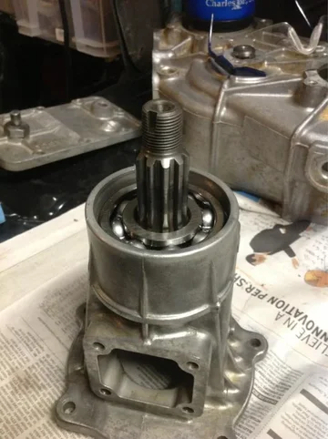

So, next question. I'm trying to drive in the extension housing shaft and gear, to the housing. But, if I'm looking at this correctly from Coolerman, I'm driving the shaft back out of the bearing before it seats.
If I drive it into the housing with the shaft, the shaft falls out of the bearing that I just drove in.
Coolerman shows it this way, in his tutorial 1/3 of the way down the page here.
