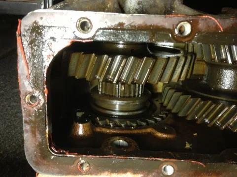

Tearing down transfer case tonite, stuck here:
How do I press this first shaft out without a press and the SST that goes between the gears?

Like Georg said, use a 2x4 to keep the low-speed gear from moving forward, then drive the shaft and high-speed gear out the front using a dead-blow hammer.
I've seen him do it. It's not a job for the shy.
Ok I got it out - the main shaft. However, what was not clear in reading the threads posted here was the fact that the small gear was needing to come out of the bottom hole with the shaft. Once I figured that out it took a few blows with a dead blow. The threads helped, but didn't make that clear. So I'll clarify.
Small gear sticking out of the hole.
Shown from inside - note small gear sticking out hole.
Support the large gear - that is what you are separating.
Great pictures and explanation!
