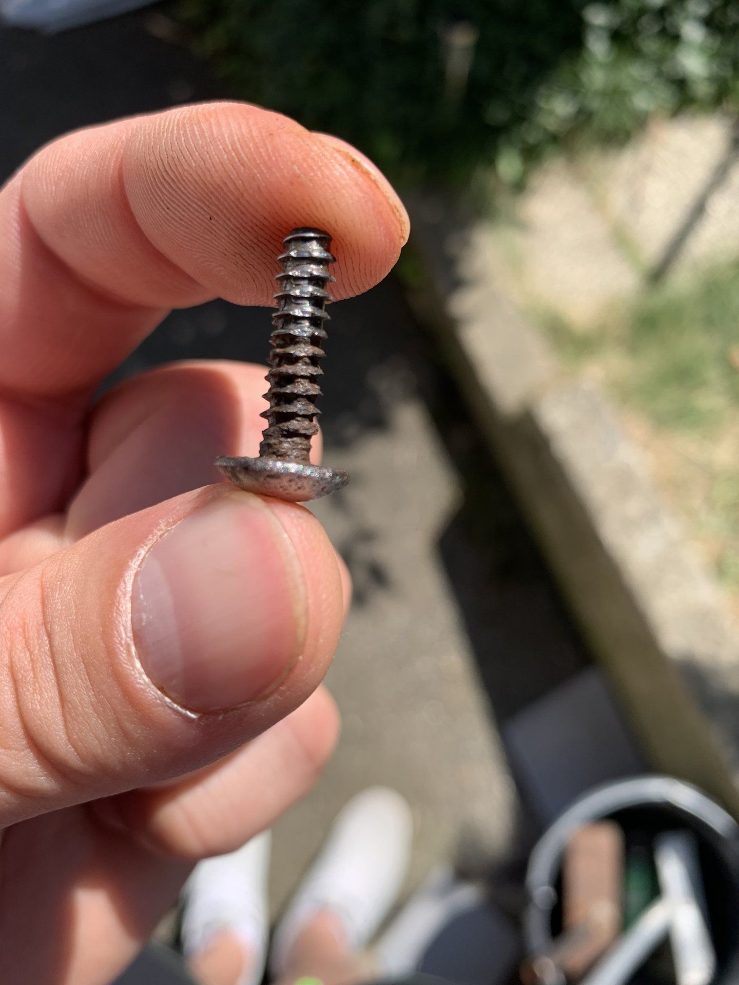

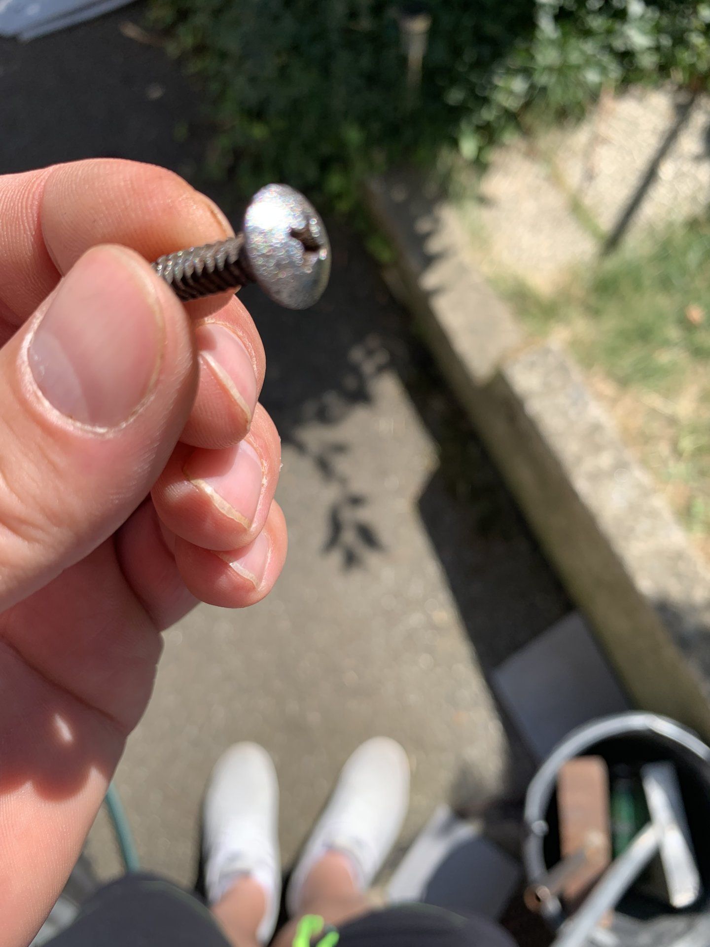

Anyone know what the exact name of this screw is? Screw on the actuator housing cover, which also holds the metal plate. Where can I find one? The old ones are very rusty and scared won't come out next time. Maybe someone knows the factory toyota oem number?
Thanks for the help!
I hear you on that. Probably the only janky Toyota fastener on the vehicle. I would find something with the same thread pattern with a better head (not Phillips). Stainless if possible. Use a washer if needed. Can be slightly shorter, but not longer.
Go to Fastenal or Parkrose Hardware type of store and match up the specs. No reason to get hardware from the dealer unless it's a single use bolt like a head stud, etc.
