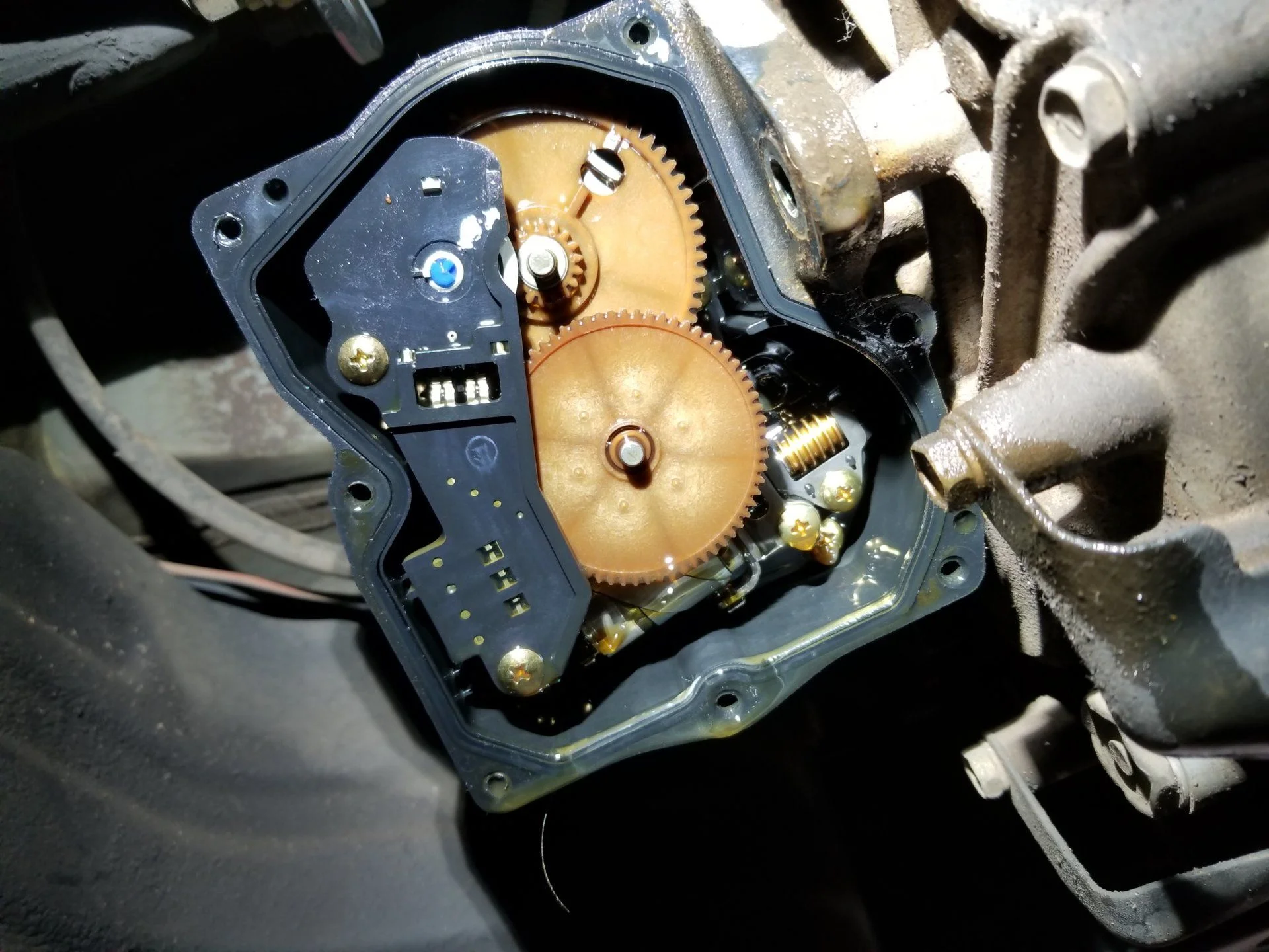

Just an update on mine - the amazon seal I linked to earlier in this thread was incorrect (too large). Reassembled it with just the larger Toyota o-ring installed and now the flashing CDL won’t go off, despite a number of attempted fixes and much research. I may have reassembled it incorrectly, so I’m going to order another seal (original pn was Nok 6810) and see if next time I can find where my reassembly went wrong. Any pointers welcome.
needs retimed .notch on blue sensor on left goes to just below bolt hole upper right . gear to the left lines up with pic ... lower gear does not matter .. take out all parts and reassemble to match pic
1923907

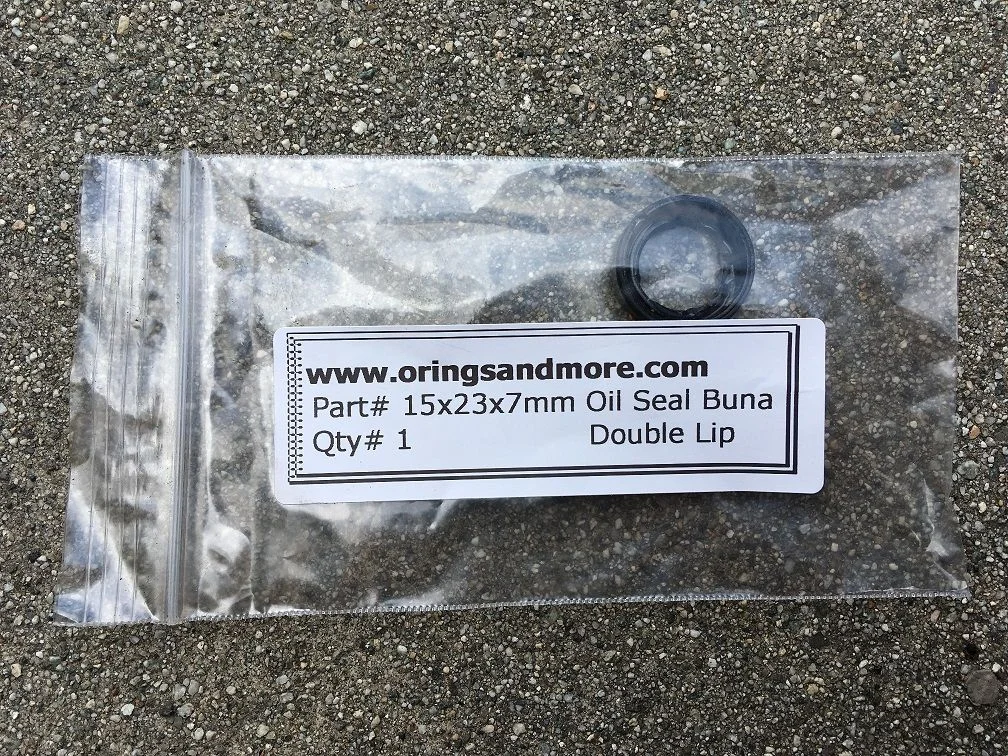

Upward and onward - Still haven't replaced the smaller seal so when I opened the actuator, still got oil leaking.
As an alternative to the smaller Rocket Seals part, I just ordered this for $5.55 including shipping off Ebay: 15x23x7mm oil seal:
Will report if its a good fit.
