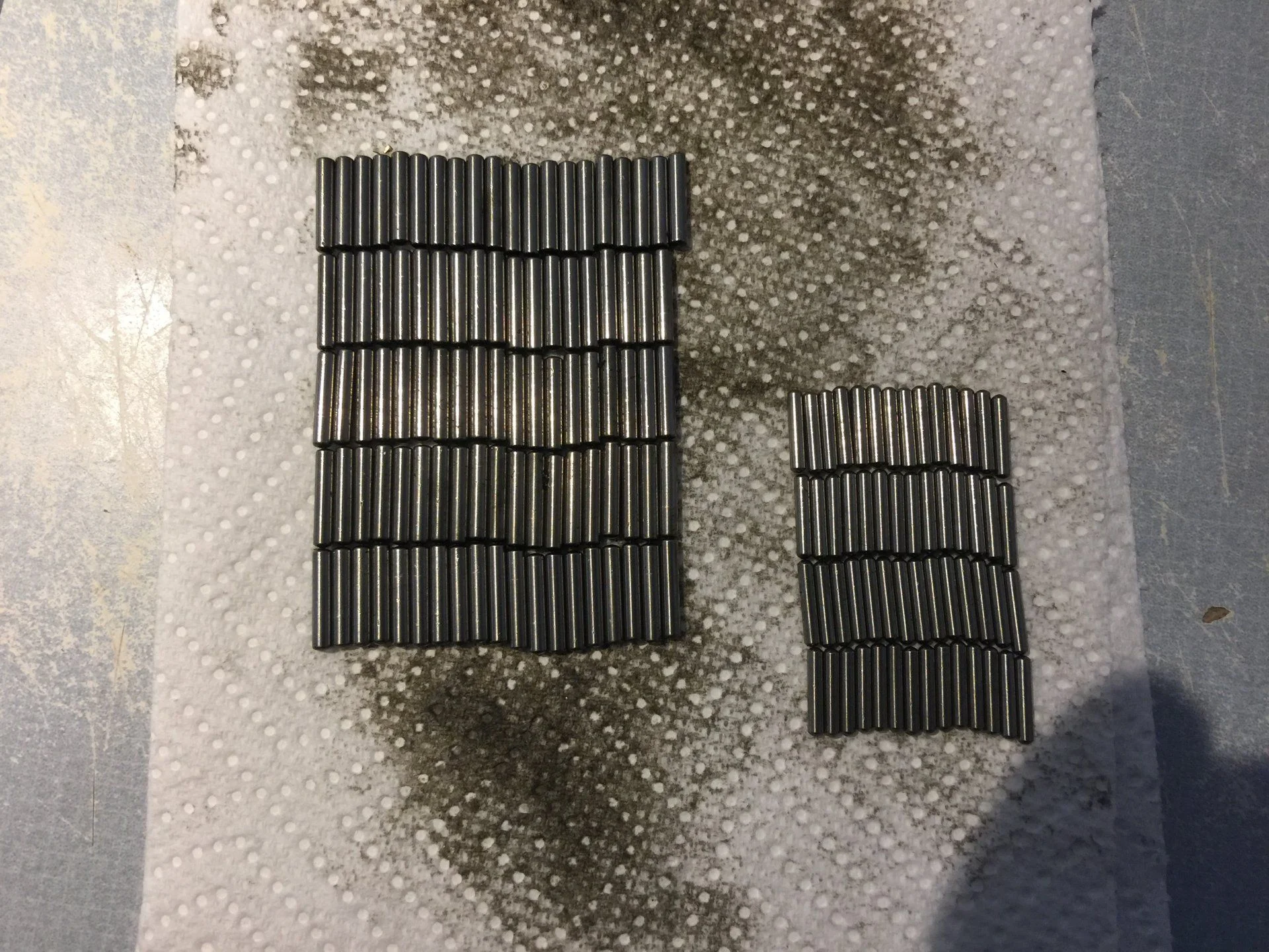

You can get the T-case kit and a basic gasket kits for the 3 speeds from most of the Vendors that support this forum. However, the 3 speed cluster gear shafts are getting harder to come by and you’ll have to get the needle rollers form overseas...can’t buy them in US and longer. Those are the 3 speed parts you’ll really need. The large group in the photo go to the cluster gear and the small group go to the reverse idler gear.
I got new needle the rollers from a bearing house in the UK...I’ll see if I can find my original order and post here.
