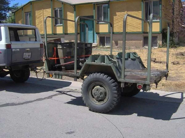

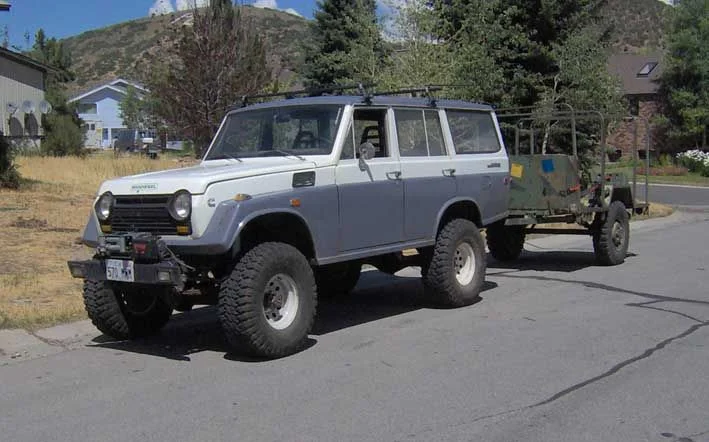

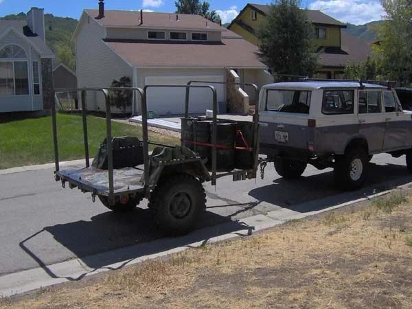

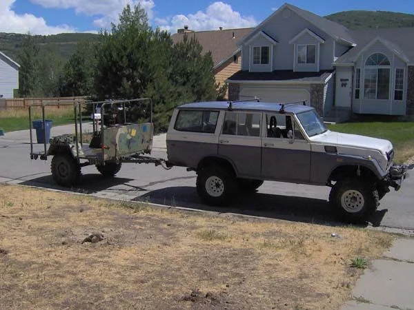

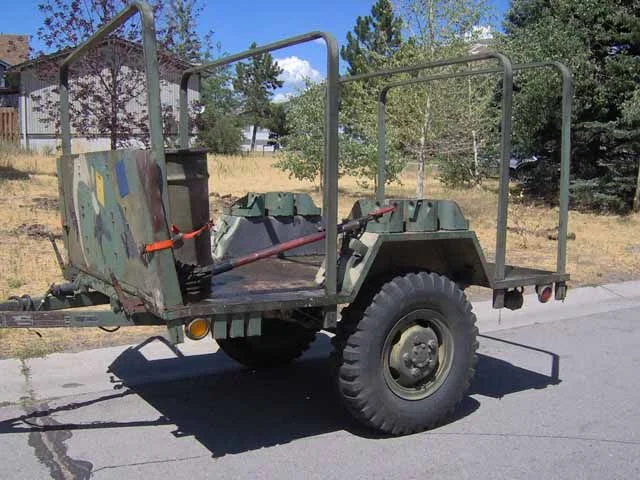

I like the size of my trailer. I'm not sure what it's from, I think an old PowerWagon or Willys 'cause the axle that was under it when I bought it had left hand threads on the driver's side...an old Mopar thing ( I think)
It's a little over 4' wide and 7' long. A perfect size for what I do, I changed the axle out to match the track width of a 60-series, to lighten it up a bit and due to the unknown condition of the axle that was under it. (had a third member with no pinion and a chunk of tire wired into the pinion hole to keep the fluid in.)
I put an aluminum rack on the front, a tool box sits there and I can also fit 4 jerry cans, a shovel, hi-lift, and a beverage cooler resides there also.
I added a reciever hitch in between the front frame rails, and can put a bike rack in it. I had a tire carrier mounted there, but it broke off on one of my shuttle trips. I then moved the spare to the tail gate. As you can see in one of these photos, it sheered off too.
I am getting ready to re-vamp it this month. Plans are to add Heep-style fenders, and step/racks fore and aft of the fenders. Move the front rack forward 6 inches and mount the spare to the front of the tub, sitting on a cross-member and use a 45LV spare tire wing nut. Not sure if I should put one or two spares on it. I will add a rear receiver too and I'm also changing out the springs and hangers, the thing bounces about a foot off the ground when it's empty (hence the two busted spare tire mounts) I know I could slow down, but I get into 'rally mode' when I'm out in the desert...Oh, I'm also going to bend up some hoops, to hold my new-to-me Bushwakka family tent. And, adding fold up, telescopic stabilizers for all four corners so the when parked and the tent is deployed, the trailer is stable. The list keeps growing but that's it for now.
These photos are old, and I've posted them up before, but they're all I've got.
Dan

I got the new springs, hangers, u-bolts on this past weekend. I think I went a bit on the heavy side...as usual. I put 3500-pound springs on since I still use this trailer to haul rocks/gravel/junk. If it were a pure off-road/camp trailer I think 1500-2000 pound springs and axle would be fine. My worry is, without it being loaded down, the tires will wear out faster. The axle is arced so it flattens out under load, if it's rarely fully loaded then I'll be running down the road on the outsides of my tires...
On another note...my new Bushwakka tent was delivered today! I haven't built the bows to hold it yet, but I will throw it up on my old rack tonight and hopefully get some pictures.
My biggest dilemma right now is figuring out where the hell to put my spare tire. Now I'm leaning towards hanging it underneath. I thought I had a spare FJ55 spare tire carrier, but I can't find it. I'll most likely just build a shelf, like tractor-trailers have to hold it.
