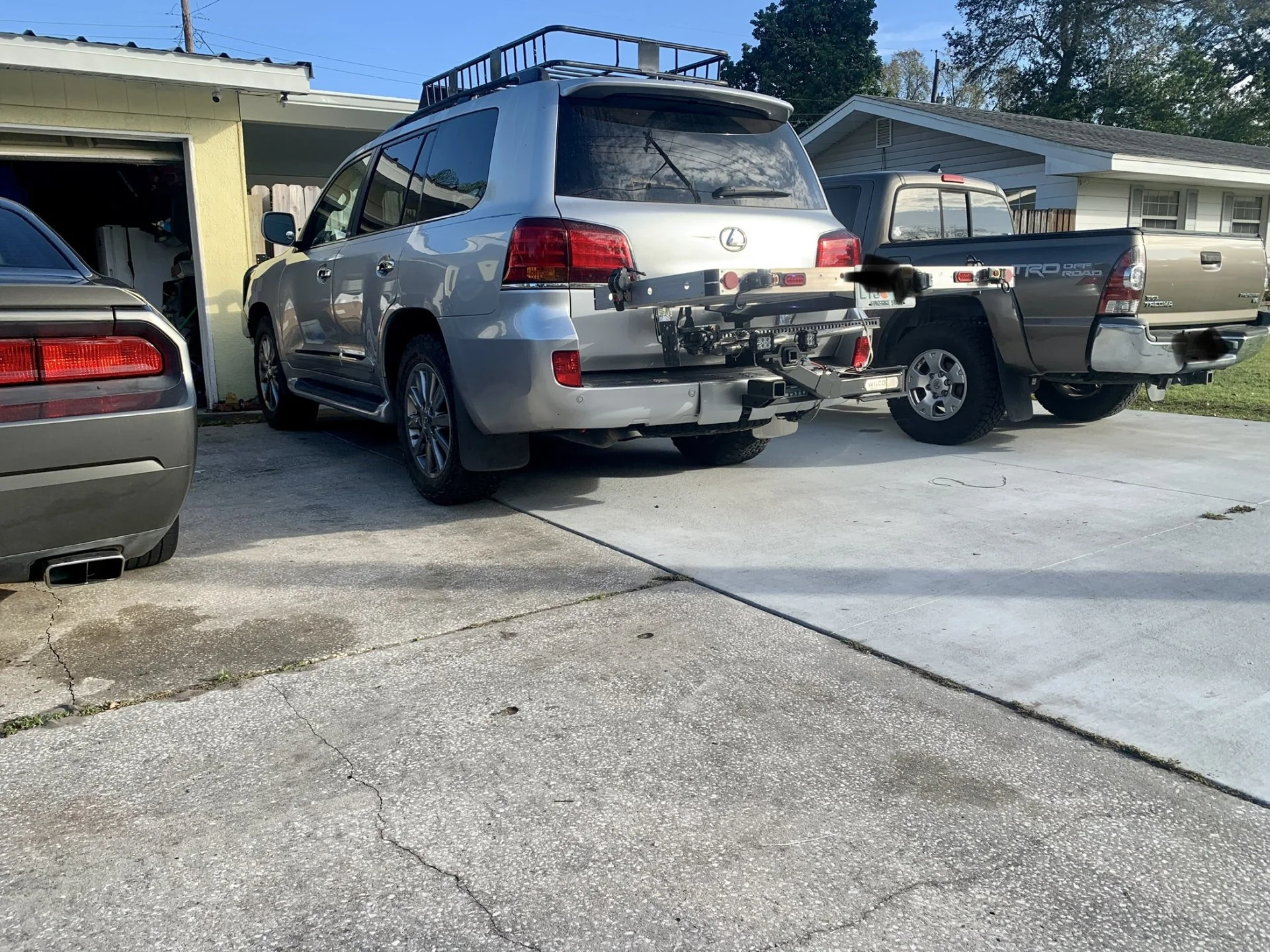

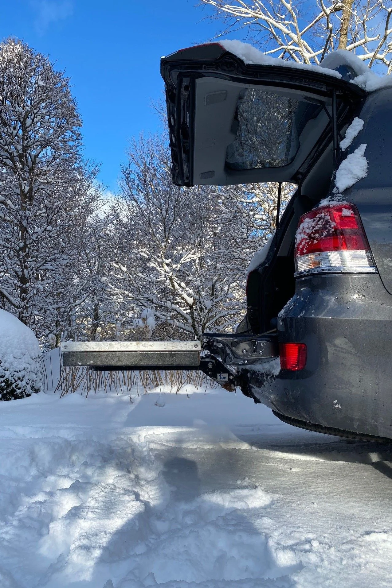

As a new owner of a 200 series (picked up my 2021 in December), I thought I would share something here that I have not seen, and a brief search turns up nothing on the topic. If anyone is looking for a hitch mounted cargo carrier, 1up is worth considering.
I have owned this hitch mounted cargo carrier for a few years and been very pleased with it on my past vehicles. I found out this weekend that it fits the 200 flawlessly. It sits up high, fits around the lower hatch like a glove, and because the hitch uses a friction fit you can fine tune how close the clearances are (it also keep the tray from rattling or rocking, which is one of the reasons I got this one vs some less expensive alternatives). The t-track and tie down options on the carrier also make it very customizable and easy to secure all kinds of items.
The additional capacity allowed my family of 6 to take a weekend trip without filling up every nook and cranny of the LC, and without adding a load to the roof or sacrificing aerodynamics.

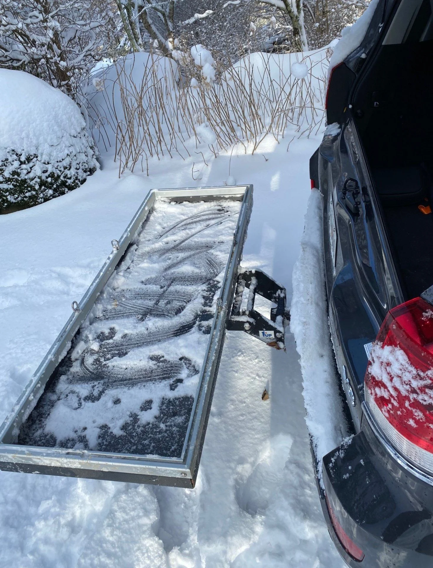

Timely post as I'm working on one at the moment. I've used hitch carriers for awhile now as it's a pretty good substitute for not having a truck. I prefer this over a roof rack as I can put oversized and heavier things like a dryer or large rolling tool chest. While it all stays in the slipstream of the car.
That 1up carrier looks on point and I never knew they even had one! I assume it tilts back and folds up using the same mount as their bike rack?

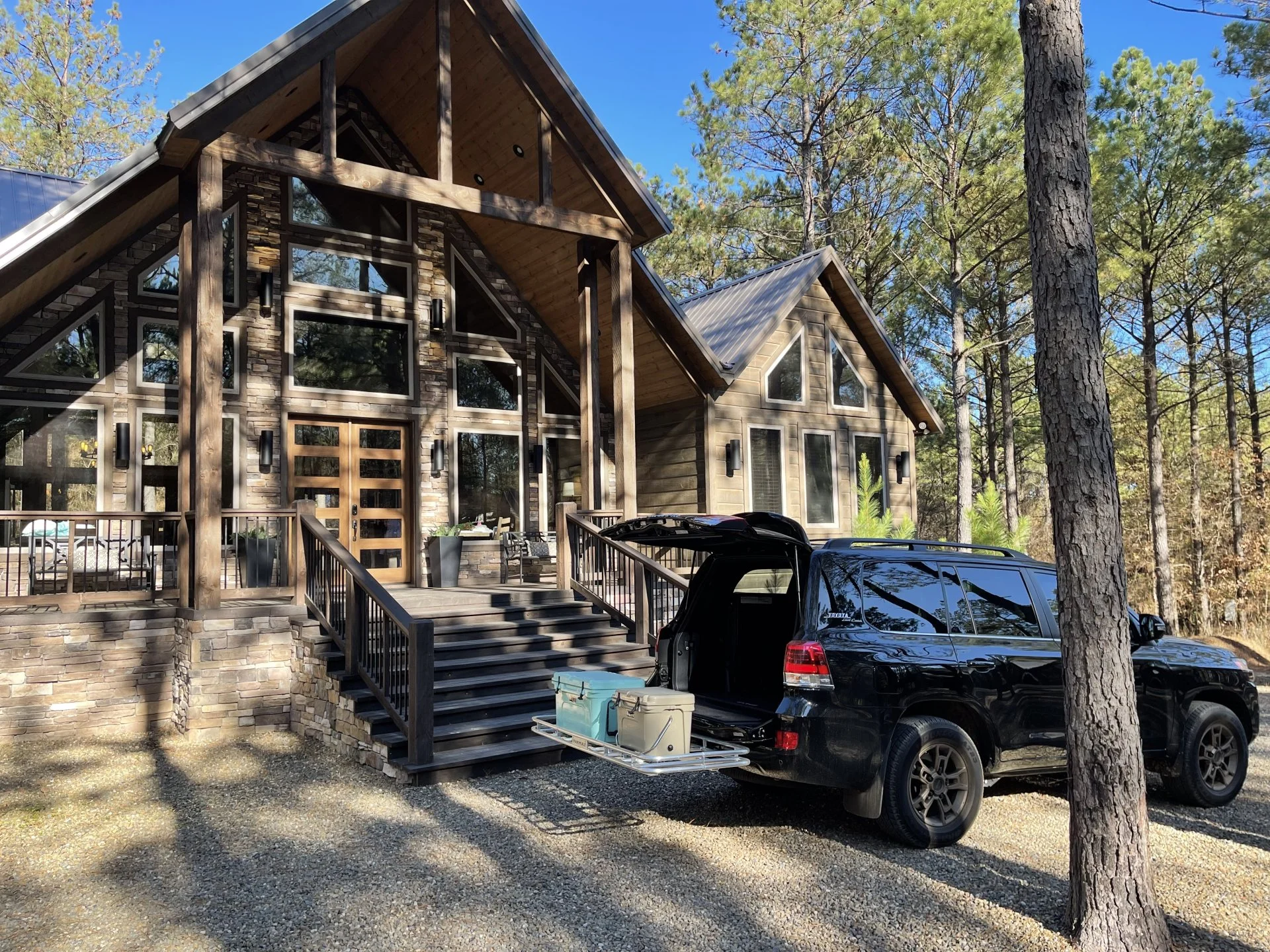

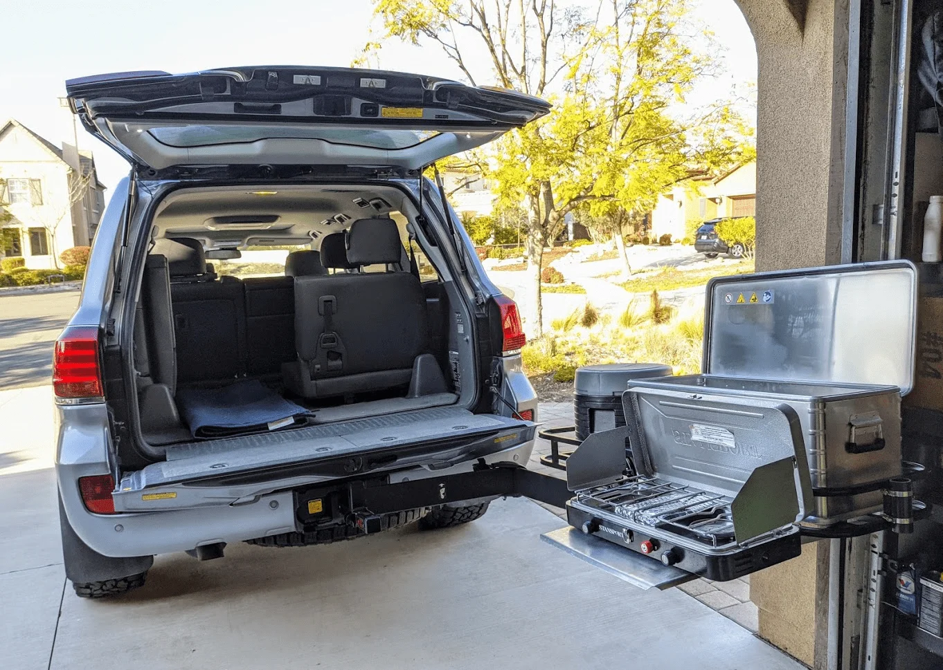

Currently working on a swingout one for overland camping. I don't prefer drawers as I need to keep the car flexible for different uses including hauling lots of people. The hitch mount will hopefully hold much of my overlanding, kitchen, propane, and stuff. While allowing the inside to be clear for sleeping. May enough room to sleep 4 with the addition over a RTT.
Mocking it up with some ugly storage boxes but have a pretty Zarges box coming in. Also fabbing some attachments for a foldout table.

Nice! Yes it tilts and folds on the same mechanism. I haven't ever seen them advertise it, but I found it when looking for ways to convert my roof mounted bike trays to a hitch. They offer it in two different widths as well. You can even add the bike trays off the back of the cargo carrier... could get quite long and unwieldy I imagine though.
And yes I think the hitch offers a lot of appeal when needing to carry more gear. I don't put anything on the roof unless I really have to. The addition of the swing out leaves a lot of room for imagination! I would love to see your finished product.

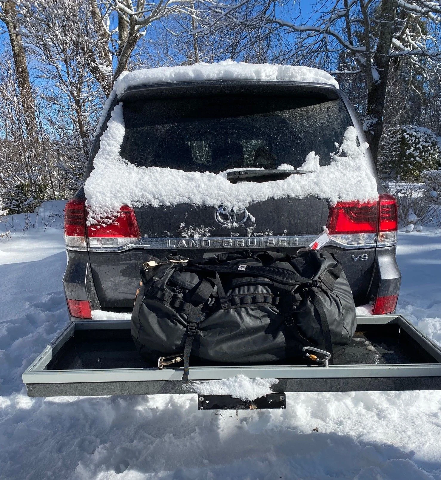

I’ve been barking up this same tree and just doing research. I found Letsgoaero.com had some cool fiberglass hitch enclosures but they are much more expensive than I could justify. Then I saw they have a wide (6’) cargo tray, and what appears to be a pretty inexpensive water resistant expandable bag for that tray.
I was kind of thinking of fabricating a platform for this bag off of an unused aluminum motorcycle carrier I have 🤷🏻‍♂️

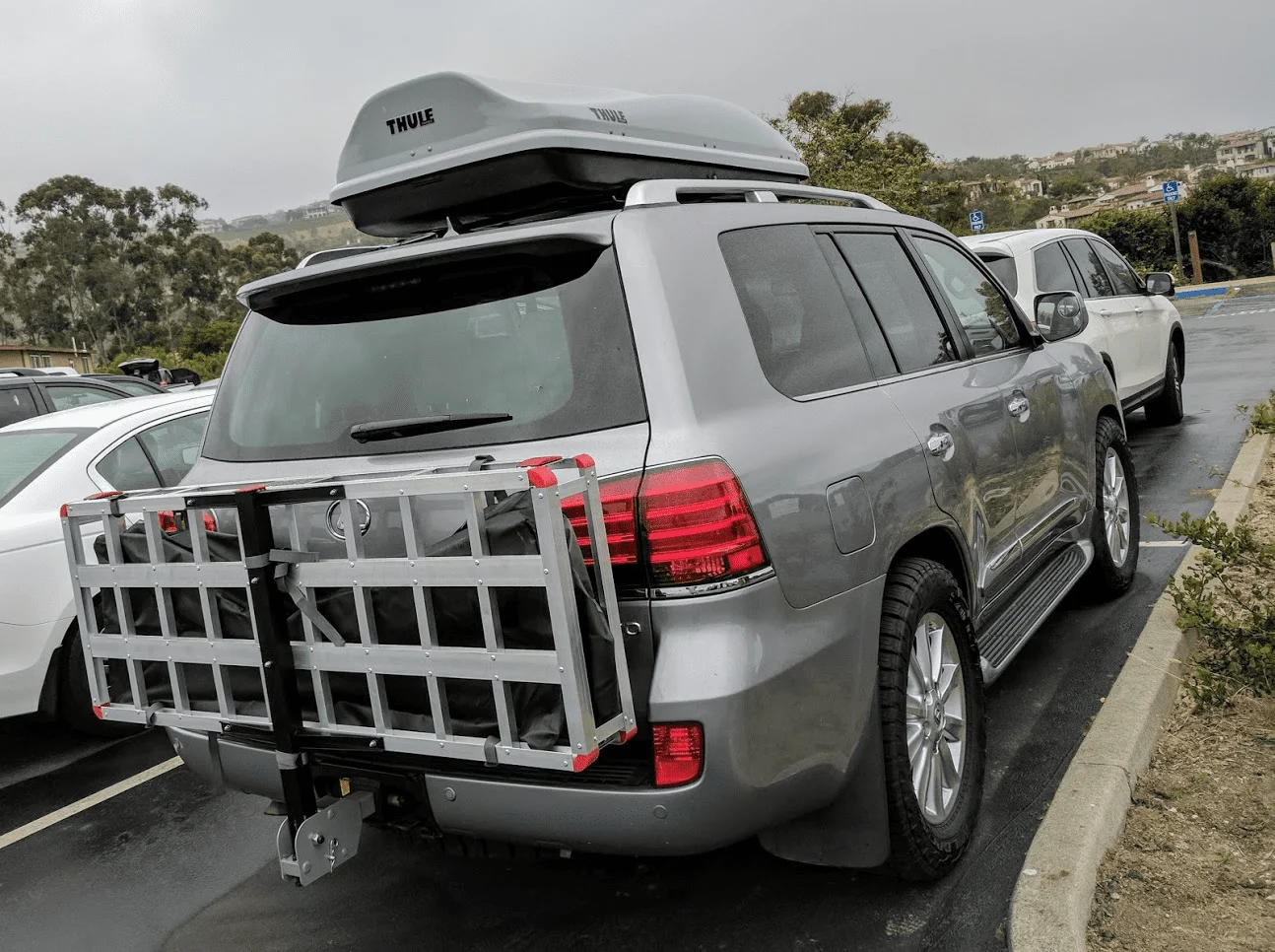

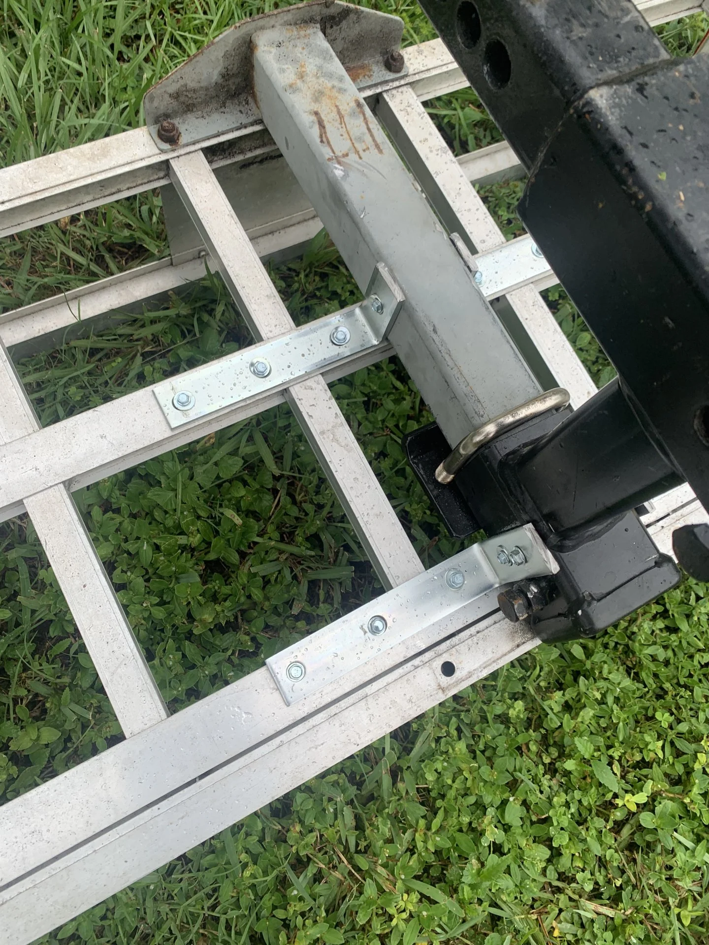

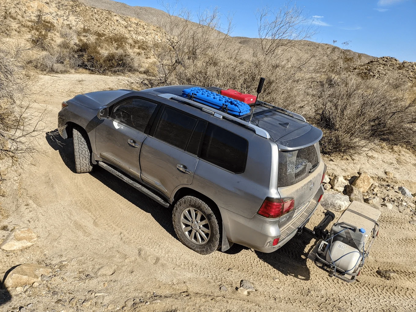

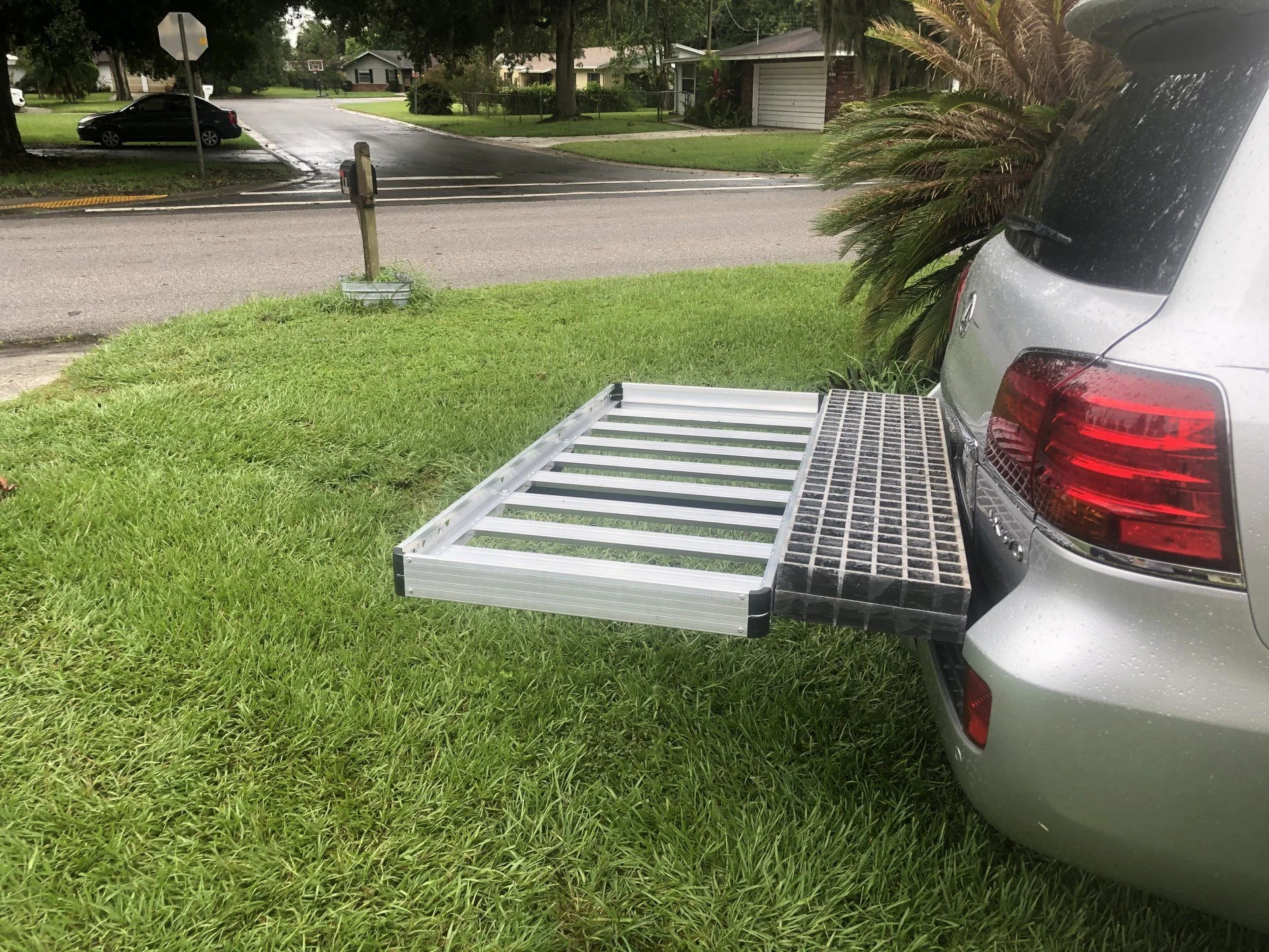

I looked at the go aero hard...but at like $500 it was a bit much and the reviews weren’t stellar. I settled on this one from Amazon...it comes with metal bits to carry 4 bicycles at a time and is very very large. I took the bike parts off but they go back on easily enough.
i wanted it closer to the vehicle and higher up so I cut some of the tongue off, drilled a new hole for the hitch pin, and added a riser...it appears to improve my potential departure angle and allows for a recovery point or the ability to pull my little travel trailer while the basket is attached. I also shortened the riser and drilled a new pin hole for it too.
it hasn’t arrived, but I’ve had such a hard time installing the hitch pin on the 200 series that I purchased the hitch pin I’ll link to as well. I’m hoping it’ll make securing the pin easier.

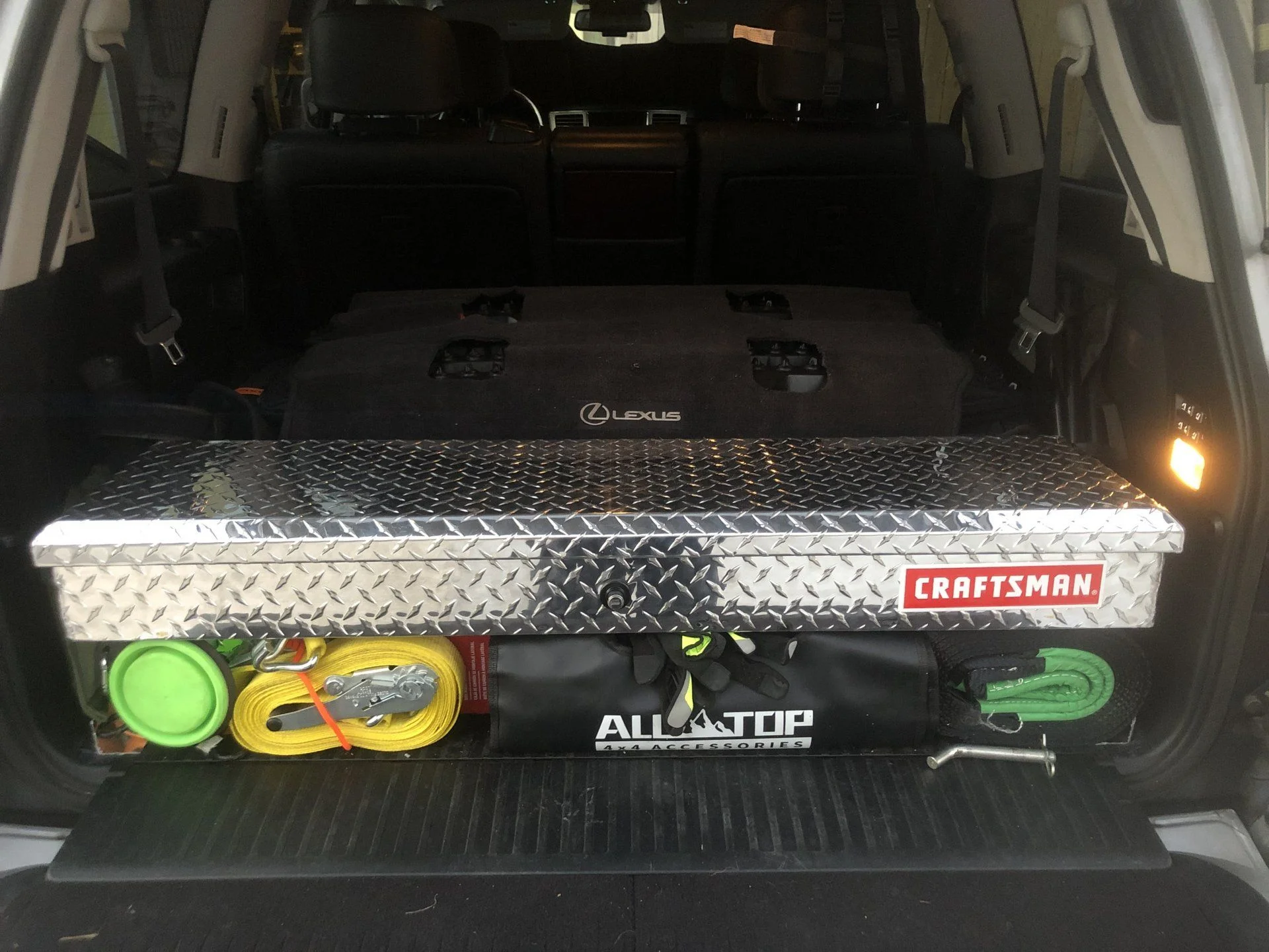

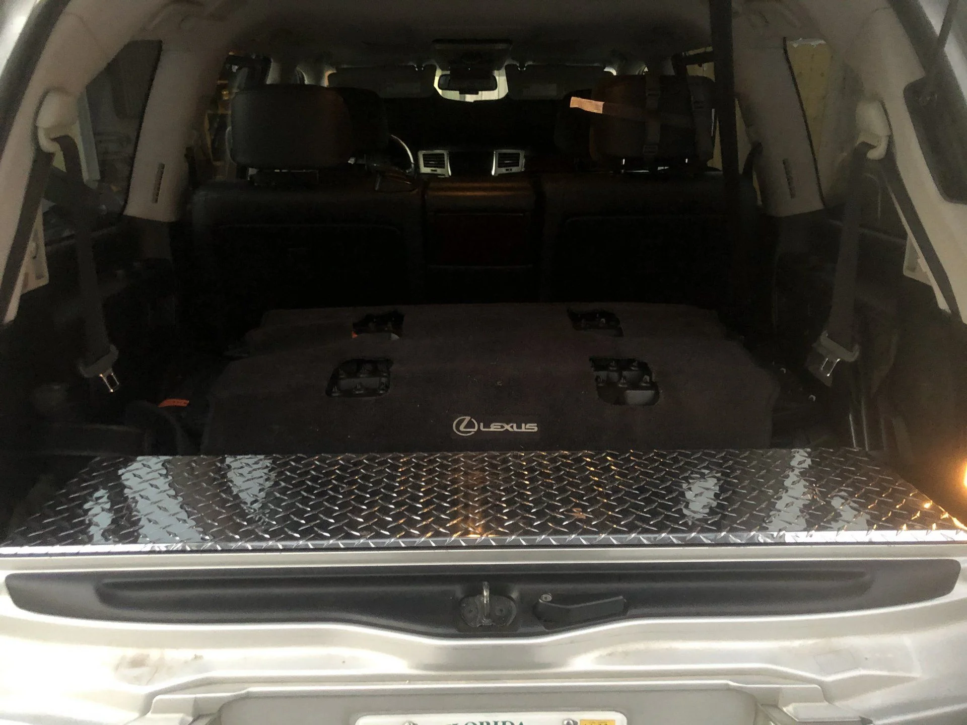

also, one of the downsides to using these baskets or putting the baskets on a riser is that you lose the ability to get full access to your tailgate...I sort of solved this by installing a 48” toolbox...I drilled holes through the bottom of it and bolted it to the rear tie downs (after removing them). This allows me to keep full use of my 3rd row (including recline) and also keeps all my tools, recovery gear, and a spare alternator stowed in a safe manner.
between the toolbox and 3rd row I can fit a spare cv shaft, starter, axe, and a few soft items (spare clothes.
ive got a ton of stuff in there.
im thinking I may drill some lash points near where you see the waffleboards on the basket, thereby allowing my to strap an easy up between the basket and the truck. I think I’d still have just enough room to scoot in between the easy up and the rear of the truck in the event I need to get into the hatch on a road trip. The waffleboards were just set there to see if they’d fit and because I was thinking if I lashed them there somehow, I’d have an even larger platform.

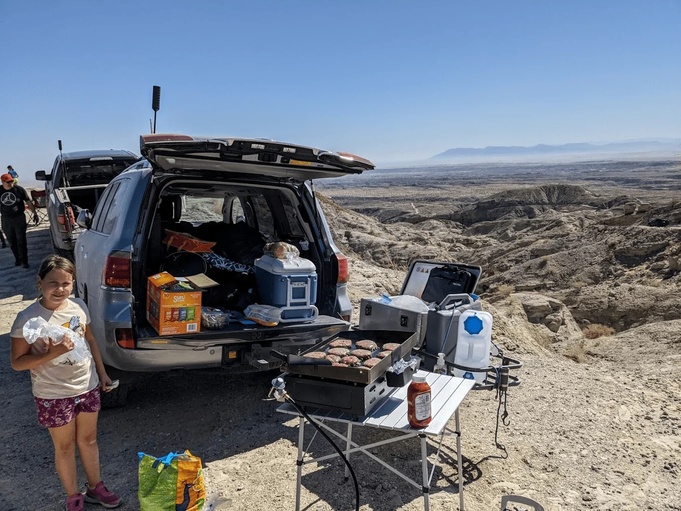

Instant camp kitchen. Or at least a more convenient camp kitchen.

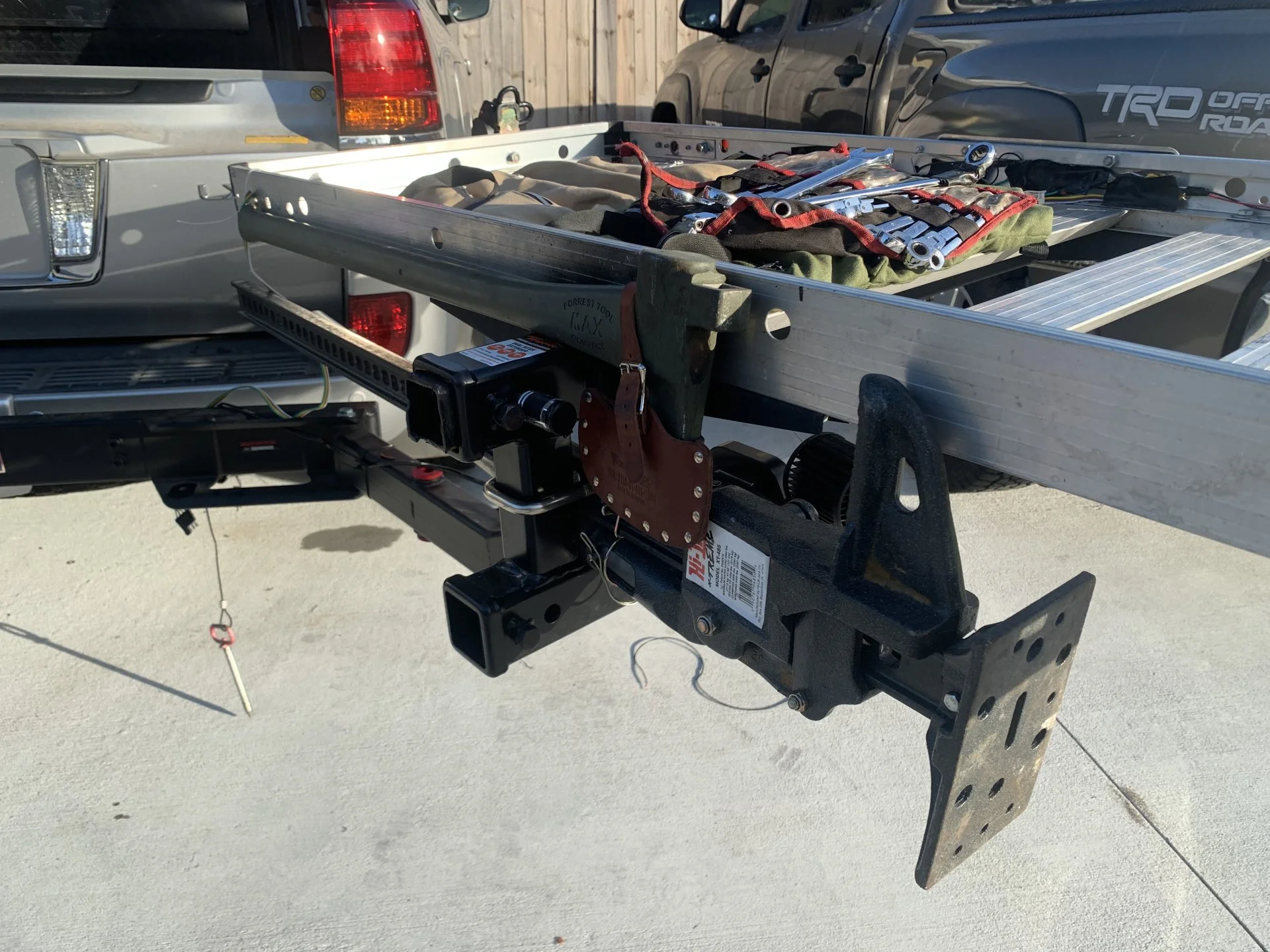

Using a smallish 52"x18" steel hitch carrier on a Yakima Backswing. Modified both to bring things as close and tight as possible to the bumper, cutting hitches about 2" on each component and re-drilling hitch pin holes. . I choose a steel basket carrier as steel is more resilient to off-road and vibration as aluminum can fatigue in these types of uses.

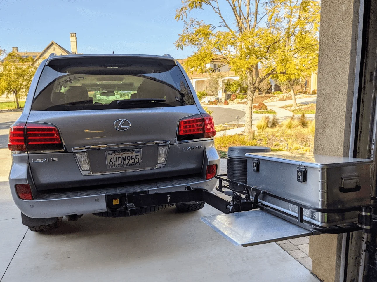

Got the Zarges 28x13x12 box in. Thing of beauty and I'm a sucker for shiny things. Several functional advantages is that it's extremely light. Robust. Most importantly, it's external size to actual internal storage dimensions is almost the same so very little overhead is used by the container itself. Most storage cases I looked into have tapered sides and use 1-2" of wall structure.

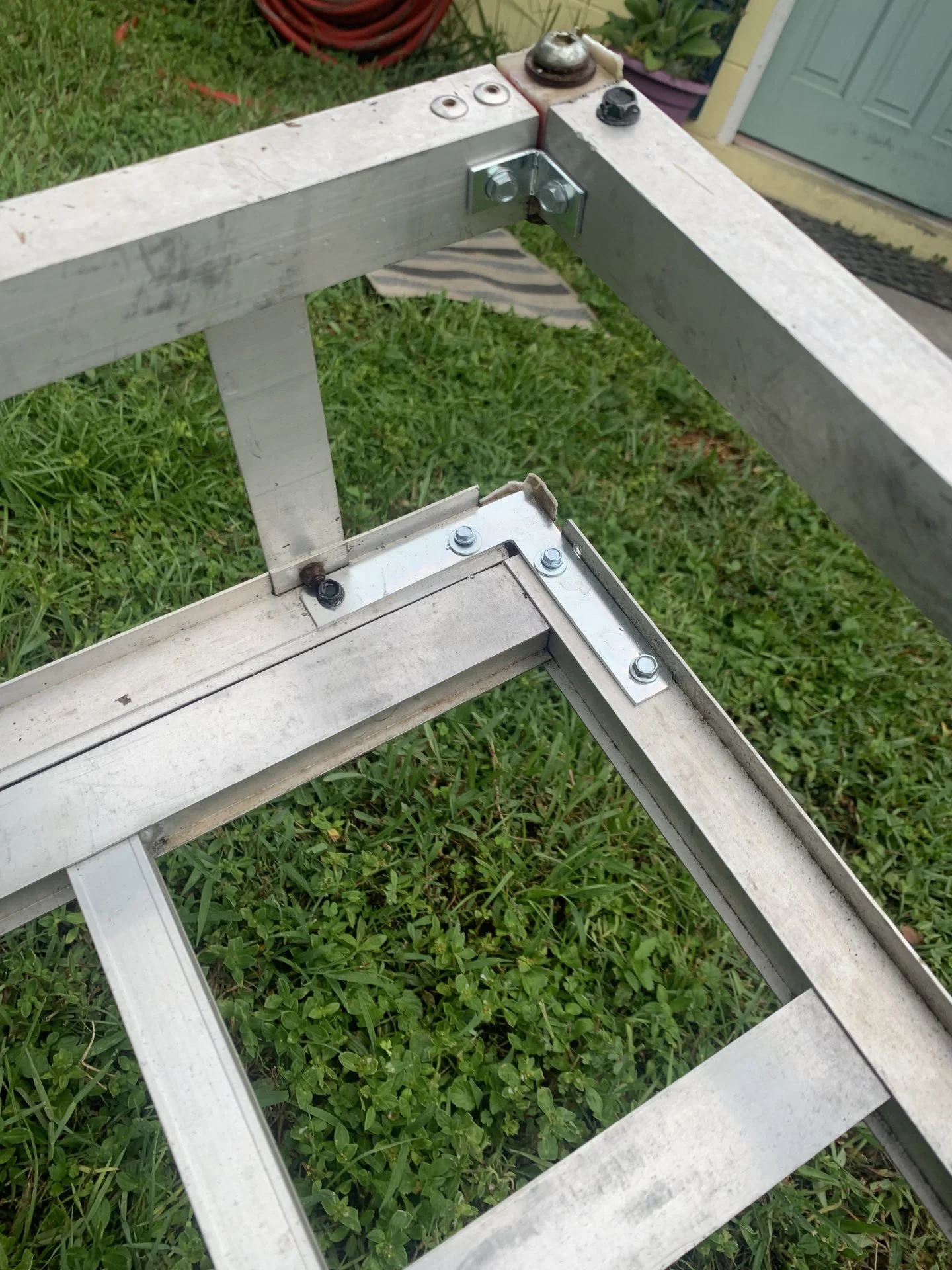

Fab'd a slide out aluminum tabletop. Probably not easy for most to do as I used sheetmetal tools including sheers and a bending brake. Worked out great and is a nice convenient surface for the cooktop. Added a beach umbrella pole mount which is probably not a expedition-ish but should prove functional.
All can be opened up along with the car hatch and tailgate which is what I was hoping for.
Tried to bring it in as close and tight as possible to preserve departure angle and I think I was mostly successful for general overlanding trips. AHC is in low here so it's about 4" higher in actual use. Or about 7" higher than the standard hitch height of a stock 200 for technical stuff.
Would like to bring it in tighter but that has consequences to being able to open the tailgate. The Yakima Backswing also has clearance issues to the tailgate any closer in. A Kuat Pivot would be a better choice to bring it in closer if ultimate departure angle is desired. But then again, it seems to use some proprietary hitch tightener that may not be good to cutoff.
Rack and chuck box worked out great. Enough clearance that I was confidently able to traverse medium difficultly trails without any concern of dragging. Was also able to serve up hot trail burgers for 12 in 20 minutes.

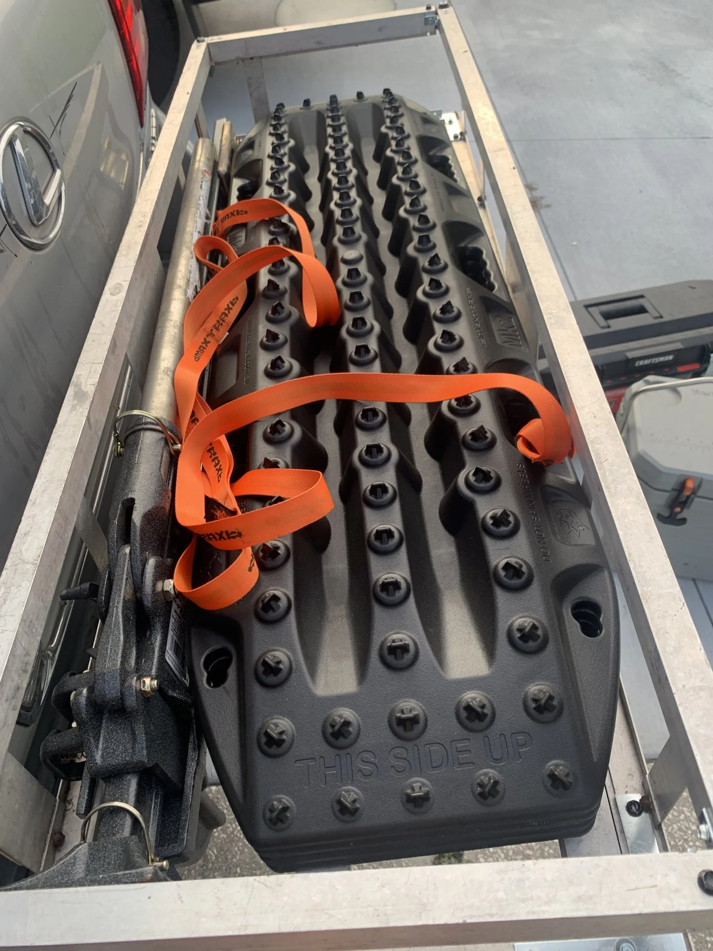

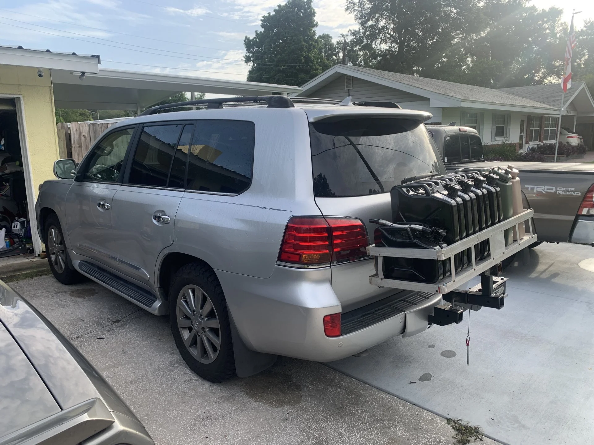

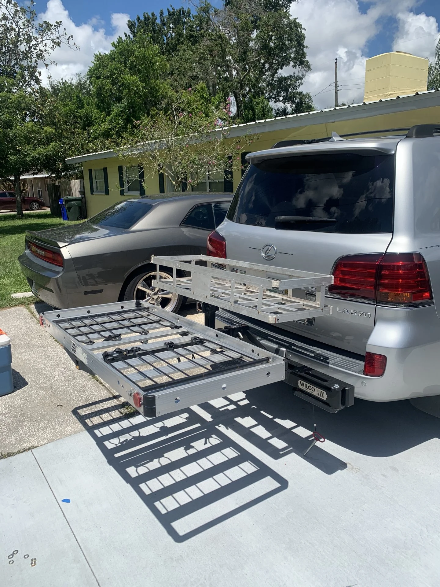

I added a Wilco…then decided I wanted a close high mini cargo carrier for Jerry cans, recovery gear, etc. the mini high and tight basket is an old harbor freight carrier I chopped up, shortened, and added a “hitch riser” to. I think I’m going to reinforce the sides of the mini carrier with some of the bits I chopped off to shorten it…then mount the max trax to the outside. That’ll get the tool box and cooler a little lower in the basket.
fits 7 Jerry cans/scepters
Also I can still add a 4 bike rack/xl hitch carrier underneath. I think this will be a good road trip setup.
I decided to raise my hitch carrier/bike rack up a bit higher and bolt a hilift to it. I don’t think think it’ll affect departure angle negatively at this height. I can just barely open the hatch…the tailgate will also open, though I need to torque the carrier slightly…it just barely clears. I used the u bolt from a hitch tightener to bolt the hilift on. The hitch riser I used is this one.
Towever 84131 Trailer 2 inches Dual Hitch Receiver Adapter Extender for Towing and Riser for Bicycle Rack, Extra Long Towing Accessories Amazon product ASIN B07PTPJJ7Z
Also, I moved my license plate to the outside of the hitch carrier and added an led license plate light…and some led brake lights. Also some light pod’s wired into the reverse lights bolted to the Wilco.
I continue to be very happy with the 1UP USA rack. Tslot allows for additional tie down points, its low profile when not in use, and fits like it was made for the 200.
is your rack the 60" or 48" version?
