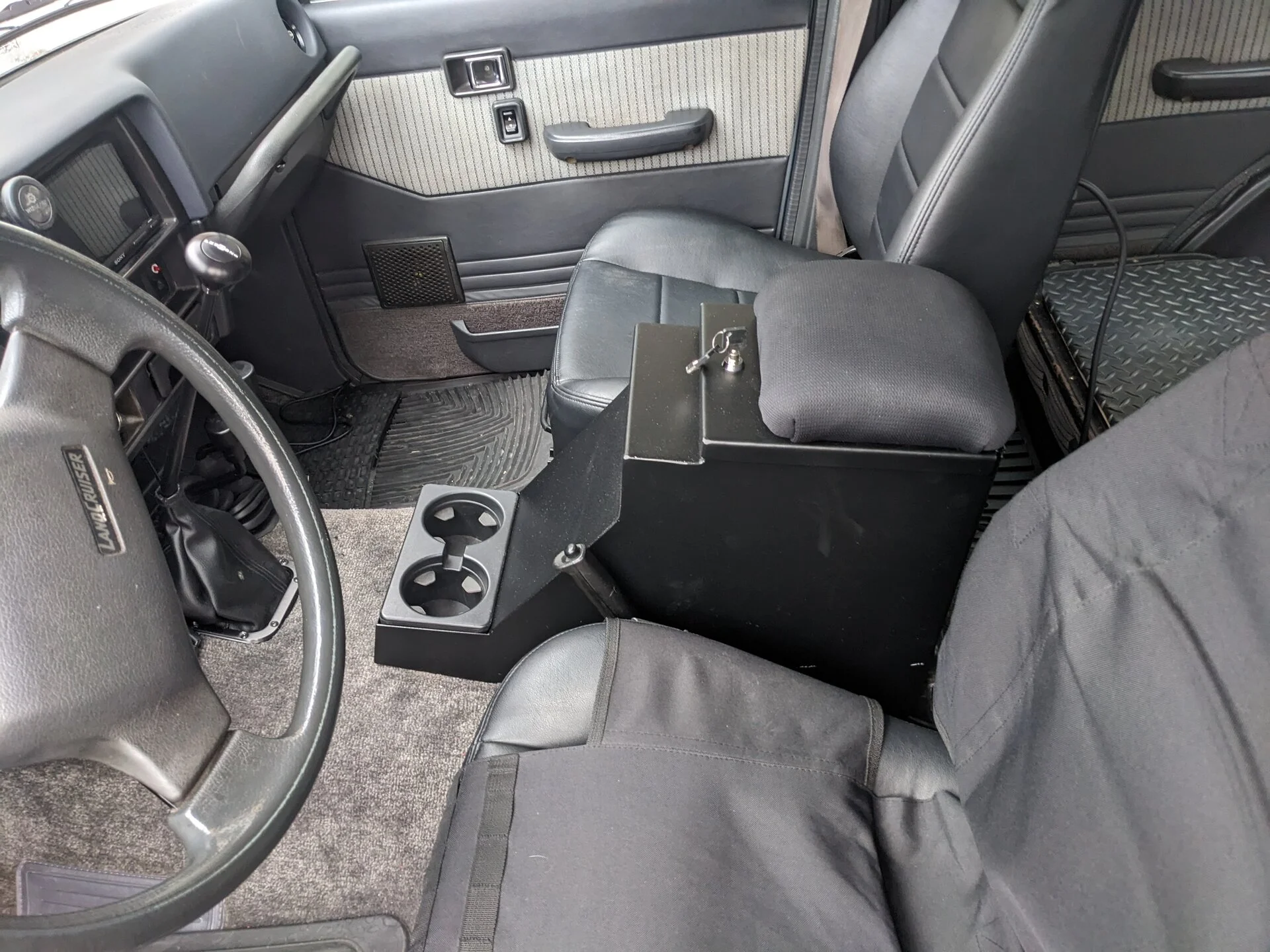

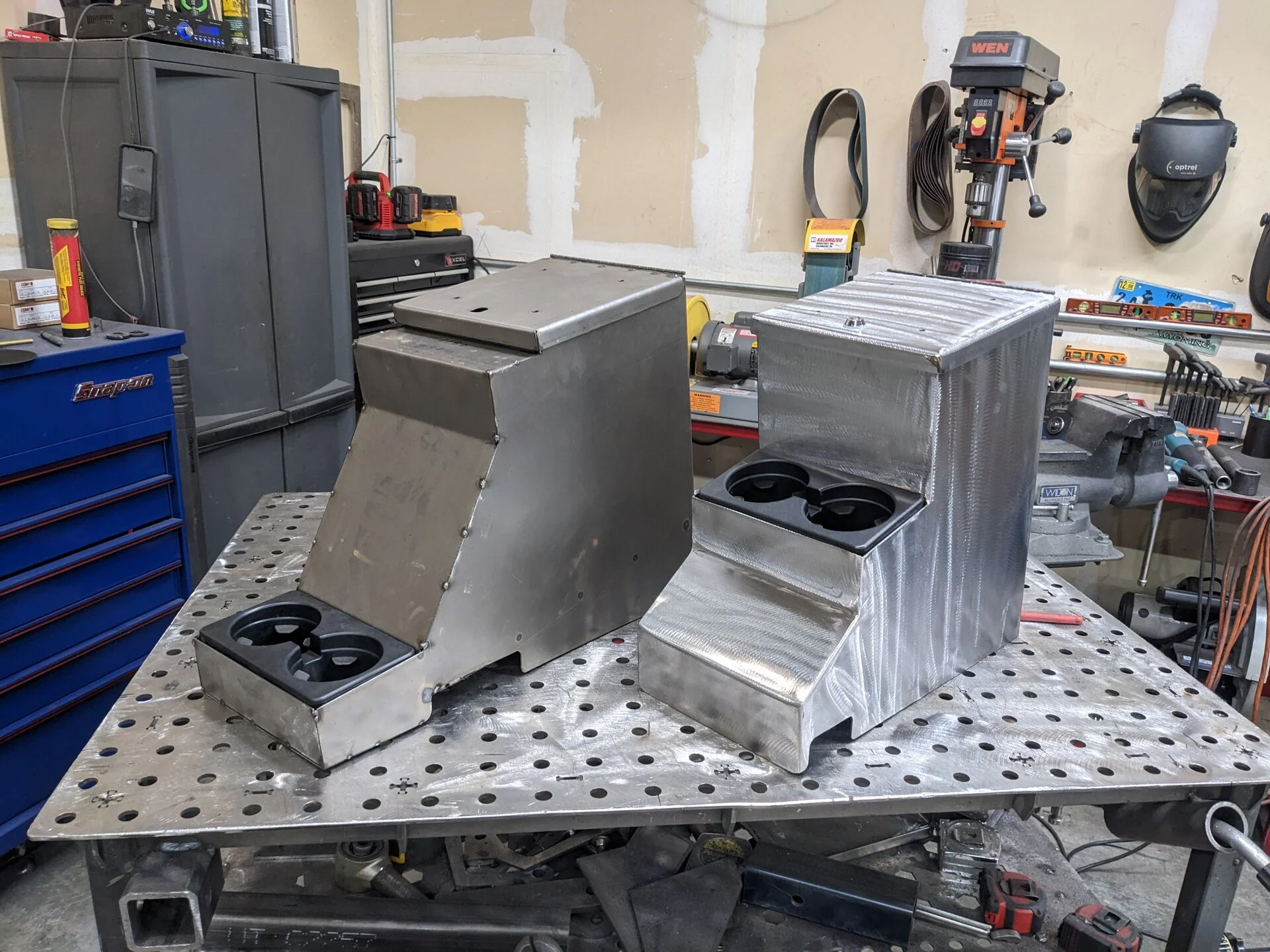

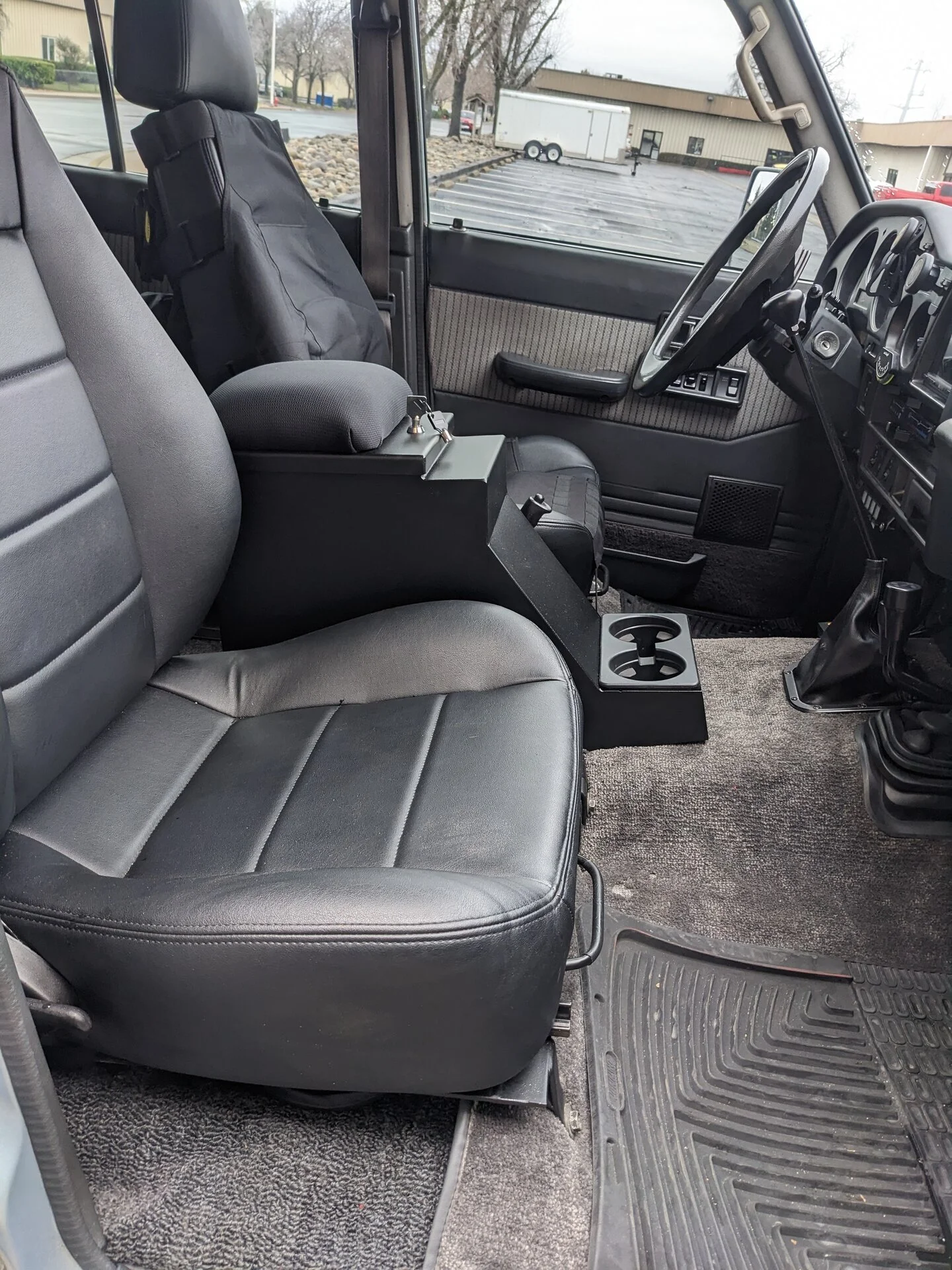

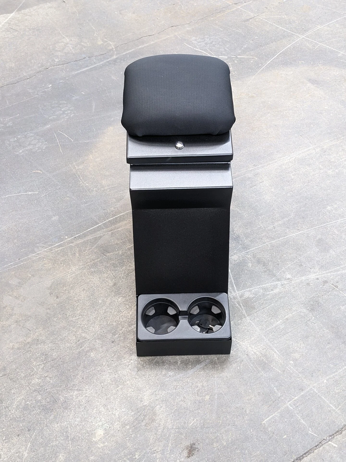

Console is back from powder. Assembled and installed.
J
Looks great! I like your cup holder MUCH better than what Tuffy provides.
Did you design it to fit around the rear heater? From what little I can see in the pics it looks like you removed the rear heater.
If you designed it to accommodate the heater, I'm curious to see it from the back.
Heater is in place and operational.
You feel like making one for a 40

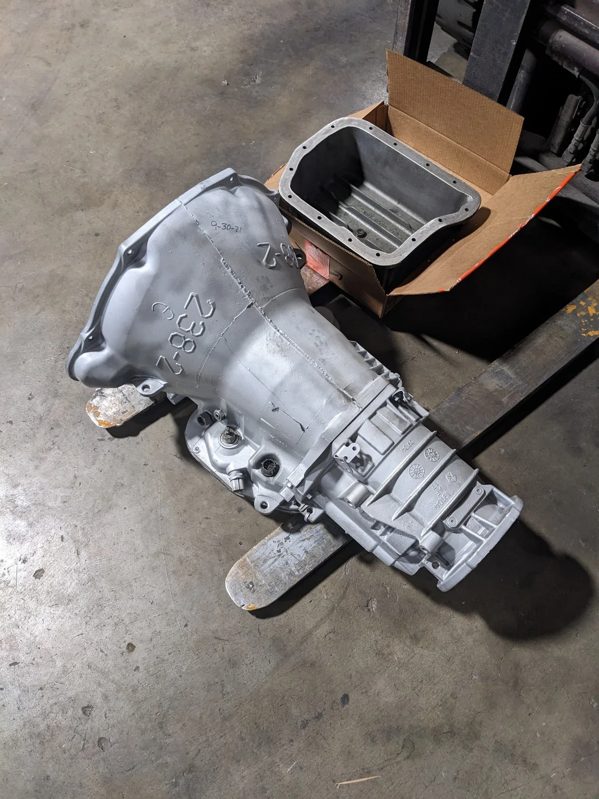

Massive build on the 47RE transmission for the 24V 5.9 Cummins going in DINKUS. Built to handle 800HP and torque. We are shooting for 500HP/torque. Custom tuning and setup.
Carbon fiber gear bands
6 Raybestos custom frictions and 6 Kolene steels in direct clutch
4 Raybestos custom frictions and 3 Kolene steels in forward clutch
10 Raybestos custom frictions and 9 Kolene steels in Overdrive Direct clutch
6 Raybestos custom frictons and 6 Kolene steels with custom apply plate
Will be getting a triple disc converter and billet flexplate as well.
Custom push button shifter to boot!

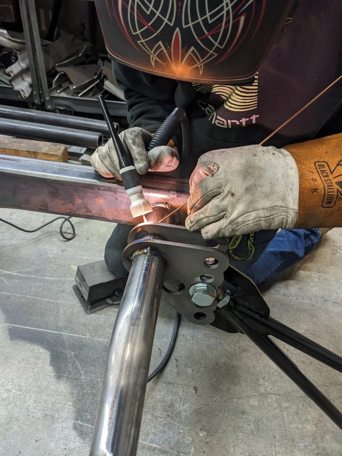

Stude is coming along.
Suspension front and rear is set up and welded.
5 degrees of caster 1 degree of camber. As pictured, Tony and I can pick it up off the stands.
Should be a filthy ride and with a 6.5" ground clearance too. Love the 2" drop spindles from Heidt's.

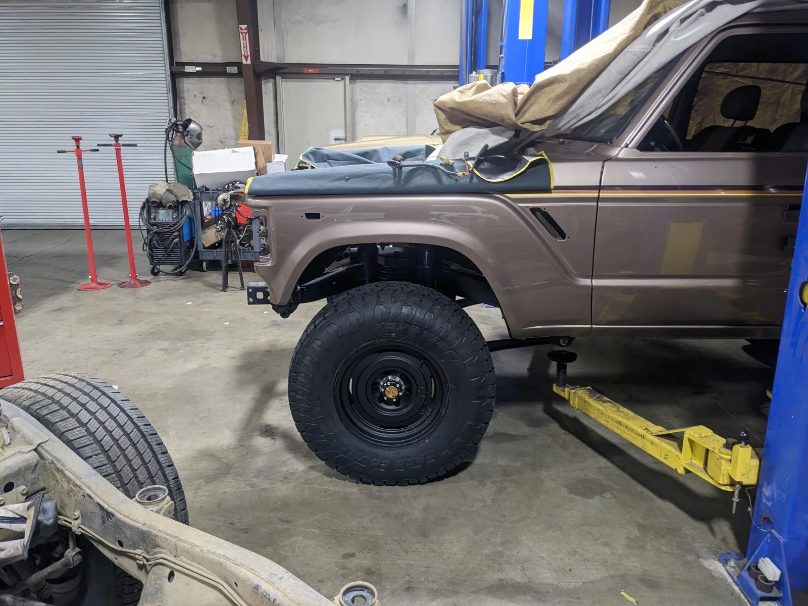

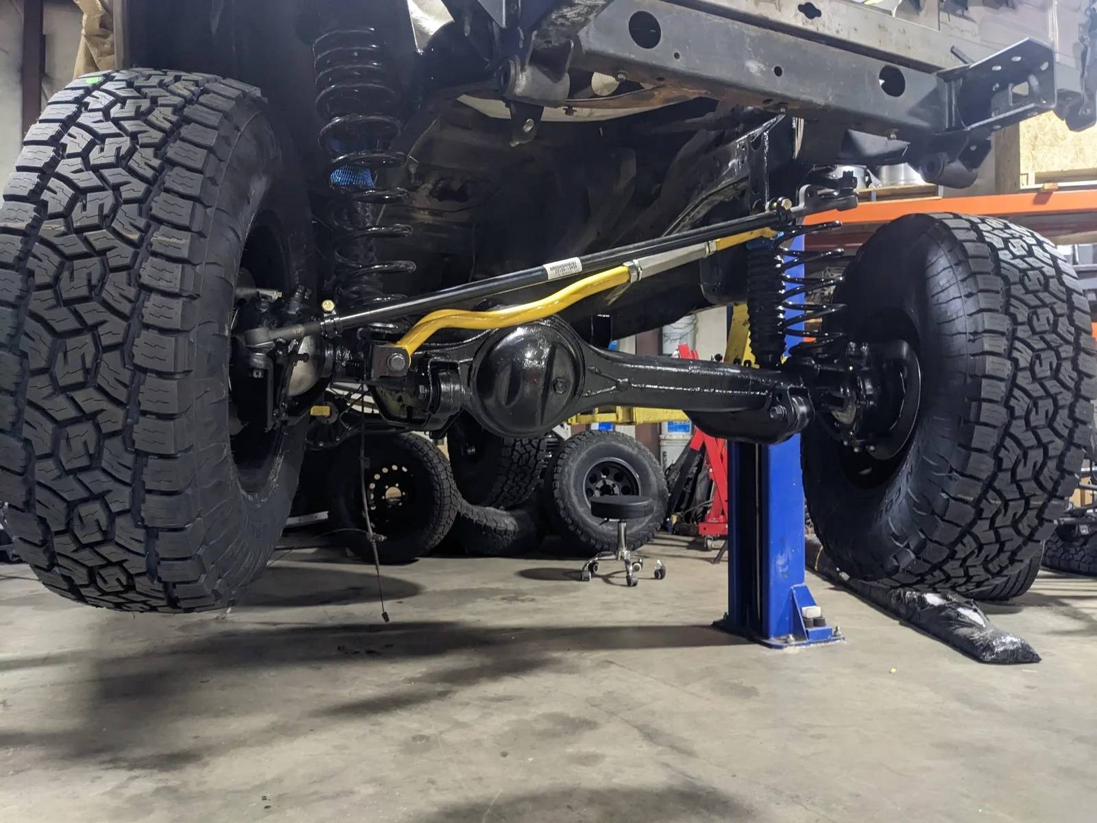

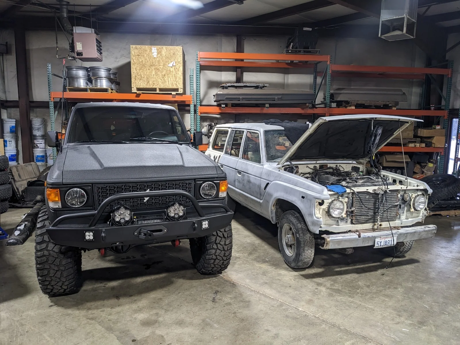

Just another front coil conversion. We have passed the 100 kits (front, rear, or both) mark sold and /or installed worldwide as of January 2023. Not to mention the 100 series front solid axle swaps and 40 series coil conversion/40 rear coilover conversion kits and installs.
This one has 35 x 11.5 x 17s and Dobinsons IMS shocks. 11" of travel and a 2.75" lift. Dozens of installs hitting the 2.5-4 degree of caster alignment specs with 34-37s and 2.75-4" lift. All ride like a Cadillac!
4 wheel disc brakes with 105 series rotors and brake calipers, ceramic pads. CrMo front birfs and Trail Tailor 4340 CrMo heat treated rear full float axles. Marlin Crawler seals, Koyo bearings, Trail Tailor ABS block offs, Aisin hubs, rebuilt steering box and hoses. new brake lines, modified prop valve, fittings, master and booster. ARB lockers front and rear with 4.10 gears.
Next up LS3, 6L80E and new transfer case and a plethora of other mods.
Jason
TT
