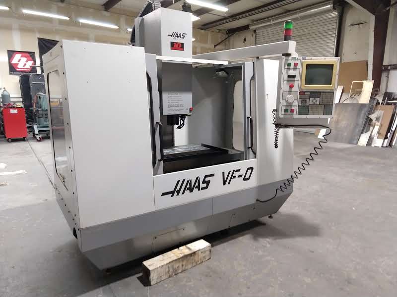

First order is to get them baselined by a Haas tech next week and a complete maintenance. These were in a community college program and always serviced by Haas. They are LOW hours.
Second order is to work with my military contractor for """"""" hammers.... :D

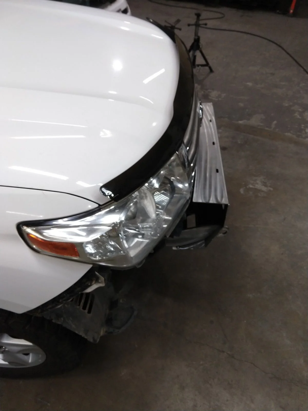

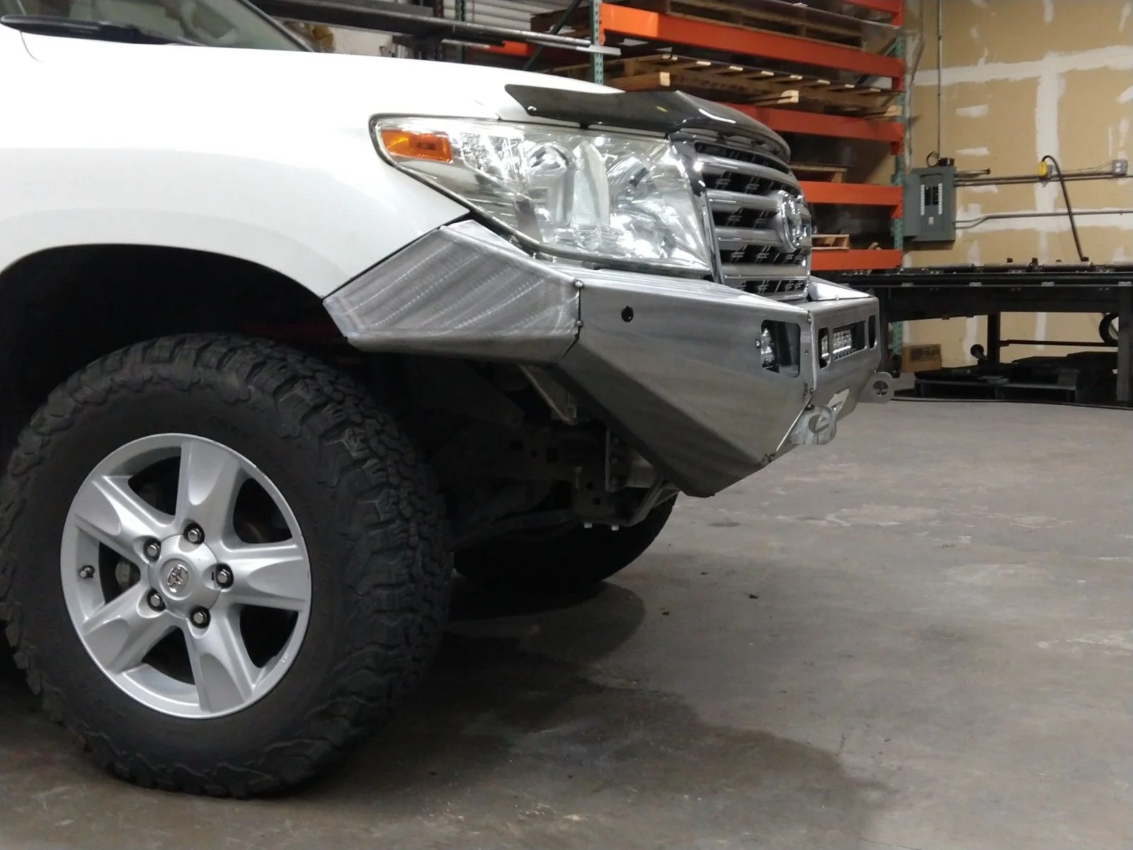

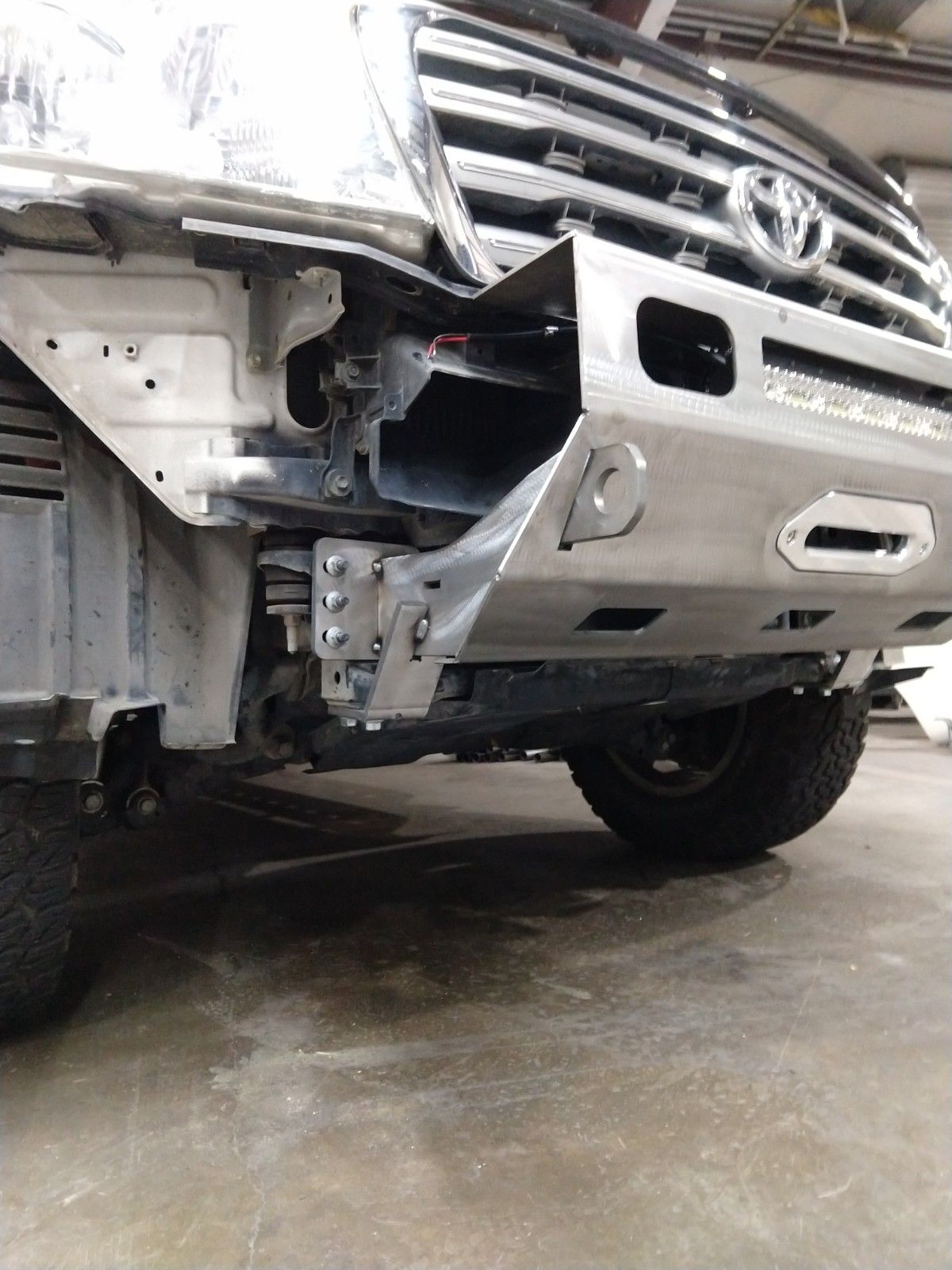

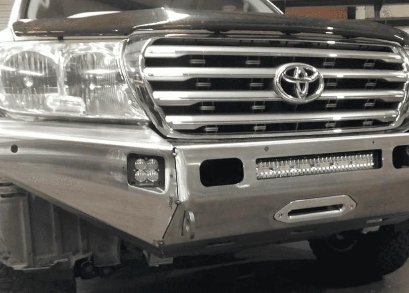

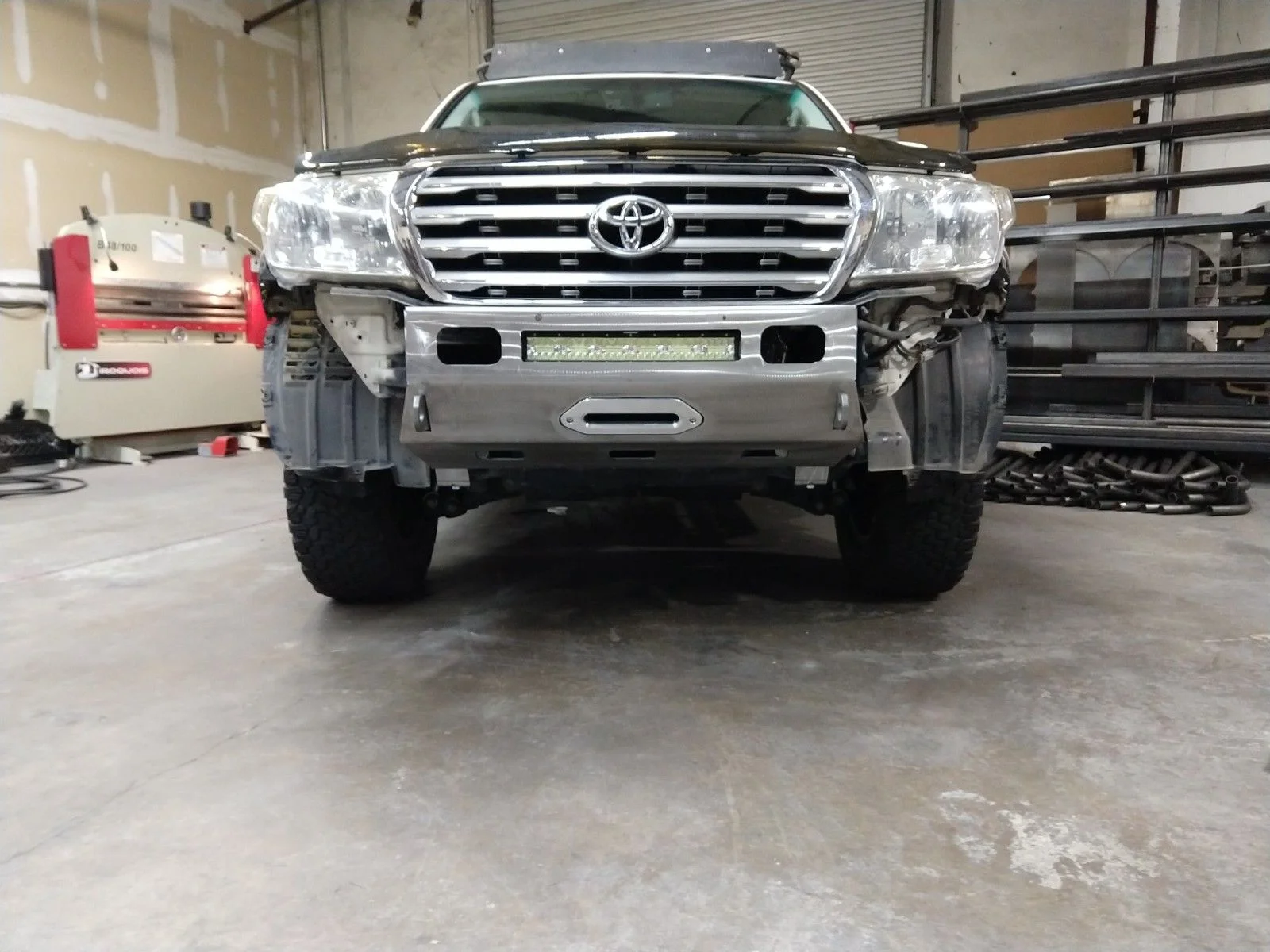

New design for the '08-'15 200 series in the works. Center section is set. Adjustable 3/8" frame plate, brace and frame skid brackets and will house a 12k winch. Recessed custom Trail Tailor aluminum fairlead, LED bar and wing/ combo driving lights.
This one will be similar to the @TonyP high cut/profile; full front replacement for the rock crawlers. This frame mounting is stronger than the previous version. Never had an issue from the prior... just making a stronger and better mousetrap.
But will also have a lower cut plastic cover version for the weekend warrior camper customers as well............ (I hate to use the term "mallcrawler"). These of course would handle anything you could throw at them......... just an aesthetic "thang"..........

Is that the winch fairlead?
If so, I’ve never seen one flush like that.
VERY interesting if that’s the actual fairlead...freed from sitting within a sharp-edged shroud or recessed frame.

Yes full recessed! I started this a couple years back and it started with my 60 bumpers.
