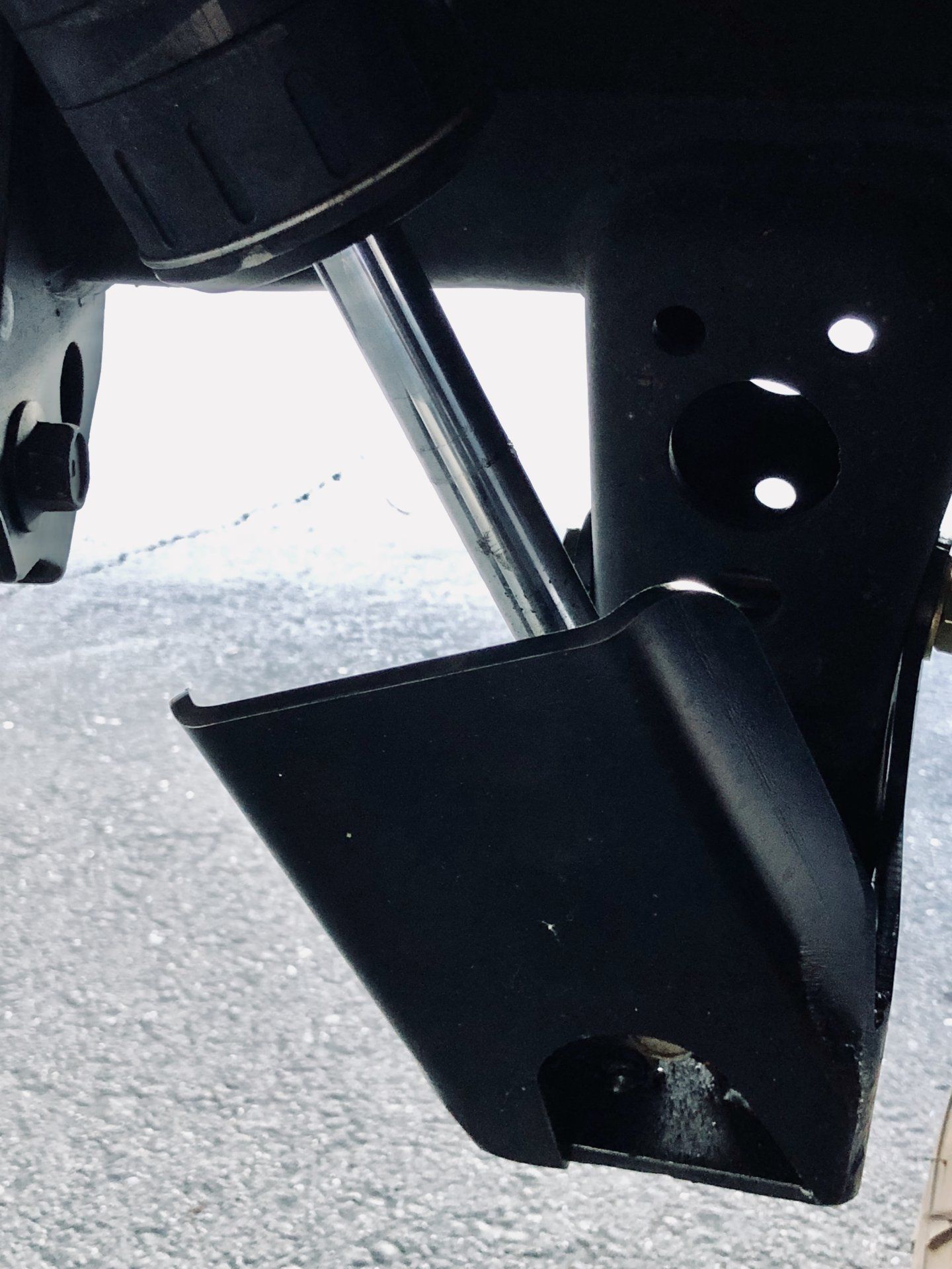

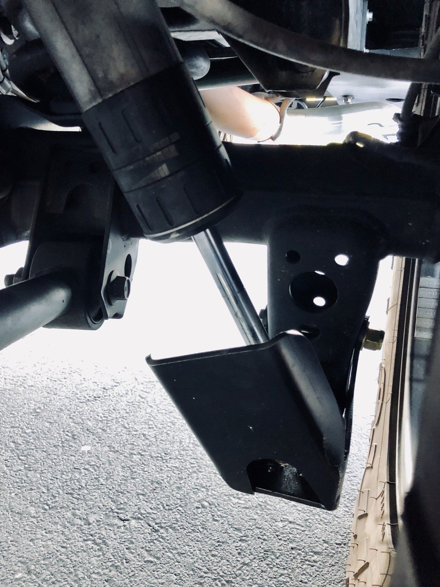

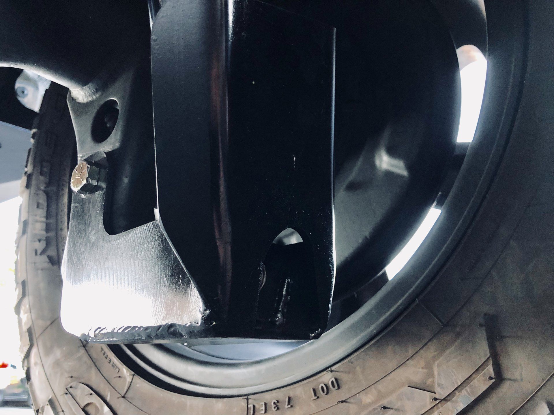

Question on the shock guards. If they get hit on hard enough to need them, wouldn't the shock guard pivot up and force the front of the guard into the shock anyway? I say this just because it looks like they attach with one bolt, which would be strong enough to keep them attached, but it might not be as effective at stopping the rotational force. I'm sure you thought of this already, so maybe there's more going on with how it attaches and/or other pieces of the shock mount resisting any rotational forces? Please explain.
(and apologies if it already is explained somewhere in the 45 pages of this thread!)
They attach at two points. The shock fastener and the grade 8 bolt through the shock mount housing so it can't move laterally or horizontally. Same concept as the ones I have and I slammed them more than few times in Moab with no movement.
Correct! I think someone could hammer on these with a 16# sledge and not budge them. Not sure on @TonyP build materials (never seen them) mine are all 3/16" HSLA steel and the main shield is double bent as well for even more rigidity. So it acts as a shield and a skid at the same time.

I made a set of big bore rear shock guards for @indycole (BP-51s) I made 2 more sets for making a jig. But gauging interest from you guys. Anyone else interested.
These are the prototypes so they look a little rougher than a production set would look.
Looking to be around the 165.00 mark in bare metal.
