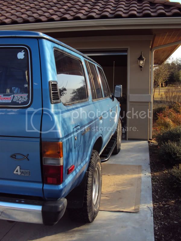

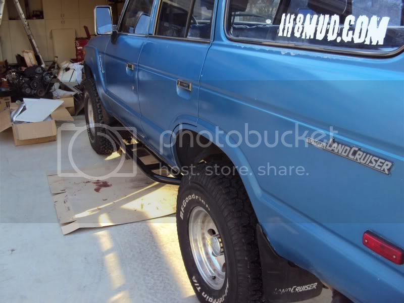

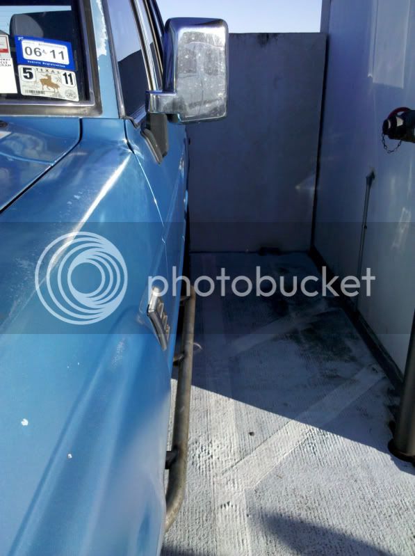

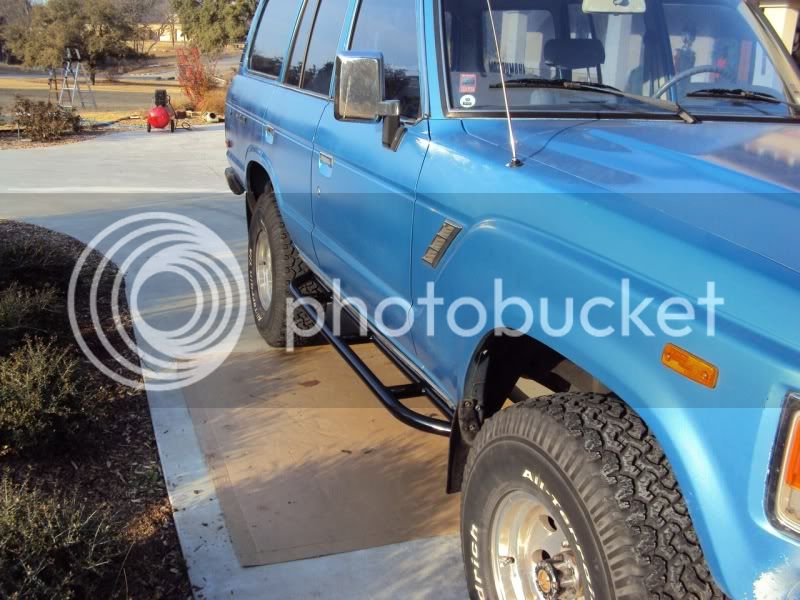

As promised...
Best profile shot I have (unpainted):
Painted pictures:
These 67" sliders are a perfect length if you take off the mud flaps, as you can see I kept mine. They stick into the rear wheel wells a little bit, but under articulation the rear tires swing backwards so no worries there. (Of course I don't have a picture to illustrate this haha)
Plus I didn't want to part with the mudflaps :)
Really like the sliders, just need to use them!
I was thinking about going the bolt on route, but I didn't have the fab skills or the time to do it. I don't see my light duty Landcruiser bending these anyway, and thats the only reason to unbolt them, to straighten them out.
