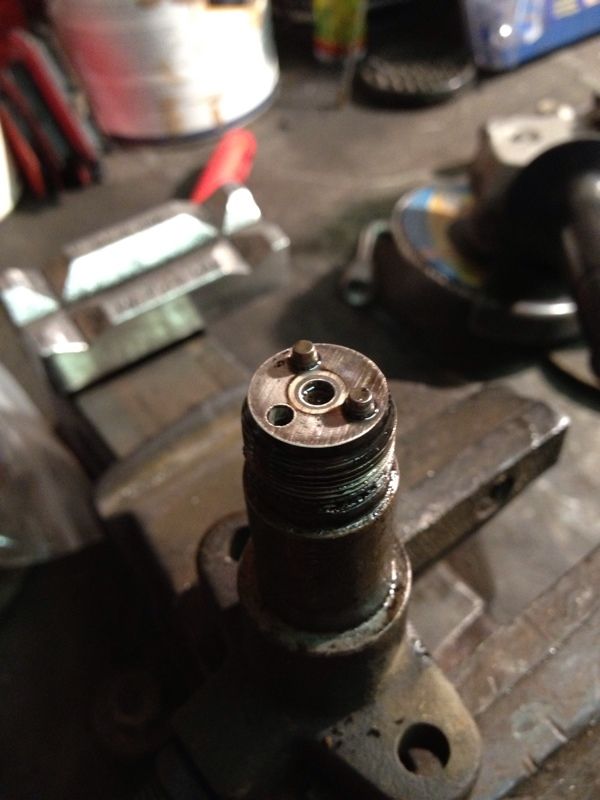

Well, it's time to spend some more cash on the motor. As to the FSM, it said to have the fuel injectors checked before reinstalling them. Took them to City Diesel, local shop, and had them tested. Three of the four were bad:bang: and he only had two, and could order the other two. That hurt the old pocket at $220 each:doh:. Well, there is no other way around it. Did get the oil cooler cover painted and the bolts all cleaned up. Just cleaning up the hard fuel lines and brackets now and getting ready to throw it all back together. Here is a pic of the oil cooler cover.
Apparently some are unrebuildable....or so I was told. You will be happier knowing they are right and there won't be any issues. And I feel your monetary pain on this one. Did you go OEM?

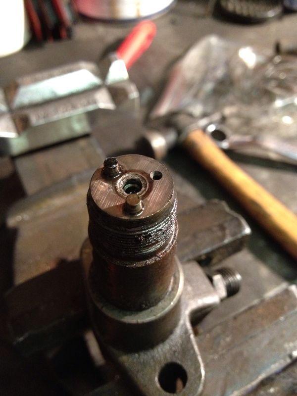

Yes the shops that tell you that are the ones that can not repair the faces, the 4BD1T injectors seem especially prone to face damage here is a pic of mine.
This is what they are suppose to look like.
They can be repaired it just takes some specialized tools. 3 of mine are bad one looks like new.
Hate to tell you this but the injectors are rebuildable for about $50 each.
Do you have any part numbers? The shop I went to is a very good shop and I know one of the co-owners.
Three of mine look like your top picture. I was told that this is caused by the pressure that causes the two pieces to bump together and also by high milage trucks. So does that worn out piece come off of the upper assembly? Would rather spend $50 per injector than $220 each.
The injectors can be machined and heat treated. However they will not last as long as just buying new ones. I talked with three shops and all said that I would get the same mileage to investment for buying new as opposed to rebuilding. The trick would be if you could find a way to rebuild yourself.
Clint
Clint
Do you know if that part that wears out can be taken off of the rest of the body? I could machine a tool to take that piece off but have no idea where to get that piece at. May just pay out the cash and get new ones from Bosch.
It is actually part of the body not a replicable part. The shop that I found that fixes them is in SoCal and they actually press in a new hardened face after some machine work to open it all up. I do not know the details about it but they are very familiar with the Isuzu 4BD1T injectors. They can also usually rebuild the nozzles as well. Longbow sent his out to this place to be fixed with good results.
http://www.dnrind.com/prodf/ib01.htm
Interesting how three of mine where also shot wile one was like new.
