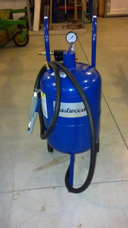

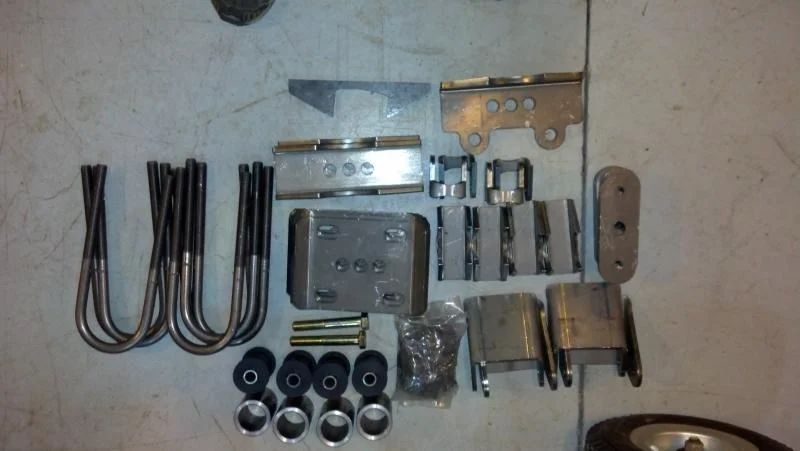

Well UPS and FedEx came to the house today to bring early Christmas presents. The SOA kit from Ruff Stuff came and 100 lb. abrasive blaster from Eastwood arrived. Now the fun begins.:beer: Attached Images

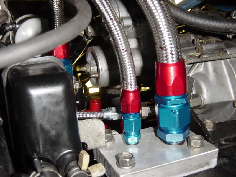

Hey Doug, in this picture of yours, what is the black box to the far left for?

In the picture, the black box is the stock Isuzu crank case vent oil separator mounted in the stock location. I swapped the 4BD2 oil pan for a 4BD1 pan, and all the connections still worked.

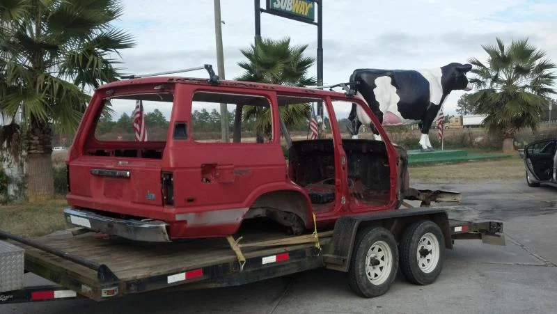

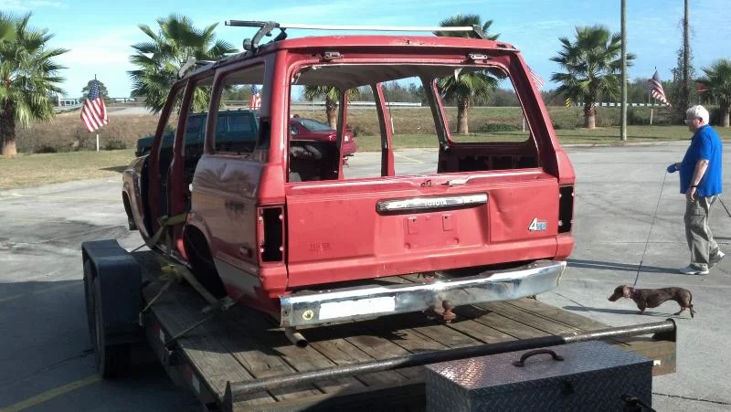

Well after 1100 miles of round trip driving this past weekend, the new body is home. Next in line is to cut the top off of the red one and replace it with the the root beer brown one. The body is pretty solid except the roof. The quarter panels and rockers are awesome. There is some rust in the front floor board and the windshield channel that was discovered when the owner started stripping it. Thanks mel lowe (Deo) for helping load the FJ. Will use parts of the old body to patch the red one. This is going to be awesome when I get it all done.
