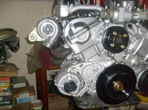

Toyota V12 into 105
Turbo (T3/T4) added on rh bank

Put on hdj100 brakes, with the electric booster. Stopping power also if the engine dies.
My LC should be around 500HP when I am done with it. Will the HDJ100 brakes work on 16" wheels?
LC100 brakes are made for 16". Don't know about 500 HP tho; total weight, speed, and tire diameter would matter. Front calipers have 4 pistons, I'll find the bore diameter somewhere...

LOL, maybe just some reasoning behind me slapping the turbos on. My house is at an altitude of about 5800ft and not all the horses come out to play in a na engine. Boost will be limited to .4 and I'll have the ability to drop it down to 0 boost. This might be the least used function in the LC! The gearbox that we are using is the same as the one in my 200 Cruiser and I am of the opinion that the weakest link will be the diffs and I'll have to look for after market units.
I'm keeping the permanent 4x4 system
To help to correct the geometry of the suspension after a 3" lift a full Snake racing setup was fitted together with 400 kg springs at the rear and 200 kg in front. With the V12 being lighter than the 4.5 I might have to change the front ones to 150 or 100kg units.
The conversion is taking a lot longer than anticipated due to the complexity of the plumbing, we are trying to get equal length tubes from the turbos to the intercooler and also to get the balance right so that we limit the volume between the turbos and the intake. This should help to reduce turbo lag. The dump valve will unfortunately be an external one and that plus the 2x 3" pipes at the back will give away the fact that the car is not std.
I can't wait to turn the key. The dyno will be done at altitude and will not show the full potential, it will however be on youtube.
