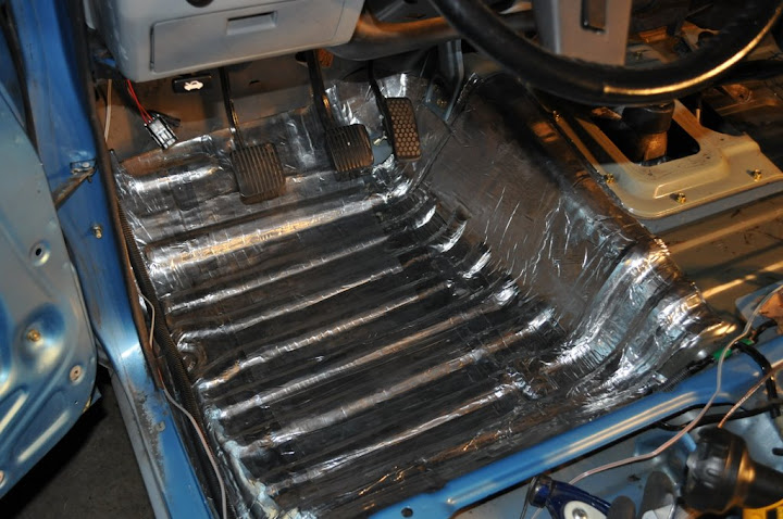

and here is what i was able to accomplish last night before crashing late:
i'll post up the rest of the pics when i do a writeup.
