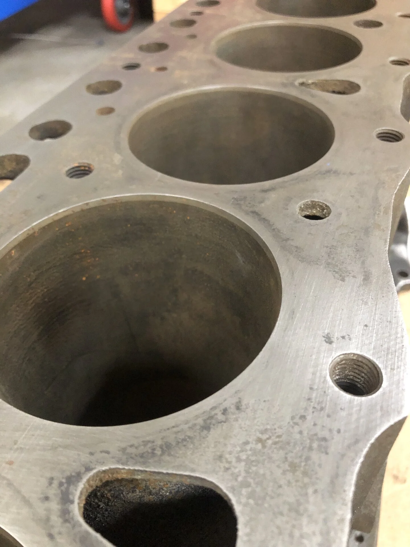

The hot tank did smell nice! The lumber did char some. I kept an eye on it and kept the flames low enough that they didn’t ignite the wood. I kept a bucket of water nearby in case. If I was to do it again I would get some concrete pavers to stack rather than the wood.
I ran that propane can for about 6-8 hours at a time and did that 4 times. The liquid never got to a rolling boil, but it was hot enough to do the job. You can certainly see currents churning through the engine passages. Remove all the freeze plugs first. I tanked the head twice because I was lazy and didn’t remove the plugs first.
I also let the parts sit in the solution over night after warming the liquid for hours. I repeated the process the next day before removing them and cleaning them up with compressed air and wire brushes.

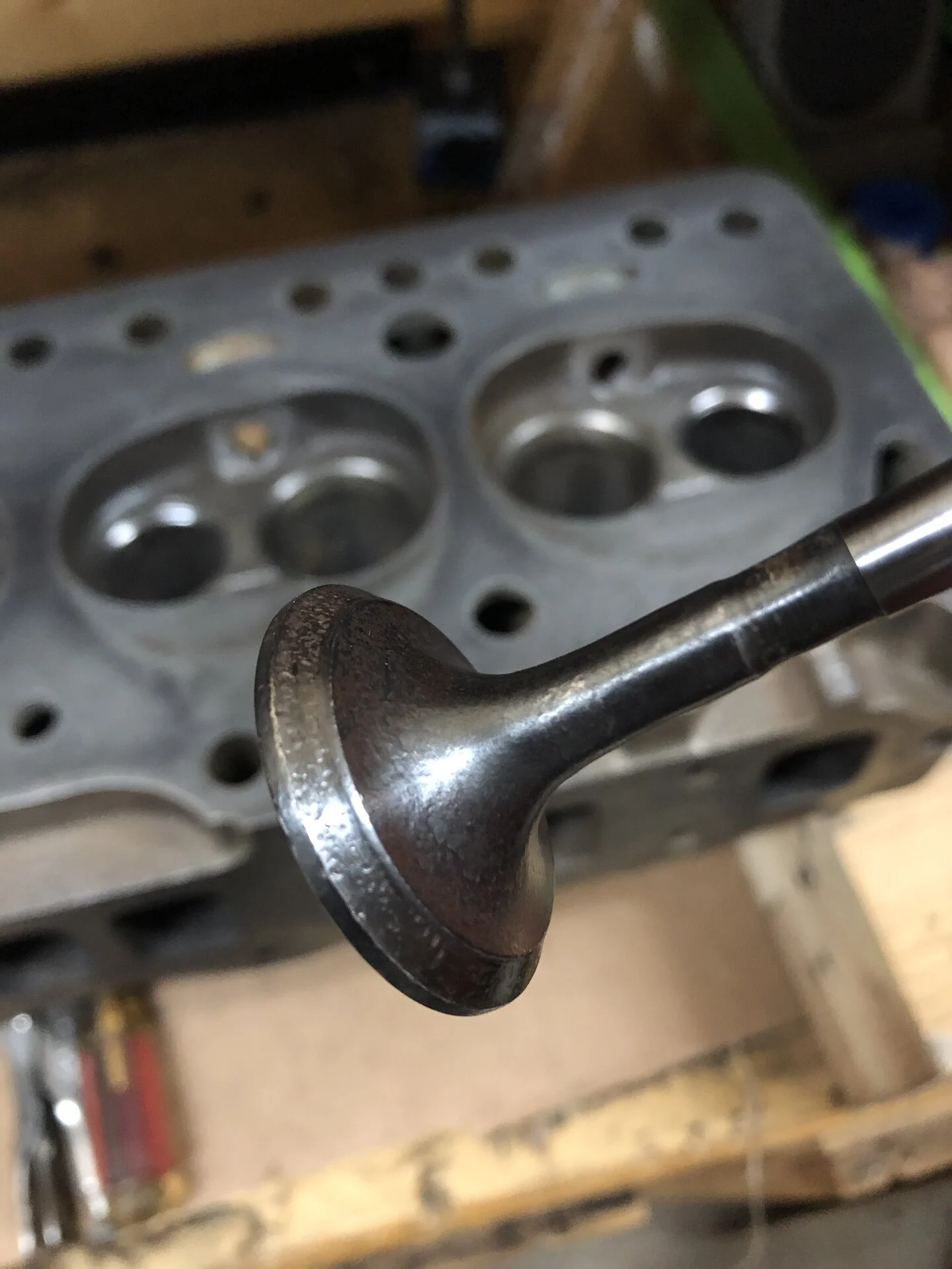

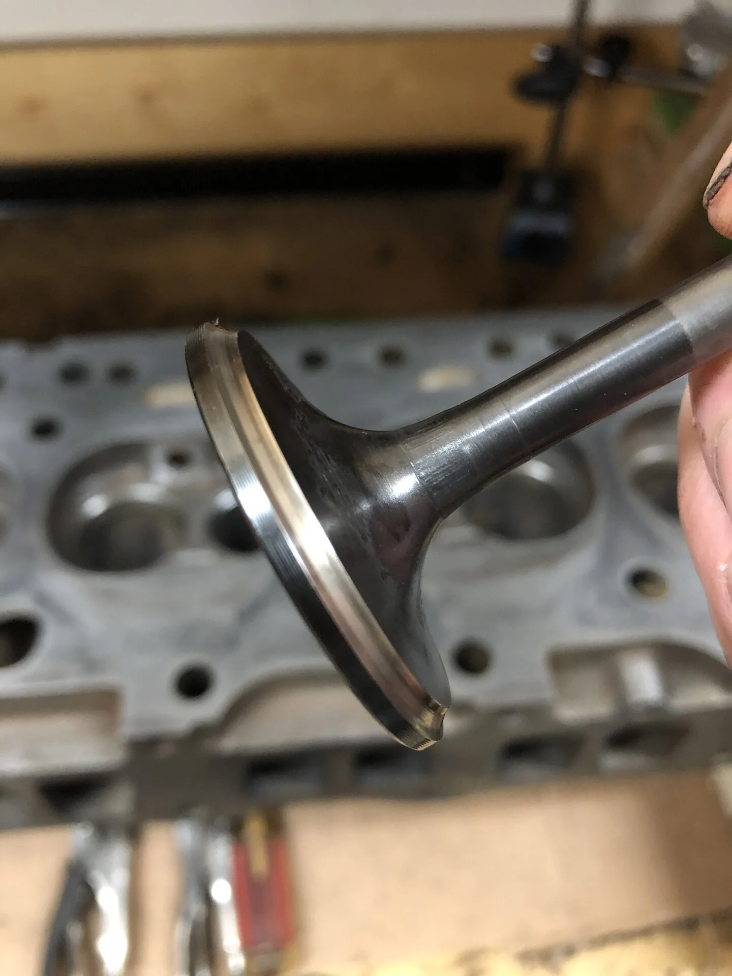

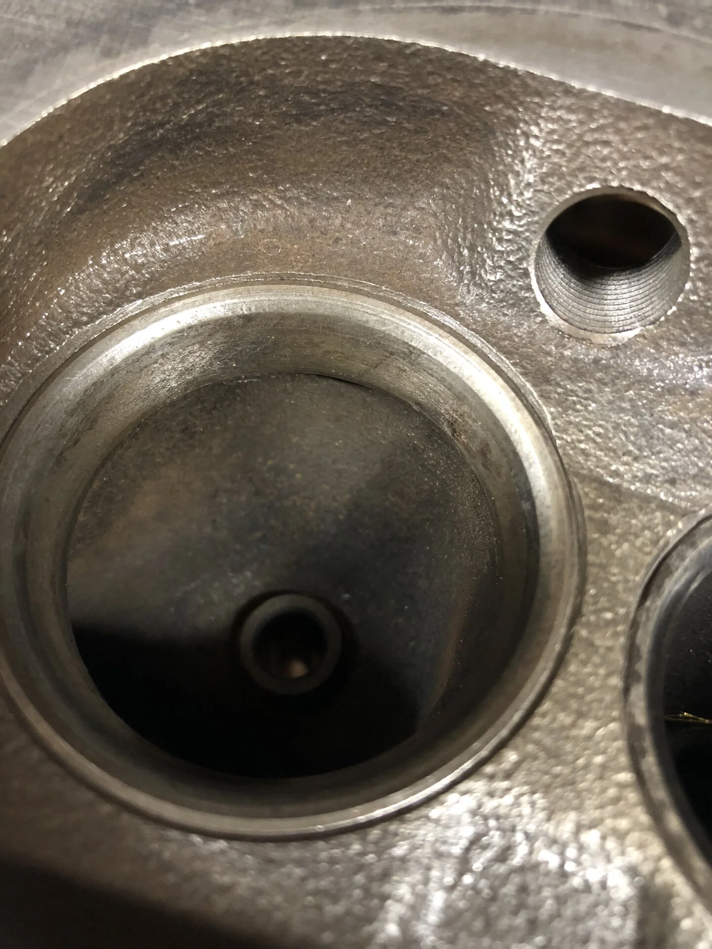

I’m on the fence with the valves and seats. I know the guides are worn and need to be replaced. I suspect I can regrind the valves and seats with a set of Neway valve seat tools. Just seems like a lot of work and the tools are pretty spendy for what they are and how often I’m gonna use them (once… maybe twice in my life?)
I’m not too keen on doing a shade tree valve lapping and calling it good. A machine shop is gonna be expensive, a long drive, and a long turn around time.
I’m leaning towards buying the tools and doing it myself. I can sell the valve seat cutters on eBay I’m sure. They’re nice tools.
Amayama has new OEM seats, guides, and valves. I’ve also sourced aftermarket parts from some of our reliable vendor friends. This could get very expensive very quickly or I might be able to pull something off with bare minimum tools. Any ideas or thoughts?

VERY nice tools. Those seat cutters are amazing. I watched so many videos.
Lapping isn’t hard at all. I did a few but then I lucked out and @TRAIL TAILOR contacted me that he had some Japanese valves. I went from there and used his gift.
I’m reading back here. @OSS prompted me to the compliments paid by @kirvesmies later… I always appreciate his kudos and saw yours too Chris.
But really when it comes to this work, I know YOU can do it. You’ve shown us your tenacity is great and worthy of this many banana task. Someone near you might have an old head to practice on? Or junk yard head? And old valves are easy… I might have a few for you to play w/.

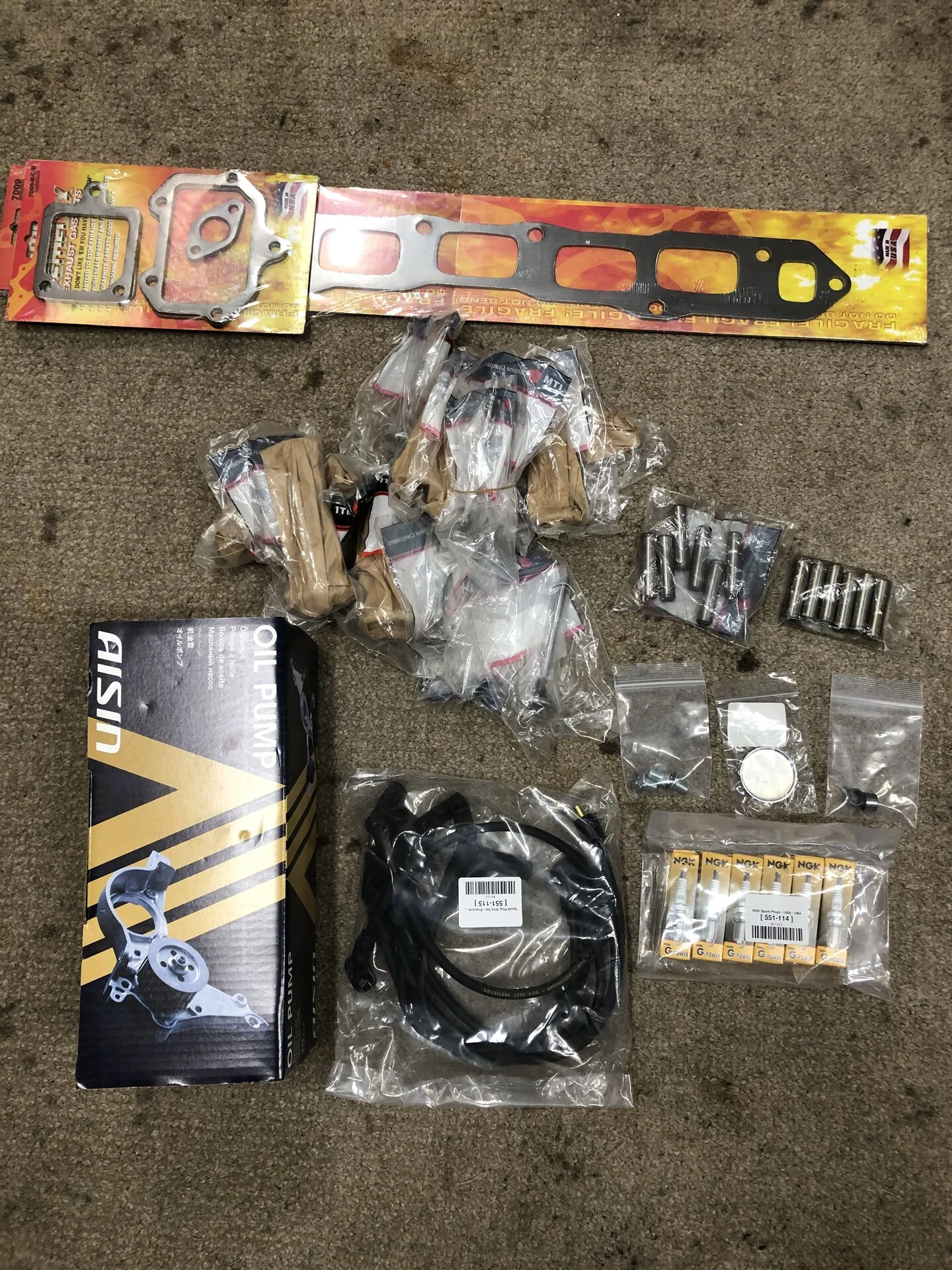

Collecting new parts too. Got new valves and guides. New timing plate screws. Cam plug. Spark plugs and wires. New Remflex gasket. New Aisin oil pump. I’m debating just getting new valve seats as opposed to buying a cutter tool. I think it’s gonna cost about the same either way. I’m not sure if I would need to cut the new seats at all or if they would be ready to lap right away. Any thoughts?

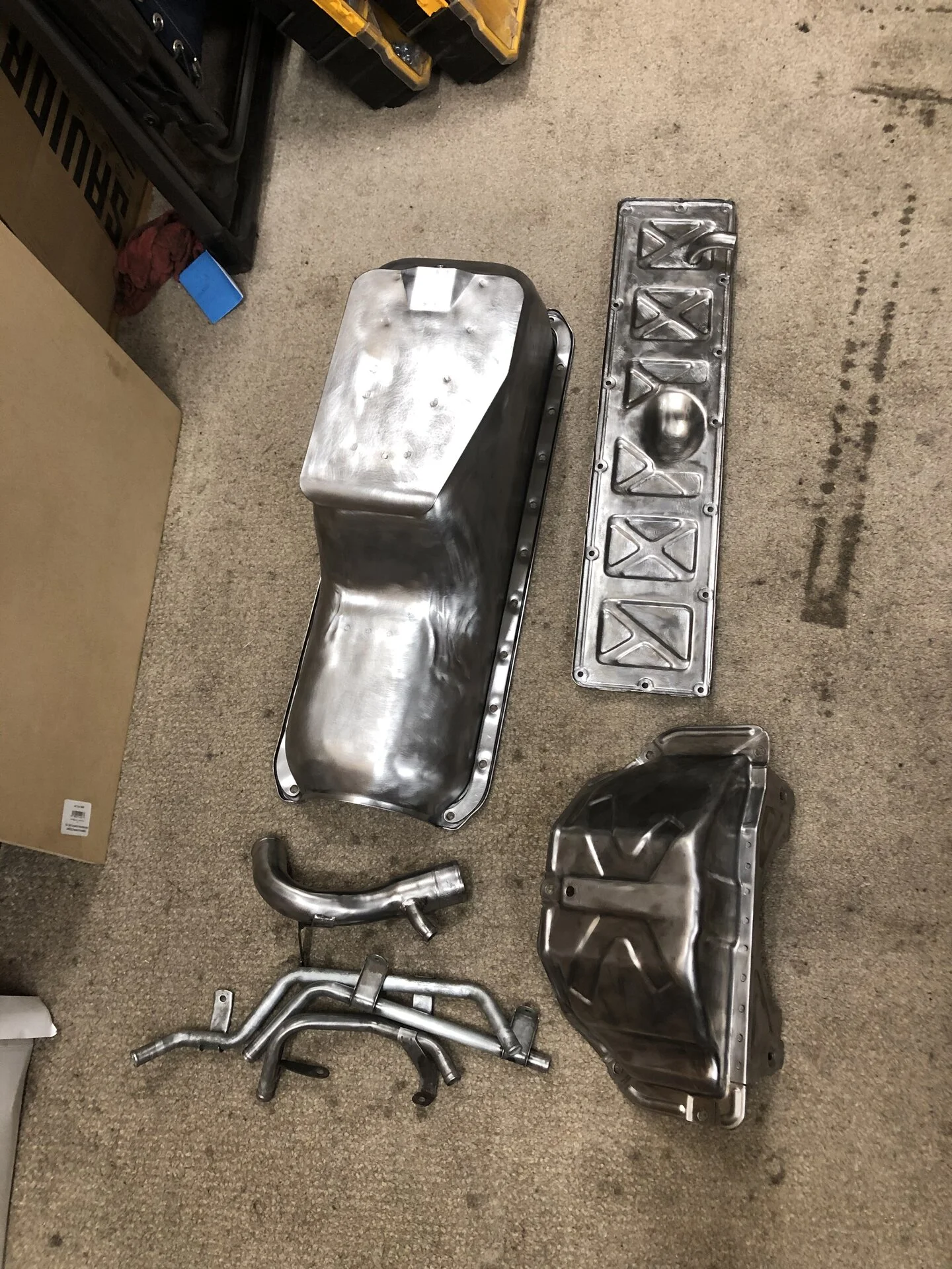

I got the oil pan, clutch cover, and side cover stripped down today. I’ll finish degreasing with acetone later this week and start painting them.

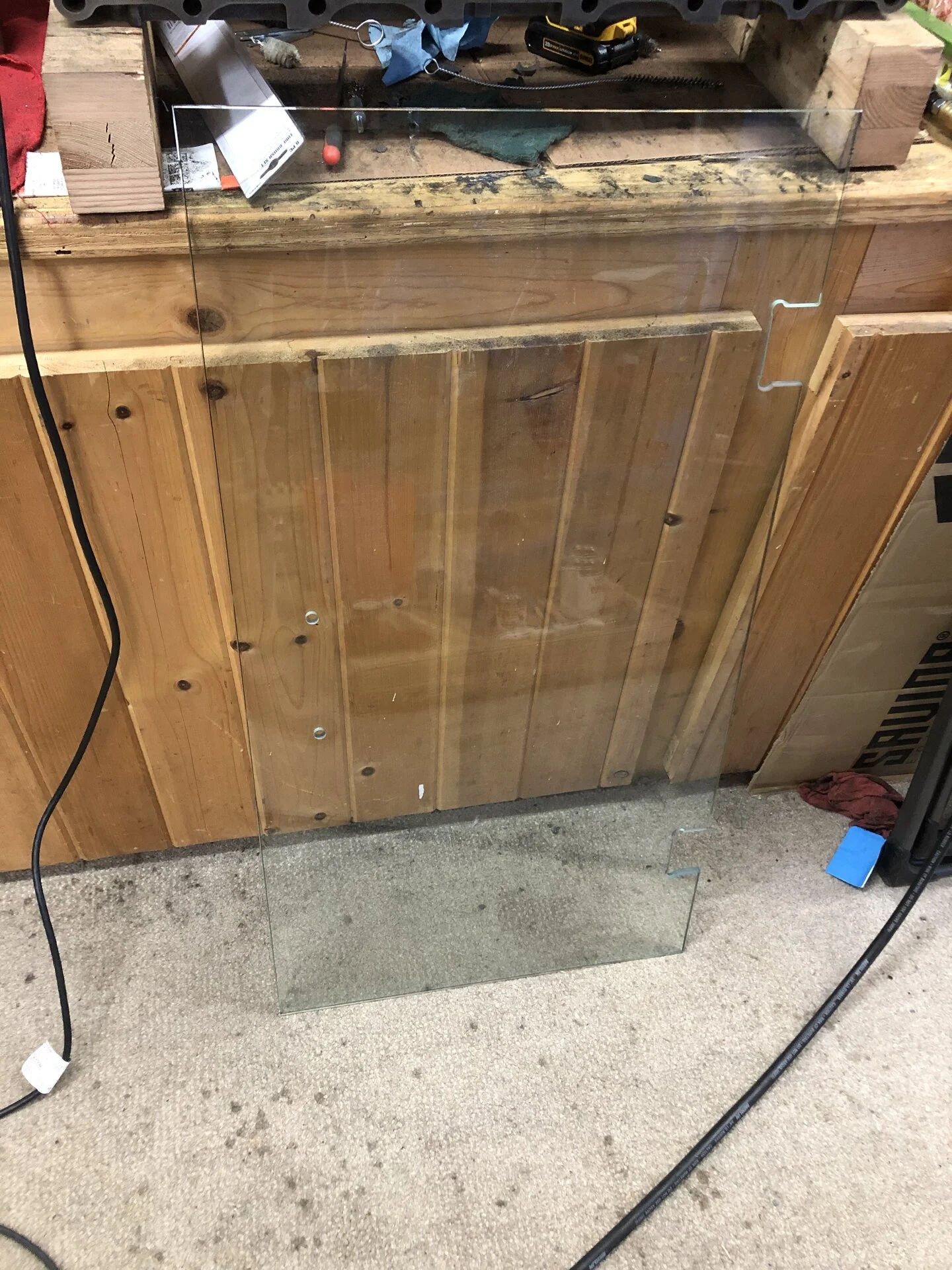

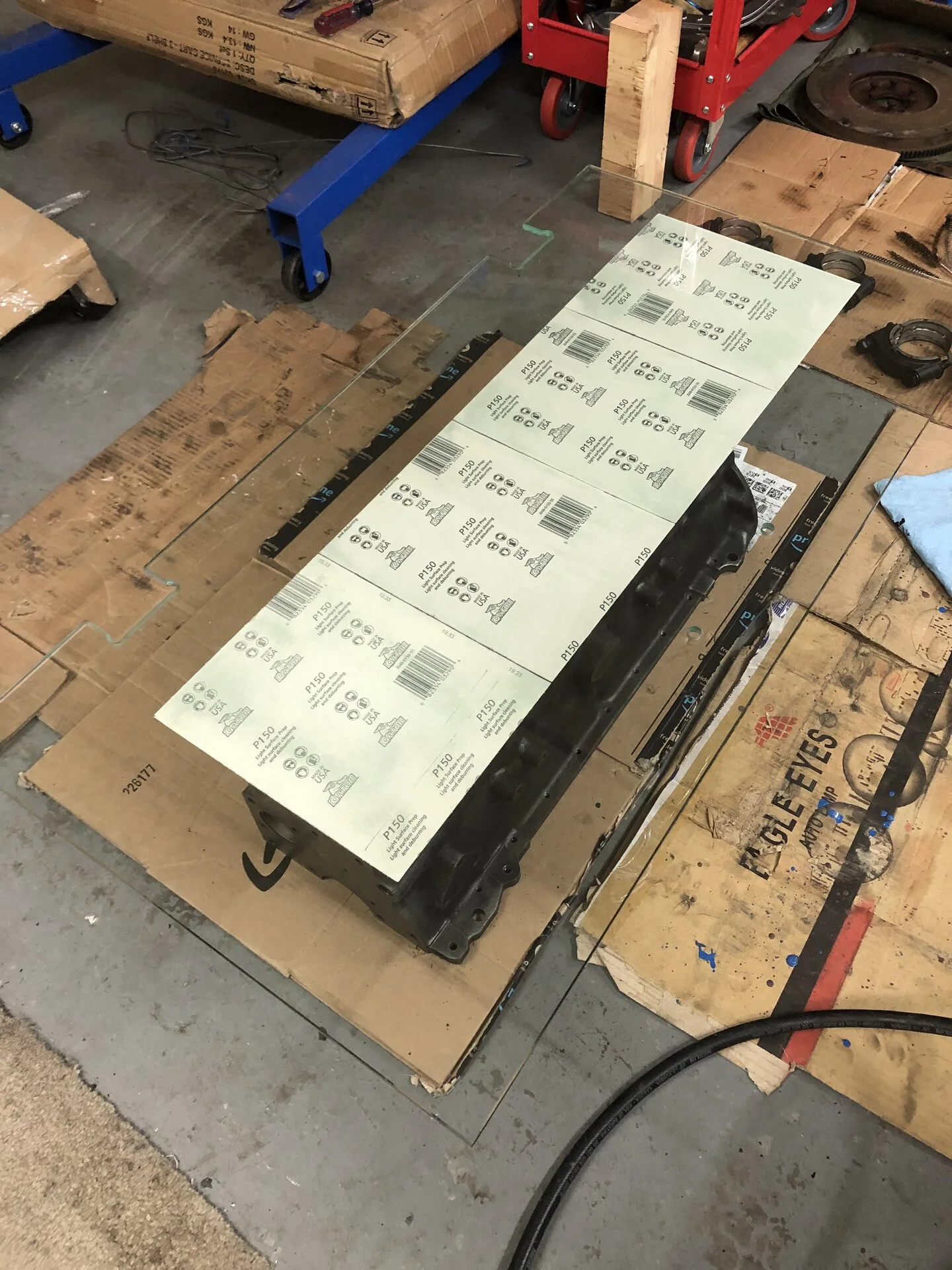

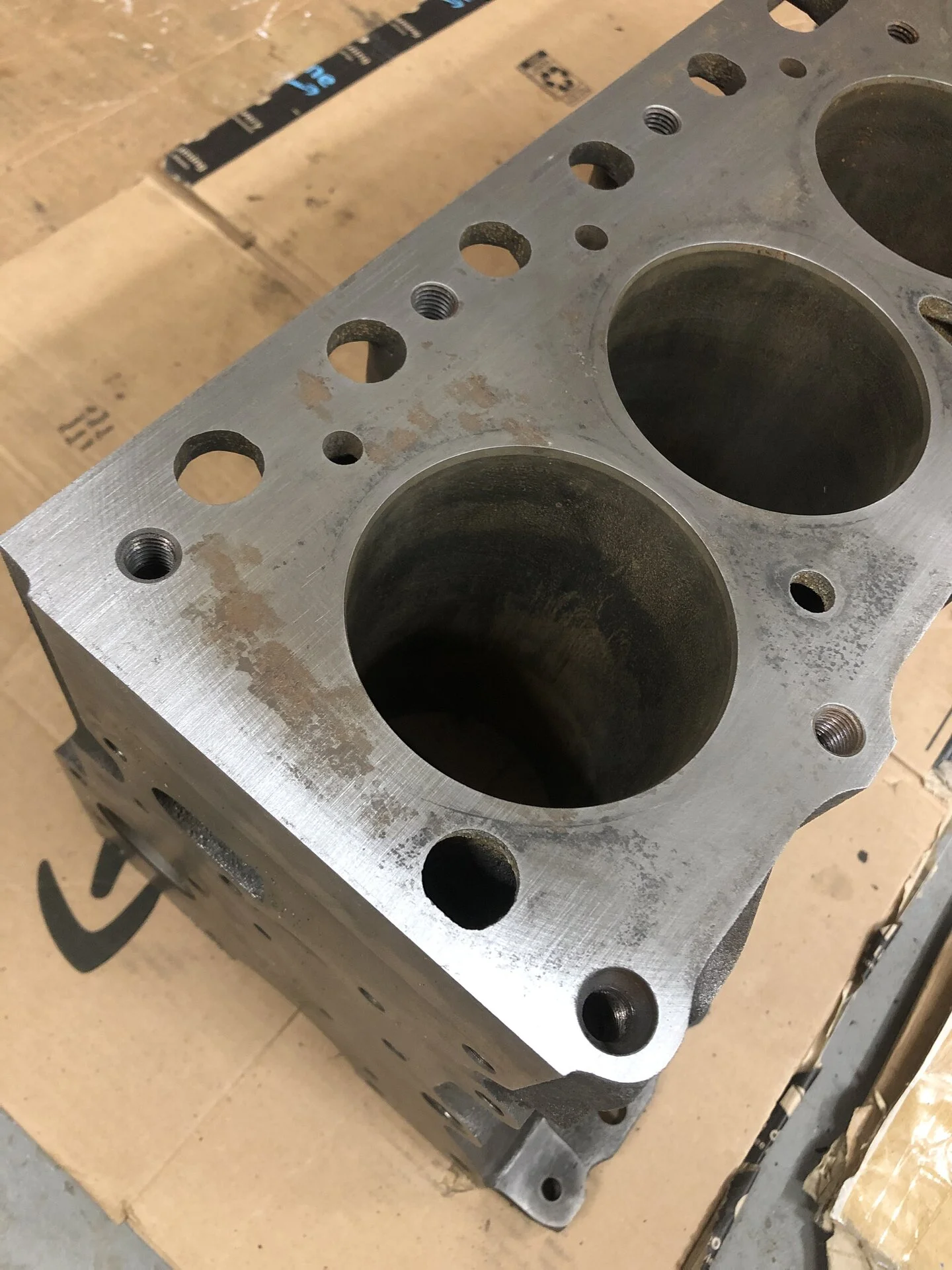

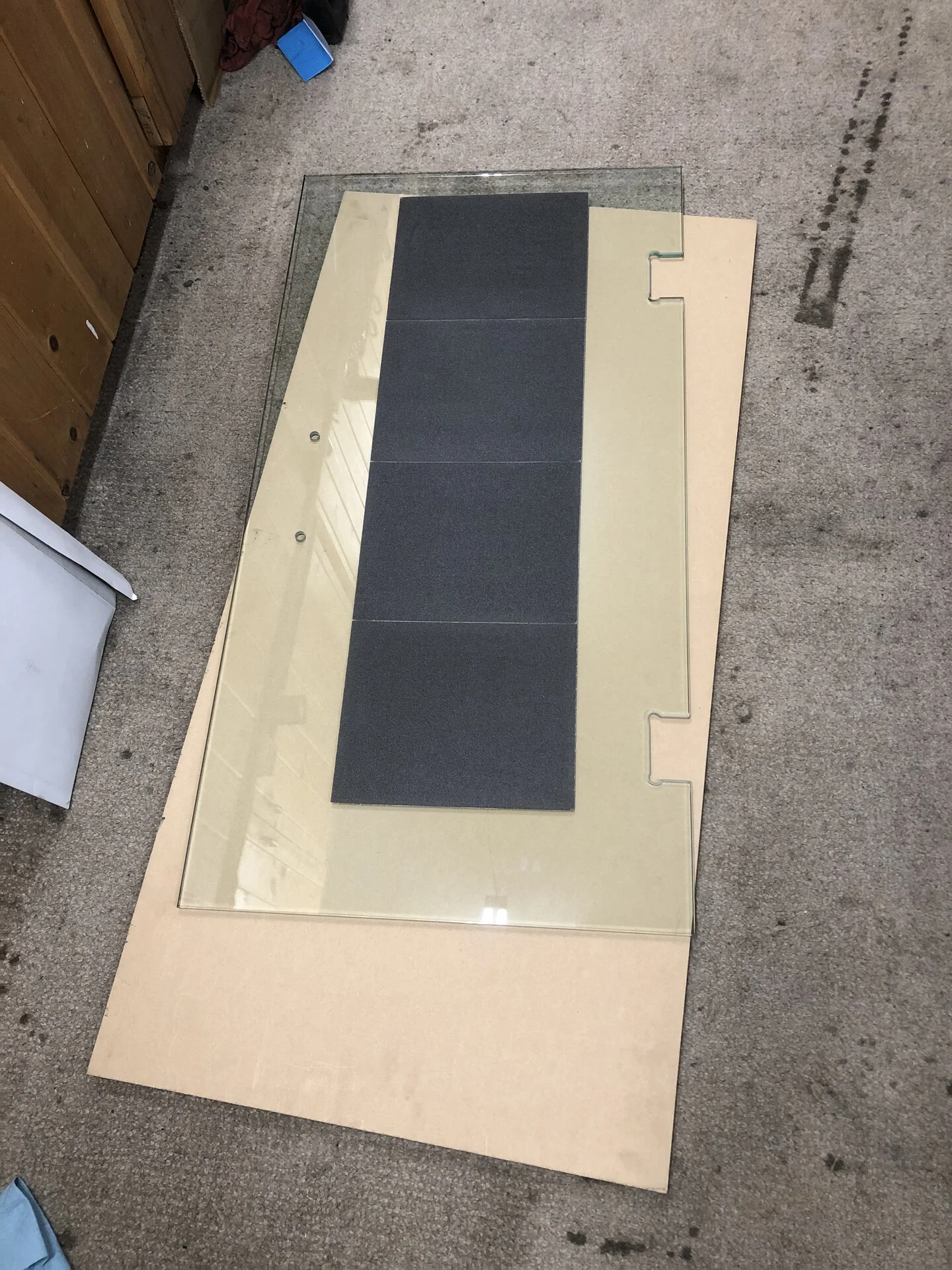

Here’s my solution to slightly warped/pitted mating surfaces.
150 grit Emory cloth is doing the job slow and steady. I simply sprayed the back side of the cloth with 3M adhesive and stuck it to the glass shower door. I’m using it as a sanding block. Sit on the floor and “row”… and row and row. It’s gonna take a while to get through all the mating surfaces I plan to flatten, but I paid nothing for the glass. Emory cloth is pricier than regular wet/dry paper, but it doesn’t break down as quickly and doesn’t leave grit all over the place.
I’m rotating the glass every 50 passes or so. I change positions as well to make sure I’m not putting pressure on one side or the other. Or if I do, it’s countered by hitting it from the other side with the same number of passes. Counting your strokes is key when flattening things by hand. Your body physics will cause imperfections so you’ve got to mitigate it to the best of your ability. I do this all day long at work on a smaller scale. Literally hundreds of times a week.
@cps432 Awesome idea on the shower glass! That stuff is alot tougher than most people think. I've checked hand planes this way as well, with a smaller piece.
