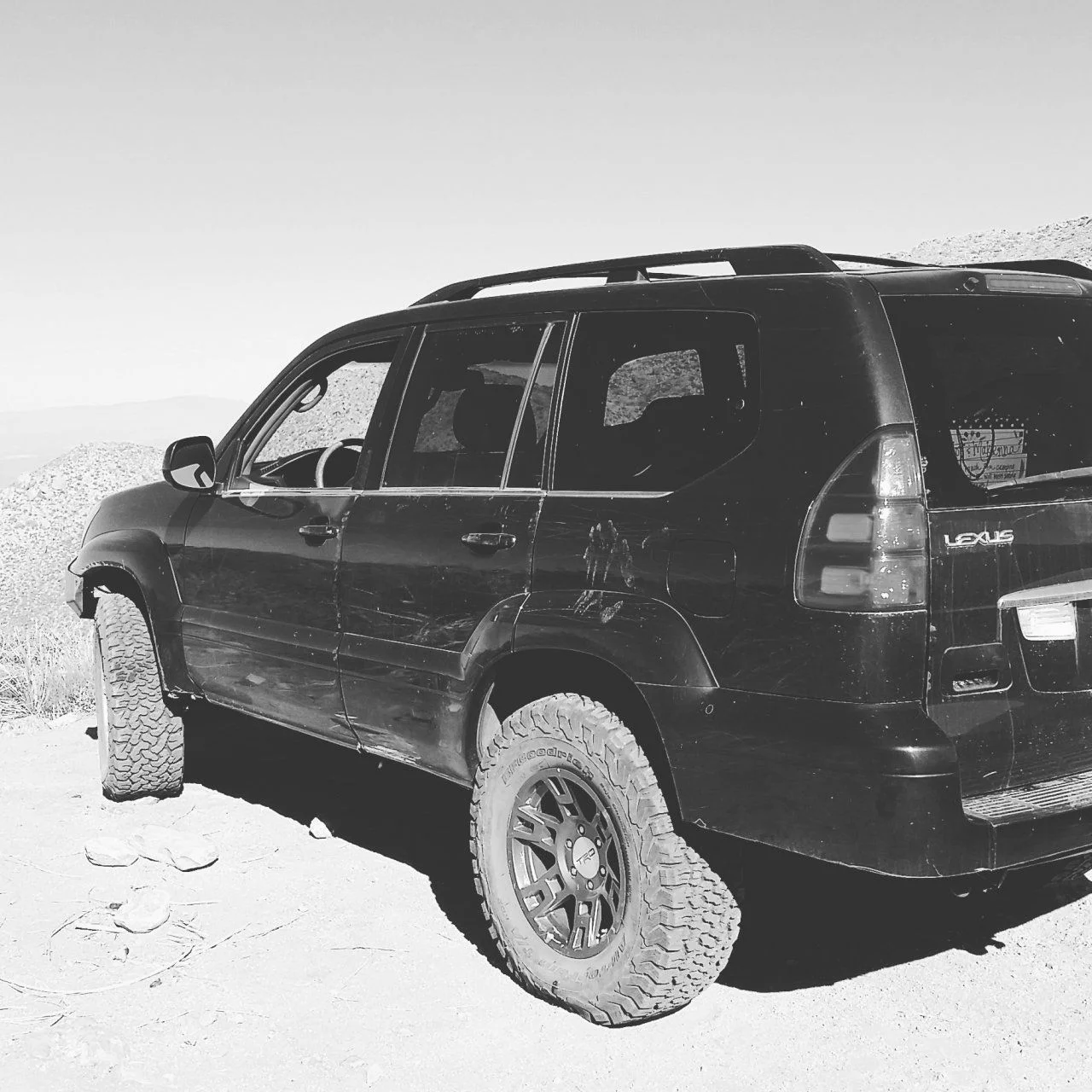

My GX has been the most problem free truck I’ve ever owned. I’m different than most as far as opinions go. I wanted non KDSS, non VVTI, and non nav, but I ended up with nav. KDSS is worth nothing to me since I don’t even run or have use for swaybars, as a high quality set of coil overs will do wonders. Non VVTI isn’t even noticeable, as someone said it’s only ever so slightly noticeable on the big end of the tach, and my truck is hardly ever there, and I prefer to be able to do cam seals with the cams still in the truck as you can without VVTi.
I’ve owned my GX for 5 years and it’s been offroad all over the country. Comparing a GX/LX/whatever to a solid front axle truck is foolish, it’ll never flex as well in the front, but thats literally the only thing it isn’t light years ahead on when compared to a Jeep for example.
I’m no longer a hard core wheeler and use it to get to fun places to camp, swim, and get away from people. The suspension consists of full Radflo mid travel, TC uppers, MT upper and lower trailing arms, and Dobinsons progressive long travel rear springs. It rides like a Cadillac on road, even with 700# front springs, and will scare you how fast it’ll go in a wash or rutted forest service road without spilling your double mocha soy latte.
Edit: another reason for 03-04, it’s almost comical for what you can pay for one now. They’re dirt cheap. And everyone who’s says 05 and up for the extra power and then says they run regular 87 is a walking contradiction.
