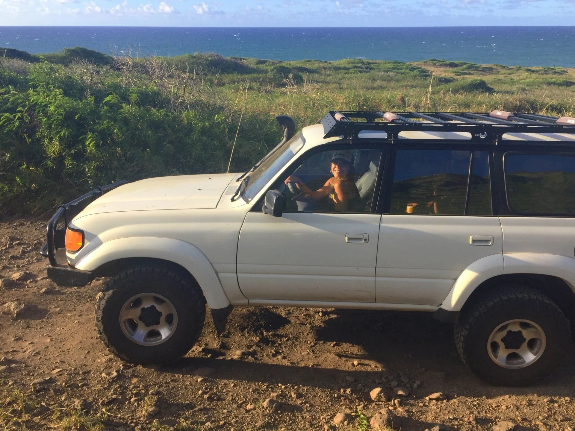

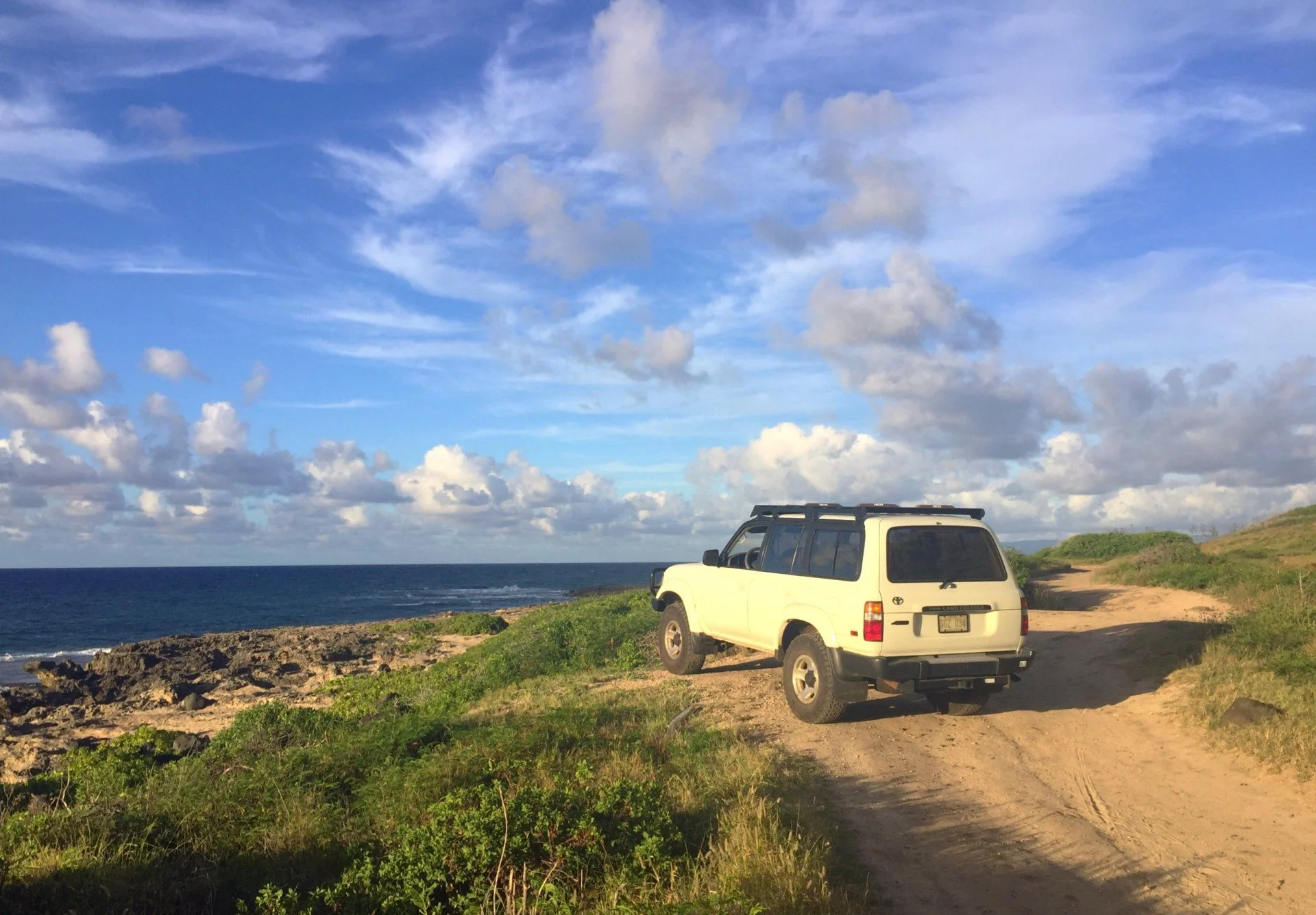

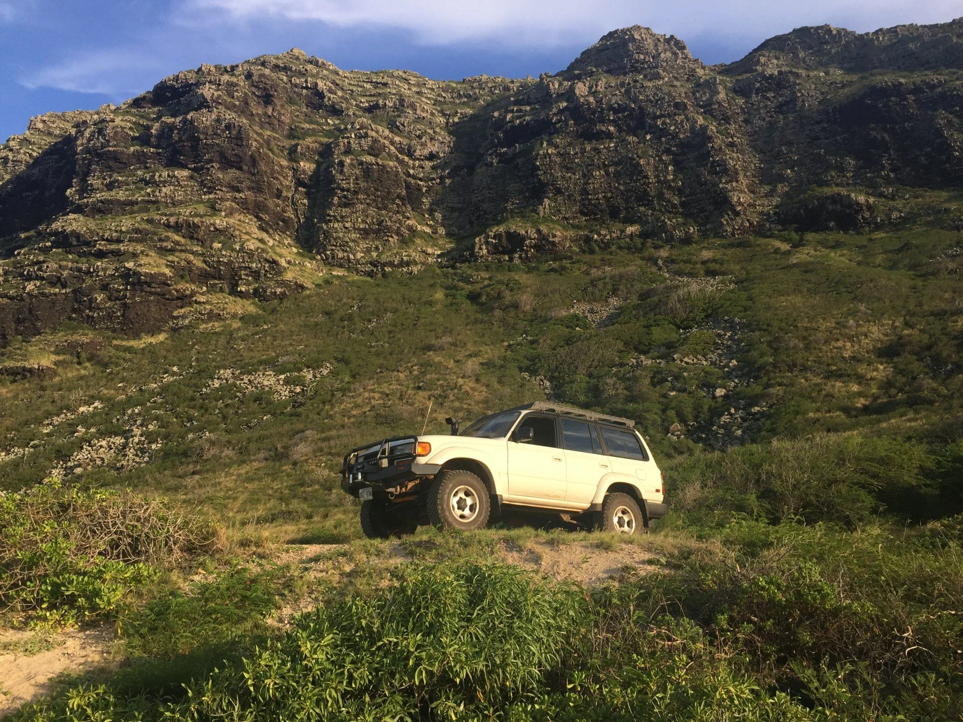

Since you asked for pictures, I can certainly accommodate that request. I don't know where my white 80 falls on the creamy scale, but it's seems pretty nice and creamy to me!

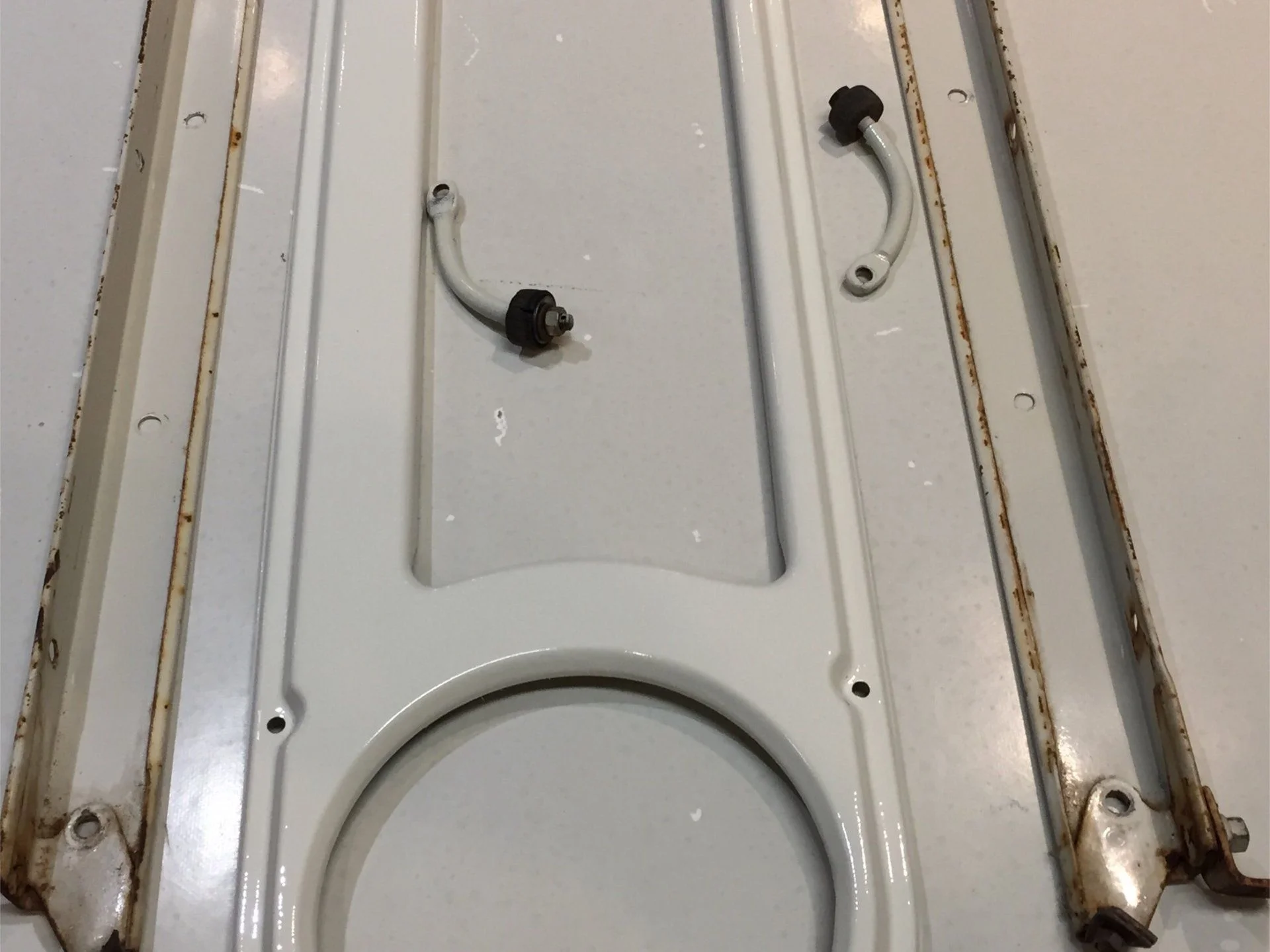

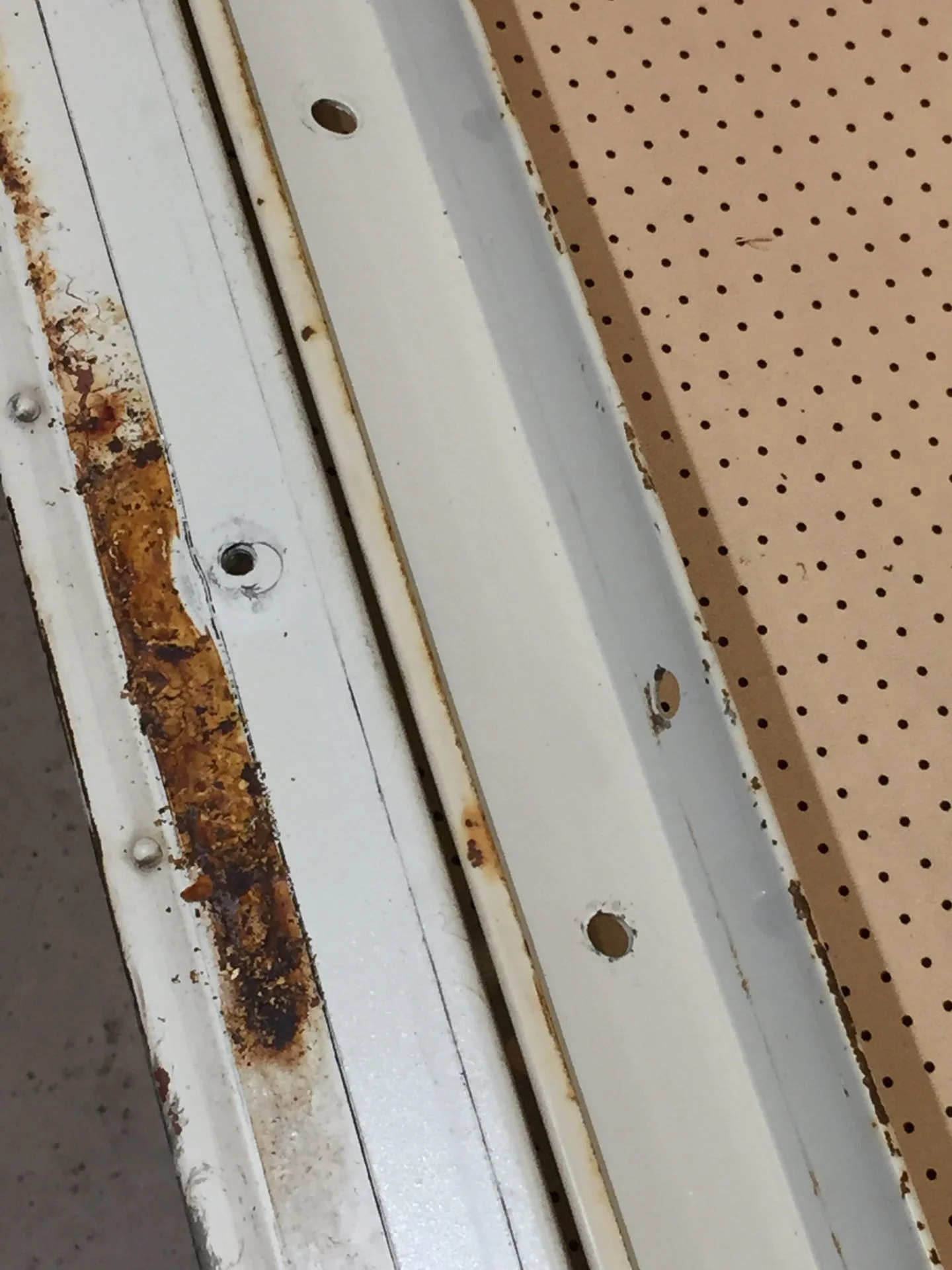

Been awhile since the question was asked. Figured I’d post some pics before I delete them from my phone
Picture was taken on my 76 40 lid. Bezel was repainted by me using spraymax 2k mixed in 033. Front door header channels came off my 71 cygnus white 40. Door stops were painted by me using PPG OMNI single stage (supposedly T12 Cygnus)
The inside of the Cygnus door headers have not been exposed to sunlight. It is the most creamy white in photo. The omni door stops have a green tinge and is not creamy like the OEM Cygnus. I was told by the paint jobber after the fact, PPG has higher end paint with better color match results.
The 033 is nice and is what I’m going to use on this lid.

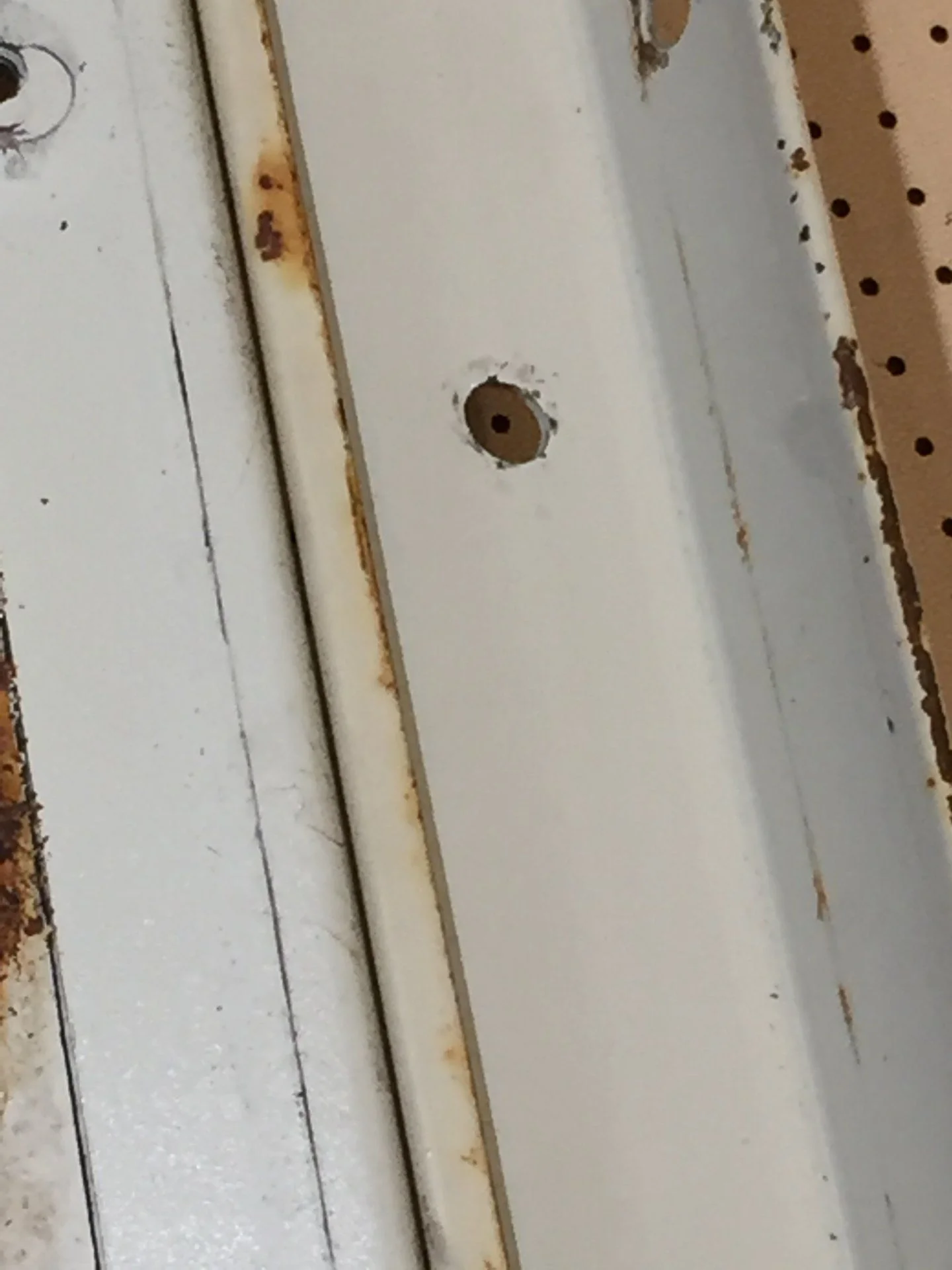

Right is the door header I seperated to find non faded Cygnus. Left is underside of roof metal that has been out of sunlight.

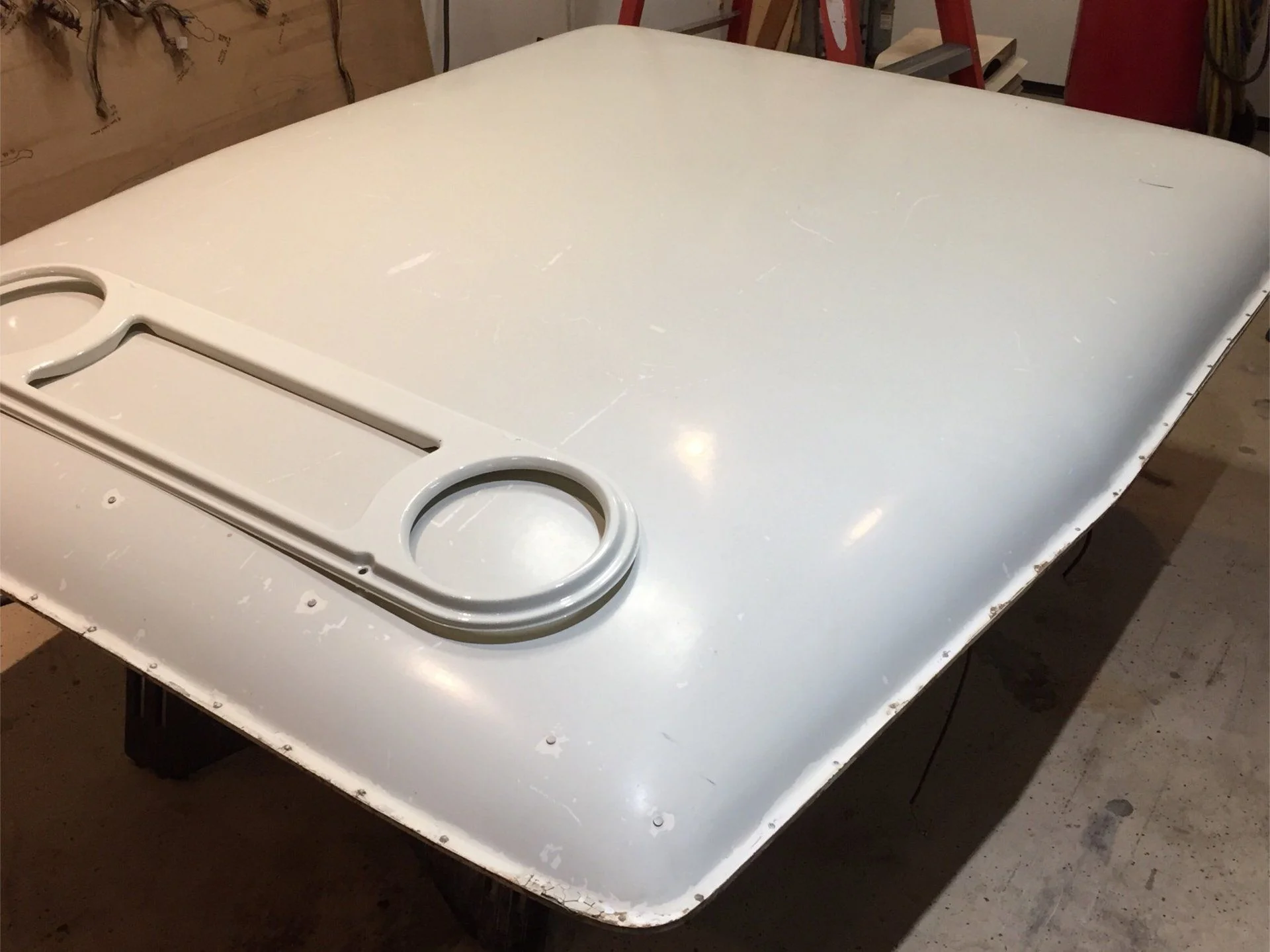

033 bezel and original color of 76 top. Before sanding

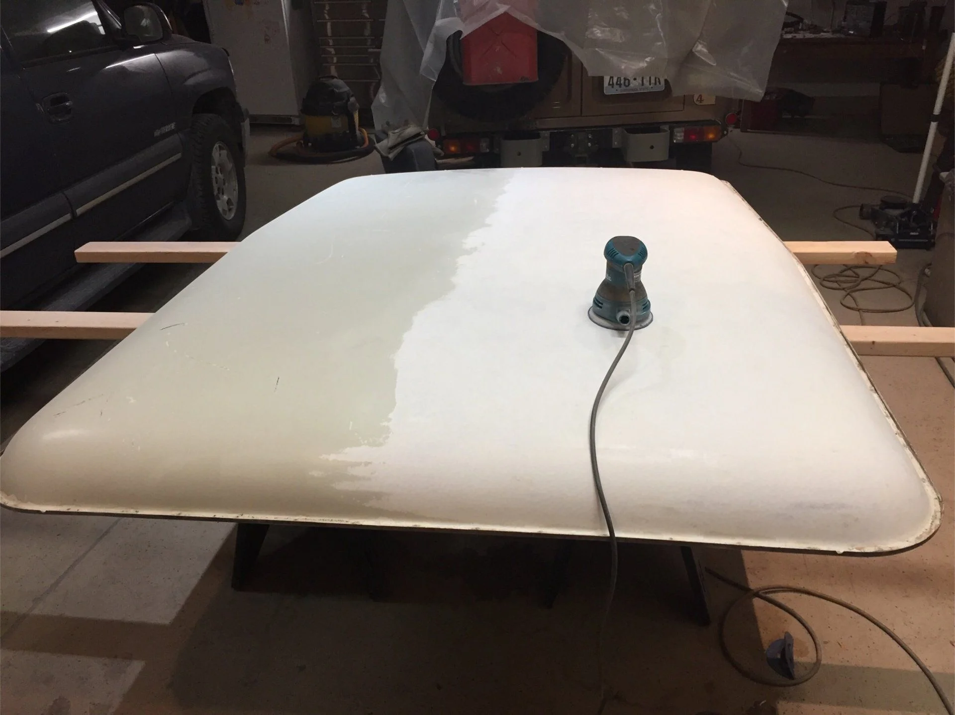

Just to show how top gel coat all off a sudden doesn’t look so white. :beer: Right is the area I sanded.
