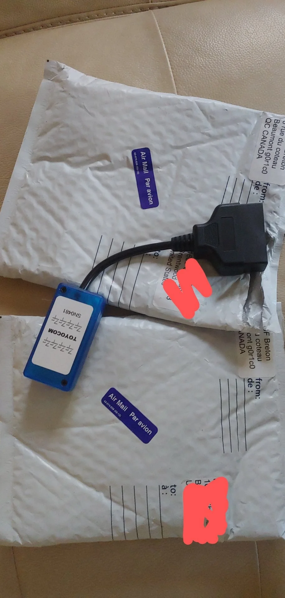

Toyocom OBD1 Bluetooth available again
Just received mine, will be hooking it up soon to check out all that i can see!

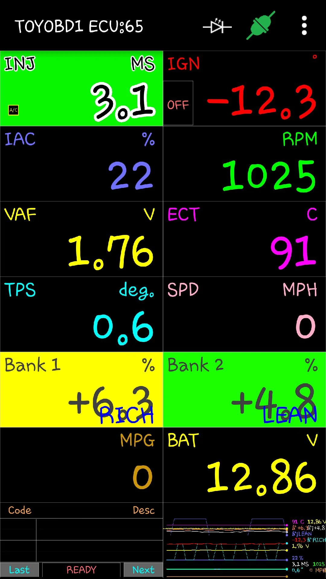

Besides changing from C to F and I've also removed the graphs, anyone have any display information feedback or customizations for their 93' TLC?
I'm just curious other than what I've got displayed, what is most useful to everyone else.

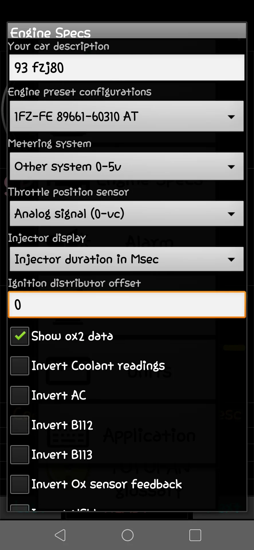

I have about the same, except I calibrated for the 1FZ spark so it isn't in negatives and for the reversed connections for AC and such.
How did you calibrate it? Is that in the 'Configuration' menu? I tried to find my engine (1FZ-FE), but I don't see it.
I can try and take some screenshots later for you, I didn't take my Land Cruiser to work today. You'll have to adjust the offset a bit for non-USDM LCs, but should be close to mine
Awesome, thank you very much sir!

Just hooked mine up and pretty happy with the parameter choices.
My main focus is on the ECT and the O2 sensor readings during travel to our designation. Would be nice nice what everyone is calibrated theirs to since our 1fe-fz is not on the list yet.
