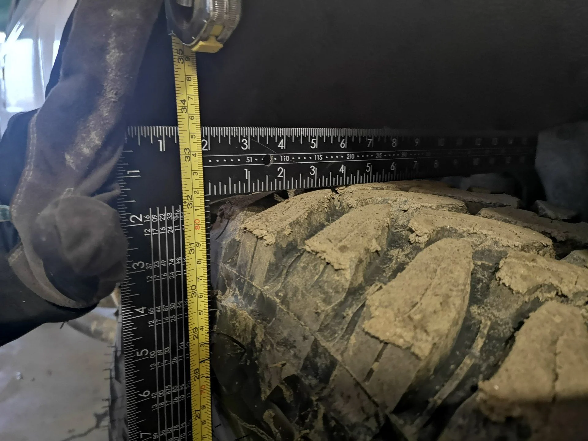

At 32psi they are a hair over 32" tall on flat ground. So maybe 33" unladen.
Measured like this.

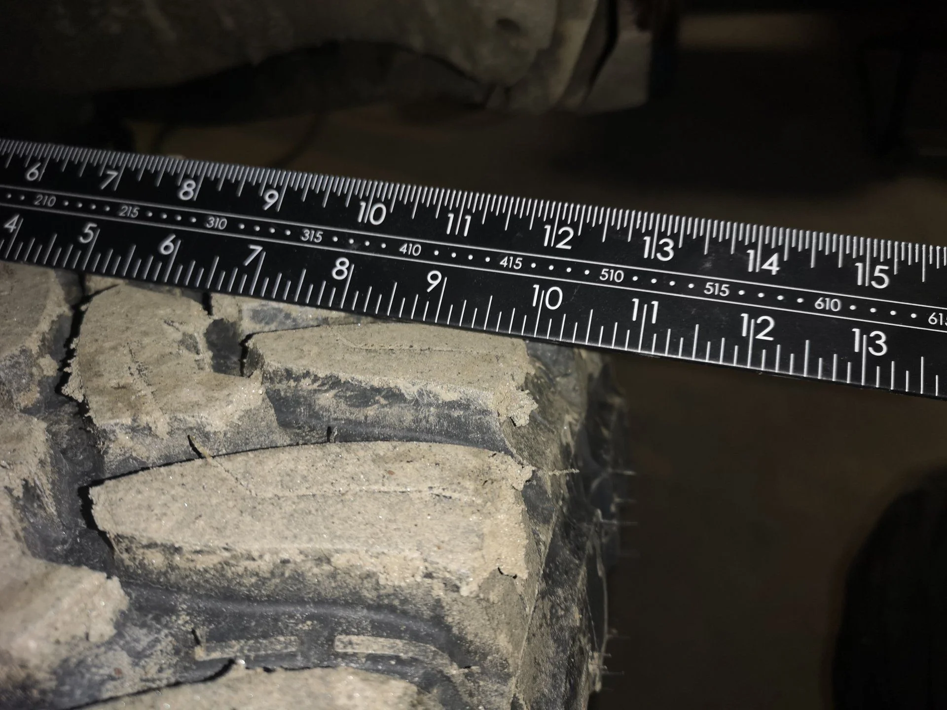

Actual thread contact width is just over 9" on the widest lugs.

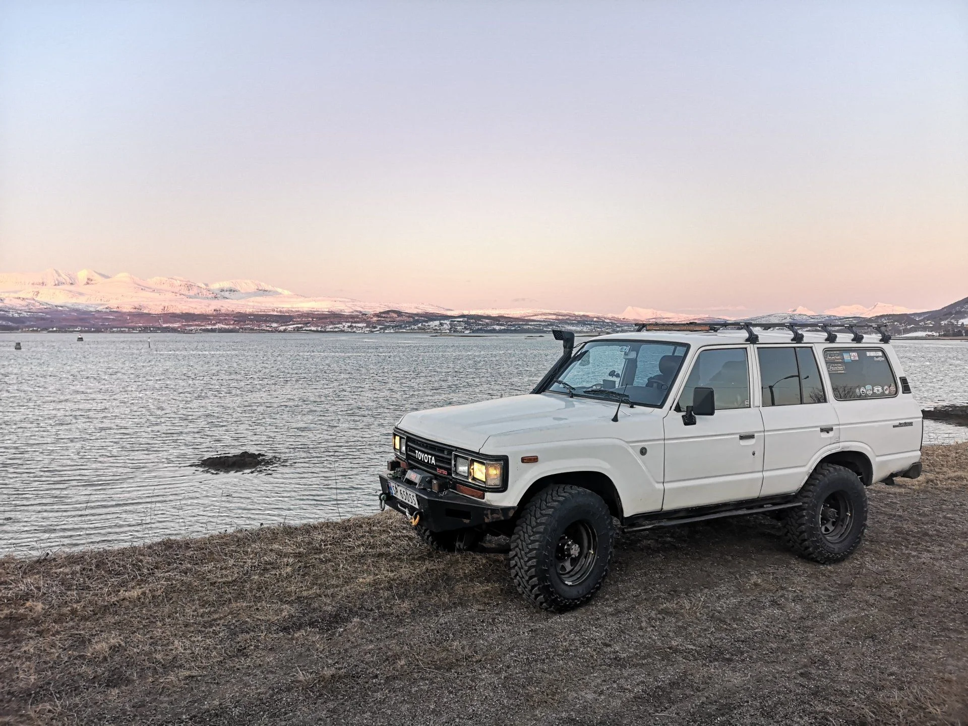

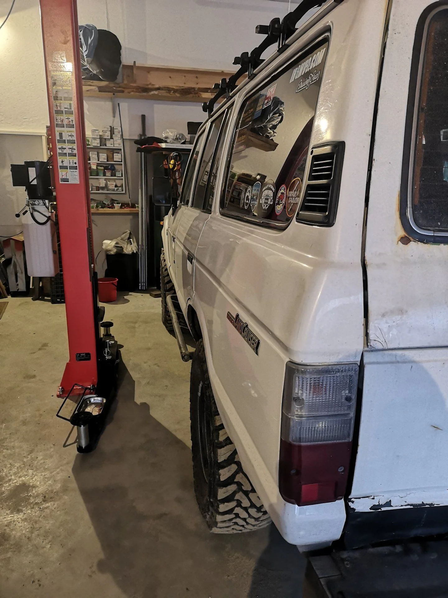

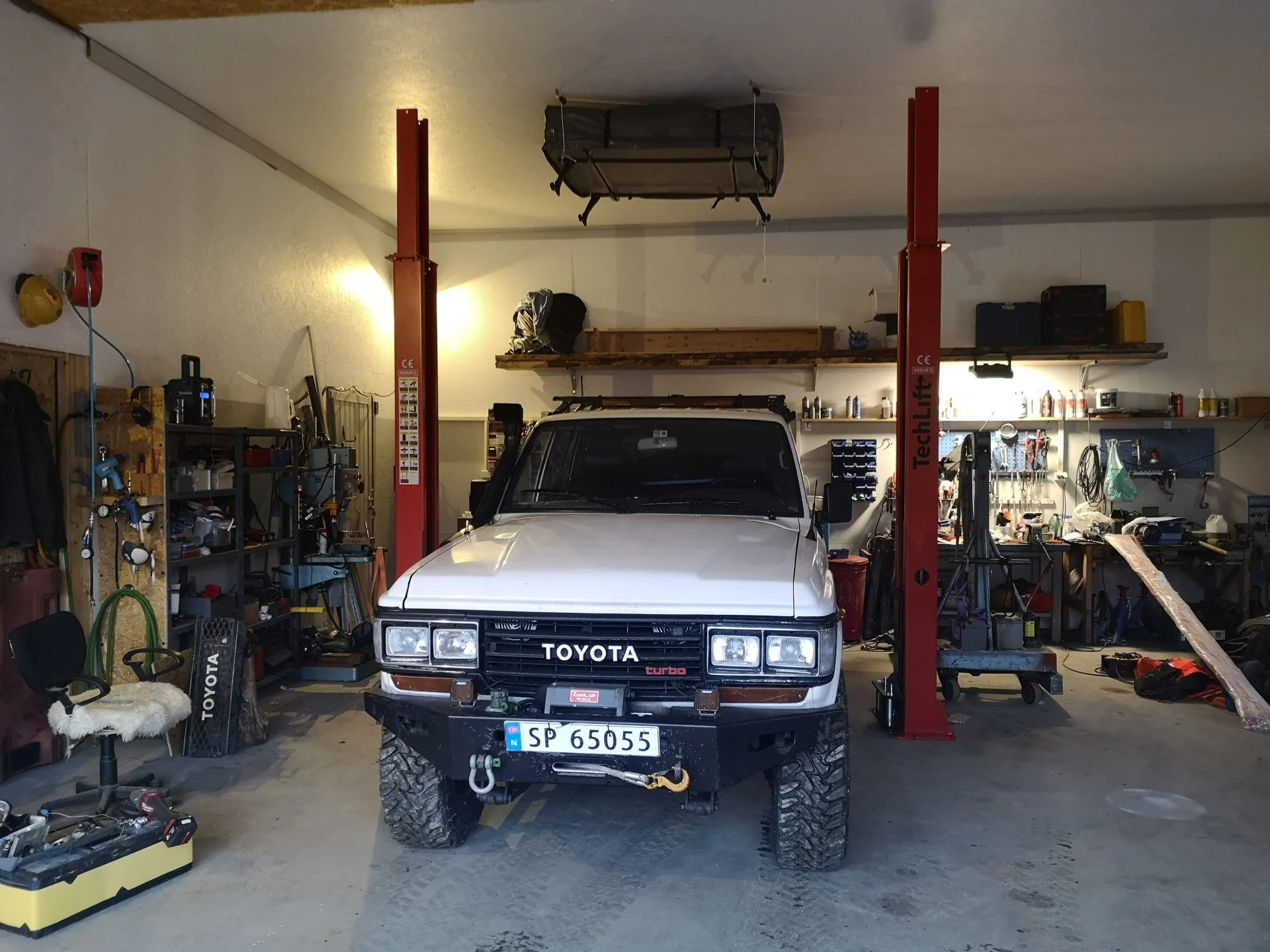

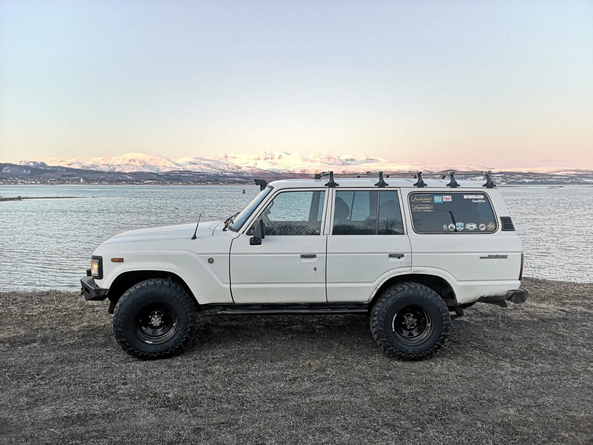

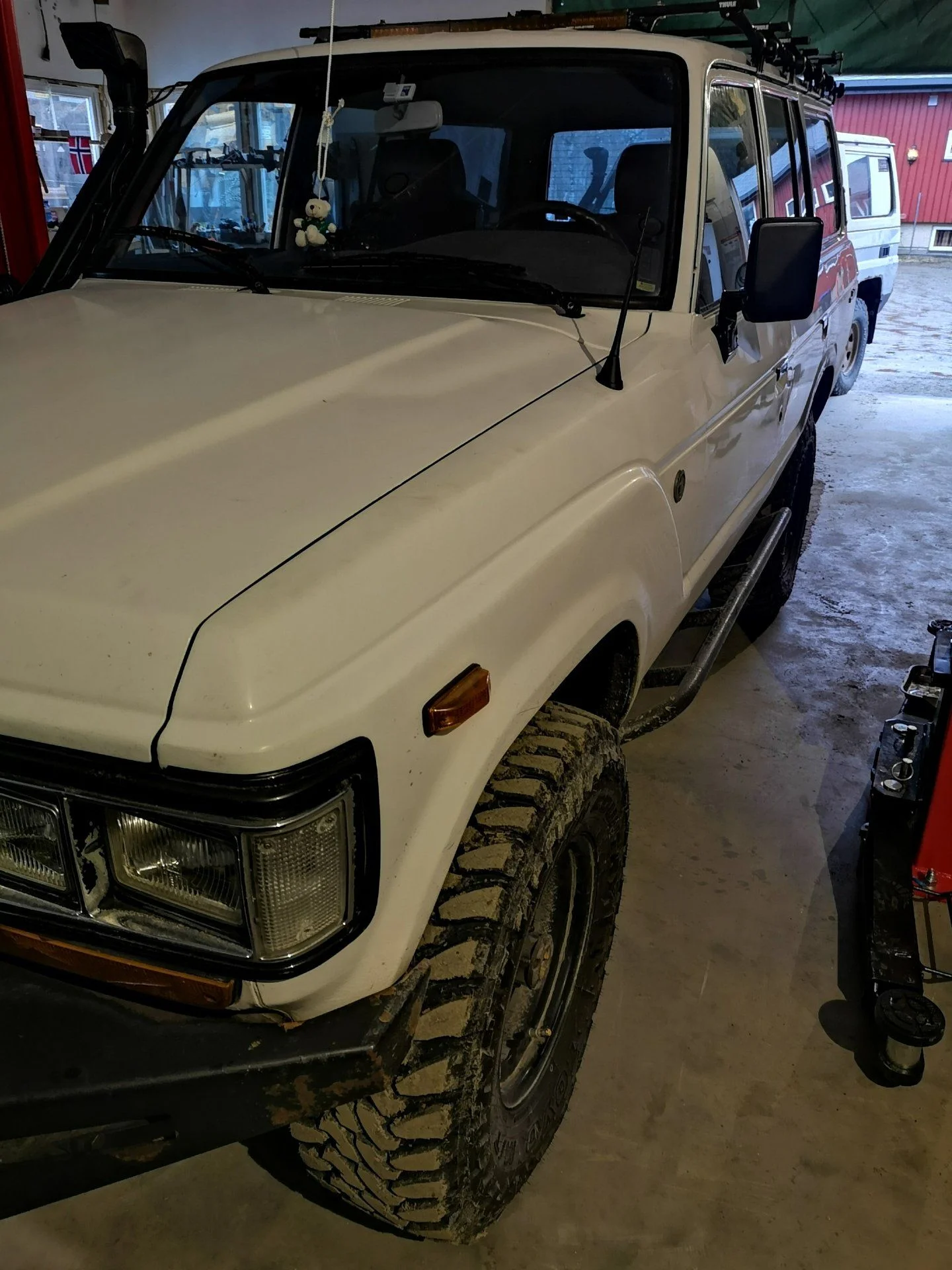

So how do they look on the cruiser? I must say, lovely! not biased at all!
Rear is just within fenders, fronts have thread right at fender line.

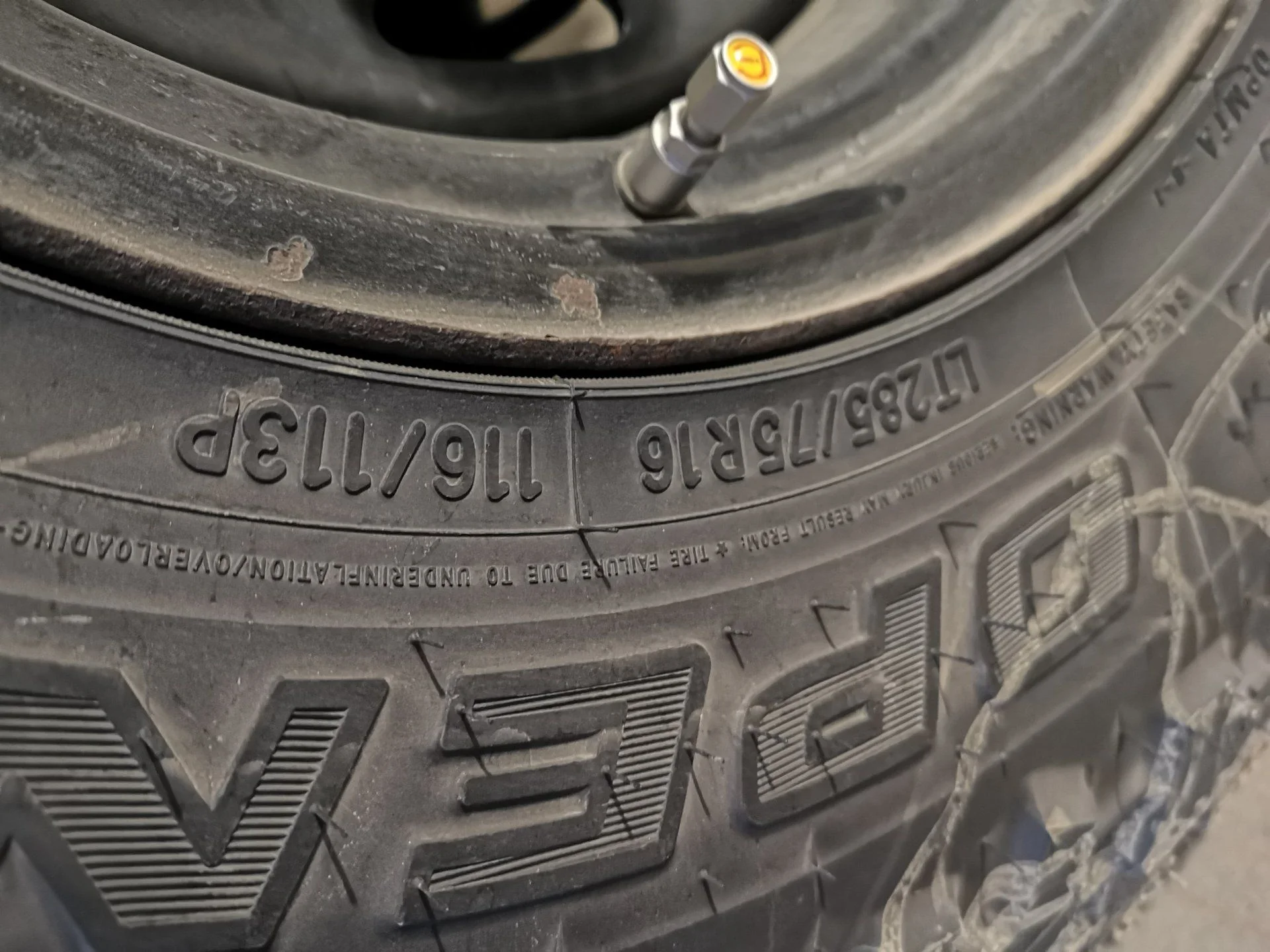

Hmm, now that I looked through the photos, I find mine says 116/113p which would be 2535 lbs. No worries, that's still x4 =10140 lbs/ 4600kg. So mine is maybe a different product code.

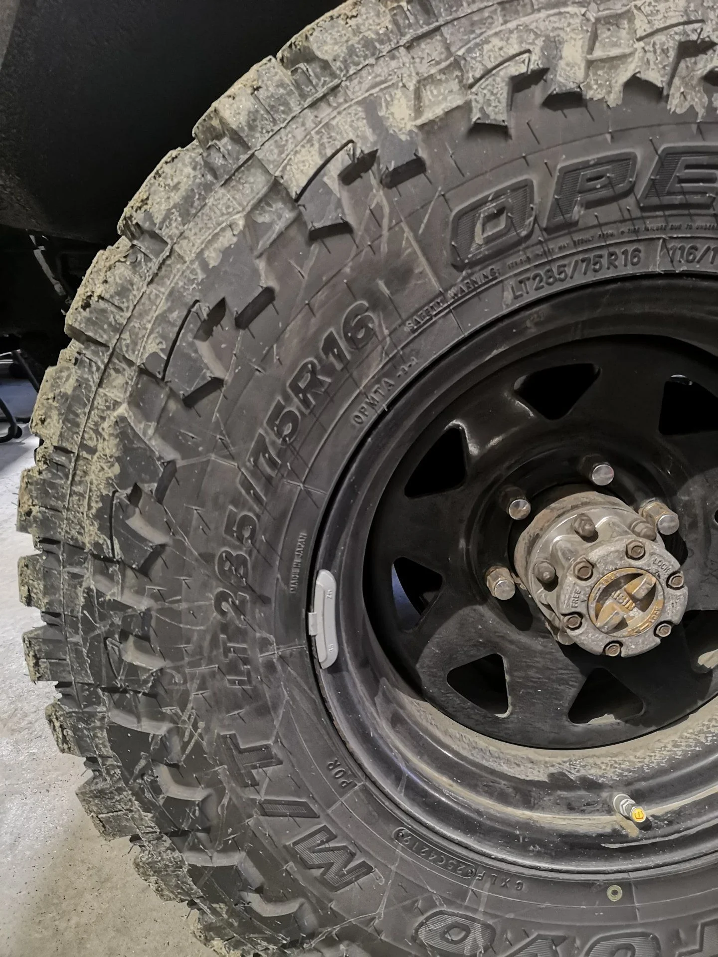

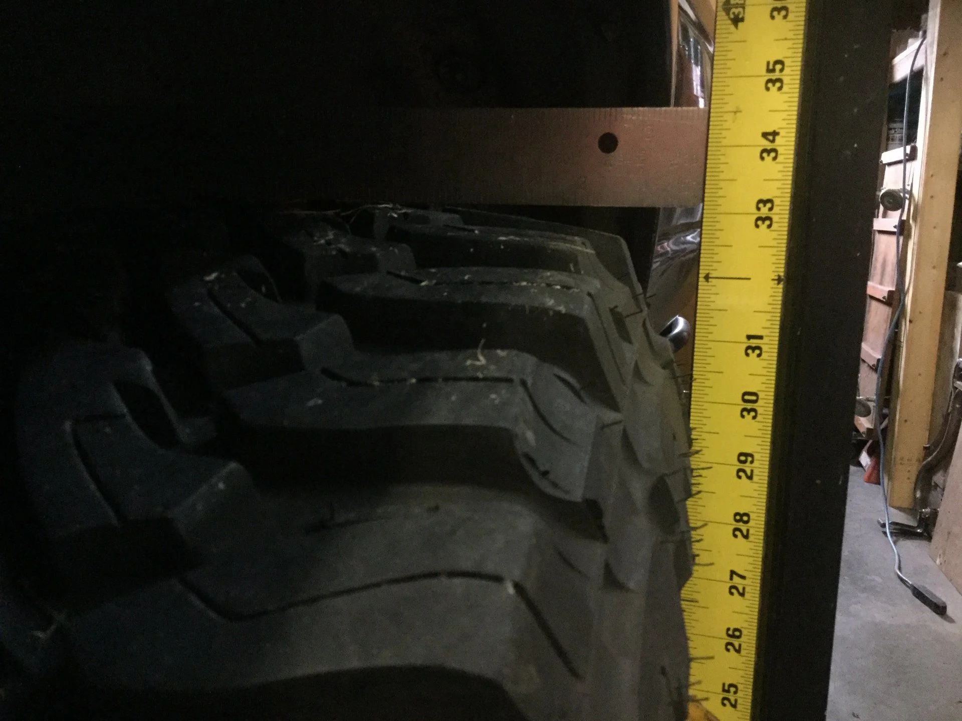

TOYO MT 285/75R17 on 17x9 3.5” backspace or -25 mm offset. 32 PSI
This is also the front left tire, full weight of 12HT on it. Fully loaded in travel mode I run
about 38 PSI front and 40 PSI in rears. They were closer to the advertised 34” when new
I measured them but didn’t copy it down anywhere. My third set so I’m used to them.
just over 33” but these aren’t new tires. Probably close to 15,000 kms on them

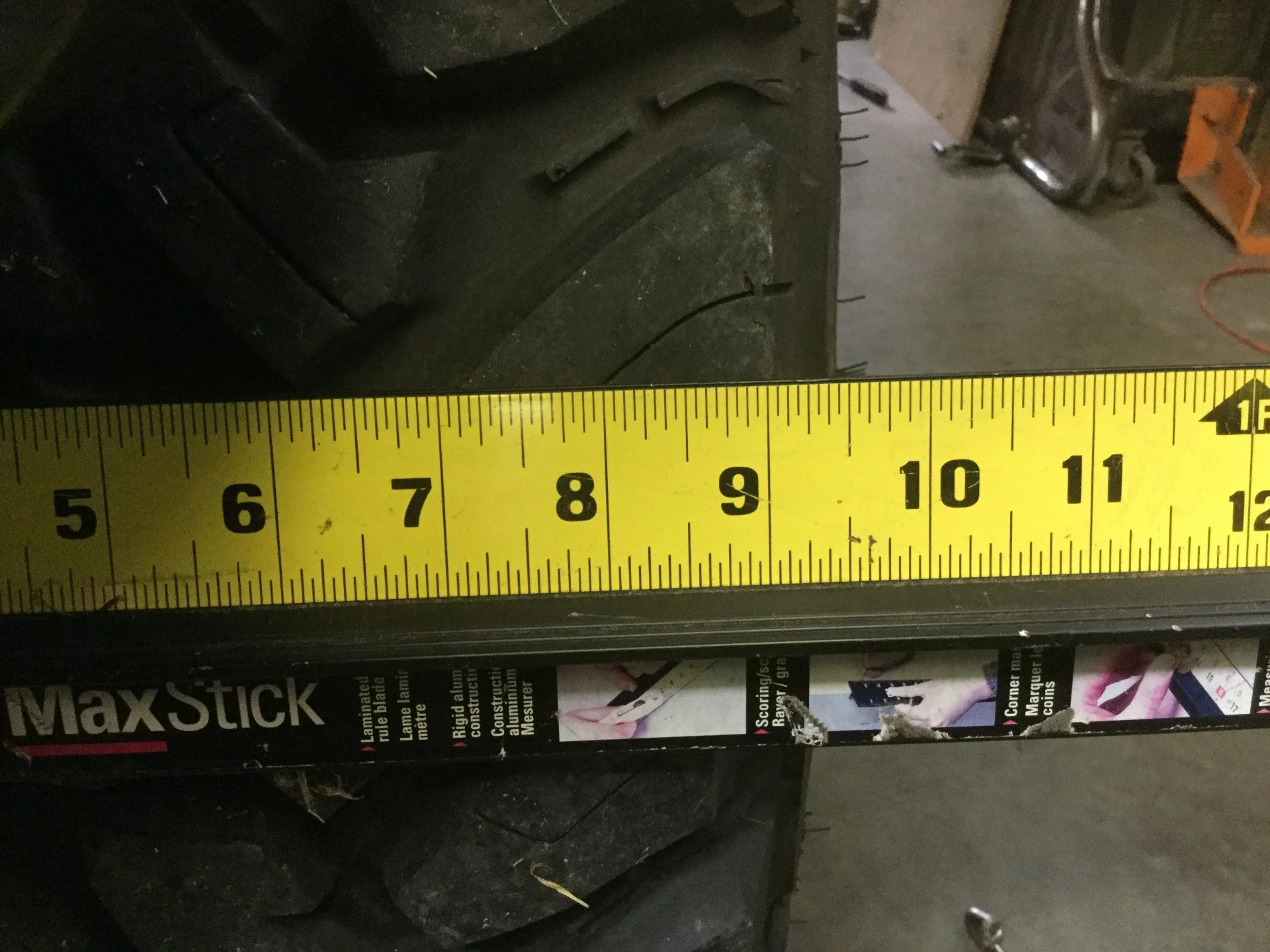

Tread width is close to advertised 9”

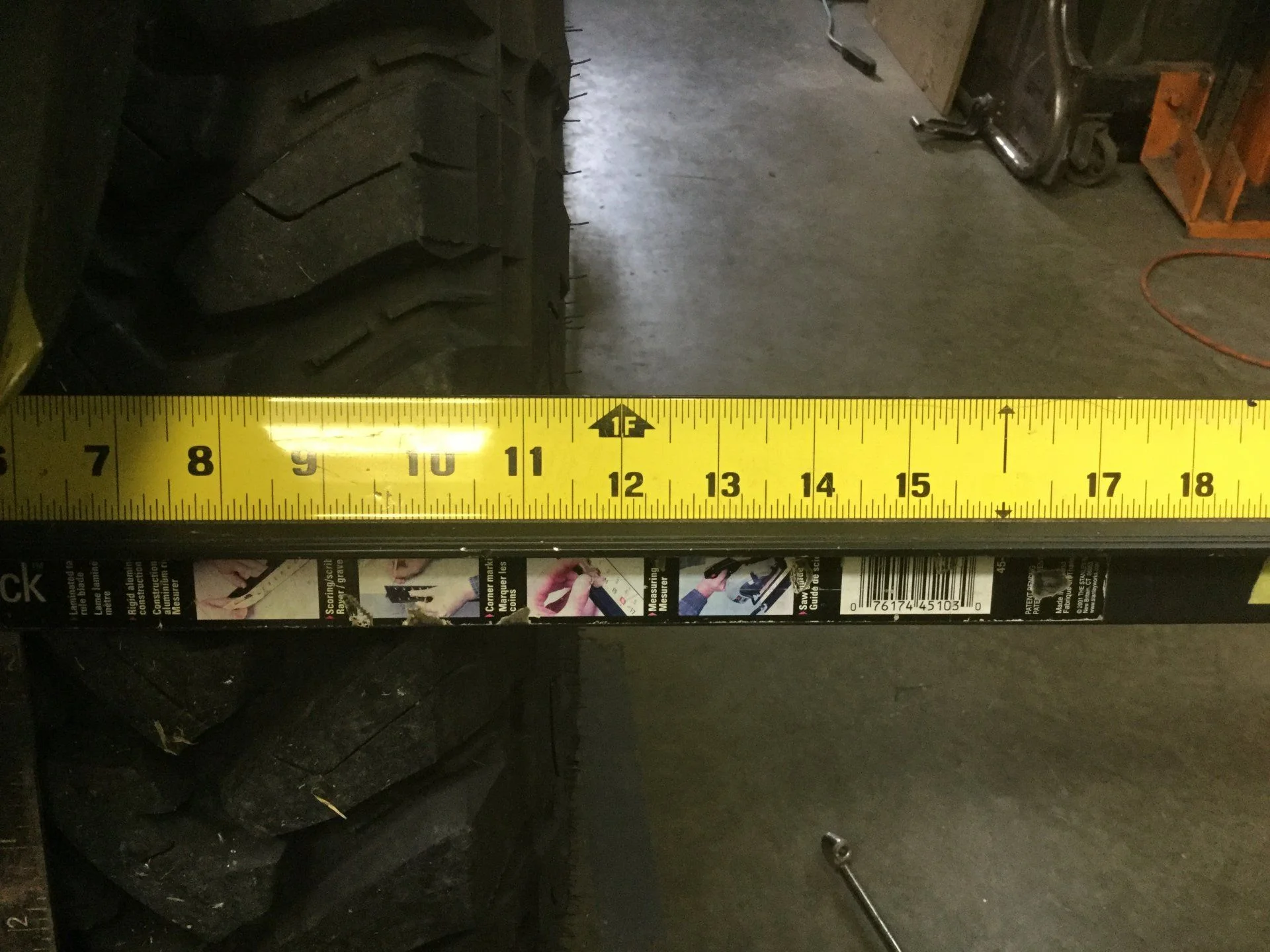

Section width as advertised in specs 11.4”
