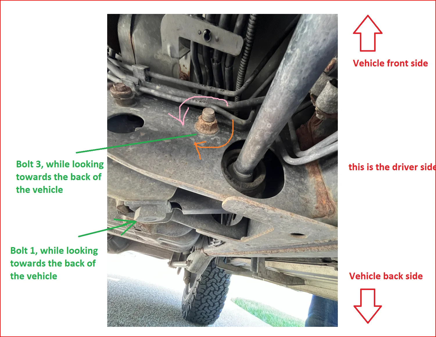

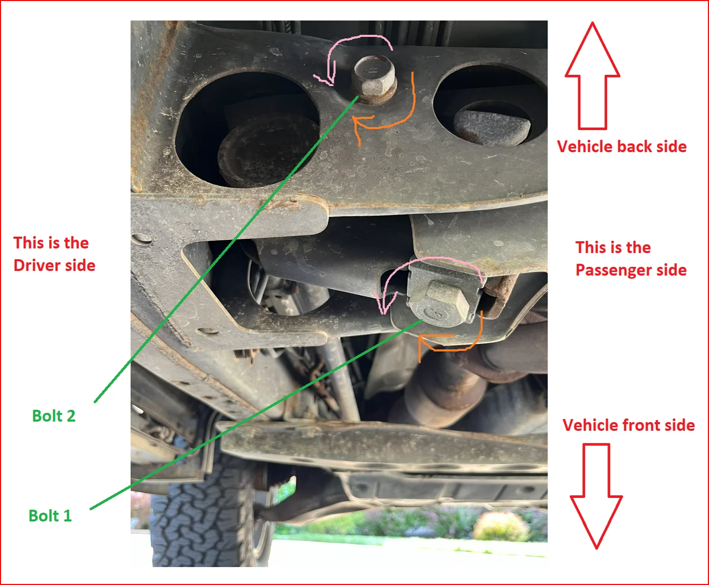

First pic, I am lying underneath the driver side, looking towards the front of the vehicle. Second pic, I am still lying under the driver side, but looking towards the back of the vehicle.
1. I have highlighted three bolts i.e. #1, #2, and #3. Which is the one that cranks the torsion bar?
2. My front driver side needs to be raised to cross-level. Whichever bolt it is above, should i turn it in Orange arrow or Pink arrow direction to raise the front driver side?

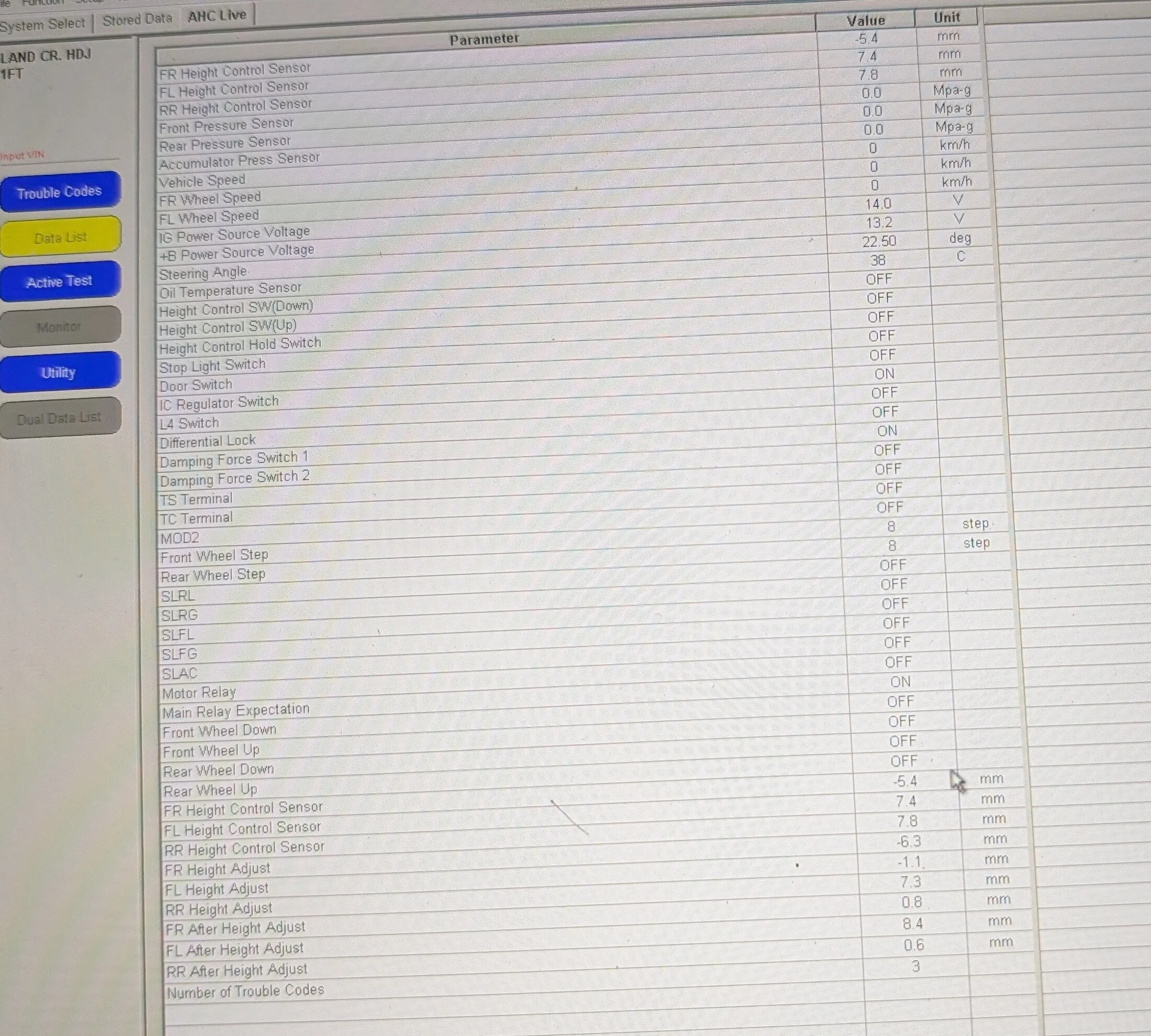

On techstream here are my BEFORE readings:
front LEFT was -0.3
Front RIGHT -0.0
FF pressure: 7.9
RR pressure 7.4
Cranked the LEFT (driver) side TB Bolt #1, two turns CLOCKwise (orange arrow). Here are the readings afterwards:
front LEFT -0.2
Front RIGHT —0.1
FF pressure: 7.7
RR pressure 7.4
So it looks like I’m almost there with cross leveling.
The question is now to reduce the front pressure further do I need to crank the torsion bar bolt clockwise by equal amounts in the SAME CLOCKwise direction on both the left and right side…. Because we are now not cross leveling and want the torsion bars on both sides to take equal higher amount of pressures in order for the AHC to have reduced pressure?
In other words:
Lying underneath the vehicle on Left/Driver side and looking up, turning the Bolt 1 CLOCKWISE (Orange arrow) will "raise" the vehicle height on that side. I have completed that.
Now on the passenger side, lying under and looking up at the Bolt, do we turn it CLOCKWISE or ANTI-CLOCKWISE to "raise" the height?
thanks.

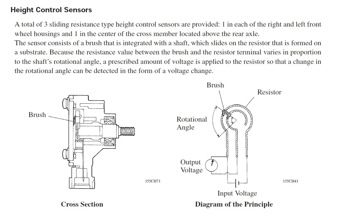

What CAN be changed is the position of the Upper Control Arm relative to the potentiometer arm inside the Height Control Sensor. This is what is being done by moving the Height Control Sensor adjusters.
Whatever is done with Height Control Sensor adjusters, when N is selected at the console switch while the engine and AHC system is operating, the ECU always will cause the 'ride height' to change until it finds a Sensor signal of ~2.25 volts and shows ~zero inches or millimetres on Techstream -- which is correct for N height. When LO or HI is selected at the console switch, the ECU will cause a response which matches the permanently programmed settings for LO or HI height respectively. This fundamentally is how the AHC system works -- UNLESS there are adjustment faults or faults in the Sensor or the connector or the circuit/harness (or in the ECU -- very rare), but all of those faults are another story ....

Hi, I was reading this thread and I'm trying to get my head around pressures on my 2006 Sahara with AHC. I can anyone read the tea leaves for me? The truck will only go into low sometimes. In this case I could not lower it.
Hi, I was reading this thread and I'm trying to get my head around pressures on my 2006 Sahara with AHC. I can anyone read the tea leaves for me? The truck will only go into low sometimes. In this case I could not lower it. View attachment 3799484
This thread your in, may confuse you. As OP didn't have a good understanding of AHC.
Here's a thread and video that should help you much more:
Concur with 2001LC.
But to give you a flying start, with the difference between the readings from the two front sensors, the AHC will not behave. If the car is level left-right, you need to figure out the height sensors. Also, the pressure readings will be valuable when moving from L to H, and when the physical heights are within specs.
