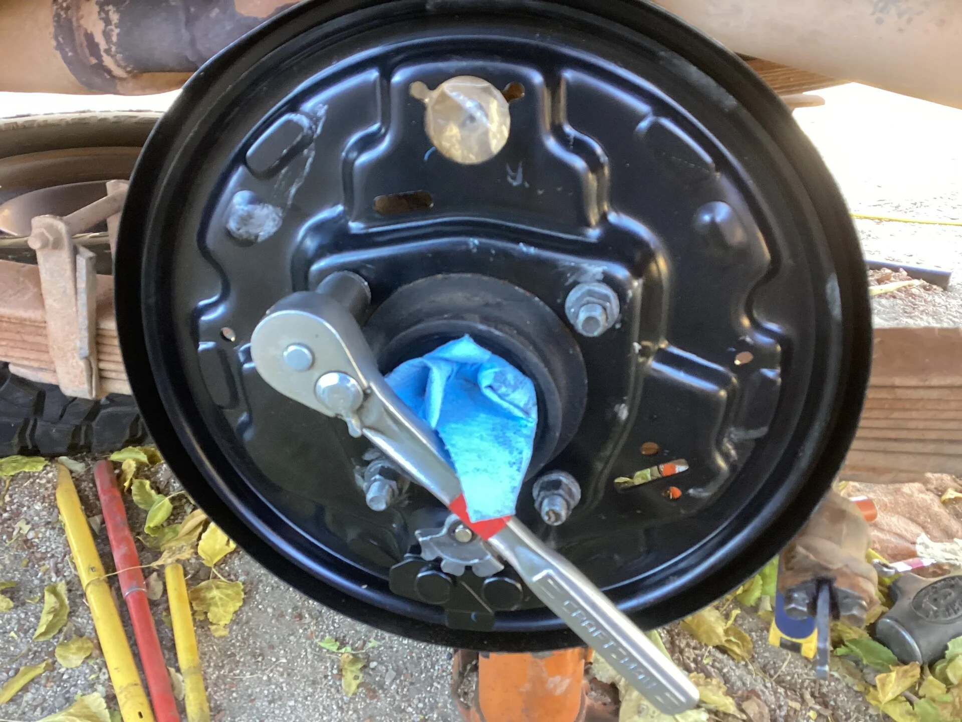

If you happen to know: FJ60 rear axle BRAKE BACKING PLATE semi float axle.
Right in the middle of installing a new brake backing plate & will look it up if necessary BUT if you happen to know it would be great, trying to wrap this up today. And a big thanks to @cruisermatt for getting it in the mail promptly.
The ones in this picture are what I need help with. The nuts are 17M.

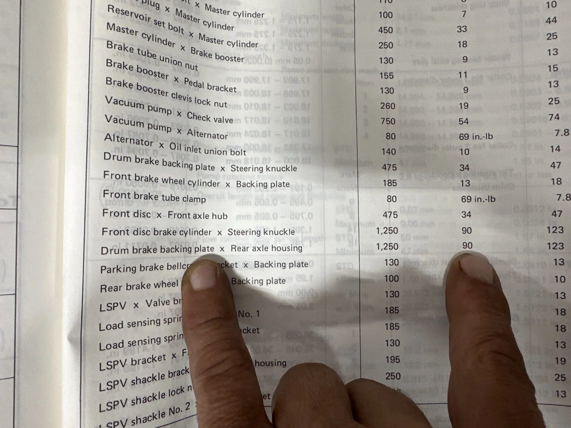

The Man! Thank you Beno.👍🎯👍
