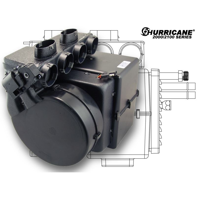

Mounting the Hurricane air hopefully for the final install. Not a lot of room for hands in the dash when securing the hoses. One large box off the garage floor soon!

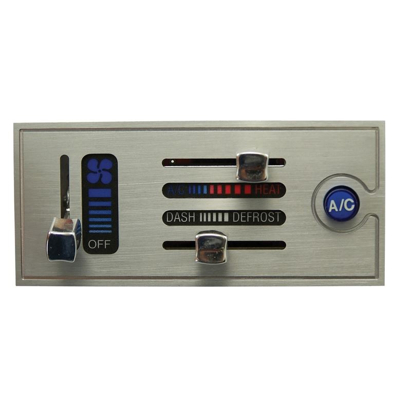

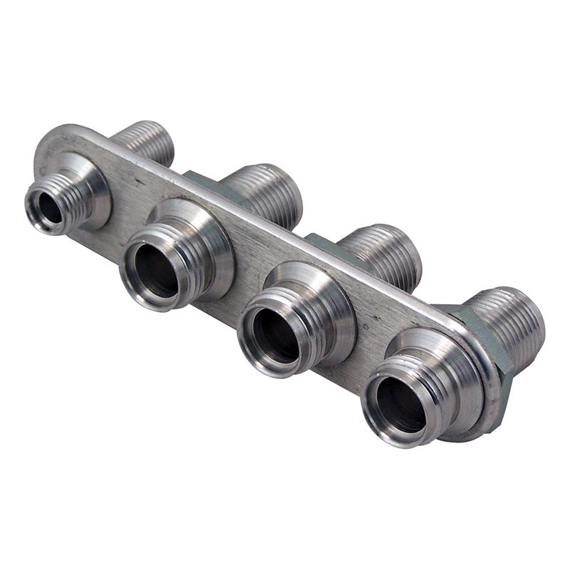

Just in case anyone is wondering, here are the parts I'm using for the AC/Heat. The controls will go in the last open spot in the dash. Not entirely sure my wiper and headlight switch will still fit but hope to figure that out this evening. One thing i almost missed was the backlighting for the AC/Heat controls. Don't forget to wire those to the park light circuit.
Dash controls in, backlight is functional. And barely had room for my switches.
