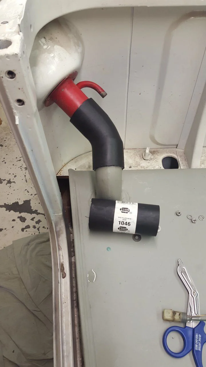

Back in the saddle. Test fitting tank chef dropped off from his stash. Fuel filler neck picked up from Gary Waggoner when he lived in tx. Yeah its been sitting waiting install a while. Filler neck pn from this forum. Bed lined up and secure.

^^^^^I need one of these too. Thanks for posting up. Do you have any specific info on the wiring bulkhead fittings you used? Do both of your newer tanks have the return lines already in them? I have to figure out how to add a return line to my stock 65 tank. Considering adding a second rear tank like the Long Ranger under the rear of my 40. Not sure if that will bolt right up to the 45...
I'm using an old confer long range tank in the back with an in tank pump. In-Tank Fuel Pump Module - PA-Series
Have not figured out plumbing or sender for in cab tank yet. Will probably only use it as aux to xfer to main rear tank.

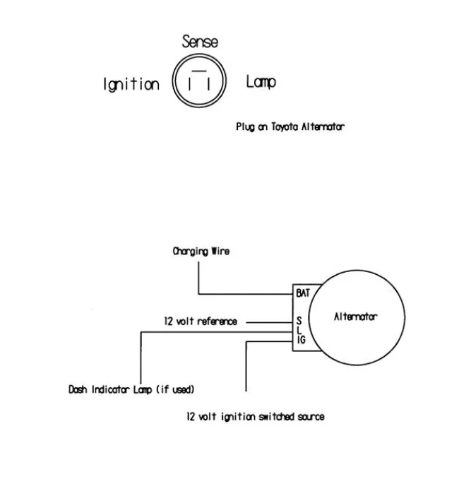

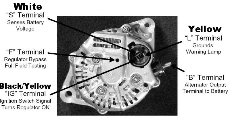

So I think Charles needed info on Alternator wiring on a 3fe conversion and this might help others.
