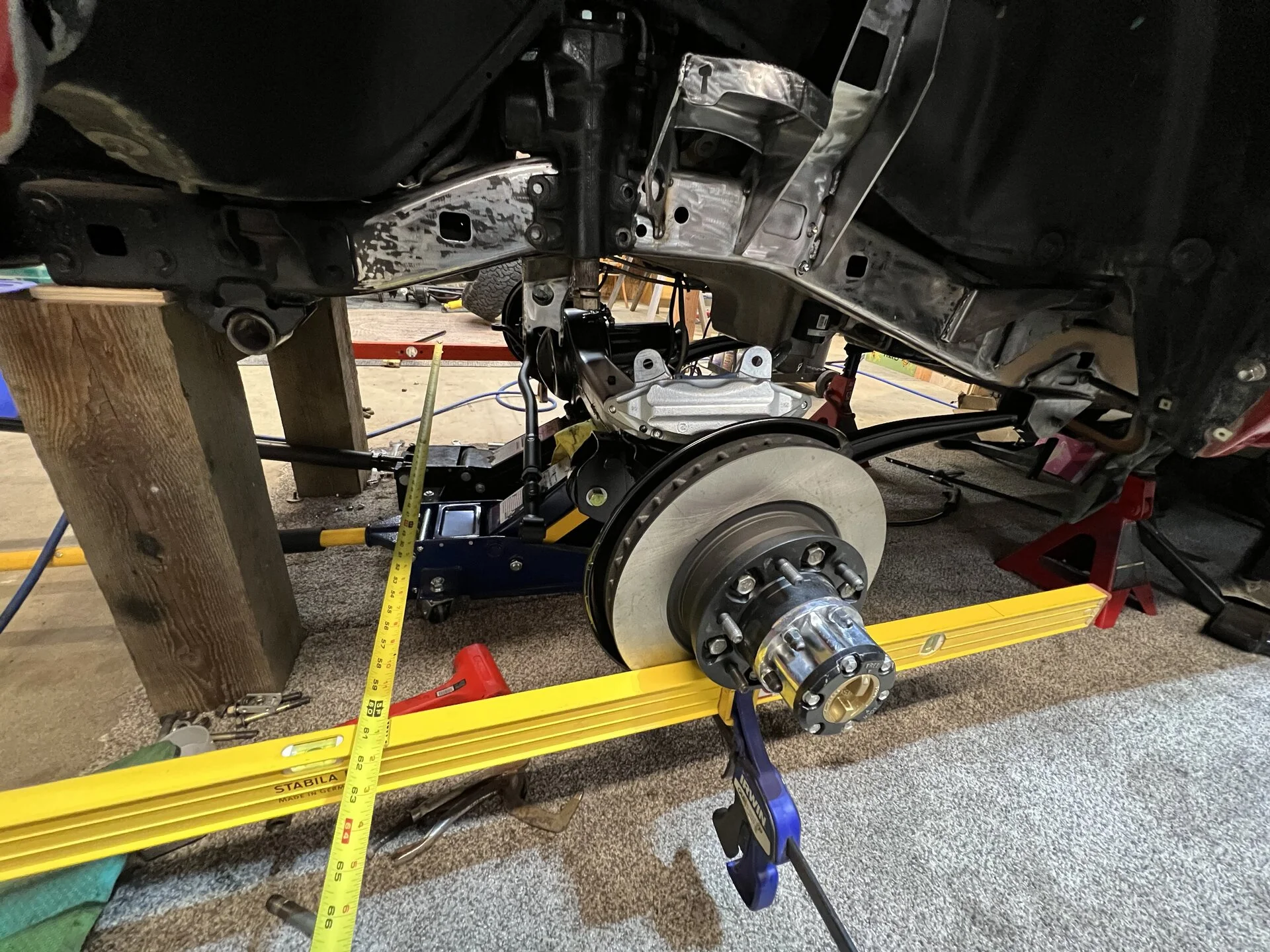

Once it’s all complete will you do your own alignment then get it checked at a shop? Looking forward to hearing about he ride and your first impressions.
Yes, the shock towers are indexed with the FJ60 sway bar mount. It makes it super easy to line it all up.
The only alignment for the 60 & 80 series is the toe. Spec is between 0 and .16” I believe. I set mine with some levels and a tape measure to just under 3/16” or 0.1875”. It should be a good starting point. If it feels off, I’ll have a shop set it.

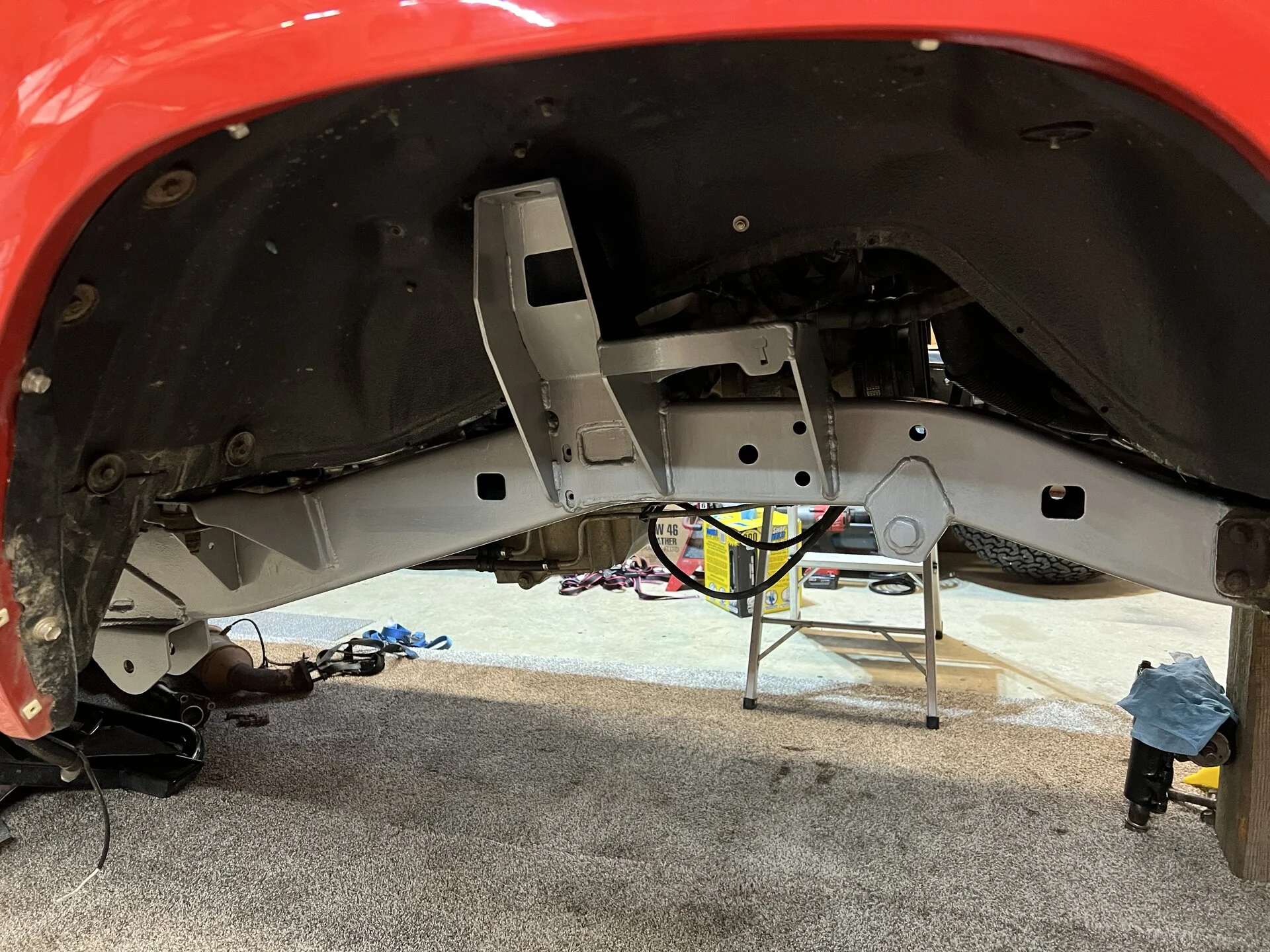

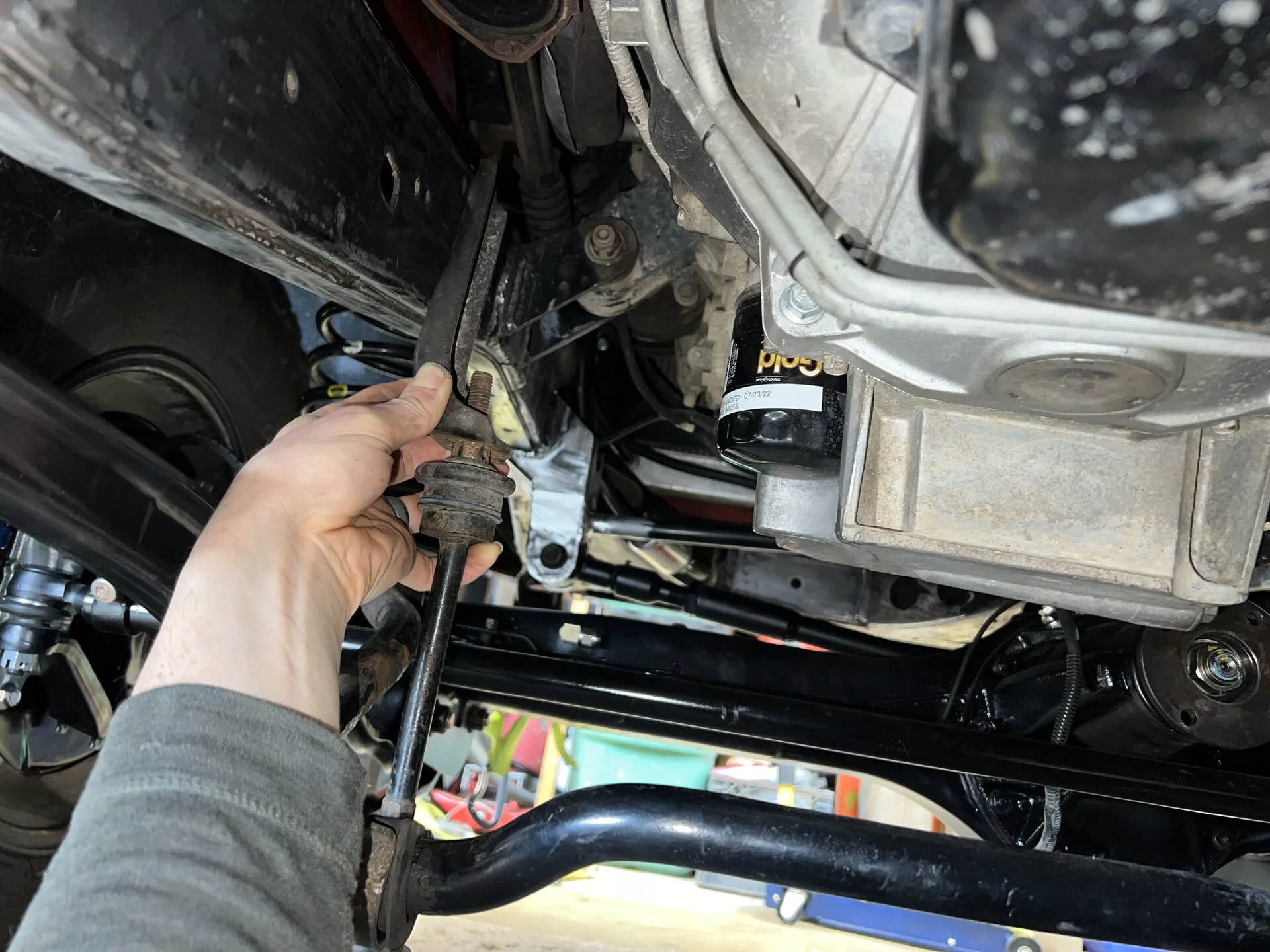

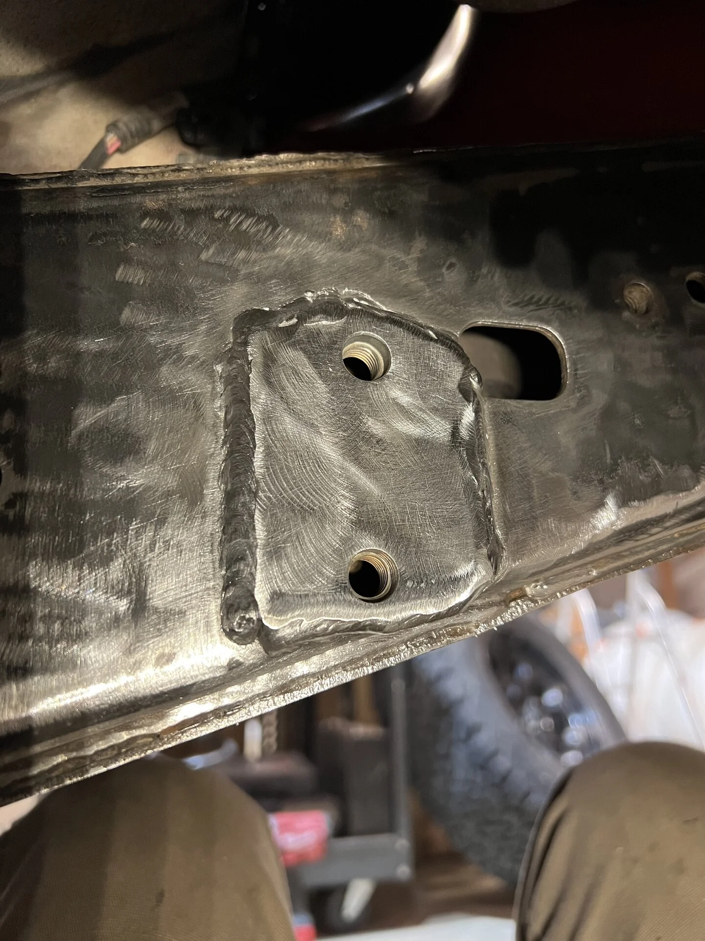

Sway bar mounts:
The Torfab kit doesn’t include sway bars for a variety of reasons. Different people have different drivetrain setups that may require different mounts.
For mine, I’m trying to reuse the FJ60 sway bar mounts but in a different way.

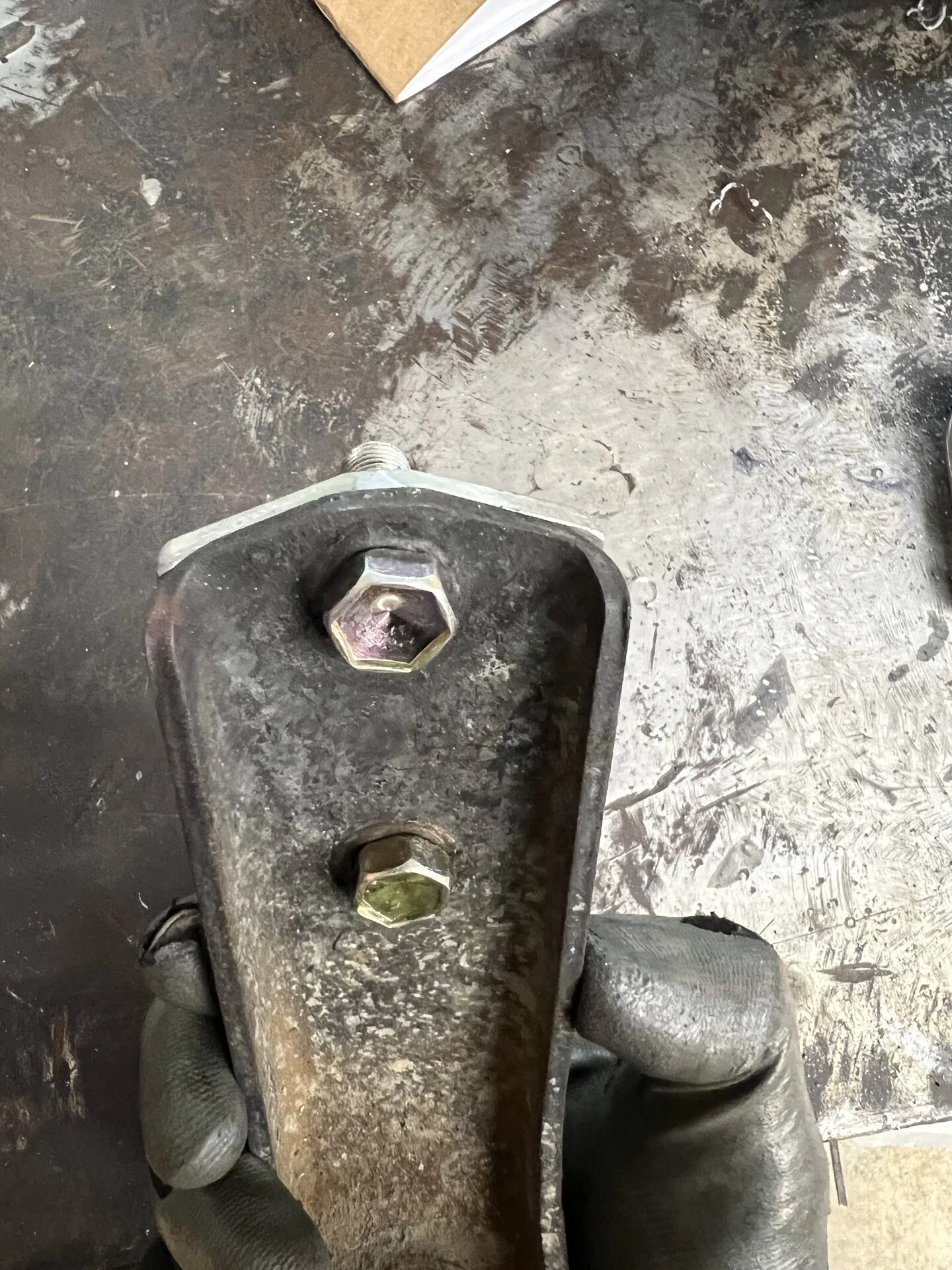

I’m going to cut the links down and weld them to a plate where the sway bar will be mounted.
I started with a plate and welded some nuts on the back of it.
I am using M10 nuts/bolts instead of the M8 that the FJ60 uses.

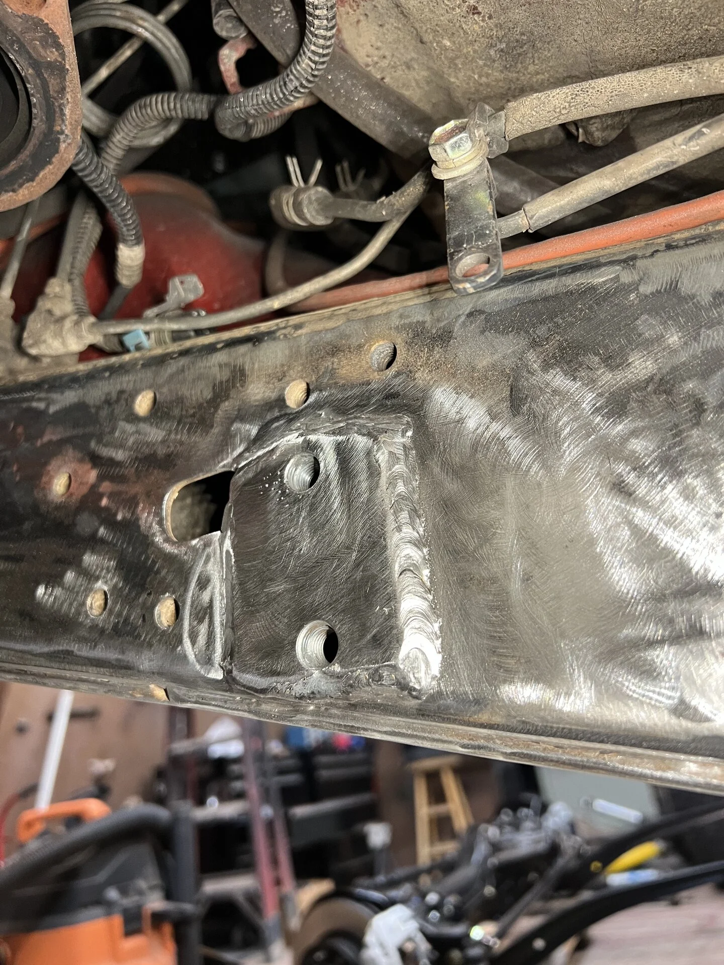

I then spent a lot of time measuring and centering the bracket with the estimated location of the sway bar.
I drilled some large holes in the frame for the captured nuts to fit through and tacked them into place.
The fit is a little tight when the exhaust is installed, but it does fit. I may trim an edge off the stock FJ60 brackets for more clearance.
All welded in:
I think this should be a good solution for the sway bar mounts. The nice thing is if they don’t work for some reason, I can abandon the mounting plates or easily cut them off to make room for different ones.
