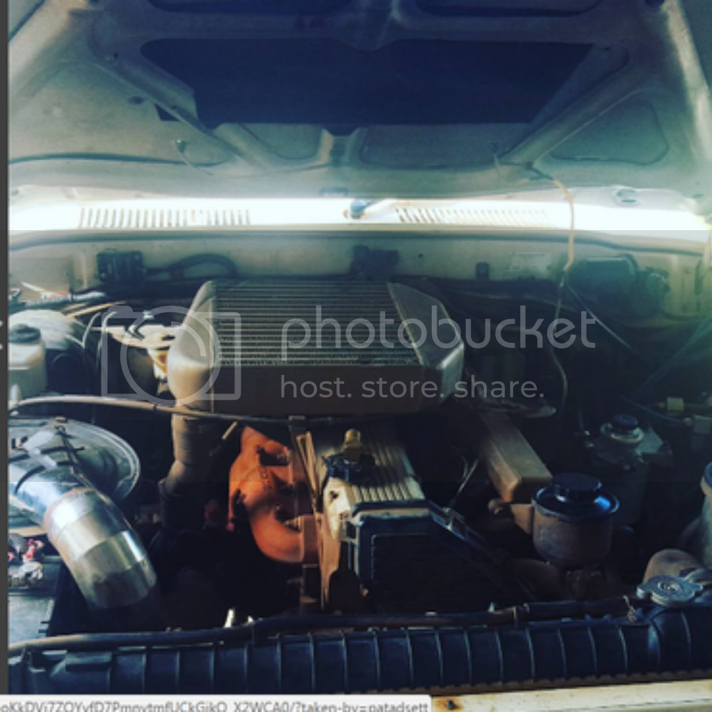

It works .. not the most eficient option but it works and it's 99% bolt on .. ( not taking in mind the hood work )
i ran one when i was diesel, it worked pretty well and lined up quite good, you will need to cut the bonne supports though
I don't have a diesel, my truck is a supercharged 1fz-fe, but i have a similar intercooler setup with in/out temp sensors. It drops iat by 10-20 degrees, generally staying at a15 degree drop most of the time
Where does the airflow across the intercooler come from? Hood scoop?
Yup, you generally need to cut the hood and put a scoop on to get airflow across a top mount air to air intercooler on these trucks. Some even add a fan, but I think you'd still need to cut the hood to get the airflow required.

Yes I did working through the debate over the last few years. Front mounts adds lag so I felt with a older engine with Pedal response is already slow it would be better with a effiecent top mount.
Having a accurate size intercooler and yet improved flow in & out was the focus here.
Getting the 3in exhaust made now to add to the power band now so will know in the next few weeks the true full benefits.
Have he scoop ready to fit & paint soon, doesn't bother me because the the hole in the hood gonna be small.
Pictures to follow

I respect your view and would say there are many factors to what's best for each person. This was a cheap yet in my opinion a very good setup to achieve good enough results. This setup cost me around $500 all in to do. Buying a aftermarket kit would be easily more than double or even triple that with shipping & taxes.
In the next few weeks I will know better.
Thanks for your interest
Wow, $500 for the top mount and intake manifold work is a great deal!
My aim for this project was to build affordable intercooler set up aiming for $300 but decided to go the extra mile with modifying restrictions with the inlet manifold that no afitermarket kit addresses.
