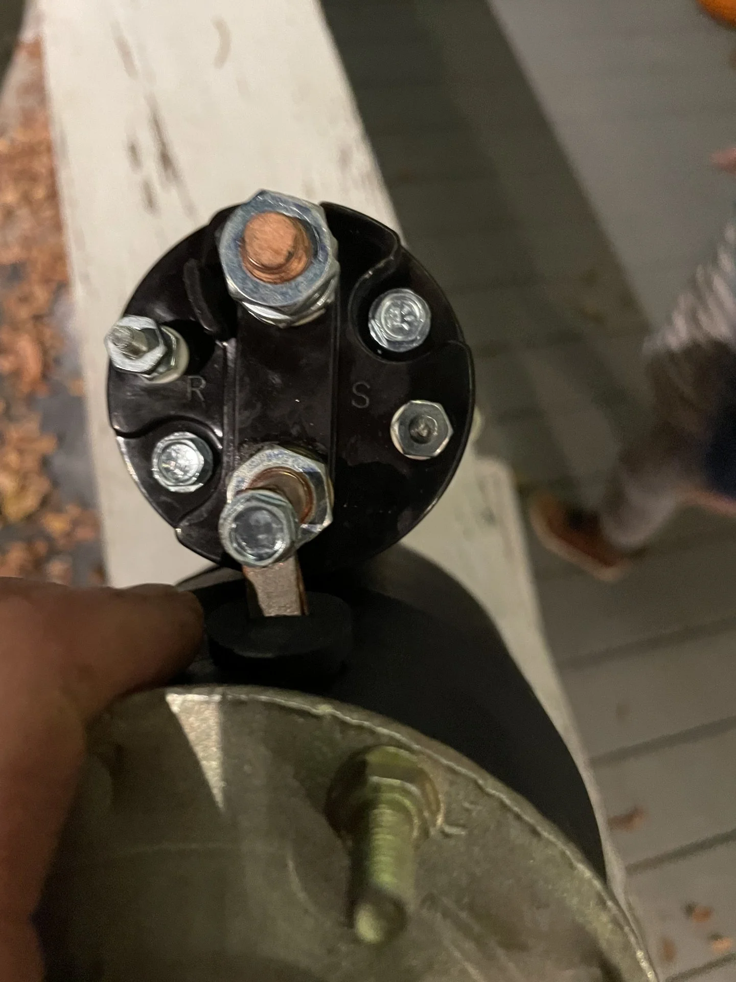

2 small and 1 big one to the battery
So take this all with a Grain of BS, not being a SB Chevy guy, but one small wire should go to your ignition system, the other to ignition switch. Ignition switch in run, sends power to solenoid relay on starter, and when that gets power, it sends 12v out the other small wire to ignition coil. Any chance in hell those two wires got swapped? Shouldn’t have a neutral switch, or starter relay (no ECU). So if your starter makes absolutely no sound with key in run, with a new starter and solenoid, I would check power with a Test light at ignition switch output with key in RUN. If no power there- jump ignition switch and see what happens? If power there, then a short in Wire between igniton Switch and starter? Or crazy s*** like bad new starter? Assuming there is no other safety switch / relay between the two. Or an inline ignition fuse or something? Sorry. hopefully this is a little helpful not a garbled mess of malarkey! Good luck!
Should be able to jump the starter mounted solenoid at the starter (large wire to small wire) to see if the starter is working. If so, check for 12v coming from key switch in start position (will be one of the small wires on the starter)
This is what I have when I pulled it off before I made sure I did one wire at a time so I remembered where they went getting ready to install new one just got home from work
