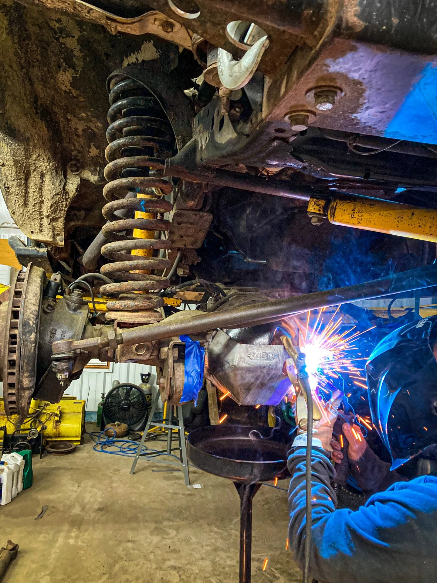

I had tried to patch like 5 yrs ago tank in place with JB tank weld, and that may have worked if i pulled tank and prepped properly. This time, pulled tank, drained, blew a cool hair dryer through for half a day, welded, and regular jb weld on top just for assurance. The welding was a bitch with the thin wall, continually thinning material, weld again, thin, repeat, **** it, jb weld.

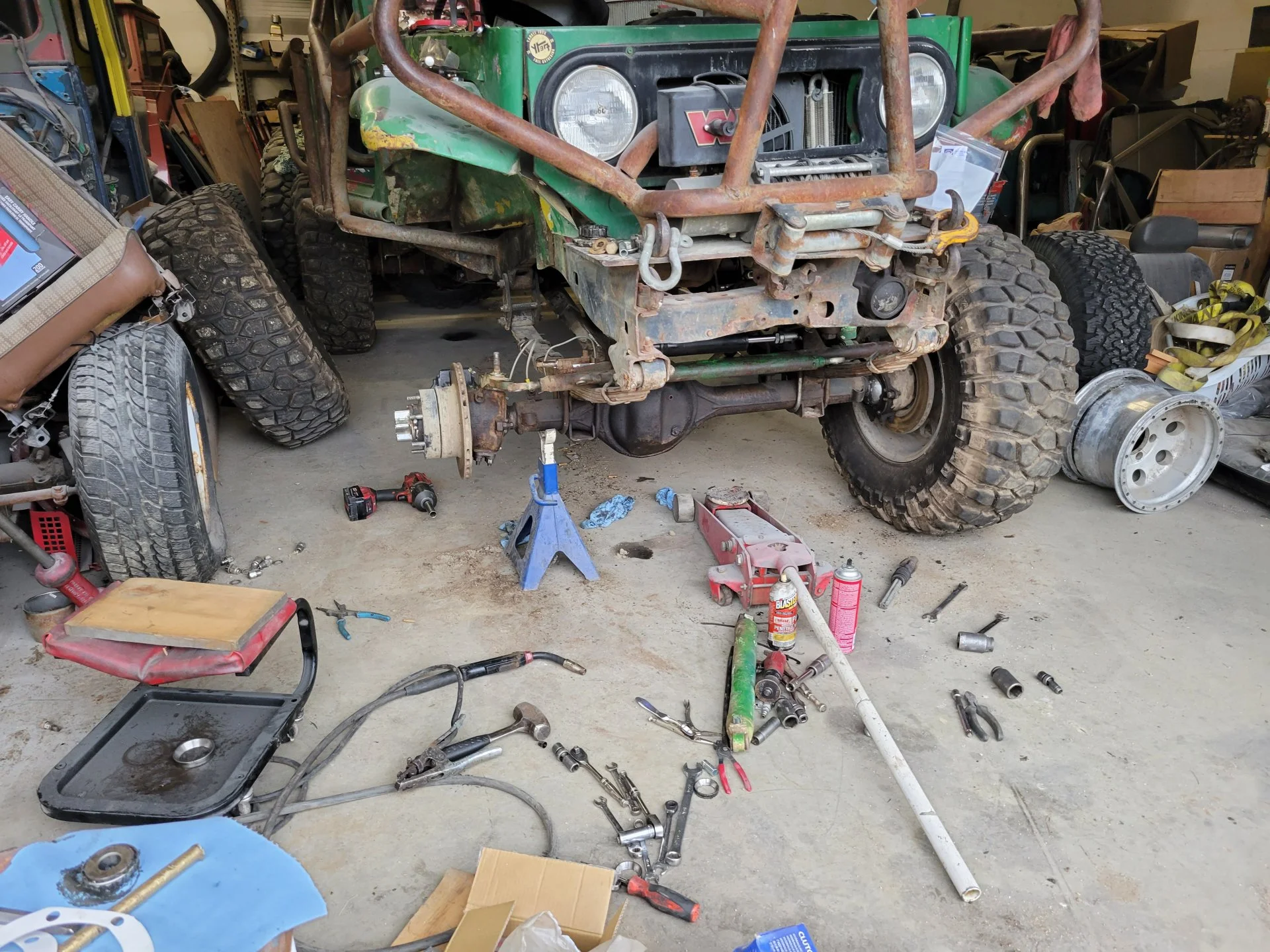

Waiting on new Knuckle studs to come in for me so I can reassemble my drivers side. Decided to order ne ones from toyota. Ordered both sides, so I will probably replace both. New studs, cone washer, washers, and nuts.

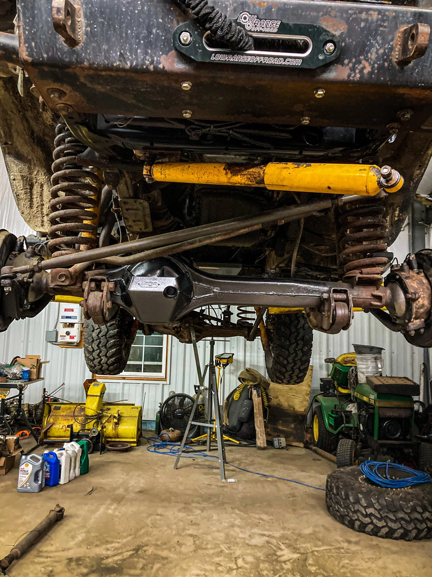

Looks like you have been busy! What diff guard is that? Looks like a Low Range Off Road, is it the one they sell for the 8" Rear axle? Fits well
I think so. Raffle prize from several years back. It seemed to line right up though, with the outer side of the “pumpkin” weld, and fill access lined right up.
