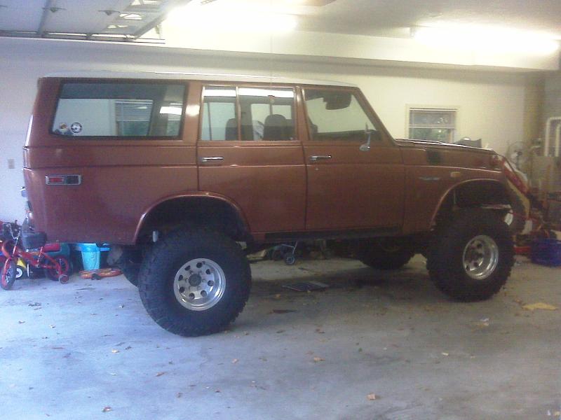

Kina finished the SOA yesterday which was very half-assedly done by the PO. The rear springs were saggy and turns out one was from a 55 and one was from a 60.
The rear spring replacements are a pair of 55 springs I got from a guy in CA which turned out to actually be 60 series springs with sleeves inside. Either way they worked great. The back end has probably been raised up about 4 inches from where it was before.
Shackles on the front are a big help now obviously. All the rattles in the truck are essentially gone and I don't have to hold my breath anymore when hitting bumps.

Pics. few more to come. had to use cameraphone so pics ain't great but you get the gist. Truck is nice and level. Still has some cruiser lean but not too bad. It's kinda tough to climb into now.

Nice job Flipper, it's looking good, the next owner is going to like what you've done!
This ones nice. I hope he keeps it long. Next I would put a full roll cage in it.
