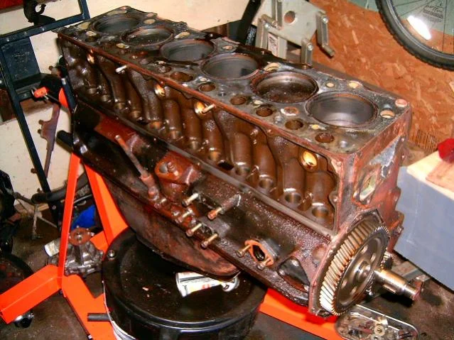

Well I picked up a spare 2F and it fell apart. :hillbilly:

Thanks. I just want to go though it to know I have a fresh motor. That and I have never done it before and figured you can't learn if you don't do it. Right? Hoping to get by with gaskets, bearings and rigs. Maybe a cam.
I just want it to be reliable. I am fine staying in the slow lane.

I was told that this engine had like 160k on it but the compression was low, around 105 in most cylinders.

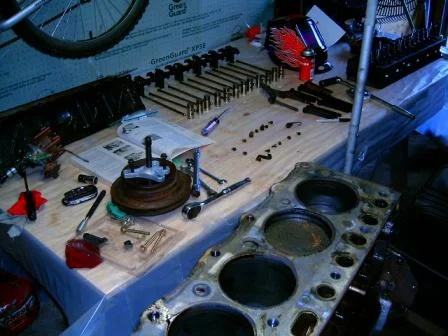

So far everything looks good. I need to get some tools (a micrometer, dial indicator) to check tolerances.
The lifters have some pitting and after reading the Big Gay 2F rebuild it seems like they can't be resurfaced with any pitting?
I'm probably going to have a bunch of questions.
the tools you need is plastigauge and a good set of feeler gauges. Nothing that elaborate.
The feeler gauges I got. I assume that you can purchase plastigauge an any auto parts store.
When reading thought the FSM they have tolerances for everything. I was unsure of what I NEED to check and what I can skip.
Not that I know jack about this....but I would check every tolerance you can find. you're not in a rush and you won't likely reassemble it and install it till the Spring. Take your time and do it once
If the cylinders are fine, just get some new rings. If you take off the main caps or the connecting rods and everything looks good, just put it back together. I'd be willing to bet everything is fine. You'll save a lot of time and money if you just get some new valve seals and get the head checked. Maybe just get the valves shot.

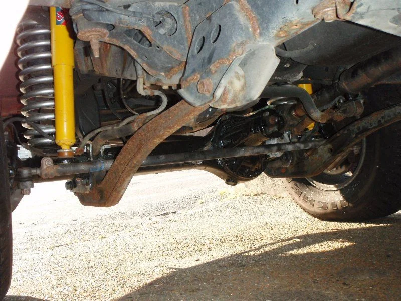

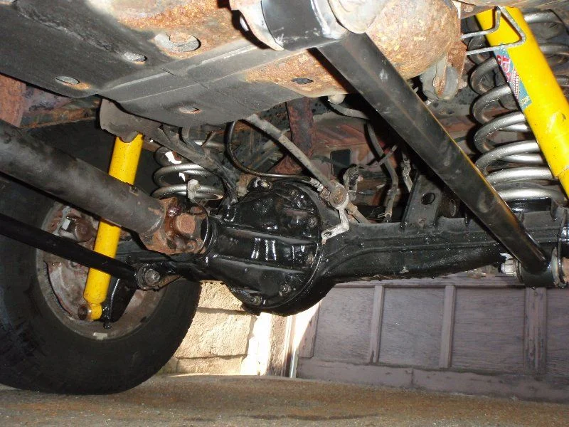

yesterday rick and i finished swapping in some freshly rebuilt axles into the red tide accompanied by HD 1/4 wall dom rear links, HD pan hard adjusters forward and aft, HD sway bar links forward and aft, extended break lines, slee 4" lift, landtank caster plates and some new break fluid and diff fluid:D
just need to rebuild the frount diff cause its got a bad pinion bearing :bang:
also need to get something besides roler scates for this thing to role on:steer:
and a new rear diff acuator this one if f*%ked:hhmm::bang::idea::bang::censor:
