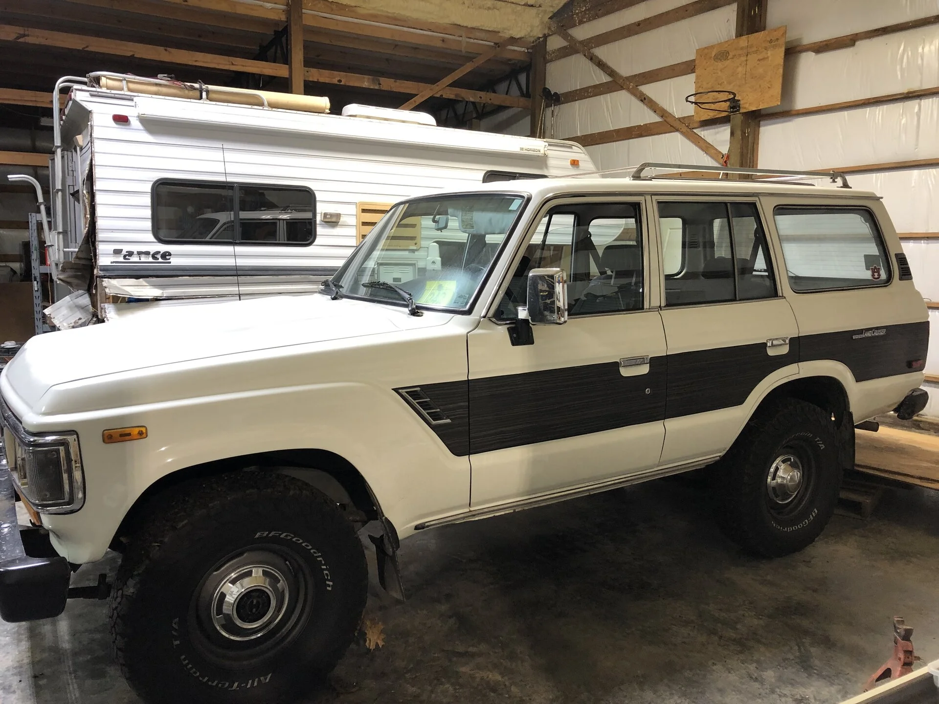

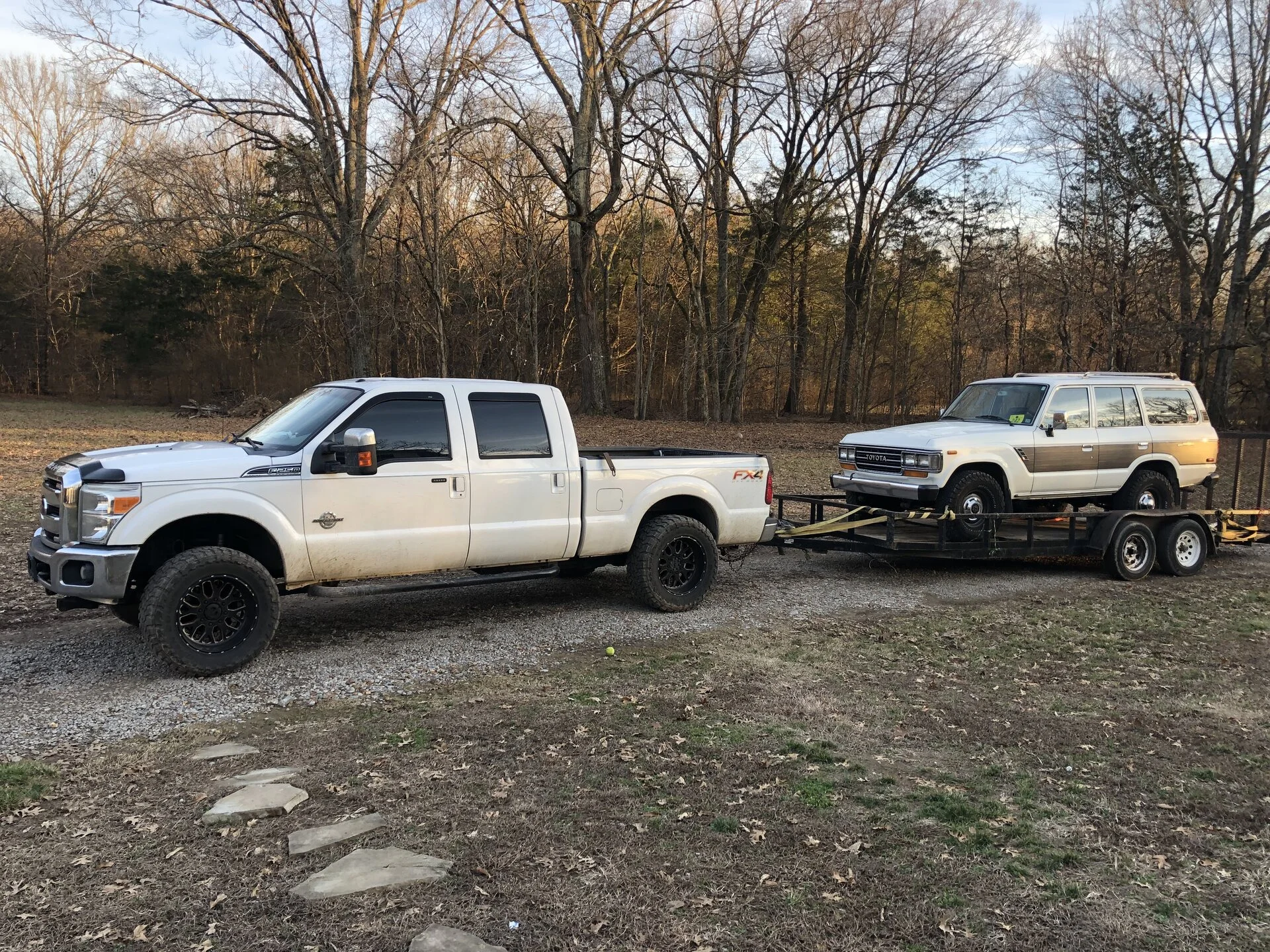

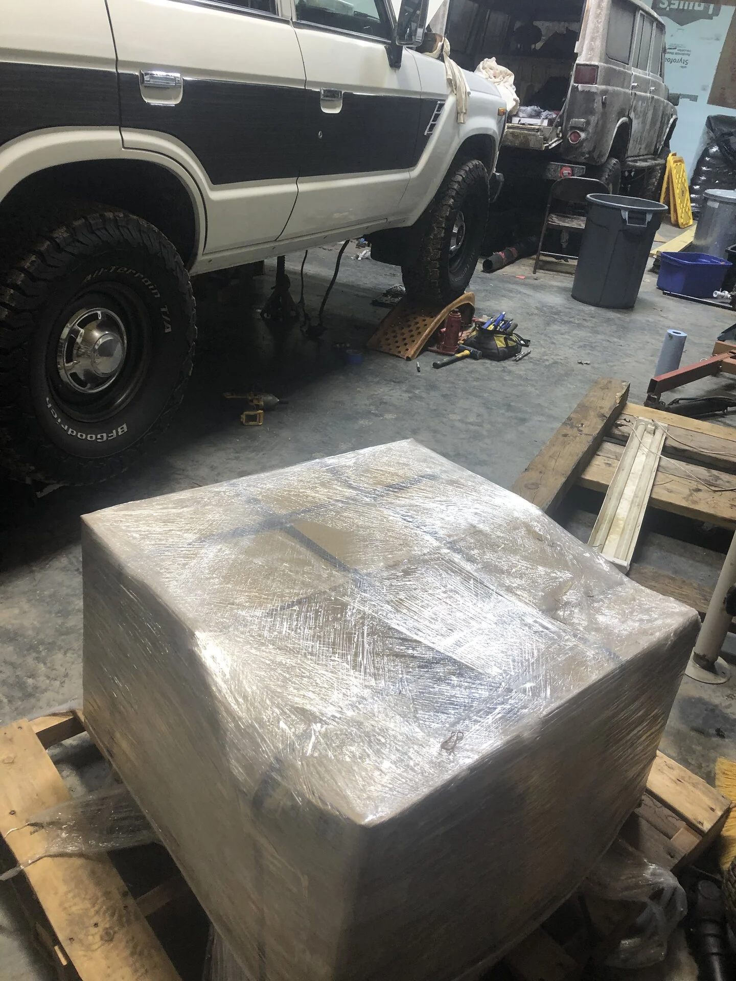

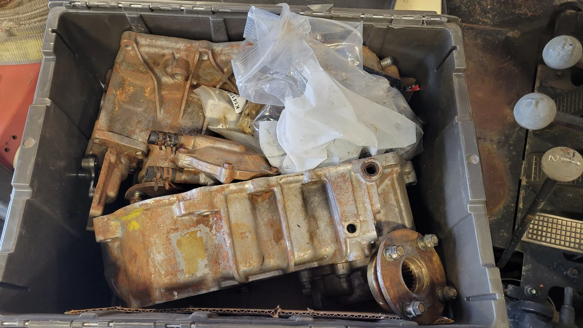

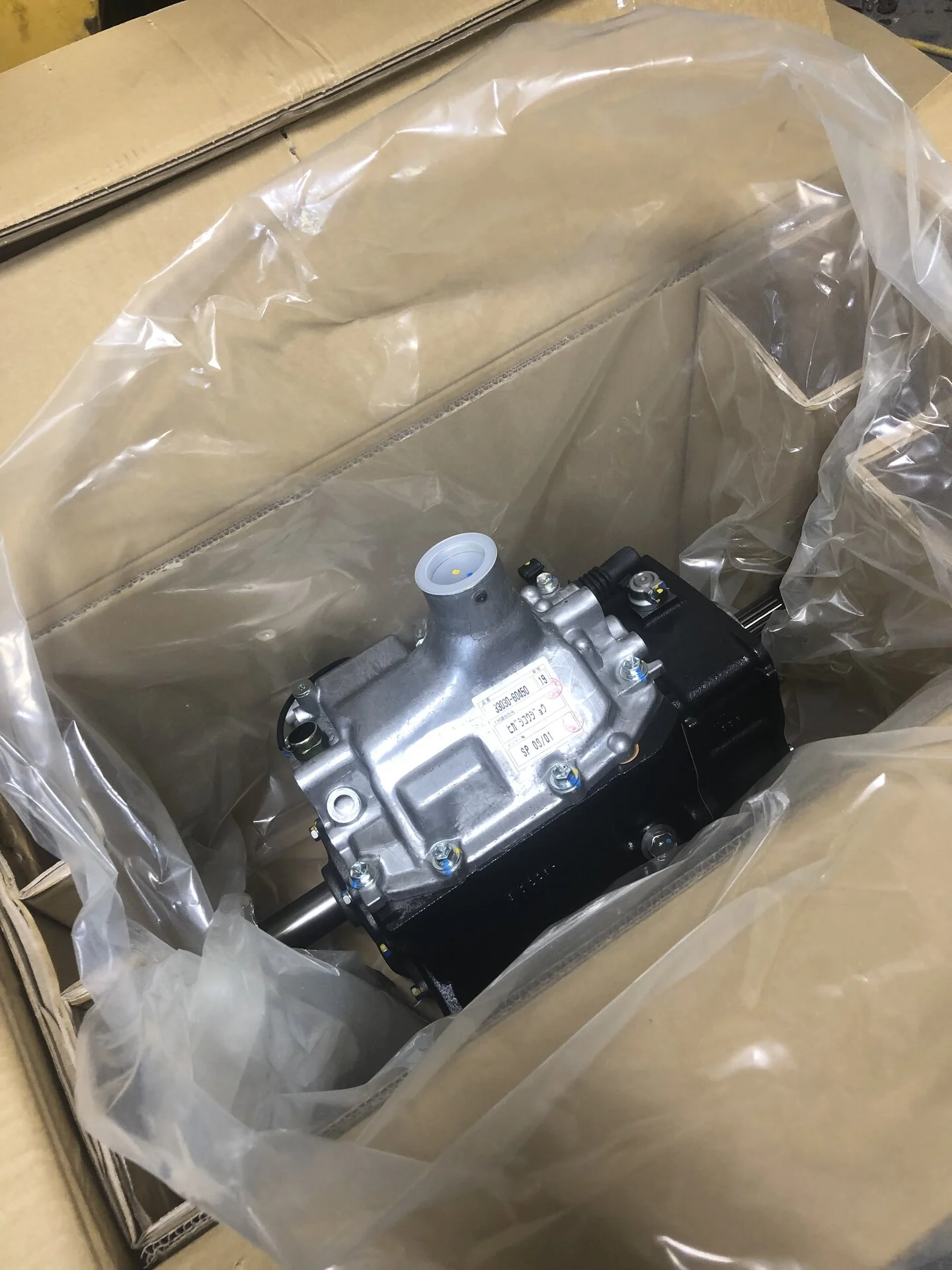

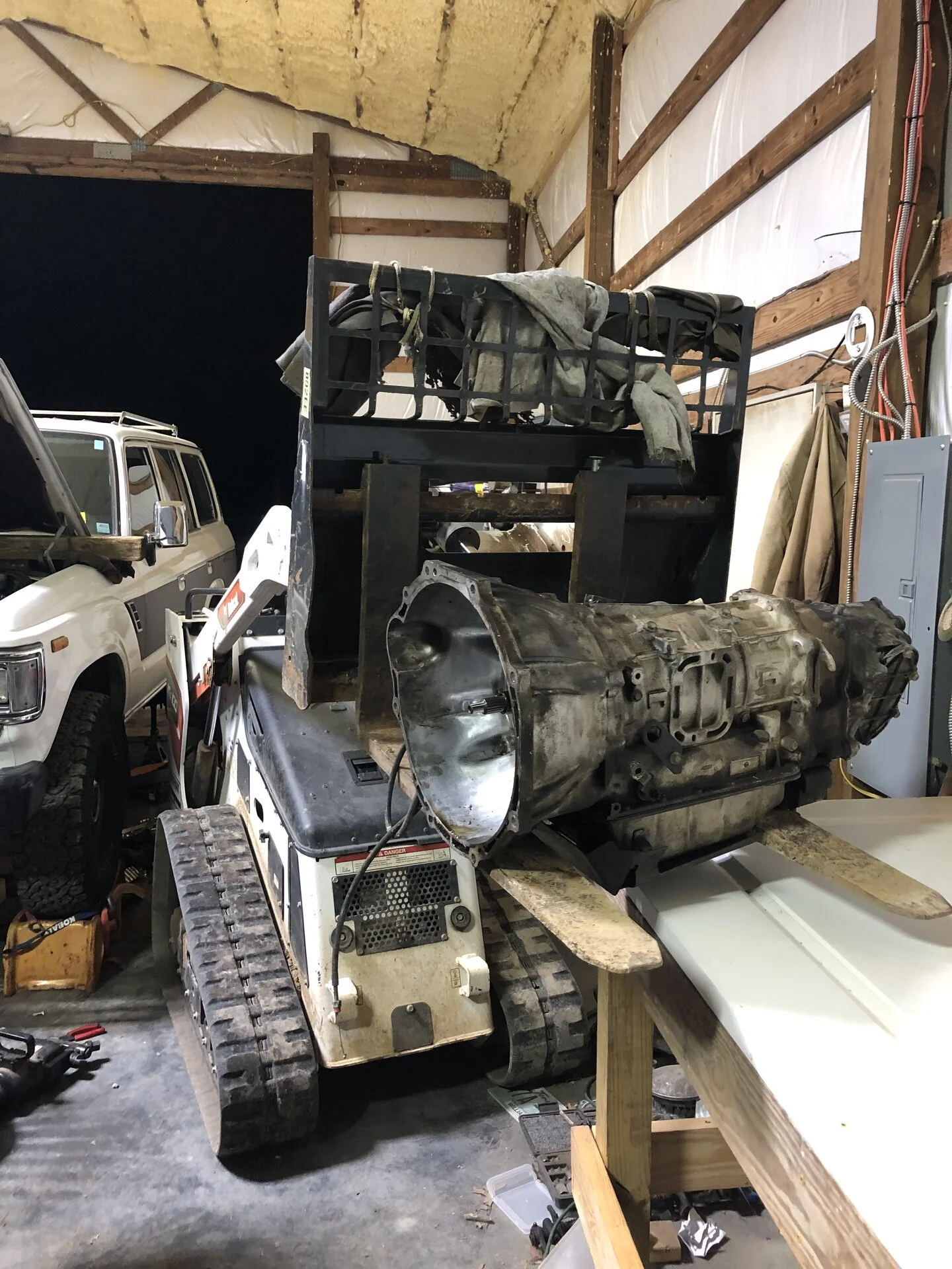

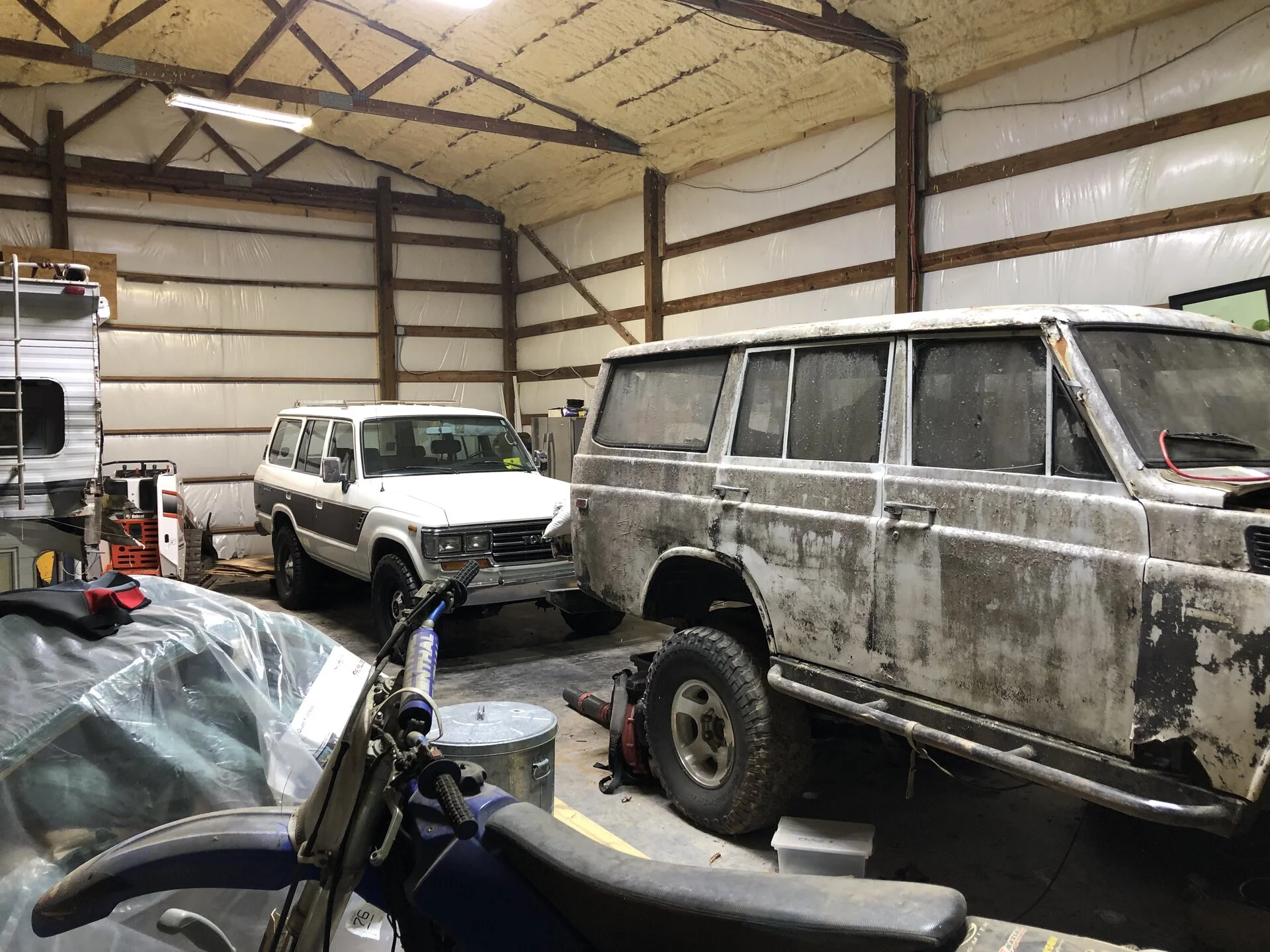

A buddy of mine bought a nice 62 a few years ago and was complaining about lack of power with the auto tranny. I was telling him he needed to go with the h55f and get rid of the automatic. Well about 2 weeks ago the automatic died and he decided to take the plunge. We ordered a tranny and a bunch of parts from @orangefj45 and Georg was great! The stuff is supposed to be get here next week. I usually lurk around in the 45,55 and 100 sections. I’m learning about these 3fe. I thought I’d post up here for fun and advice. Here it is after dragging it home.

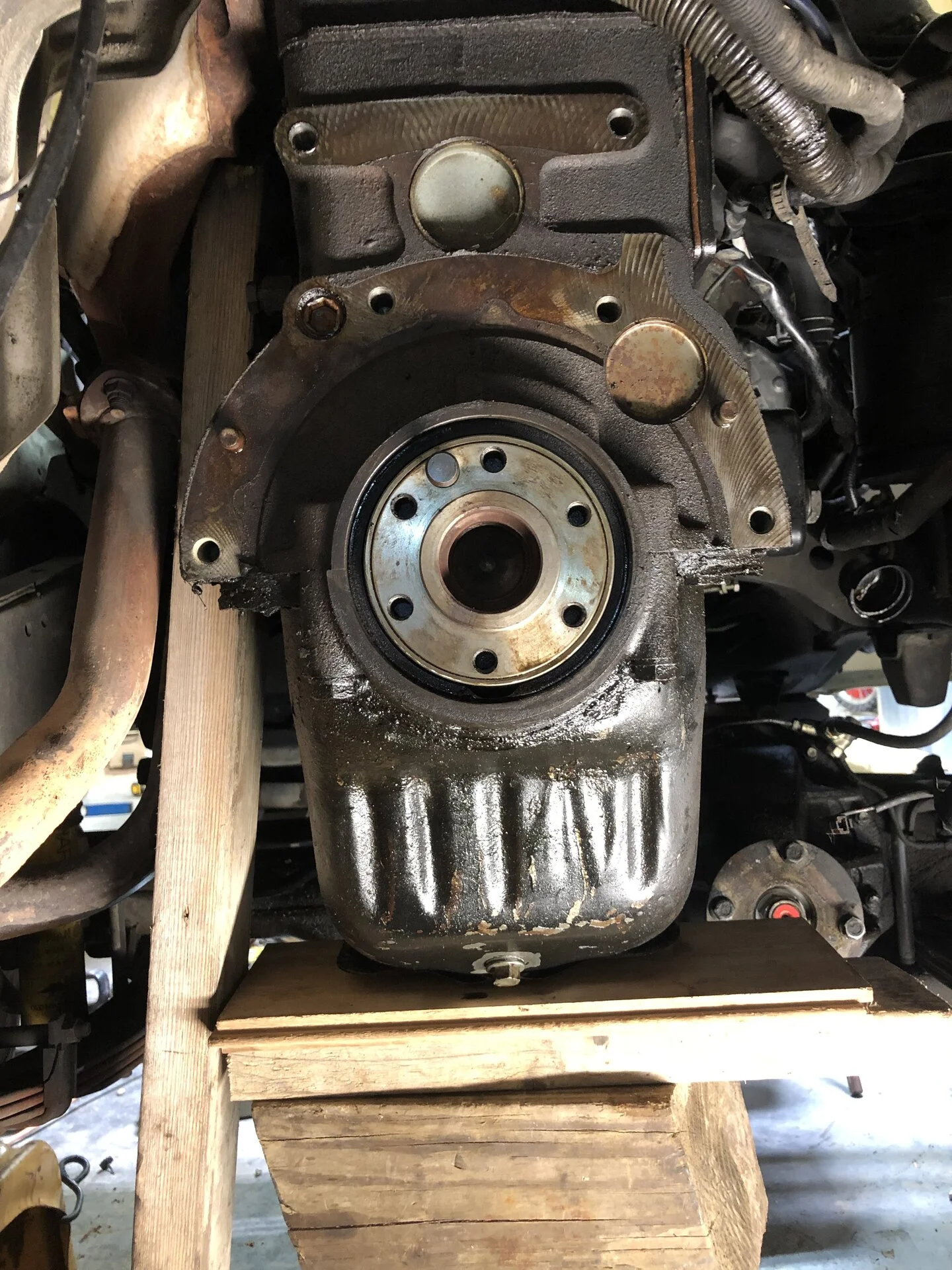

Got the rear main out, bellhousing etc off. Next will pull the oil pan and start cleaning parts and disassemble the t-case. Hopefully I can get a lot of this done before our package arrives!
Jason

If I might make a suggestion, loosen the rear main cap slightly, slide the rear main seal in place then re-torque the rear main cap. Then install the oil pan gasket.

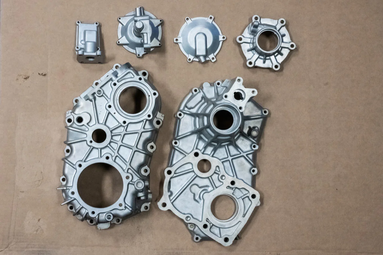

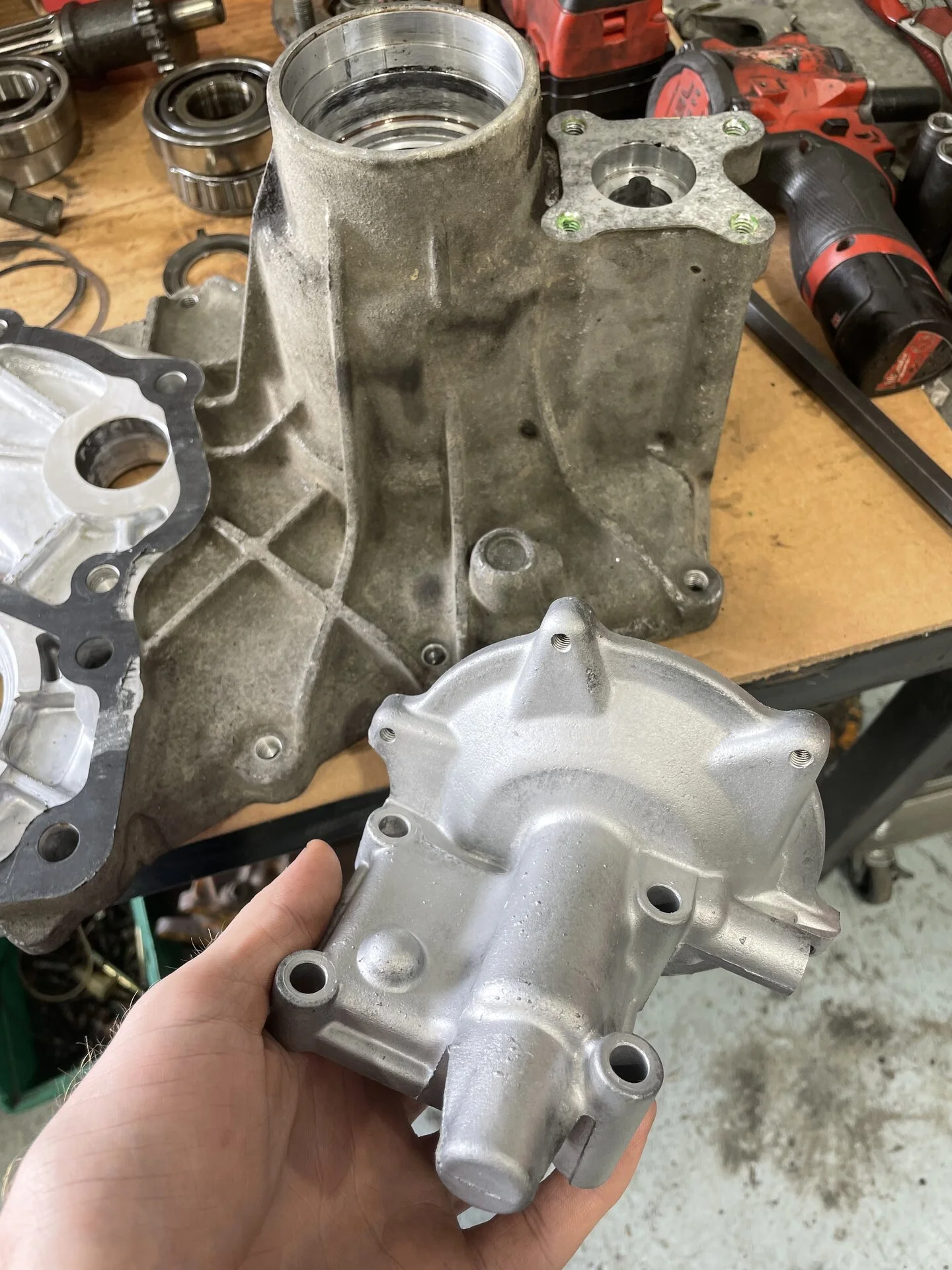

Thanks guys! Any advice on cleaning outside of the t-case? My parts washer isn’t doing anything for the baked on stuff. I tried a pressure washer with hot water and didn’t touch it either. I saw a YouTube video where guy said he used parts washer then put it in a blast cabinet then parts washer again. I just wanted to be careful with the aluminum case. I spent about 4 hours cleaning gasket material off and still need to do the oil pan and block. Just wondering if there is a faster way. It’s been about 20 years since I worked in a transmission shop and honestly they didn’t care how the outside looked. All my mating surfaces are clean where gaskets go but kinda hate putting a cruddy t case on the back of that nice new tranny!

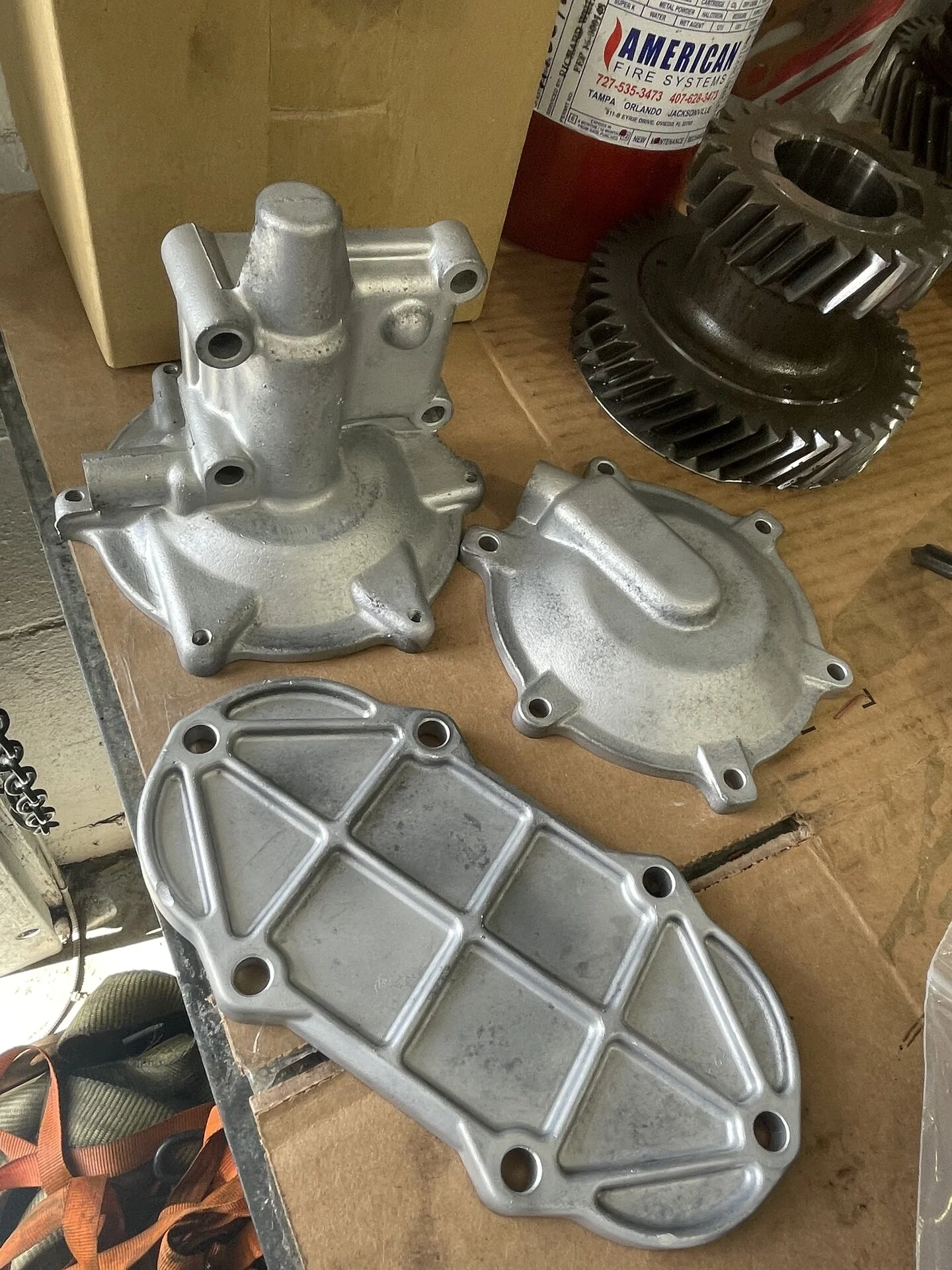

See if you can find someone offering vapors blasting in your hood.
The process can make parts look pretty amazing. (Before/after, no paint)
Love my vapor blaster.

Try steam
