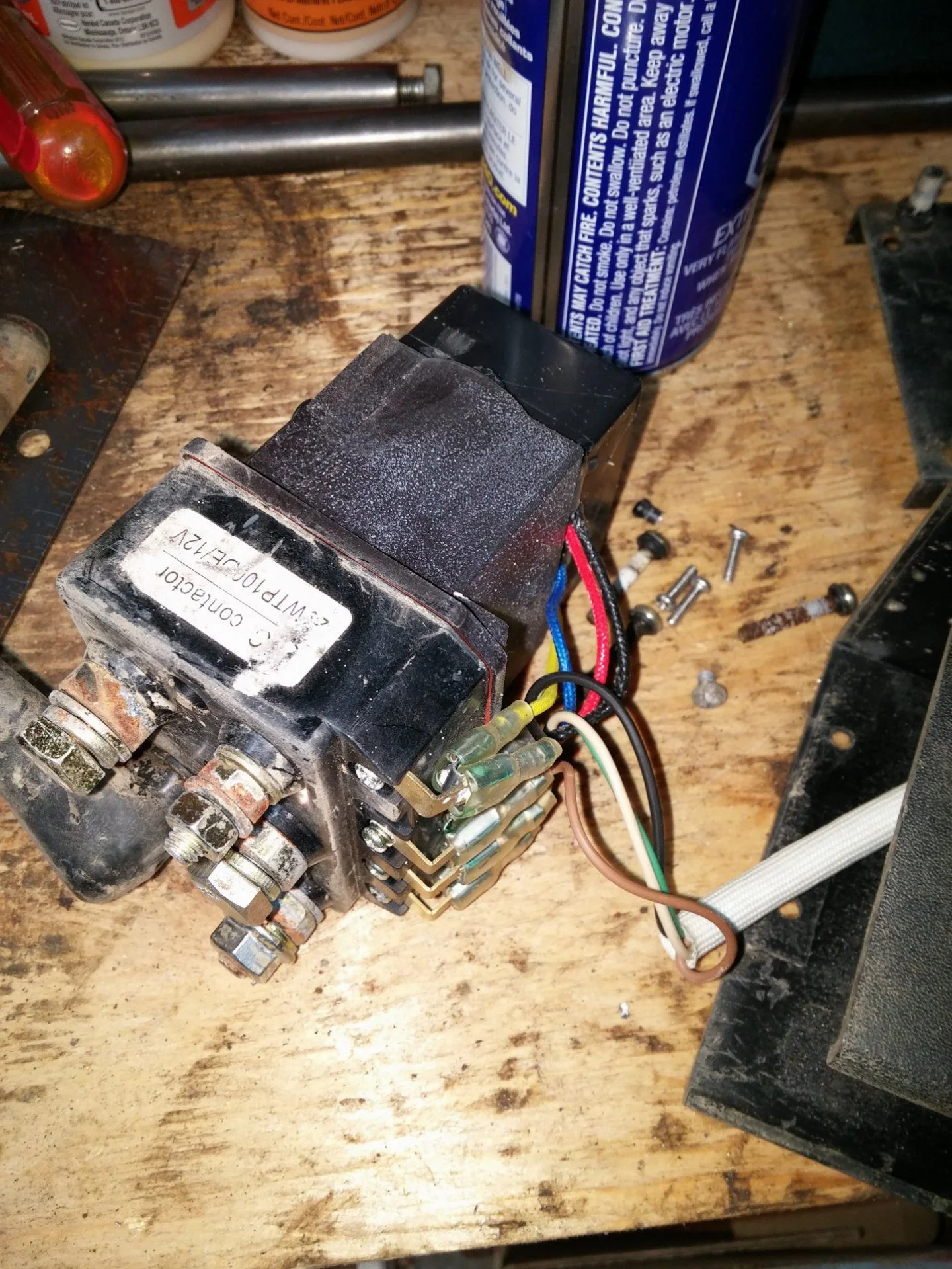

I won it a few years ago, finally got around to putting it on...last yearm maybe two years ago. Used it once, go to use it again...and nothing.
Sad thing is it hasnt seen deep water, just the usual elements from being on the front bumper. I took it off today, expecting to just clean up some solenoids/contacts/whatever and remote mount it in the engine bay.
It's the first time I've attempted fixing one of these new winches, and maybe the riveted cover should have given it away, but c'mon TJM..really? Nothing in here that can be maintained, just replaced. Jerks. One of these units

No resolution. My winch has just been decoration on my bumper. The problem was that inside the contactor unit there are some sealed "computer chips" type cards, and these got corroded somehow. It has nothing to do with grounds or anything else as obvious.

Have you sourced a replacement? Try Runva they sell proper contactors for reasonable price
