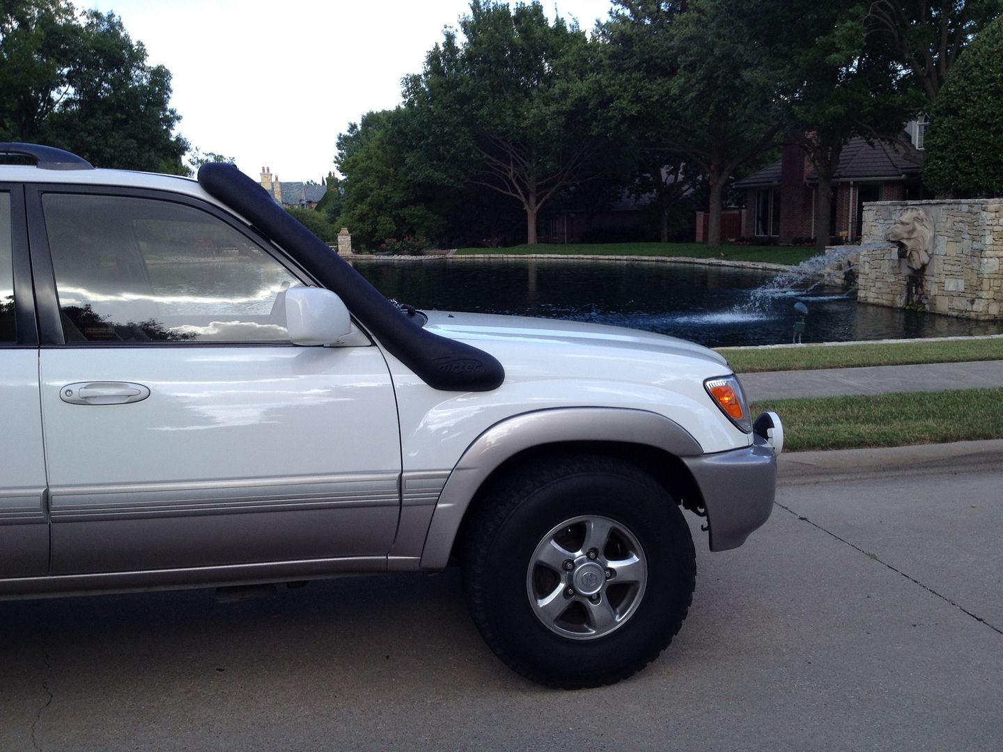

Quick pic:

GREAT PICTURE - I know it has been asked a million times but what should I do with my antenna since I listen/use my FM radio a lot. I also want to think of a creative way to use our dash mounted up/down antenna buttons for something else. Releasing mini tire spikes for poor drivers behind me, or something else. I just don't want that button to go to waste!!
