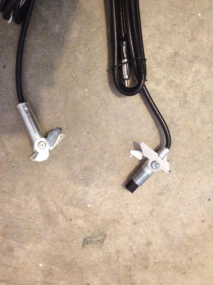

Update on mounting the antenna:

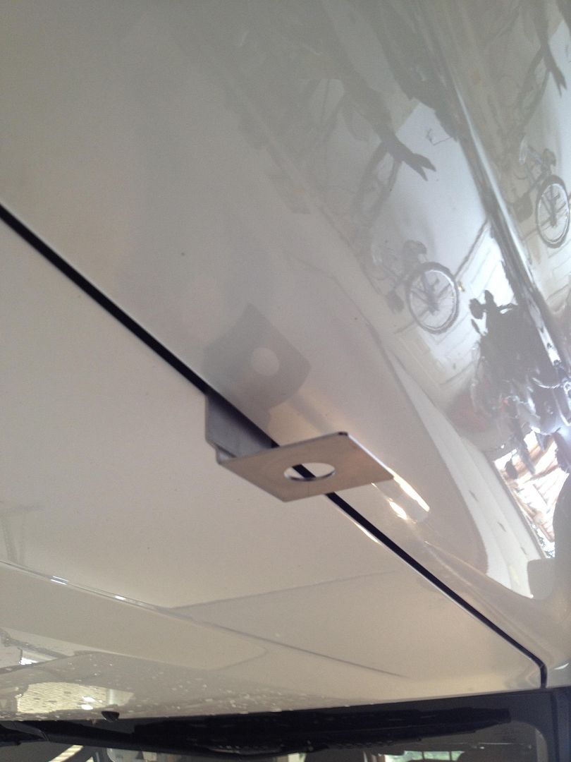

Bracket came in. Be advised that it will only bolt to a specific bolt. I wanted to mount it closer to the original location but the way the bracket was made the holes will not align. Nevertheless the piece is solid and perfect and it bolts securely. I like it.
As for my original purchased antenna....DIDNT WORK (Jensen Marine). The base was too long and was hitting the fender.
Pics:
The mount:

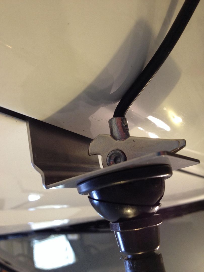

This is the part (silver) that was too long and was hitting the fender preventing me from mounting:
Solution:
Went to Autozone and bought one with a shorter base:
Result:
Havent painted the bracket and base black bc I want to make sure it works. otherwise Im returning it. Antenna is flexible and amplified so my hopes are up.
Comparison:
Notice the length after the legs. To use this bracket you want a short mast.
This is the one I bought:
Hope this helps

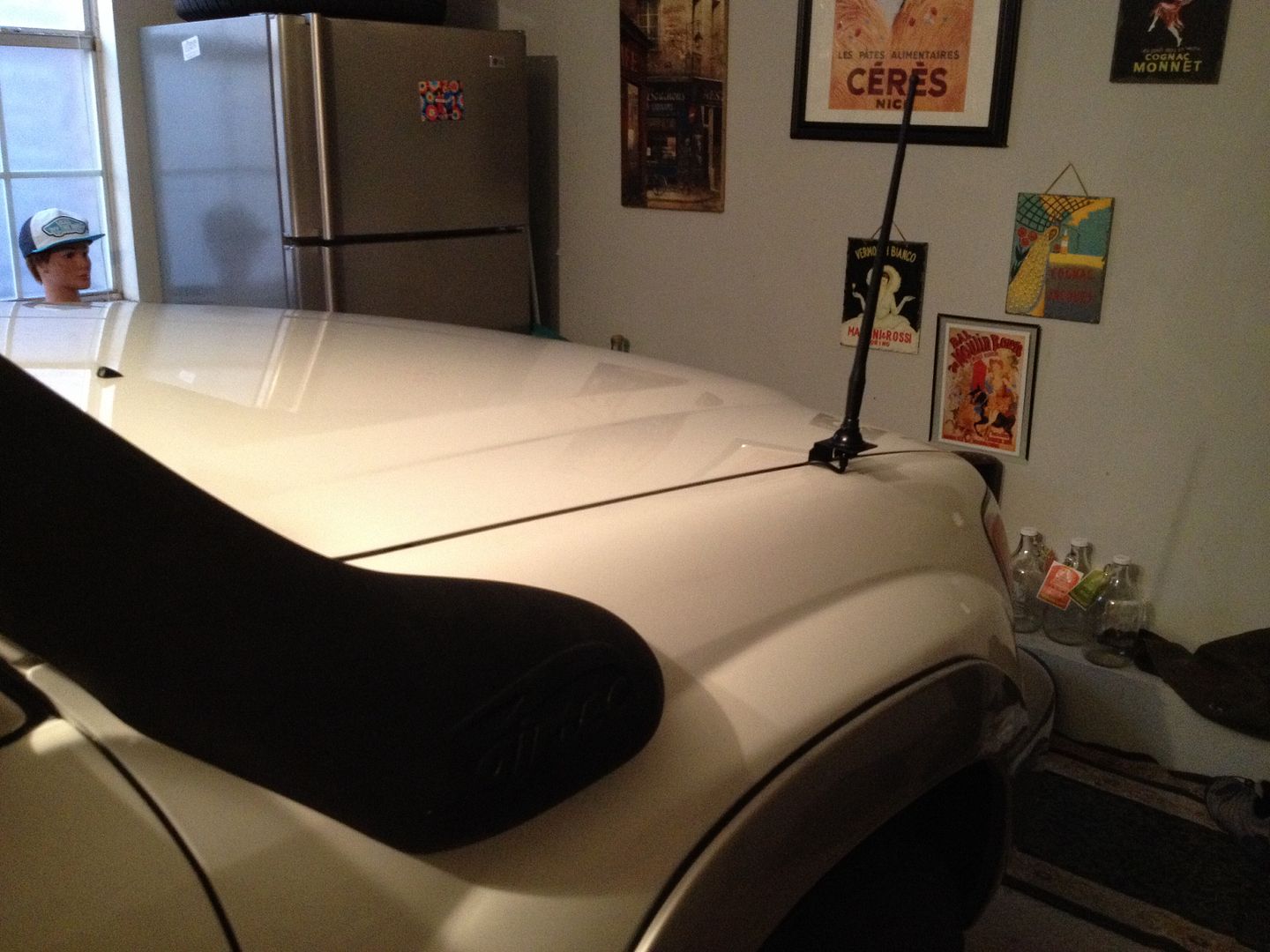

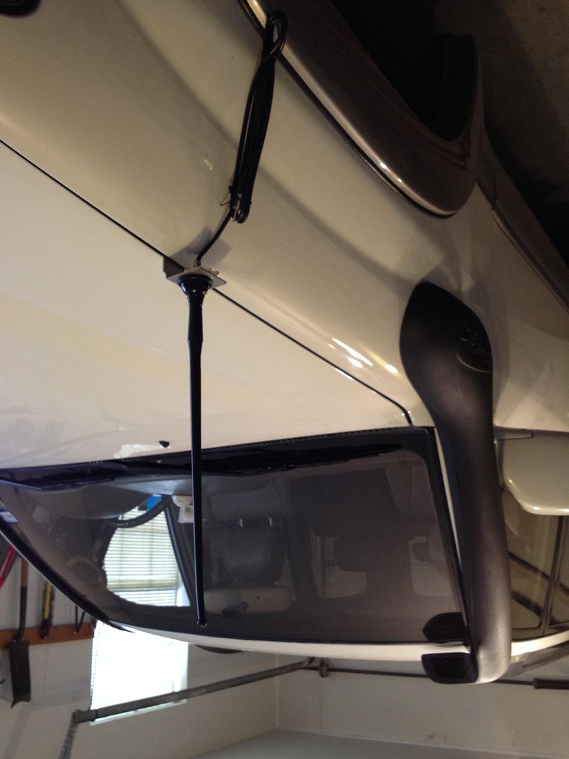

Couldnt help it and went ahead. Its not plugged bc I need an extension but I dig the result so far.
View from inside:
Ill post my final result tomorrow after I buy the extension. Including a non scientific test on radio reception plus one of engine RPMS vs Speed comparo pre and post Snorkel.
Cheers
Very good job, I like the look of it. What do you think about the location? Appears to be a good foot and a half from the original antenna location.

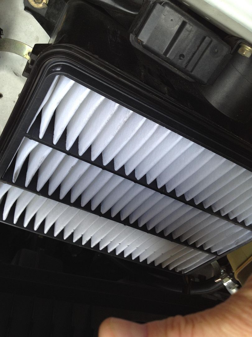

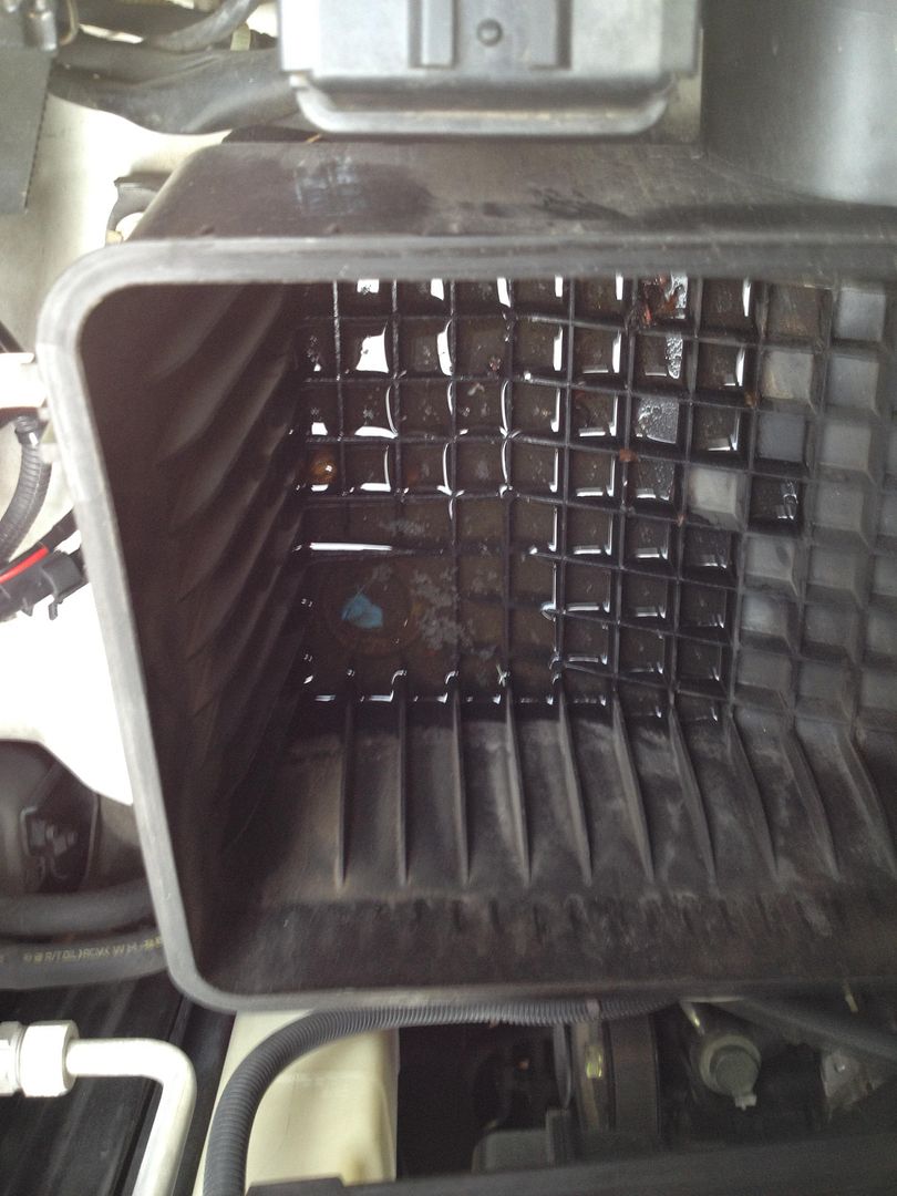

Update regarding rain water accumulation:
After two days of constant rain (the news said we got 8-11 inches of rain) and me driving up and down the tollway in heavy rain (several times 35 minutes each time for maybe 6 times) this is what I found in the airbox:

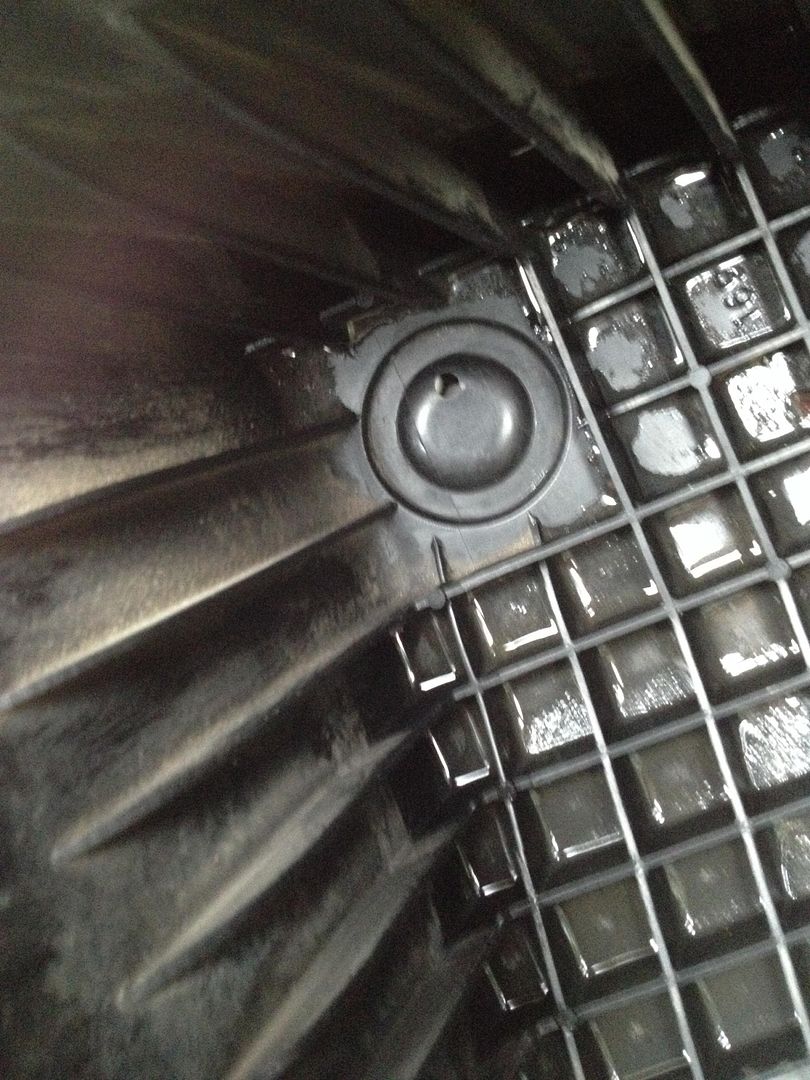

Notice that i plugged the drain hole (blue gum looking thing).
Filter was nice and dry:
I dried as best i could with a towel and i removed the "plug". A friend of mine from South Africa came by and he said they mod the box there. He recommended using a dremel to cut the grid (because the box is slanted to drain but the plastic grid prevents it) making a channel for water to reach the drain plug.
He also suggested making the drain larger and carrying a plug (HomeDepot) to attach when (to use his word) I go in the Bush lol.
Notice the drain hole is tiny, Im thinking of getting the type of plug that looks similar to ear plugs like the battle plugs and just using them when needed. I will post for those interested the end result of dremelling the grid.
Plug looks like this

Well it kinda works when Im in the city, not sure what to blame. The connection or the short crappy and cheap antenna I bought from Autozone in a rush to try the mount.
My next step is to have the antenna cable connected to a an extension and plugged directly to the head unit. I havent cared much bc currently Im streaming from my phone to the head unit whatever i want. But I know not to rely on it.
