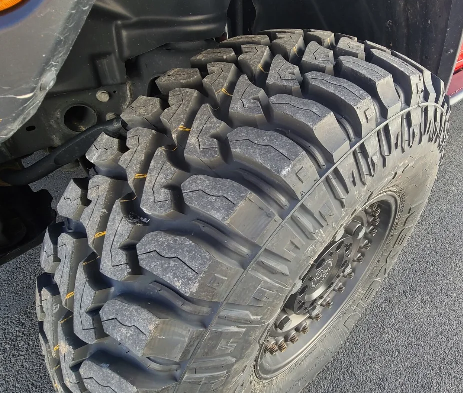

35x12.5R15 muds terrains are hard to find in stock. Found Cooper STT Pro tires in stock for decent price, but section width is a bit wide at 13.1". Noticed some Nexen mud tires that I had initially written off; as I associate the company with cheap tires. Read into it quite a bit, and decided to go for them. Seems Nexen put quite an effort into engineering a good MT tire. Can even get up to load range 'F' (12 ply) in some sizes. 3 ply side walls, and a tread pattern that I find attractive. $320each shipped! That is a fantastic price if you've looked at any truck tire recently.
Will see how they go. Here's how the tire looks (not my vehicle/picture):
Look pretty cool. Those look like a stiffer sidewall than the ones you are running. Are you going to
get the C rated or E rated tires?
Hey Jon, I went with C rated. Possibly could be a stiffer sidewall; will see I guess. They are a bit taller, but also narrower than what I have I think.

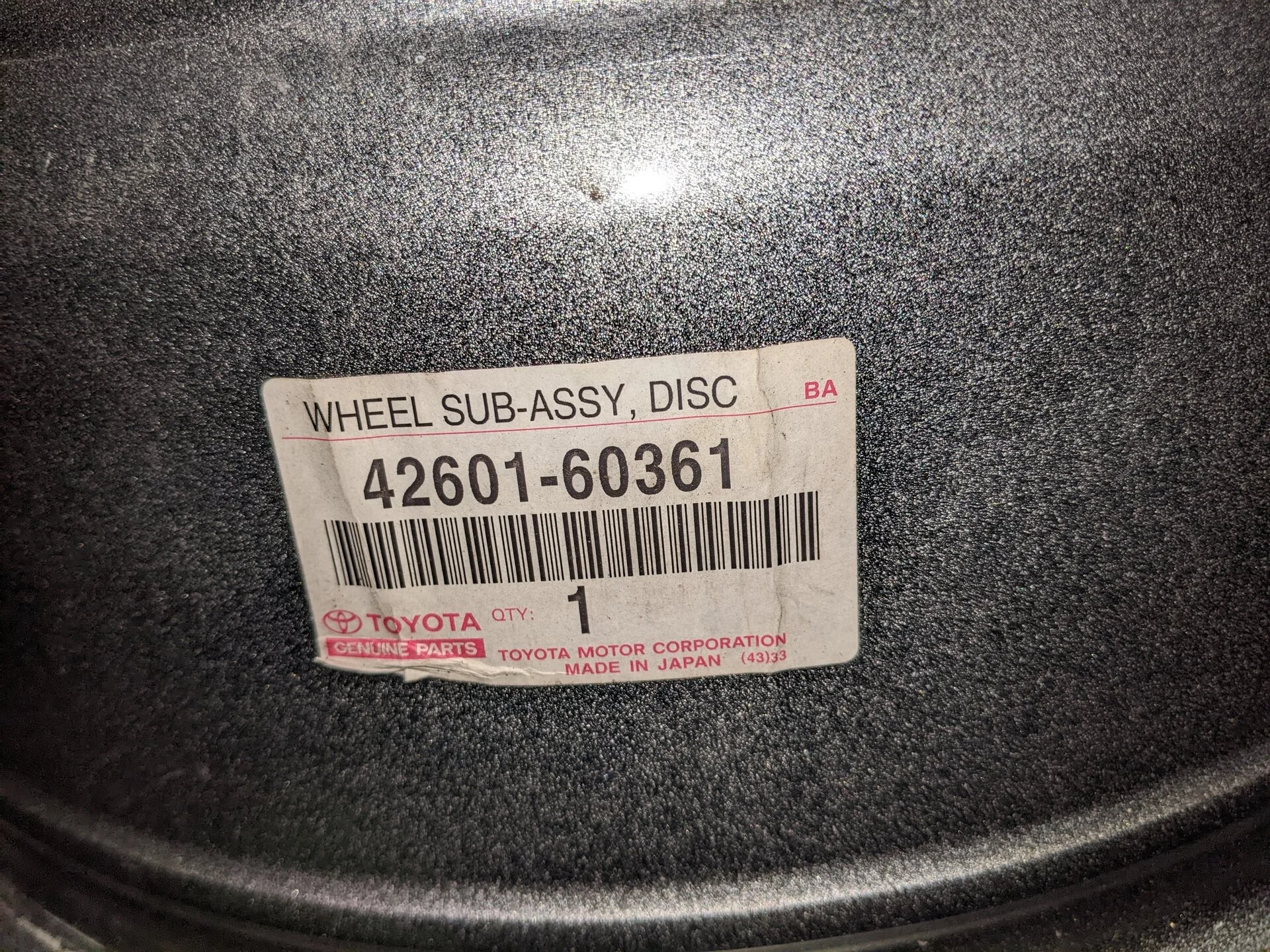

Are the rims you bought steel or alloy? That's a good price in any case. Maybe you already mentioned this elsewhere and I didn't see...

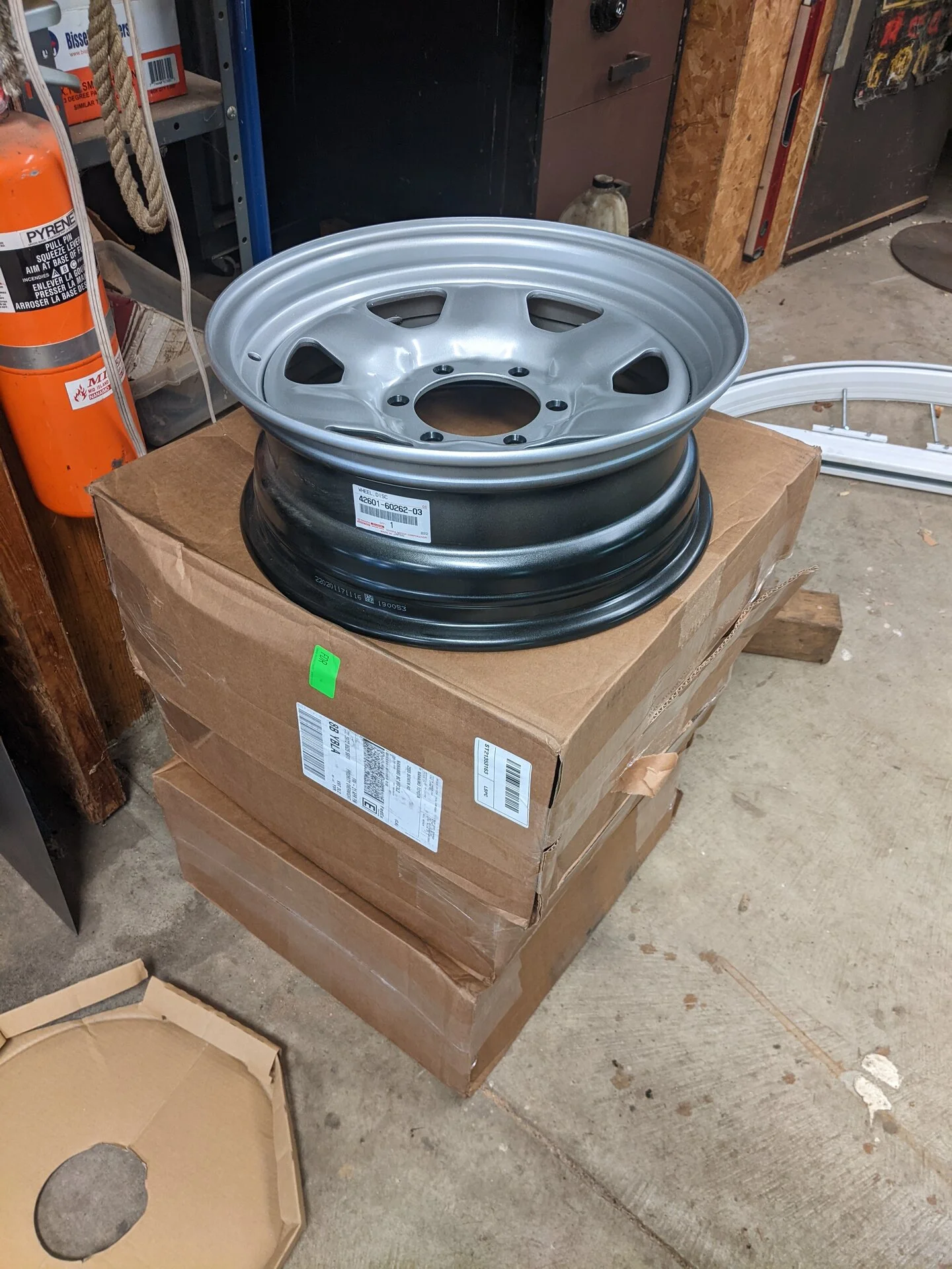

This is what's waiting for tires in my shop...View attachment 3348093
Very nice!!
Have you measured the rim width? Looking up that part number, Mr. T claims 16x6. But your wheel picture looks more like 16x7 to me.
The 285/75R16 tires you're looking at spec a 7.5-9" wide rim. You could probably get away with 7" ok, but might be a little crowned at higher pressures.
Wonder if your tire shop can get some 255/85R16 for you? Those would be better on a narrow rim.

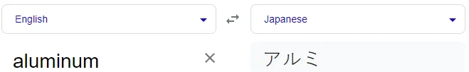

(The Japanese in this description reads: Illustration. Meaning Type C in the picture).

255/85 is definitely my first choice, but there's pretty limited options.
285 are just a lot more common, and fit on the rims ok, but I prefer the skinnier ones.

Wasted a couple minutes at work to confirm what I thought. In that wheel illustration:
